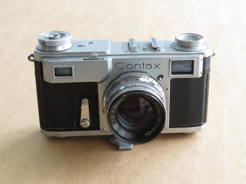

Jacques M. Posted - Jul 28 2010 : 09:11:30 AM
First, sorry for my long silence: my computer broke down two months ago and as I am stupid, I had not made copies. So I have lost all my datas...
I received lately two interesting Contaxes. Of course,I would not speak of them if they were not in close relationship with Kievs.
http://www.ussrphoto.com/UserContent/2872010_005.JPG
On the right: a Contax II of the last batch, n° O.64166 with a 1,5/5cm Sonnar T coated. Made before Dresden was bombed in february 1945. The remaining camera bodies and spare parts were sent to Kiev and they were used as production training. The first "Kiev 1947" were made with these parts, at least those with script re-engraved front plate (at the reverse of the front plate, the stroke of the "t" is lower than on the Contax Jena).
On the left, an early 1947 Contax Jena n° 11826, certainly with the original lens. History says that the Soviet forces asked for three production lines, that the Contax Jena and some Kiev 1947 (those with the "block" inscription??)were produced and that these lines were shipped to Kiev with some German engineers. No production in Ukraine before 1948, as it seems.
Unhappily, it's almost impossible to get a Kiev 1947. If not, I would have made close comparisons with these two ones...

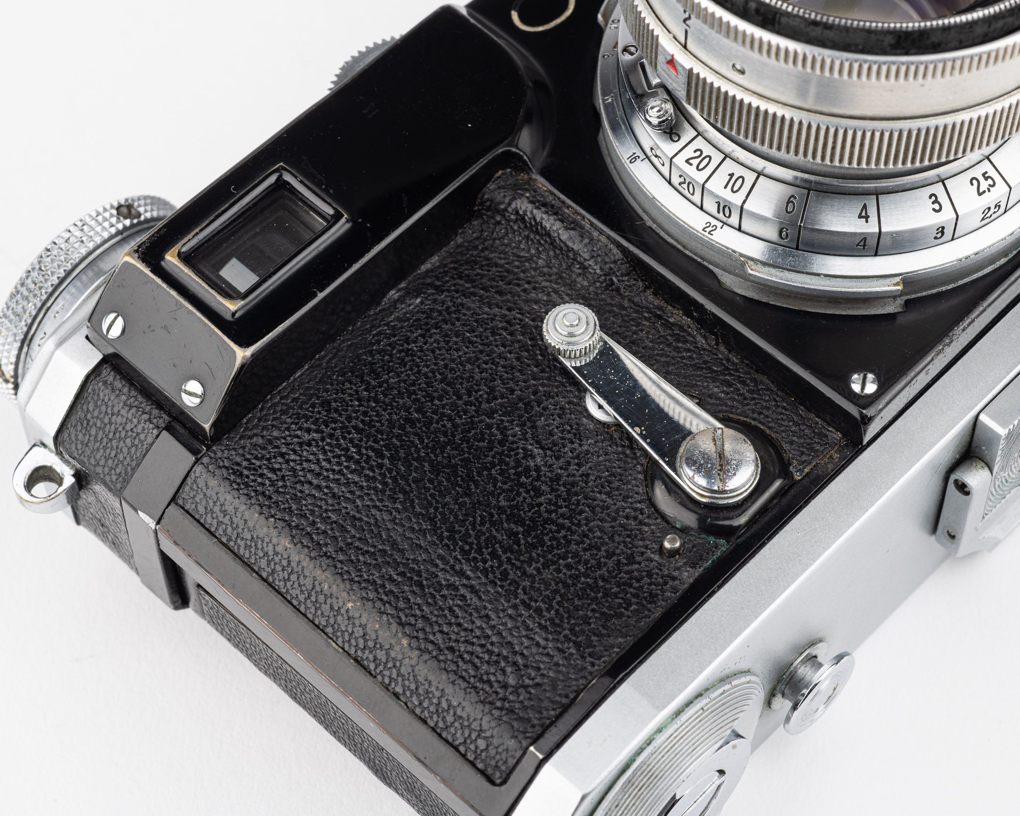

Jacques M. Posted - Dec 09 2023 : 09:58:54 AM
Congratulations for your Jena Contax "black face". Rare cameras! Probably around fifty in the 28xxx range, and perhaps some others on the 305xx range, by my data...
Thanks for the photos of your #28073. The 2/50mm Sonnar (not the usual 5cm) is interesting too. Your "black face" is not the only late Jena Contax to have received such a Sonnar in millimeters (still by my data).

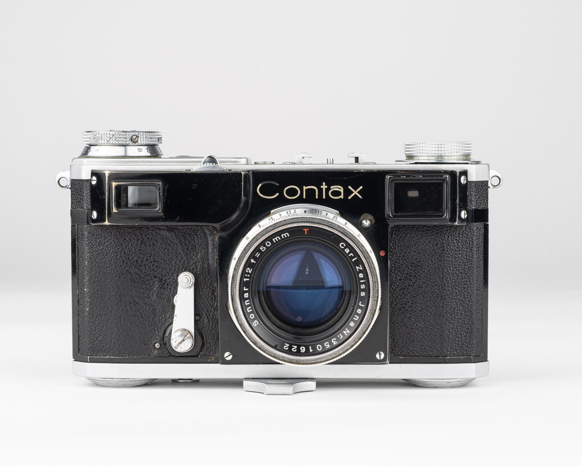

treehorn Posted - Dec 08 2023 : 10:23:22 AM
we had a lot about the Jena Contax, including the "ivory" version. There is also a black face version. Some cameras were sold recently at Leitz Photographica Auctions:
28039 + Sonnar 2/5cm T (3059673): Leitz Photographica Auction #41 (November 2022); hammer price 3120 Euro
https://www.leitz-auction.com/en/Carl-Zeiss-Jena-Contax-II-Black-Face/AI-41-41100
28068: Leitz Photographica Auction #37 (November 2020); hammer price ca. 4000 Euro
28079: Leitz Photographica Auction #36 (June 2020); hammer price ca. 5000 Euro
I was very lucky to find another one of them with the serial number 28073. Als serial numbers are very close and all cameras show the same characteristics of the Jena Contax.
http://www.ussrphoto.com/UserContent2/8122023_Contax-Jena_black_02.jpg
http://www.ussrphoto.com/UserContent2/8122023_Contax-Jena_black_04.jpg
http://www.ussrphoto.com/UserContent2/8122023_Contax-Jena_black_08.jpg

uwittehh Posted - Oct 02 2011 : 02:42:09 AM
Now that I own a Jena Contax too I can confirm to all points that Jacques listed. It's a really interesting camera. Here are some pictures:
The feather on the selftimer release and the black painted ring under the selftimer lever:
The shoe with the number and the logo. An interesting detail on the film reminder disk, the digits are engraved a bit more to the inner part of it. And no flat "3":
This seems to be really interesting, the shutter has no number engraved. On my Kiev II from 1949 there is a hand engraved number on it. Maybe the shutters are from the same factory and the ones for the Kievs were engraved by hand to distinguish them from the ones for the Jena Contax?
That's funny, there are parts made of cardboard to shield the rangefinder prism from light (the brown/black part on left-top of the picture). It just felt out and I wondered first where I have to reinstall it...:
And the result after reassembling:
Now it's a real beauty, when it arrives here the chrome on the top and front mask was a bit yellow tinted, then I found out that was nicotine (it stinks during removing it...)! So it seems that the camera was sitting the most time on a shelf in the household of a heavy smoker. That was the main reason why I disassembled the chrome parts carefully.
By the way, the lens is a rigid Sonnar in an aluminium housing. Like the Zorki lens on my Kiev II from 1949.

Here are the external differences between prewar or wartime Contaxes and the Jena Contaxes.
If it can help some colleagues to identify better their 1947-49 Kiev, specially about their origins: does mine come from Dresden parts or from Jena?...
On the cover of Jena Contaxes:
1- View counter: "3" with round top, flat on prewar or wartime Contaxes. Idem for the distance scale (front part).
2- Rewind knob: arrow without central extension.
3- Rewind knob: central screw: 6mm (5mm on other ones)
4- Accessory shoe: square shape.
5- Accessory shoe: logo "Carl Zeiss Jena".
6- Rangefinder: grey/grey rather than green/yellow.
On the front:
7- Selftimer: black painted rim under selftimer.
8- Contax engraving different. Clearly visible: distances between C/o and n/x are more important.
Rear part:
9- No logo.
Back part:
10- Accessory shoe: number of circles more important.
11- Accessory shoe: tripod with moulded lines on the two parts,
12- Release button: with concentric circles.
It is interesting to add that Jena Contaxes may have slightly different front engravings, concerning the exact shape of the O, for example (less or more flat). And the rear/back part is heavier on some rare Jena Contaxes (c.175g instead c.115g). Last: a flash sync on the cover (last batch only).
Very probably, there are other differences I missed! Please, don't hesitate to add your remarks.
