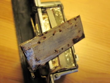

I received today the early Kiev III with the serial 52472. Unfortunately the ribbons are broken so it needs to be overhauled. One more example that perfect cosmetic condition indicates some inner defect.
I would like to concentrate on the light-meter of this Kiev. It's completely from Dresden! This verifies my guess that Kievs with the scales from the second column of my table have Dresden light-meter.
Here is the bottom of the light-meter housing:
http://www.ussrphoto.com/UserContent/2112013_7.jpg
http://www.ussrphoto.com/UserContent/2112013_8.jpg
D stands most probably for Deutschland (Germany). Makes sence since it is calibrated to DIN. 33 denotes the maximal sensitivity. R - denotes resistance?
Selenium cell is covered with some plastic that is untypical for Kievs
http://www.ussrphoto.com/UserContent/2112013_6.jpg
Back side of the cell. All wires seems to be connected to the external contacts mechanically (!!!) and not brazed.
http://www.ussrphoto.com/UserContent/2112013_5.jpg
I did not succeed to look at the galvanometer since the housing was sealed and I was afraid to break the glass.

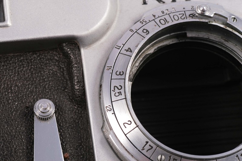

Concerning the "tower" knob. Look at this detail:
http://www.ussrphoto.com/UserContent/2112013_1.jpg
It was surely modified to fit the other tower details. Some number:
http://www.ussrphoto.com/UserContent/2112013_2.jpg
http://www.ussrphoto.com/UserContent/2112013_3.jpg
Some more details:
The arrow on the self-timer has 5 feathers like on Kiev 1958. Bayonet ring bears comas not dots but 3 is already with round top. Shutter has some cosmetic features that distinguish it from later shutter I've seen (e.g. Kiev 1956). The rewind knob mounting to the housing is different from standard Kiev III way of mounting. Here are the number on the shutter:
http://www.ussrphoto.com/UserContent/2112013_4.jpg
Bayonet mount has very good finish that is much better than of later Kiev models. It bears the number 1735 and the letter B. The winding knob has very shiny look and differs slightly from the other chromed parts (e.g. rewind knob). And of course the are no traces of Contax name on the front plate.

Posted - Dec 08 2013 :  04:44:15 AM  Show Profile  Reply with Quote
Hi, I see your picture of the selenium cell wrapped in cellophane - this will be a Zeiss on as I have just stripped a 1938 Contax 3, which had the identical cell. The cell was continued post-war, as I was able to fit a better cell from a Super Ikonta into it. Basically, there is a brass frame, which is soldered to the camera, then the selenium cell is simply slotted into the back of this frame and held in place by the earth spring and the glass diffuser that fits to the front of the cell. I beleive the cellophane was an effort to seal the cell, preventing oxidisation and loss of sensitivity. My Contax cell was stamped in ink 'FEB 1938' to show date of manufacture. The later,Kiev manufactured cells are less easy to replace as the wire is soldered direct to the selenium cell itself.
