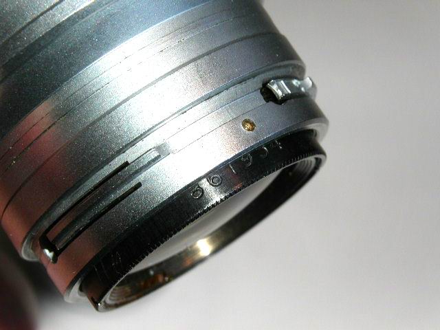

Posted - Sep 10 2009 : 04:27:23 AM Here's a sample of a hand written s/n. Lens is a 1956 Jupiter-3 (Kiev mount) :
 http://www.ussrphoto.com/UserContent/1092009_Redimensionnerjupiter3.JPG

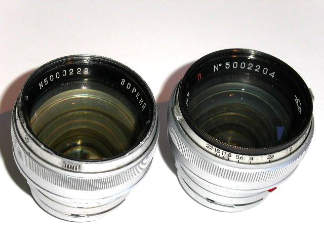

Posted - Sep 08 2009 : 07:07:23 AM Hello Brian
Thanks for sharing this !
I also own two early Russian 5Omm f1,5 lenses but in Kiev mount : ZK s/n 5000229 Jupiter 3 s/n 5002204
Both rear module have a machine stamped s/n : 860651 (ZK), 861934 (Jupiter 3). Still a Zeiss part inside that early Juipiter 3.
 http://www.ussrphoto.com/UserContent/892009_Ré-exposition de PICT0001.JPG
 http://www.ussrphoto.com/UserContent/892009_Ré-exposition de PICT0002.JPG
I have tested the lenses, they still take great pictures
I would like to add that you helped me a lot to learn how to repair such lenses. Thanks lots
Jed |
