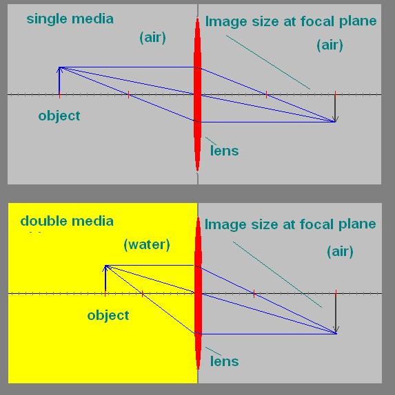

Posted - Apr 27 2010 : 8:51:35 PM Nice illustration of the differences in the angles of coverage between air and water, Luiz. Thank you for those.
So Vlad (of course no apology necessary, and I had already thought the same thing) .. then the question then is ... what M-42 mount camera, as well as, what M-39 mount camera would this lens be for? The passport does seem to indicate that it will be for a 35mm camera.
I have thought maybe Leningrad since it's automatic function is useful for underwater photography ... but that may be wrong. Are there any M-42 rangefinders that will have the proper focal plane distance? Or, is it made for some non-Russian camera?

Posted - Apr 27 2010 : 2:24:59 PM  http://www.ussrphoto.com/UserContent/2742010_angles.JPG
| Luiz Paracampo |
Posted - Apr 27 2010 : 1:19:13 PM Answer to Juhani, Vlad and Bill. This lens probably will correctly focus on air with Zorki etc cameras giving normal wide angle covering (around 90º). In another media like water the higher refraction index will offer a greater image and a consequent narrower angle. In loose words we can say that considering the same sinus length observed on air, a shorter distance will be needed from the lens nodule to the object in water media due the higher refraction index, and this distance is equal to the quocient berween air refraction index and water refraction index, approximatedly .66. (or 60º) see diagram. Regards LP |
