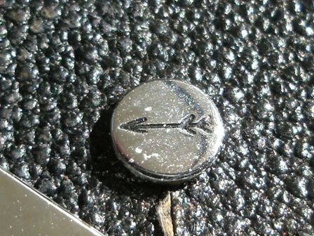

Posted - Sep 02 2011 : 09:49:52 AM The pictures of the same part... My three early Kievs II (1949 and 2x1950) have the same button. In fact, exactly the same as the Contax O series:
 http://www.ussrphoto.com/UserContent/292011_arrows-feathers 010.JPG
The big surprise comes from my 1949 Contax III. The general drawing and the size are the same as the Jena Contaxes ones, but it has four feathers only:
 http://www.ussrphoto.com/UserContent/292011_arrows-feathers 008.JPG
The last picture for my 1958 Kiev III:
 http://www.ussrphoto.com/UserContent/292011_arrows-feathers 009.JPG
What to conclude? Nothing for the moment! Some more pictures would be of great use to complement the collection... One can too imagine that in those years, Arsenal used what they find: spare parts coming from Germany, new parts made by themselves or ordered outside... All is open!
Amitiés. Jacques. PS: thanks once more, Ulrich, for your very important articles you sent me a while ago. Alas, in German...
| Jacques M. |
Posted - Sep 02 2011 : 09:36:47 AM Hello,
Ulrich is right. The arrows of the selftimer and their feathers can be important to date a Contax/Kiev camera. So, I have shot some of them.
About the Contaxes, no surprise. That they be II or III, prewar or wartime, they all have the same arrow with "five" feathers,if we call a feather the extension of the arrow.
Here is the one of my Contax O series:
 http://www.ussrphoto.com/UserContent/292011_arrows-feathers 004.JPG
Now, the ones of my two Jena Contaxes. Same general drawing for the # 11826, even if the arrow is a bit bigger:
 http://www.ussrphoto.com/UserContent/292011_arrows-feathers 006.JPG
The Contax Jena # 30536 is like the # 11826, but the button is in inox rather aluminium. A camera for the rich ?
 http://www.ussrphoto.com/UserContent/292011_arrows-feathers 007.JPG

| Jacques M. |
Posted - Aug 28 2011 : 09:09:32 AM Very last thing: the stamped spot round the counter (on the Contax 3).
 http://www.ussrphoto.com/UserContent/2882011_Compl. Kiev II 49 - Contax IIIM 002.JPG
A very interesting question, as this reinforcement exists on Contax III only. Not on Contax II, Jena Contaxes, Kievs... That means that the top plate of this 1949 Kiev III cannot have been made at Dresden.
So, the meter and the tower like button only seem coming from Dresden. All the rest of the camera can have been made at Jena, or perhaps at Kiev. Impossible to be more precise, as the two "pure" Jena details (black circle under selftimer, number of circles on the square part of the shoe) are absent here. And we don't have any Jena Contax III to compare...
But it is known that an electrician engineer, specialised in Contax III, was left at Jena well after the machine tools were sent to Kiev. It would explain why it is more or less admitted that Kiev III were really made at Kiev only from 1952.
Now, I hope that Alexander will go on the thread with pictures of his 1948 Kiev III. Perhaps they will solve some questions?
