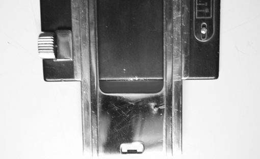

Vlad |
Posted - Jun 06 2010 : 11:14:47 AM Hi Michel!
You have a VERY early one it seems, with the non-rectangular viewfinder and VTOMP stamping on the back. My Compur is #467097 and has the serial under the rails where yours doesn't and mine is hand-engraved and not even stamped. Also mine has GOMZ stamped on the back. Also you have a rectangular hole on the rails and not the semi-circle which also points to a very early origin. My Vario version of Fotokor (albeit already with square viewfinder) has this same rectangular hole.
So it's very possible they weren't even numbering these at the early stages like you have. Very nice find! Congrats!
Cheers, Vlad. |
Michel |
Posted - Jun 05 2010 : 12:46:24 PM Hi friends,
I'm puzzled with my Compur Fotokor. Like Vlad, I did'nt find this serial number. Reading Nightphoto post, I searched again and again. Then I went to Fotoua and saw where the s/n should be.(Under the focusing plate) So it appears that my Fotokor has none. Some photos of this camera will help to identify what I think is a N°1… All comments are greatly welcome.
 http://www.ussrphoto.com/UserContent/562010_Dos.JPG
 http://www.ussrphoto.com/UserContent/562010_Ortagoz.JPG
 http://www.ussrphoto.com/UserContent/562010_Pas de N° serie.JPG
 http://www.ussrphoto.com/UserContent/562010_Poignée.JPG
 http://www.ussrphoto.com/UserContent/562010_Viseur.JPG
 http://www.ussrphoto.com/UserContent/562010_VOOMP.JPG
Thanks to all. Michel
