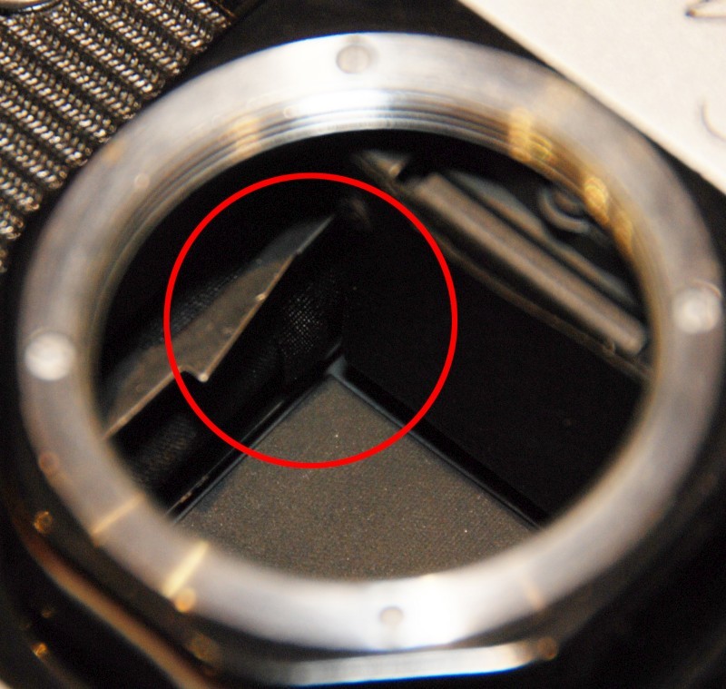

While trying to mount my Zenit 3M on the MTO and playing with it, I started having this thing happen when winding up.. top of the curtain started dragging behind... is there a simple fix for this?
http://www.ussrphoto.com/UserContent/DSC_9718.JPG

okynek Posted - Apr 25 2008 : 11:00:06 PM
Yeh, sorry that you have this problem Vlad. I had same stuff with Kristall. It is definately bad ribbon. Without experiense shatter and evrething around it really hard to fix on Zenits

fedka Posted - Apr 25 2008 : 3:50:31 PM
Vlad,
This looks like a broken ribbon. The fix is not that easy, but possible, since you only need a new ribbon, which most repairmen have.
Yuri
Vlad Posted - Apr 25 2008 : 3:46:08 PM
If I look inside the body opening from front I can also see a ribbon that came down 1/3 way... Don't know if it's visible on picture below.....
http://www.ussrphoto.com/UserContent/DSC_9720.JPG
