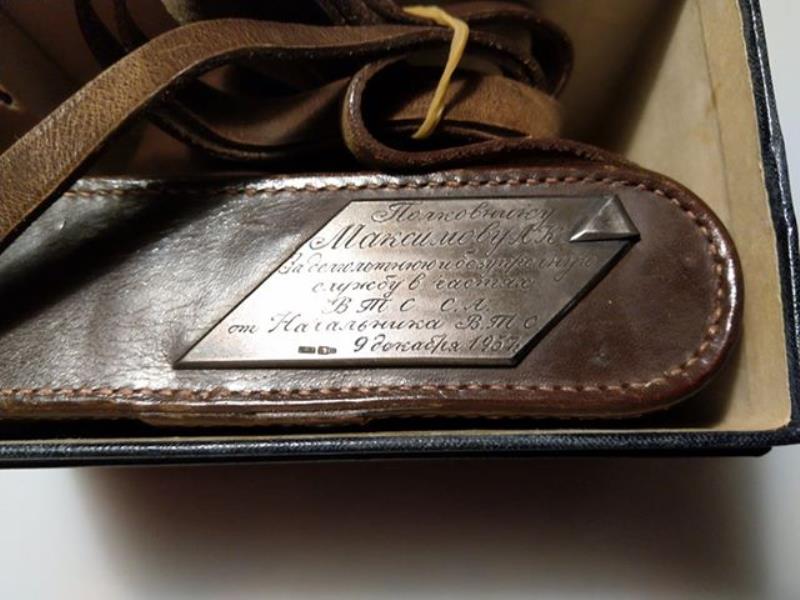

Alexander Bronstein has kindly provided me with more detailed photos of that camera box. It is quite plain...
http://www.ussrphoto.com/UserContent2/3012020_83198860_2543204285923546_5280322640123265024_n.jpg
http://www.ussrphoto.com/UserContent2/3012020_84137376_794603631012123_859831823931277312_n.jpg
http://www.ussrphoto.com/UserContent2/3012020_84433982_179889856724635_5151127245015744512_n.jpg
http://www.ussrphoto.com/UserContent2/3012020_83101564_2567392373495093_4336284705293860864_n.jpg

Posted - Jan 31 2020 :  01:57:45 AM  Show Profile  Reply with Quote
The plaque on the bottom of the case is interesting.
Detlev
http://www.ussrphoto.com/UserContent2/3112020_TSVVS.jpg
2668 Posts
Posted - Jan 31 2020 :  3:00:27 PM  Show Profile  Reply with Quote
The plaque is interesting. Can somebody translate what is written? I see 1957 as an anniversary date (?): probably late if it's the case...
The cable release with its special case inside the box is interesting too. A pity we don't know more about it.
Posted - Jan 31 2020 :  3:06:58 PM  Show Profile  Visit Vlad's Homepage  Reply with Quote
Here's a better photo.
It says:
"To Colonel Maximov L.K. for many years of excellence in service in detachment of VTS SA (Military Topography Service of Soviet Army) from head of VTS, December 9 1957".
http://www.ussrphoto.com/UserContent2/3112020_84002721_160790025358946_8312377858118909952_n.jpg
2668 Posts
Posted - Jan 31 2020 :  3:20:09 PM  Show Profile  Reply with Quote
Thanks, Vlad.
The Military Topography Service sounds right, of course.
But what about the date? This VTS-VS is "officially" a 1950 camera. The last batches of Jena-Contaxes were delivered well inside the fifties, especially the 305xx series. But is a comparison possible?
Edited by - Jacques M. on Jan 31 2020 3:21:53 PM

About TSVVS case:
My first impression is that the case is contemporary within 1957 years.
I had seen some 60 years ago. But this one reminds Zorki cases once Ukranian FED and KIEV had a thicker paper and (generally) grey interior.So, probably not original from 1949/1950.
Regards.

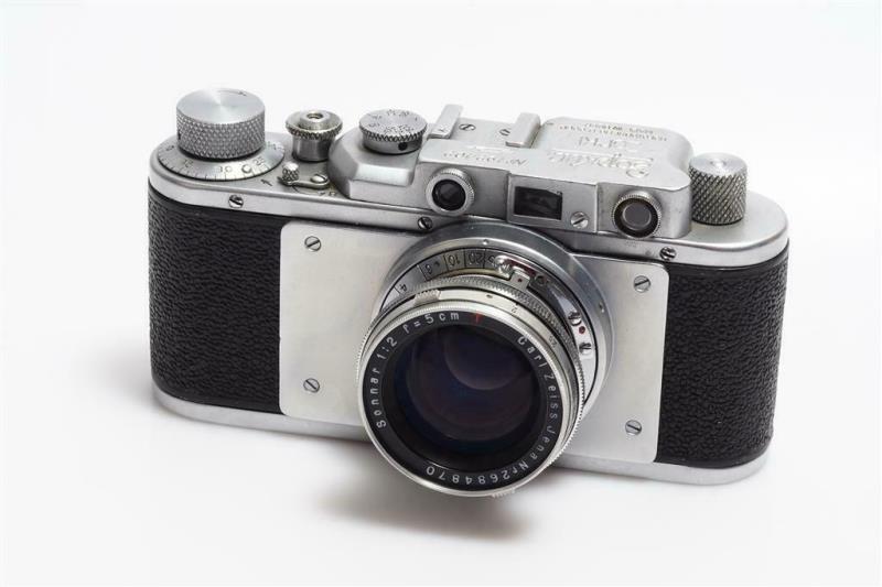

Picked up a "Leica Copies" book by HPR this weekend at Chicago Camera Show, interesting information regarding TSVVS in there, a mention of 1970s sale of 5-10 of these cameras in South Germany! This is the first time I see this camera mentioned before 1990s.
http://www.ussrphoto.com/UserContent2/2422020_Scan_20200224_103529.jpg
Posted - Feb 24 2020 :  10:40:41 AM  Show Profile  Visit Vlad's Homepage  Reply with Quote
Also this mention of this frankencamera/cutlet/meatball:
http://www.ussrphoto.com/UserContent2/2422020_viber_image_2020-02-24_10-30-46.jpg
2668 Posts
Posted - Feb 24 2020 :  11:19:43 AM  Show Profile  Reply with Quote
Concerning the frankenFed, it's easy to answer the question.
The adaptation was made to put a Sonnar in Contax mount on the Fed 1b, much better than the original Industar 10... In case the owner had such a lens!...
Here is a "modern" changing, still for sale on ebay. Less interesting than the precedent conversion, as we have all the possible Jups in M39 mount now...
http://www.ussrphoto.com/UserContent2/2422020_Zorki-TSVVS.jpg
Posted - Feb 24 2020 :  11:46:45 AM  Show Profile  Visit Vlad's Homepage  Reply with Quote
Hi Jacques, the bottom seems to be from TSVVS on the photo from the book, and top from FED. It's curious how all mechanisms fit together from both cameras...
2010 Posts
Posted - Feb 24 2020 :  6:40:06 PM  Show Profile  Visit Luiz Paracampo's Homepage  Reply with Quote
Very well observed by Vlad, is that "the altered FED" is a real TSVVS with rangefinder, viewfinder ant top from FED
And the FrankenFED from Jacques is really a Zorki with an original machined Contax mount!
2668 Posts
Posted - Feb 25 2020 :  03:19:52 AM  Show Profile  Reply with Quote
Ah, yes! Thanks, Vlad and Luis.
So, this frankenFed cannot have been made before 1949... Really a strange camera, as the ZK lenses in m39 mount were available.
Or a test camera before the TSVVS production?
Anyway, very interesting.
