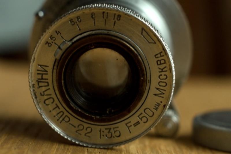

The Industar 22 "Moscow" was not coated in the first run (picture 1), some of them are later. The Industar 22 "Zorki" was coated mostly (picture 2). And the other (early) Industar 22 were coated mostly too (picture 3 maybe from 1952 (or earlier?) and picture 4 from 1953). I have some of them here. For the differences of the coatings I agree, there are some.
The FED-Zorki were delivered with the "Moscow", the "Zorki" and the noname Industar 22 variant over the time (1948/1949). The Zorki 1a (1949) also. And some FED-Zorki's were also deliverd with ZK 50mm/1.5 and ZK 50mm/2.0 lenses by the way.
I think most of the lenses delivered with FED-Zorki's are authentic. I've seen only very few offers with later Industar 22 (or other later lenses) coming with FED-Zorki's.
Maybe it helps ...

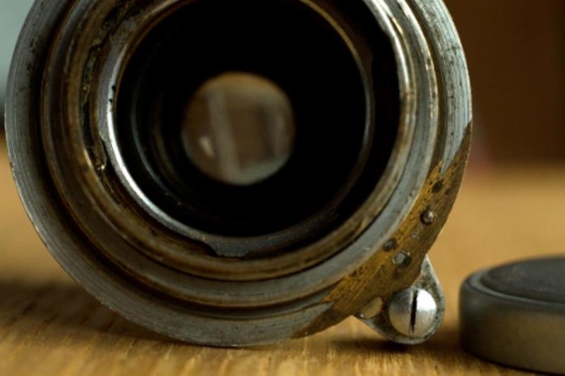

The Industar 22 from KMZ and the so called Industar 10 from FED are not the same construction, I think. But it's just an other story
I am wondering if the early Industar 22 with the diafragm tab, is longer than the Industar 10 (FED).
The main difference in optics between the regular Industar 22 and the Fed 3,5/50 is the fact that the I-22 is longer.
Good point, Milo.
I have just compared the length: my early MOCKBA (with short diaphragm tab) is just the same length of later Industar 22. So it's not only a reengraved Fed 3,5/50, contrarily to what I thought.

Just by pure chance I bought today the lens Industar-22 Moscow. I'm a big fan of I-22 and use a lot both rangefinder and SLR versions of it. I was curious about the very early version of I-22.
My sample lacks the original press tab on the focusing arm. It was replaced with the later flat version. You can imagine the way of how so valuable today cameras and lenses were repaired 60 years ago in Soviet Union. In order to fit the new tab a repairman has ground off the part of surface on mounting plate together with the serial number. I can still recognize the traces of the number 4282 (or 4289).
The most interesting is the prehistory of the lens. Of course I wanted to know what happened with the camera. The seller told me that he was also curious and asked this question the original owner of the lens. The owner lives in some small village near Kiev. He wanted to sell some unnecessary photographic rubbish. When the guy who sold me the lens saw this Industar and asked for the corresponding camera. The owner answered that he has Zorki and could offer it with an another lens for 10 euros. The only problem was that the camera was kept in the flat of the owner's son. When the seller arrived to this flat and inspected Zorki he discovered that it was early Zorki (but not FED-KMZ or FED-Zorki) fitted with the ZK lens. Meanwhile, the son of the original owner checked in internet the prizes for the lens and of course asked for the camera much more than 10 euros .
So it seems that the lens was separated with the original camera already in 1950-1951. Sounds rather strange. If the camera failed to work properly then there is no reason to separate the body with the optics since that time the camera could be repaired easily. Most probably the owner of the camera fitted it with the later coated Industar and sold this early version. At least the previous owner possessed this lens and Zorki with ZK since 1950.

It is also funny that this lens does not fit properly the thread of FED NKVD (I mean the correct position of the distance scale) This fact is very surprising for me. Probably I missed something. I thought that all pre-war FED's threads are the same and equal to the early Zorki's ones.

No, no, you have not missed anything!
The 1b and 1c could have different positions for the infinity button (globally from 7 to 11 o'clock). It is said that the position of the four screws was regulated for each camera/lens at the factory. The regularity (8 o'clock) was obtained from 1938-39, as it seems.
That can lead to funny looks. I have put a postwar Fed lens on a NKVD: the infinity button is at 3 o'clock...
Concerning the lenses on a Fed Zorki, the ZKs were expensive and sought after, certainly from the origin (1948). We could imagine a parallel market... On one of my FZ, the original lens (which one?) was changed against a 1950 Industar 22 K350...
For the rest, there was a normalisation about the pitch after the war. Before the war: 1 mm by turn. After the war (I don't know the exact date for Fed): 0,976 mm by turn: the Leica gauge. That explains why the postwar lenses generally don't fit the prewar Fed. Or you must force. Or the thread is worn!
