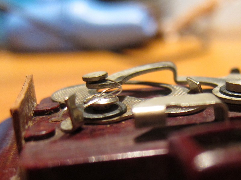

Hello!
First, the screw, that hold front plate, is missing. Can anyone make picture, what this screw is like and how is it fixed in the film chamber (pictures 1 and 2).
Second, theres must be missing one spring (picture 4). How does it look like and how fixed.
Thank you!
http://www.ussrphoto.com/UserContent/182011_lil1.jpg
http://www.ussrphoto.com/UserContent/182011_lil2.jpg
http://www.ussrphoto.com/UserContent/182011_lil3.jpg
http://www.ussrphoto.com/UserContent/182011_lil4.jpg

I checked both my Liliput and Maliutka which has the same exact housing on the front, my Liliput doesn't seem to have an original screw in it but I took a picture of it anyways, but Maliutka does, so I think that's the screw that you should be looking for. See below.
http://www.ussrphoto.com/UserContent/182011_IMG_1244.JPG
http://www.ussrphoto.com/UserContent/182011_IMG_1245.JPG
http://www.ussrphoto.com/UserContent/182011_IMG_1246.JPG
http://www.ussrphoto.com/UserContent/182011_IMG_1247.JPG
http://www.ussrphoto.com/UserContent/182011_IMG_1248.JPG
http://www.ussrphoto.com/UserContent/182011_IMG_1249.JPG
http://www.ussrphoto.com/UserContent/182011_IMG_1250.JPG
Hope this helps. If you need any more pictures with different angles, let me know.

It also seems that my Liliput has been repaired and the bigger diameter screw was put in, because I tried switching the screws around, the one from Maliutka (the original one) was too thin for the Liliput, but I think yours is just like Maliutka since I think whoever repaired it had put in a bigger screw..

Pleas make one picture inside the film chamber!
I was thinking, is the screw fixed in the body or is ther somekind of nut there?
And dont you want to take of the spring and make a picture? With meausuring tape? (Dont risk if you are not sure, you can but it back :)
Best, Martti
4275 Posts
Posted - Aug 02 2011 :  8:27:12 PM  Show Profile  Visit Vlad's Homepage  Reply with Quote
Unfortunately I wasn't able to take the spring out, it's coiled around a rivet and it doesn't seem to be removable. I took some detailed images instead. And there is no nut in the back.
http://www.ussrphoto.com/UserContent/282011_IMG_1252.jpg
http://www.ussrphoto.com/UserContent/282011_IMG_1253.jpg
http://www.ussrphoto.com/UserContent/282011_IMG_1255.jpg

Posted - Aug 25 2011 :  04:11:04 AM  Show Profile  Visit fotomuda's Homepage  Reply with Quote
Thanks Vlad!!!
I have get the screw from smena-7 (from the top plate)
4275 Posts
Posted - Aug 25 2011 :  7:34:08 PM  Show Profile  Visit Vlad's Homepage  Reply with Quote
My pleasure, looks great!
