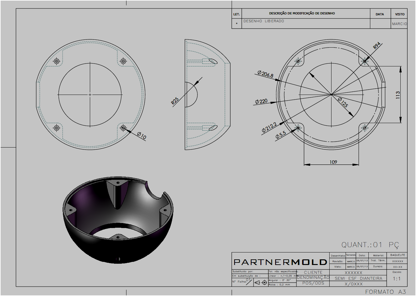

Posted - Jan 08 2014 :  3:09:45 PM  Show Profile  Visit Luiz Paracampo's Homepage  Reply with Quote
images of telescope
http://www.ussrphoto.com/UserContent/812014_1.png
http://www.ussrphoto.com/UserContent/812014_2.png
http://www.ussrphoto.com/UserContent/812014_3.png
http://www.ussrphoto.com/UserContent/812014_4.png
http://www.ussrphoto.com/UserContent/812014_5.png
http://www.ussrphoto.com/UserContent/812014_10.png
http://www.ussrphoto.com/UserContent/812014_11.png
http://www.ussrphoto.com/UserContent/812014_12.png

Looks great and very unusual!
Have you made any sample photographs to compare sharpness and contrast to other reflex lenses?
2010 Posts
Posted - Jan 08 2014 :  4:06:34 PM  Show Profile  Visit Luiz Paracampo's Homepage  Reply with Quote
i REALLY DID NOT MADE ANY PHOTOGRAPHS BUT THE VISUAL RESULTS ARE THE SAME OF THE CONSVENTIONAL LENS.
i AM JUST PRODUCING 40 PIECES FOR THE UNIVERSITY OF AMAZONAS. i BELIEVE THEY WILL TEST TEHM FOR ME.
RGDS
