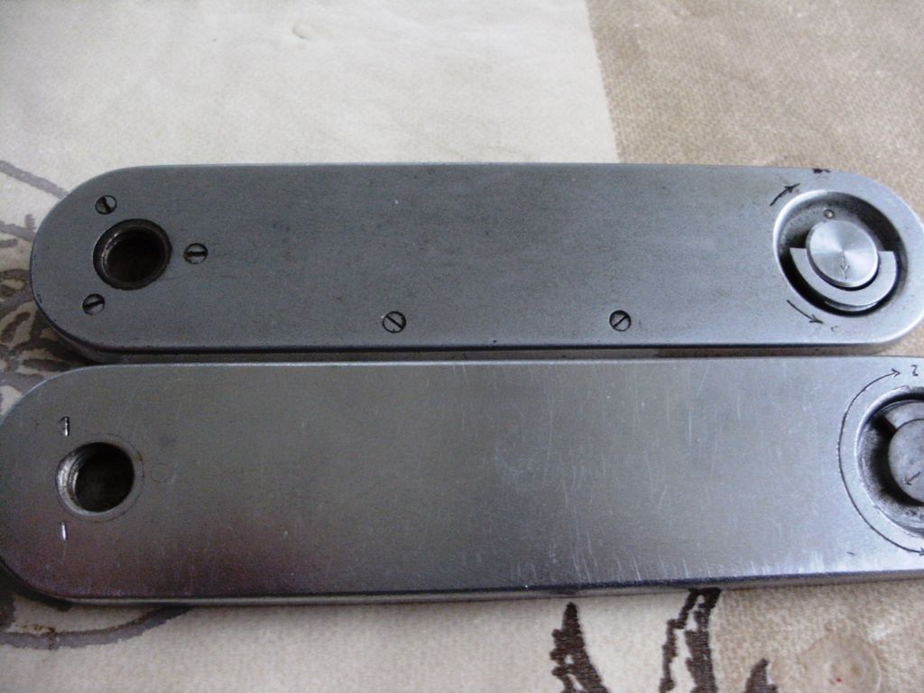

I have just received the camera.
Some words to share my first impressions.
It seems homogeneous: all is well adjusted and would work if the shutters were cleaned.
The chrome looks like the first Leica III(F) one of 1933: bright and somewhat peeling.
No hole to adjust the lens on the back, no hole on the press film inside.
The tip of the rangefinder could be a Fed 1c's with its drop shape.
The lens must be a Fed with the diaphragm at the rear (middle on Elmars) and its number: 15035 (probably 1935).
But there are things which are very strange: the main buttons, the inscriptions on the counter and the speed dial, the rear of the shutter box when the baseplate is removed, the setting of the baseplate and the position of the screws which fasten the shutter box on the front. All that is neither Fed's nor Leica's. And that could hardly have been home made.
Photos as soon as I can!

I have now partially dismounted this mysterious camera and a second one (a Fed 1d) to compare.
Of course, the technical solutions are globally the same: they both are Leica II copies. But almost all the internal details are different: position and size of screws, shape of the shutter box, springs and position of the film plate...

Posted - Nov 25 2014 :  05:11:13 AM  Show Profile  Reply with Quote
The two baseplates (with z and a on the Leica fake).
http://www.ussrphoto.com/UserContent/25112014_DSCF1710.JPG
http://www.ussrphoto.com/UserContent/25112014_DSCF1712.JPG
Edited by - Jacques M. on Nov 25 2014 05:15:15 AM
Lenny
496 Posts
Posted - Nov 25 2014 :  05:21:30 AM  Show Profile  Reply with Quote

496 Posts
Posted - Nov 25 2014 :  05:37:40 AM  Show Profile  Reply with Quote
Jacques, have both baseplates the same length?

2604 Posts
Posted - Nov 25 2014 :  11:15:03 AM  Show Profile  Reply with Quote
To Lenny:
- the metal ring behind the lensplate is completed by a paper shim (5 on the Fed 1d showed!).
- both baseplates have the same dimensions.

as for the screw on the top right... winder end: both my redcurtains IIIc have a screw on that end of the top, but not on the other side...
that's what you were remembering at the beginning of the discussion. But it's the only thing that this camera has with a stepped IIIc.
nice find... may be you should fit the odd 50mm F2 partially coated lens on it... ;-)

Just a detail more about this camera.
By the position of "D.R.P." (Deutsches Reich Patent) on the cover, the Leica camera which was used as a model was made between 1932 and 1936. After, the "DRP" inscription is in second position, just under "Leica".
That does not really change what we had said. But the camera could have been made before WW2 too.

They both have six-sided nuts with an additional plate under it and the long shutter-spring. Your Neuca has 2/4-sided nuts without a plate under it and a short spring. I guess your Neuca is a younger evolution. Why start with a shorter spring when Feds had long springs. But still I like your Neuca most, very special.
2604 Posts
Posted - Jun 15 2015 :  5:08:15 PM  Show Profile  Reply with Quote
Luiz,
Do you know what the shutter box of the Neucaflex is made of?
On your site, it seems aluminium or iron, not brass: http://www.novacon.com.br/influest12.htm
On my camera, it is made of iron, contrarily to the Neucas we know.
And the base plate is made of iron too. I had not tried a magnet...
So, this camera could derive from a Neucaflex rather than a Neuca?
Thanks. Jacques.

If your Ucaflex has a shutter box made in aluminium, I suppose that the whole series of Uni/Uca/Neucaflex has the same.
I try a magnet everywhere, now!
And in my LTM "Leica like", this camera is the only one to have the shutter box, the buttons and the two plates in iron. The body is in aluminium and the cover in brass with chrome.
Why? I don't really see an explanation for that.

No idea concerning this shutter box made in iron sheet?
I don't remember having seen a Leica like mechanism made of that material. As for the plates and the buttons made in iron too... But I am far for knowing all of them.
Just a guessing. At first sight, it is probably easier to make the mechanism of a prototype in iron sheet whereas the corresponding production will be made of brass or alloy. So, yes, that would leads towards a prototype.
But does this camera, as it is, lead us towards the Neuca? Probably not: they seem too far. This camera would be rather a sort of "orphan" with, perhaps, as ancestry, the mechanism of the Neucaflex... Unless the Neucaflex is derived from this camera??
