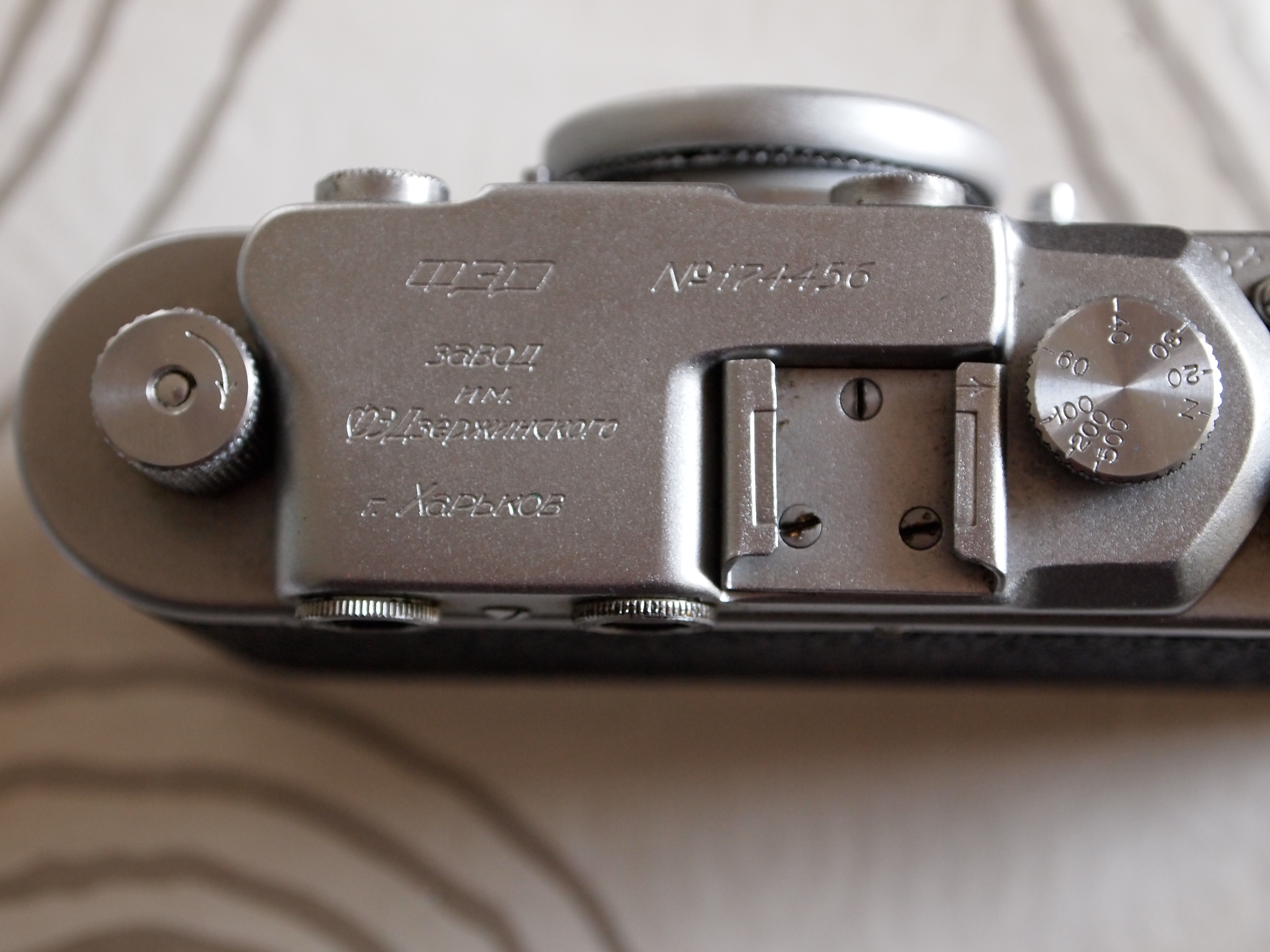

Usually I don't buy compilation of cameras. But this time I made an exception.
This what in not on photos is lens number: 15541.
Interesting camera, insn't it ?

Posted - Apr 07 2016 :  4:26:02 PM  Show Profile  Visit Vlad's Homepage  Reply with Quote
It looks like a regular FED 1e just has a strange speed dial that does look like it's from FED-Zorki...
2669 Posts
Posted - Apr 08 2016 :  03:19:28 AM  Show Profile  Reply with Quote
A very interesting camera, for sure!
The mechanism certainly belongs to a Zorki, with that crisp paint and the shape of the lock. Idem for the frame counter. The speed dial is a Fed-Zorki's, as Vlad said.
The cover is strange. At first sight, it's a good old Fed 1e's. But I wonder: the chrome is really very smooth. The serial number is regular for a 1e, but the ciphers are really smaller than the original ones.
So, an exciting camera, Alfa!
BTW: what's the shape of the rangefinder? Fed's or Zorki's?

Posted - Apr 08 2016 :  06:17:57 AM  Show Profile  Reply with Quote
Seems to be a Zorki-1b with a re-engraved top plate. The serial number should be much wider. The vulcanite could be Zorki too.
I'm sure you would prefer a real Fed-1e. But still, the engraving looks really nice, maybe even better than the real one.

Alfa2
Poland
349 Posts
Posted - Apr 10 2016 :  2:11:53 PM  Show Profile  Reply with Quote
I haven't removed top plate but I have 2 new photos which may answer some questions.
On 2nd photo:
- on top Zorki No. 10321
- bottom our strange FED
On my eye, strange FED looks like FED-Zorki but upper plate is replaced with this strange one, bottom plate is replaced with plate from FED (engravings tells it is from FED), lens in from early FED NKVD.
Edited by - Alfa2 on Apr 10 2016 2:13:08 PM
2669 Posts
Posted - Apr 11 2016 :  10:38:42 AM  Show Profile  Reply with Quote
Fine Zorki 1a/1b, s/n 10321...
About your "special" Fed 1e, it's difficult to say. The base of the camera could be a 1a/1b, with the crisp paint, the four nut bolts (to regulate the shutters) and the speed dial.
As for the release button, there is a gradual changing between s/n 9000 and 10600. Always Fed-Zorki type before, Zorki one after, and mixed between the two. As far as I know! Yours is a Zorki one.
For the cover, nothing is clear. The chrome is finer than a Fed 1e's. The general shape is correct, and the engraving too, except for the number. If it's good for a 1e, the ciphers are too small and not in a correct position. For example, have a look at http://ussrphoto.com/Wiki/default.asp?WikiCatID=98&ParentID=1&ContentID=962&Item=FED+1d . It's a 1d, but the ciphers are the same on a 1e.
I think of a Zorki 1a/1b, with a correct Fed 1e cover which could have been rechromed and engraved with the actual serial number. A training at KMZ's? Who knows...

Posted - Apr 12 2016 :  07:51:53 AM  Show Profile  Reply with Quote
The top plate is from a much later camera. It can be seen on the left side of the plate, earlier plates doesn't have this shape.
These comparison photos side by side are really helpful. It can be seen that the top plate of the 'Fed' is so flat on the top while the Zorki is much more round and doesn't have these edges.
But still, I like the engraving as a Fed-1e and it looks good with this type of chrome.
2669 Posts
Posted - Apr 12 2016 :  10:25:09 AM  Show Profile  Reply with Quote
No doubt, Lenny, you are right: the cover was completely reingraved. There are some very tiny details in the lettering which are different from a genuine 1e, when looked with a magnifyer.
So, I fear you have a Zorki 1a/1b without any Fed part, Alfa. Unless the baseplate which you speak of?

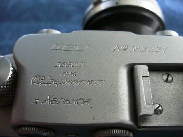

2669 Posts
Posted - Apr 13 2016 :  11:08:06 AM  Show Profile  Reply with Quote
Here is a photo of a cover.
http://www.ussrphoto.com/UserContent/1342016_DSCF2359.JPG
I let you make comparisons. Just have a special look at the "B" (= V).

Posted - Apr 14 2016 :  03:08:18 AM  Show Profile  Reply with Quote
Thank You very much.
You are absolutely right. Top plate of my "Fed" is a fake.
And many thanks for photo of top plate of FED 183231. It is really interesting especaily this "B".

Interesting serial #183231, Jacques. According to Princelle, Fed started evacuating the factory on September 5th. We know the passport of #180024 made on 31/07/1941. Could #183231 still be produced in Kharkov? 3207 cameras within 5 weeks? That are 33333 cameras per year. We also know passport #136157 made on 20/08/1940. They produced over 44.000 cameras in the last 12 months. So #183231 should still be made in Kharkov. The question is if #183231 is real. The left side looks very round and it seems there is an edge in front of the shoe. I have doubts, hard to tell only from this photo.
2669 Posts
Posted - Apr 14 2016 :  10:11:38 AM  Show Profile  Reply with Quote
I have another question. Could you produce a photo of one of your 1e-s, taken with the same angle of view, to support your doubts?
If not, I stop there.

2669 Posts
Posted - Apr 18 2016 :  05:03:44 AM  Show Profile  Reply with Quote
We must be more cautious.
My two photos are from 1d-s. Here is an other of my S-s, in fact my earliest (an early 1c).
As you can see, it has an other system...
Last thing. I won't post any more about that question. If we are not wise enough, we will have soon heaps of S-s for sale on the net.
Edited by - Jacques M. on Apr 18 2016 05:04:58 AM

Hi all...
I think, as Lenny said, that each time we buy 1948 Fed/Zorki, we have the risk to buy a fake, especially on the web..
In fact, the problem is to fix at what price we consider getting cheated...
If price is more or less at regular Fed 1 B or C or NKVD price, I consider it is not a problem and I accept the risk.
These fakes are sometimes really nice and open new questions.. For instance, why my fake 1948 Fed Zorki came with (fake?)collapsible 1948 ZK???
