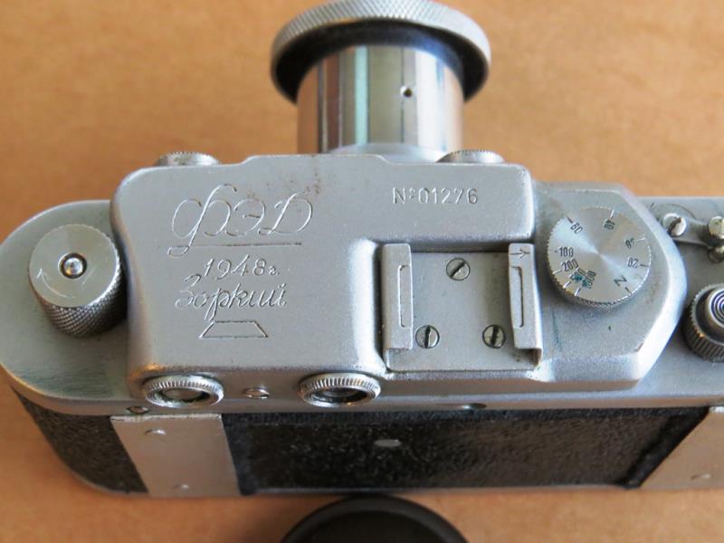

I have bought lately a Fed-Zorki (one more!) mainly because of its back (and secondly because I had a 1948 1,5/5cm ZK to put on).
Here it is:
http://www.ussrphoto.com/UserContent2/16122019_IMG_2445.JPG
First surprise: my ZK lens does not have the right position on it (infinity at 3 o'clock rather than 12). The mount seems in correct position. So, rather than turning the lensplate, I have put an Industar Moskva "tomb" which was waiting for a body too...

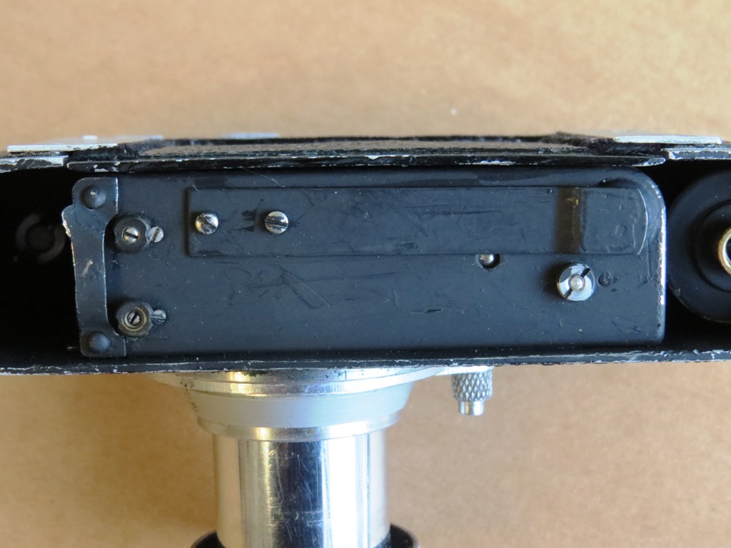

Here is the back:
http://www.ussrphoto.com/UserContent2/16122019_IMG_2447.JPG
It looks like a home made work, probably for a special work.
The back was partially cut, then replaced with foam to avoid any entry of light. The hole in the center is right in the middle of the film plate. Certainly a possibility to regulate the register. But for which type of work?

Jacques, can you slide the back down? Maybe it was made to make the film loading easier?
2679 Posts
Posted - Dec 19 2019 :  07:33:24 AM  Show Profile  Reply with Quote
No, Ulrich, I cannot slide the back. But I wonder if it was not re-fixed after the special use, just for selling.
I have tried to slip a film inside by the back: it's very difficult. There is not enough space for that. No doubt that the camera is not in working order.

So, I have taken to pieces this strange early Fed-Zorki.
As it can be foreseen, the back is removable. I did not want to force, and it is tightly mounted.

2679 Posts
Posted - Jan 09 2020 :  09:01:19 AM  Show Profile  Reply with Quote
The press film is directly rivetted to the back. So, no spring behind, and I have measured a register strictly at 28,8mm (there are important variations on pre-war Feds).
http://www.ussrphoto.com/UserContent2/912020_IMG_0011.JPG
A important correction is made on the lens plate which is thicker than usual.
