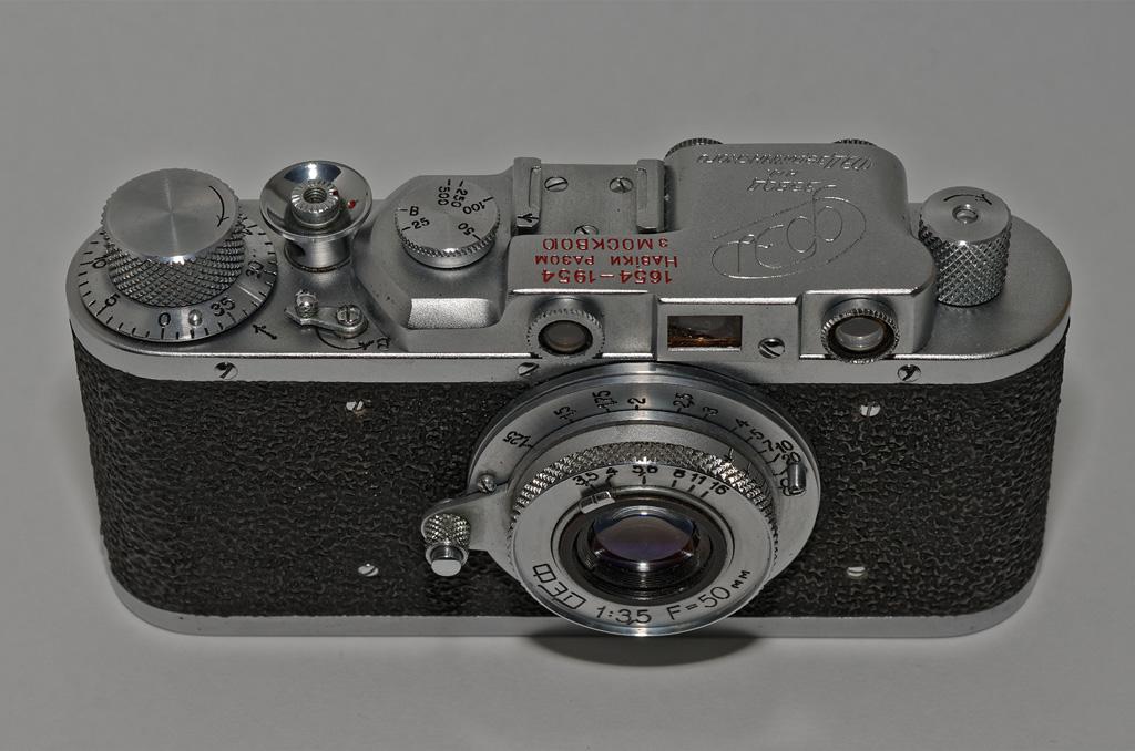

OK Jacques!
Here are some photographs of my camera, which I am quite sure is authentic, as upon close examination it can be seen that the camera's top rangefinder plate (and everything else) appears to be completely original and untouched, including original dirt, etc. Also it is only a few serial numbers away from the passport shown on the DVDTech site.
It will be interesting to see other serial numbers and photos of the engravings for comparison.

Thank you Bill! What I do like about having this camera is that the actual year on the engraving helps a lot on placing the serial number ranges of post-war FED 1 into context more precisely. Give you a good solid milestone within production, since all the serials are quite cryptic.
2669 Posts
Posted - Apr 21 2008 :  03:58:40 AM  Show Profile  Reply with Quote
Thanks a lot for your fine pictures, Bill! No need I buy a numerics if you are here!
I had forgotten my Pegorari's booklets. No doubt: my "anniversary" is a true one too, at least by the engravings. Princelle doesn't speak of this camera.
I'm going to look for the two or three sites where I saw such "anniversaries" with different engravings. It could help to compare!

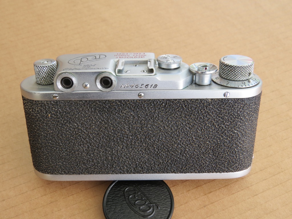

Jacques, could you provide pictures of your camera #465618?
It's in the earlier batch and it would be interesting if there are any differences in engraving.

Here are photos of my "anniversary", just made.
http://www.ussrphoto.com/UserContent2/442020_IMG_0062.JPG
http://www.ussrphoto.com/UserContent2/442020_IMG_0063.JPG
http://www.ussrphoto.com/UserContent2/442020_IMG_0065.JPG
I am curious to know if you will find differences between these two batches. When I bought this camera, years ago, I was a bit surprised too... Ask for more photos if necessary.

Thank you, Jacques!
The only difference is the black filling of the engraving on top and in the serial number.
It is also seen on #465569 owned by levonsa.
http://ussrcameras.ru/catalog/480
But #468456 also has black engravings and is in the second batch after mine so that's of no use.

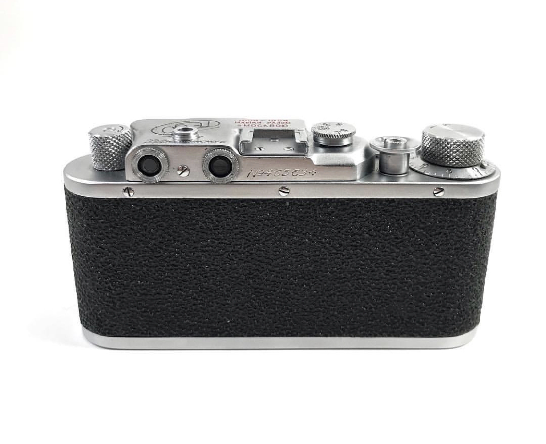

Interesting, Edgar!
It is now the latest known example of the first batch. Apart from the added flash sync it looks like the usual examples, I see nothing odd in the engraving.
Is this your camera?
If so could you please tell us the lens number?
2669 Posts
Posted - Jun 05 2020 :  11:22:27 AM  Show Profile  Reply with Quote
Thanks, Edgar!
Another camera, added in the wiki. Same first batch.
