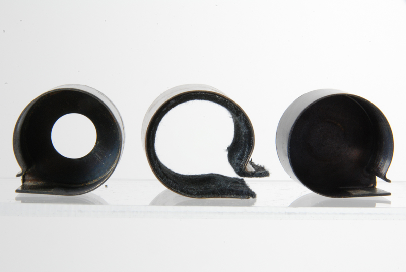

Posted - Oct 11 2007 : 10:55:05 AM Gerard,
Here are the images, let me know if you need any more angles.
The dimensions of the cassette are:
Height: 38mm Diameter: 25mm Diameter if you go from one end to the tip of the film opening: 30mm
Sorry for overexposure, did these quick and dirty, had not time to calibrate the light.
Vlad |

If you are going to use the heavy card stock for the housing of the cassette, that may work, I would sure it's black though so it's lightproof.. If you would like I can take detailed pictures of the real FT-2 cassette from my own FT-2 and post them here in high resolution. Let me know if that will help you, I will gladly do it for you.
Vlad. |
