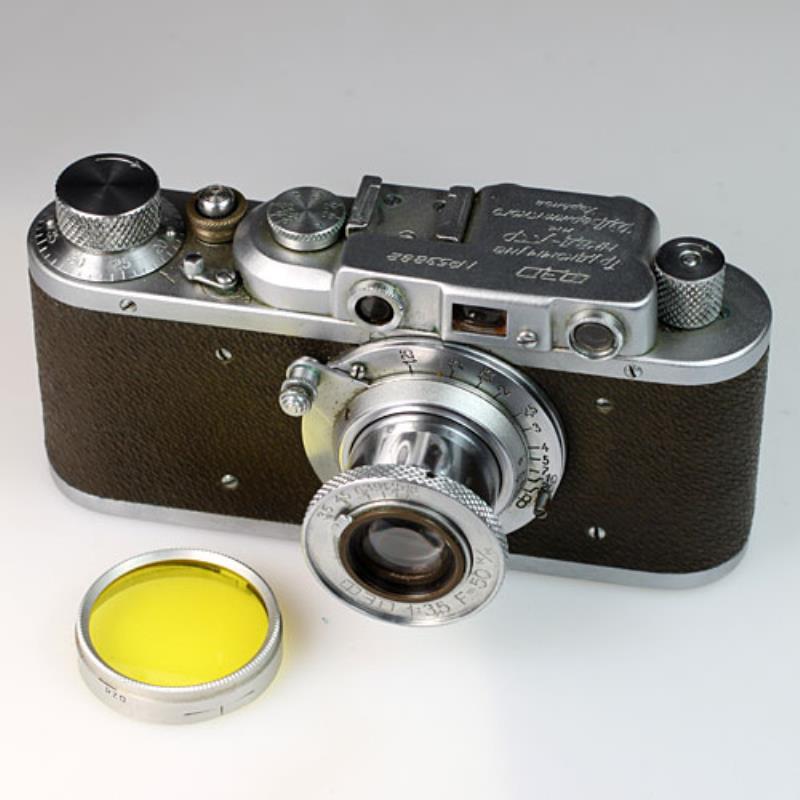

Here is another one I found in my records. FED No53882 + 50/3.5 60533 with "mushroom" button
http://www.ussrphoto.com/UserContent/3102016_163-fed0.jpg
There is a pattern emerging.
Cheers
Geoff
Edited by - geoffox23 on Oct 03 2016 6:13:15 PM
