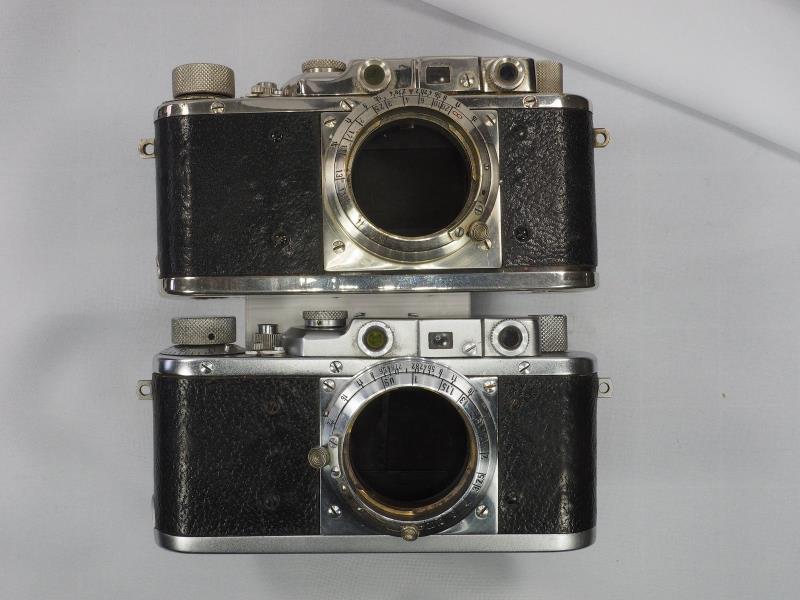

Here are some pictures of the both oldies ...
The metal version:
http://www.ussrphoto.com/UserContent/12122016_PC110411.JPG
Edited by - Mosasaurus2 on Dec 19 2016 07:43:52 AM

Posted - Dec 12 2016 :  4:16:42 PM  Show Profile  Reply with Quote
The chromed version:
http://www.ussrphoto.com/UserContent/12122016_PC110414.JPG
Edited by - Mosasaurus2 on Dec 19 2016 07:43:11 AM

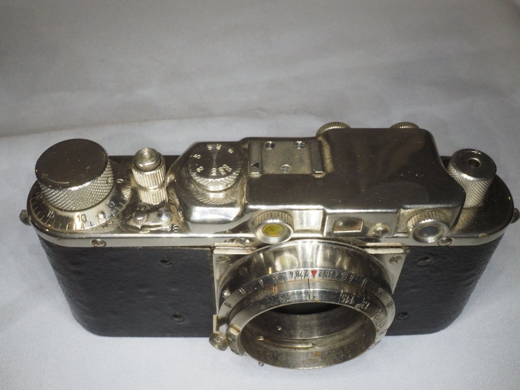

Posted - Dec 12 2016 :  4:17:57 PM  Show Profile  Reply with Quote
Beneath the metal version:
http://www.ussrphoto.com/UserContent/12122016_PC110409.JPG
Edited by - Mosasaurus2 on Dec 19 2016 07:44:34 AM

Posted - Dec 12 2016 :  4:18:51 PM  Show Profile  Reply with Quote
Metal version above:
http://www.ussrphoto.com/UserContent/12122016_PC110419.JPG
Edited by - Mosasaurus2 on Dec 19 2016 07:42:03 AM

Posted - Dec 12 2016 :  5:12:10 PM  Show Profile  Visit Vlad's Homepage  Reply with Quote
Thank you Ad!
At first glance these do look like legit TSVVS (or VTS-VS) cameras with smaller rangefinder and viewfinder windows than FEDs. This is quite interesting as you have found them together in Germany, as one of the running theories here by Alexey Nikitin (levonsa) is that they were made in East-German factory by special Soviet order. I would like to get some other's opinions as well, but these seem like genuine articles to me (considering all TSVVS are gunuine) - another theory that the whole series is an elaborate line of fakes made by very skilled technicians in Poland..
I personally more inclined towards Alexey's story.

Welcome here, Ad.
I had seen your question on RFF. And frankly, it's not easy to answer. Probably we could share the discussion and examine your two cameras separately...
There are many special features on TSVVS-s. I only take four of them.
- the weight. The body and the bottom are made of brass, so they are heavier than Feds. To compare: 572g for body + bottom, 52g for bottom only. For a Fed: 366g and 43g in the same conditions.
- the internal number, stamped on the bottom (internal face), bottom of the shutter box, and internal face of the belt, under the press film.
- the finder. The front window is smaller than Feds', and it is in the middle of the front rectangle.
- the dimensions, lightly bigger than Feds, so that a Fed shoe cannot be mounted on a TSVVS.
There are curious features on your cameras, and I wonder if they were not made from TSVVS parts, completed with other ones... Anyway, you should buy a 1d to compare closely, Ad...
Of course OK about the possible German origin of the TSVVS. I remind that some Jena Contaxes have the same internal engraved numbers as TSVVS-s. And brass made bodies!
PS: I should be deceived that this discussion would end by a sale, as it was several times the case not long ago.
Edited by - Jacques M. on Dec 14 2016 07:36:02 AM

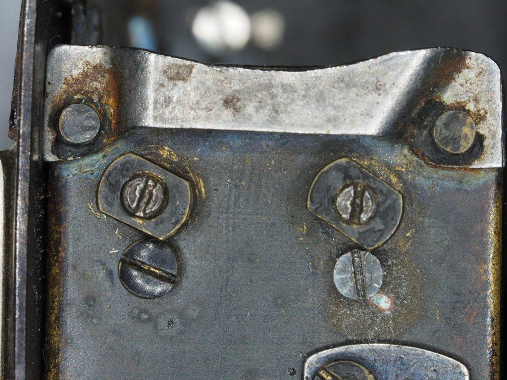

http://www.ussrphoto.com/UserContent/14122016_PC140465.JPG

2667 Posts
Posted - Dec 14 2016 :  10:30:00 AM  Show Profile  Reply with Quote
OK. The springs are TSVVS ones.
Fed's are flat:
http://www.ussrphoto.com/UserContent/14122016_DSCF2284.JPG
Sure Vlad will post here the article when he has found it.

Picture 10:19:47, camera with rivets. The "17" is on the right, between the right extremity of the spring and the screw...
Ad van Hout
Mosasaurus2
Netherlands
31 Posts
Posted - Dec 14 2016 :  4:20:10 PM  Show Profile  Reply with Quote
Hello Jacques,
A "2"????? (Chromed version.)
http://www.ussrphoto.com/UserContent/14122016_PC140479.JPG
Edited by - Mosasaurus2 on Dec 19 2016 07:32:50 AM
2667 Posts
Posted - Dec 15 2016 :  03:57:14 AM  Show Profile  Reply with Quote
OK, I have dreamt.
It would have been interesting: it's at this right place that there is a stamped number (at least on my "264").
I have nothing more to add now. You can see that there are vey light differences between these two backs of shutter box. More generally speaking, I always think that your cameras are pre or post run TSVVS.
The lens is most interesting too. It belongs to a series of 10 (only !!) Tessars delivered the 14/06/1951, by Thiele. It's the last series of this lens produced by CZJ. And the only one to be written "50mm", not "5cm". The date is interesting in itself: it could lead to a post series for the cameras.

On the picture of the bottom plate (12 december (4:18:51) I can see a number: "1", I suppose. This is confusing... (Should be "2".) Below a detail/close up.
Ad
http://www.ussrphoto.com/UserContent/15122016_PC150485.JPG
Edited by - Mosasaurus2 on Dec 15 2016 3:33:03 PM

2667 Posts
Posted - Dec 15 2016 :  4:06:51 PM  Show Profile  Reply with Quote
I don't know if your "1" can be considered as an original cipher: impossible to say, only by a photo. It depends on the depth of engraving and the dimension of the cipher... And it would be necessary to compare the position of the numbers on all the TSVVS we know: are these numbers always put in the same place?
TSVVS are rare cameras (probably 1000 samples), so they are not completely known. Already for the running production! As for your couple...

At your request: 2 pictures of the camera's. Above the chromed version. It's difficult to make a picture of the chromed version: strange reflections all over.
http://www.ussrphoto.com/UserContent/19122016_PC190496.JPG
http://www.ussrphoto.com/UserContent/19122016_PC190500.JPG

2667 Posts
Posted - Dec 19 2016 :  09:08:24 AM  Show Profile  Reply with Quote
Thanks for the new photos, Ad.
Looking at them, it seems that:
On the above version, the strap lugs are lower than on ordinary TSVVS-s,
On the other one (below), it's the middle screw which is not on its common place. And the rectangular finder ir not exactly centered.
This last remark is important, as most fakes have a wrong rectangular window, too large, because of a cover borrowed to Fed 1 (I have not said that your camera is a fake!).
Now, concerning the classification adopted by sovietcams, I don't see why these non engraved TSVVS should necessarily be pre serie cameras. But the shape of the cover, they should rather be intermediate prototypes or post series. I ask Aidas about it. Certainly he will answer!
Alexander: I cannot see if you have screws or rivets to fix the lock of the bottom on your camera? It seems there are inside numbers stamped?
Edited by - Jacques M. on Dec 19 2016 09:19:18 AM

Ad van Hout
Mosasaurus2
Netherlands
31 Posts
Posted - Dec 19 2016 :  10:08:35 AM  Show Profile  Reply with Quote
Hello Jacques,
About the place of the 2 screws: I noticed that. (And mentioned it in my "P.S." of my first post.
The rectangle of the viewfinder: the finder of the metal version is somewhat better. Perhaps because of the chroming process, the other is not so straight...?
Ad
Edited by - Mosasaurus2 on Dec 19 2016 10:14:23 AM
2667 Posts
Posted - Dec 19 2016 :  10:39:54 AM  Show Profile  Reply with Quote
No, Ad, it's a question of position: the rectangle does not seem well centered: probably too low.
To compare with the windows on my two TSVVS which seem correctly centered:
http://www.ussrphoto.com/UserContent/19122016_TSVVS 005.jpg
That said, I may be wrong: it's perhaps the photo...

Ilya Stolyar
ilyast
67 Posts
Posted - Dec 19 2016 :  6:27:19 PM  Show Profile  Reply with Quote
http://www.ussrphoto.com/UserContent/19122016__DSC8022.jpg
http://www.ussrphoto.com/UserContent/19122016__DSC8028.jpg

2667 Posts
Posted - Dec 20 2016 :  04:37:31 AM  Show Profile  Reply with Quote
I think too, Juhani.
What a strange mount for your Tessar, Ilya! Where does it come from? Could you tell the s/n of the lens? The release spring seems a bit special, with its three screws. Well, so, a "no name" more! Finally, they are not so rare! Always no internal number?
Thanks! Jacques.
Edited by - Jacques M. on Dec 20 2016 07:54:09 AM
Ilya Stolyar
ilyast
67 Posts
Posted - Dec 20 2016 :  09:21:58 AM  Show Profile  Reply with Quote
http://www.ussrphoto.com/UserContent/20122016__DSC8024.jpg
2667 Posts
Posted - Dec 20 2016 :  12:01:11 PM  Show Profile  Reply with Quote
Thanks, Ilya.
By its number, this Tessar belongs to a series with Exakta mount, delivered the 13/07/48, by the Thiele. OK for the date. But not really understandable for the mount...
And it seems that the regular engravings on the upper plate don't exist on Ilya's camera: no arrow towards the counter frame (just a point), idem for the arrow and the "B" under the rewind lever... just like one of Ad's cameras.
Our enquiry is not finished...
