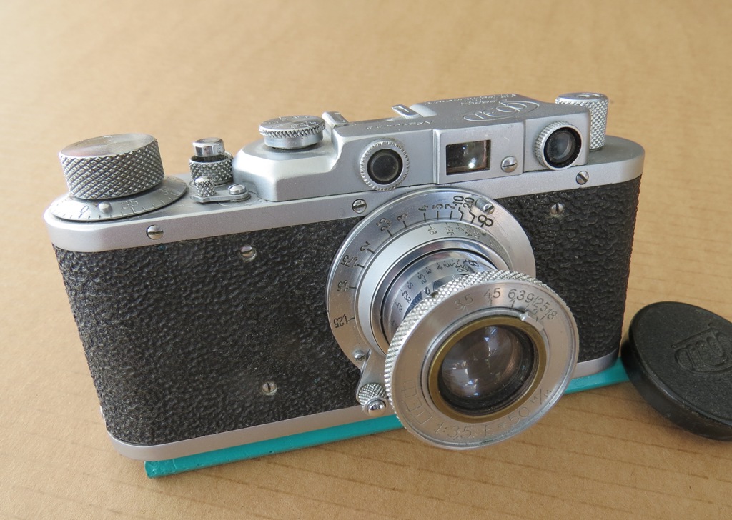

First one, the 1e.
A well known camera, now. As we have already said in other threads, they were still made in Kharkov before the evacuation in september 1941. Here is an ordinary 1e:
http://www.ussrphoto.com/UserContent2/592021_IMG_0405.JPG
http://www.ussrphoto.com/UserContent2/592021_IMG_0406.JPG
Not completely ordinary, in fact : a 1,5/5cm Sonnar was adapted to a Fed mount. In fact, it seems that Fed missed lenses, and it's not the only 1e to have an "exotic" lens.

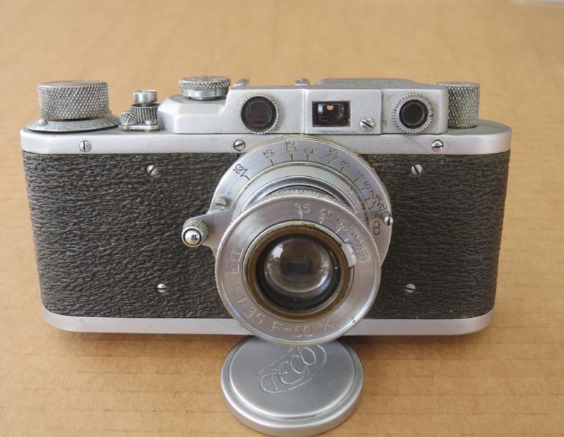

Last item: the early Fed 1f s/n 210112.
http://www.ussrphoto.com/UserContent2/592021_IMG_0424.JPG
http://www.ussrphoto.com/UserContent2/592021_IMG_0425.JPG
Nothing special, except of course the circled release button which reminds the 1c to 1e series. Very fast, the 1f release buttons will be soft on the 1f.

What to conclude? Certainly nothing! All that was just to discuss a bit.
The question of vulcanite, for example, is very interesting and suggests that there were communications between Berdsk (1e) and Kharkhov (1f).
The variability of some 1e, with parts not yet existing in 1941, could denote a post 1941 montage.
The nuts made in non painted brass (or only blackened) on the Arsenal, the Red Flag and the very early 1f lets think of a sort of "permeability" between the different spots where Fed parts could be found (and made).
Fourth question (for me, I'll stop there!): I am puzzled by the number of old parts (possibly coming from 1a/early 1b) on the known Fed Arsenal. But I know: its existence is contested!
PS: if necessary, I can add other parameters and other cameras to the comparison.

I should have proposed a short comparison with an early, but ordinary Fed 1f too.
Here are some photos of the s/n 210455.
http://www.ussrphoto.com/UserContent2/1192021_IMG_0429.JPG
http://www.ussrphoto.com/UserContent2/1192021_IMG_0430.JPG
The visible change is the release button: circled on the others, soft on this one.
