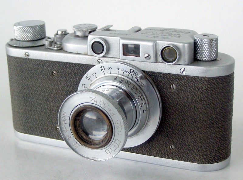

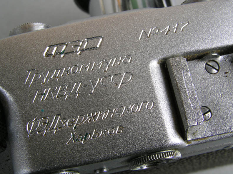

I have seen this many times and even have two examples myself. I have consulted with others about this as well.
There seem to be at least two or three schools of thought, although everyone seems to agree that these cameras are FED-1B cameras.
Some think that these cameras are mis-numbered, with the last digit being left off by the person who engraved the numbers.
Others have ideas that there may have either been another small FED factory (in the Lesopark district of Kharkov) where a separate group of cameras were made and numbered separately (but for what reason).
One other thing I have though is that possibly, during this period, when an owner of an earlier FED went to have it fixed by FED, they just gave the owner a new FED and engraved the old number on it.
The two cameras I own are identical to yours as far as all features and the serial numbers are No.3631 and No.417. As well, I have a photo of a passport (from a Russian collector in Kharkov) dated 1936 with camera No.3504. Below are some photos.
I think that these cameras are not just "mis-numbered", but I don't know the real reason or answer. I think it would be good to have a catalog entry for them, with a list of serial numbers. It could be called "FED-1B- Unusual Numbers". Maybe someday we will find a good explanation.

Bill's camera No.3631
Bill's camera No.417
Bill's cameras - front views

Posted - Feb 25 2008 :  12:55:37 PM  Show Profile  Visit nightphoto's Homepage  Reply with Quote
It seems that these uniquely numbered cameras are all of the same type and time and date between 1936 and 1939, approximately, and so must represent a specific practice at FED during those years. Probably not, just mis-numbering, in my opinion.
And, why would a camera that was being repaired and so had the old number engraved on a new camera, come with a new passport? These cameras all have the same style vulcanite and other features of a 1936 - 1939 camera and none of the features of the earlier FED-1A which you would think would be the case if they were just repaired.
Maybe there was some practice at FED during these years just to just replace a broken camera and issue a new passport with the old number on the passport and the camera.
Or, one other idea I have had is that they may have been of some military issued series, as when you look at the front of the passport that I pictured in my post above, the "FED" logo seems different than what I have seen before and also includes a "hammer and sickle" and a "star", symbols of the Soviet military. I have not seen this before.
The Russian collectors from Kharkov that I once talked to said there was a separate additional production facility of FED at Lesopark, which has a somewhat unique history with the Soviet military also.

Bill Parkinson
nightphoto
1027 Posts
Posted - Aug 02 2008 :  5:42:50 PM  Show Profile  Visit nightphoto's Homepage  Reply with Quote
Vlad,
I don't mean they would re-engrave an old camera. I think if you brought in your broken FED (say FED number 417), instead of repairing the camera, they would tell you to come back in two days, or whatever, and when you came back you would be given a new FED with the old number on it. So, rather than repairing your original camera, they would just replace it. To do this they would take a camera that had not be engraved on top yet, tell the engraver the proper number that they need, he would do it, a passport with the old number but new and proper date would be put with it, and then it would be brought to the "customer service office" where it would be given to the customer when they came back.
Actually, I don't take the different duties of the NKVD stereotypically. I have read about the organization and it's many changes in organization and specific duties. The fact is that the FED commune was under control of the NKVD. In 1934 the functions of the State Police were transferred to the NKVD. Engraving "NKVD" appears on top plates of FED in early 1935. In 1935 Makarenko is transferred away from the FED Commune. In 1936 750 new members are added to the Commune, and backed up by 400 outside workers. Also in 1937 Labor Communes were abolished. In 1939 FED becomes a Kombinat (so not a commune any longer ... now a combine factory). So many changes and no doubt that the NKVD was in control of FED to a large extent. Whether things were made at FED that were for the NKVD, internal police, or national security related activities, I have not heard of anything and have no opinion, but of course would not rule it out since they were under NKVD.
As far as the buildings in Lesopark ... although I don't have the photos anymore, I will try to get them. They did show old "FED" signs on them and were obviously part of the FED operation in some way. They did not look at all like post-War buildings, and evidently they had a small train tracks running some miles from the main FED factory to the Lesopark buildings. But I don't know what they were used for. In any case, these buildings may have been abandoned at least by FED shortly after, during the war, but they did not look big like the FED Commune Building pictured on page 89 and 91 of Princelle.
So, these cameras did come from that time of large growth and many organizational and production changes. My sources are Oscar Fricke, Princelle, translation of the FED site history, and the things that this man living in Kharkov told me and showed the photos of, which is of course anecdotal.
Still one big question I have is where the original FED Communune and it's building was located in Kharkov. I cannot find that information anywhere. Was it always "Lesopark 27" ?
Bill Parkinson
