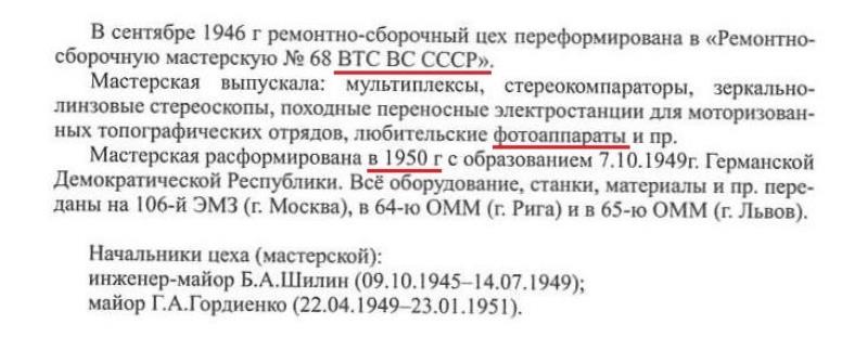

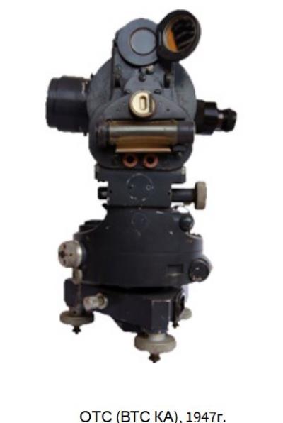

Coming back to this... So many years had passed, so many things learned about Soviet cameras and still VTS-VS (aka TSVVS) information eluded us until I ran into this document in the vast spaces of VKontake social network posted by a collector only known as "Kot":
/UserContent2/2212020_MyuR55yEZ7M.jpg
http://www.ussrphoto.com/UserContent2/2212020_MyuR55yEZ7M.jpg
/UserContent2/2212020_dLmBRxHbTos.jpg
http://www.ussrphoto.com/UserContent2/2212020_dLmBRxHbTos.jpg
/UserContent2/2212020_W8CLihiKws8.jpg
http://www.ussrphoto.com/UserContent2/2212020_W8CLihiKws8.jpg
Cover:
Topographical Service
Armed Forces of Russian Federation
E.I. Dolgov, S.V. Sergeev
History of Division of Topographical Service
Moscow 2012

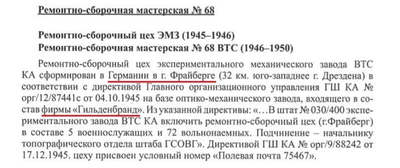

Excerpt 1:
Service and assembly workshop #64
Service and Assembly floor EMZ (??) 1945-1946
Service and assemebly workshop #68 VTS 1946-1950
Service and assembly floor or experimental mechanical factory VTS-KA was formed in Germany in city of Fraiberg (32 km south-west of Dresden) in accordance to directive of Main organizing directorate of GSH-KA (??) #/org/12/87441c from 04/10/1945 on the basis of optical-mechanical factory which was part of concern "Hildenbrandt". From the aformentioned directive: "..into the contingent #30/400 of experimental factory VTS KA inlcude service-assembly floor (city of Fraiberg) consisting of 5 military and 72 civilian personnel. All to be reported to the head of topographical division of GSOVG headquarters". With the directive GSH KA # org/9/88242 on 17/12/1945 this assembly floor has been designated as "Field post 75467".
Excerpt 2
In September 1945 the service-assembly floor was reorganized into "Service assembly workshop #68 VTS BC USSR".
The workshop had manufactured: multiplexes, stereo periscopes (?), stereo mirror scopes, portable power plants for motorized topographical forces, amateur photo cameras and other.
The workshop was disbanded in 1950 with the formation of 7/10/1949 German Democratic Republic. All the manufacturing equipment and materials were transported to factories #106 EMZ (Moscow), 64 OMM(Riga) and 65 OMM (Lvov).
Heads of workshop and floor:
Engineer-Major B.A. Shilin (9/10/1945-14/07/1949)
Major G.A. Gordienko (22/04/1949-23/01/1951)

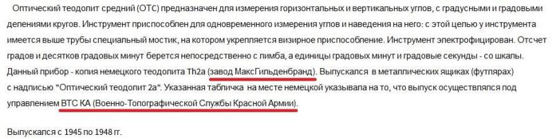

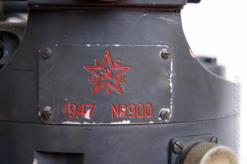

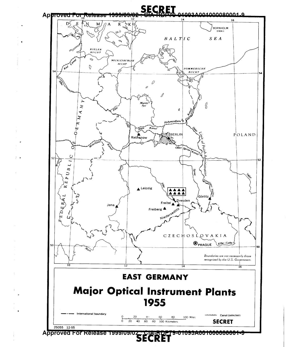

Quite a handful of information confirming the rumors of German manufacture of VTS-VS (aka TSVVS).
Replied on: 20200122224817
Wow!
And Freiberg links to Pentacon...

Replied on: 20200123153633
Great work finding that document Vlad! Finally some detailed information that is believable about TSVVS. Thank you and Hello to all!

I wait for this moment, like you all![:D]
Thanks to Vlad to have found this doc, and delighted to have seen Bill's sign!

Enzo,
to be honest, it only "confirms the rumors" about German origin that were going around in the past, and it made me question things now, because in the recent years I've been of the opinion that this entire camera production is fake made in Ukraine for collectors market, made by very skilled people in post-soviet factory conditions (same ones who possibly made FED-Sport, Zorki-75, Zorki-250, FED Stemar, etc) as I'm yet to see any accompanying documentation. Also the fact that I haven't seen a single VTS-VS camera in bad condition and they all work so smoothly like new (cameras from 1940s, even German ones usually have issues with deteriorating lubrication, yet to see an aged version of it).
So I agree with you, this doesn't completely prove anything, just made me stop and think.. I am also skeptical about the "2012" dating of this document, this could've been written knowing that these cameras already exist.. so yes.. definitely more information than we had before, but I still want to see a manual or a box for this camera...

Also since this is a fairly recent document with authors listed, maybe it's possible to track down the authors for more information.
Reply author: schyter
Replied on: 20200124110419
<br />Also since this is a fairly recent document with authors listed, maybe it's possible to track down the authors for more information.
The two authors of the 2012 document (E.I. Dolgov, S.V. Sergeev) are officers of the Russian Armed Forces (reservists) and have written several books on the history of the topographical service of the last 200 years.
https://www.worldcat.org/title/istoriia-chastei-topograficheskoi-sluzhby/oclc/1005514753&referer=brief_results

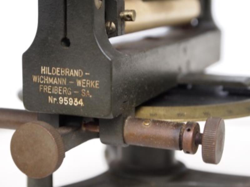

There was a factory Max Hildebrand in Freiberg/Sa. The factory was dismantled in 1945 to 1948
/UserContent2/2612020_NivelliergeraetTheodolit_Hildebrand_WichmannP1010591.jpg
http://www.ussrphoto.com/UserContent2/2612020_NivelliergeraetTheodolit_Hildebrand_WichmannP1010591.jpg
Reply author: Detlev

Replied on: 20200127103656

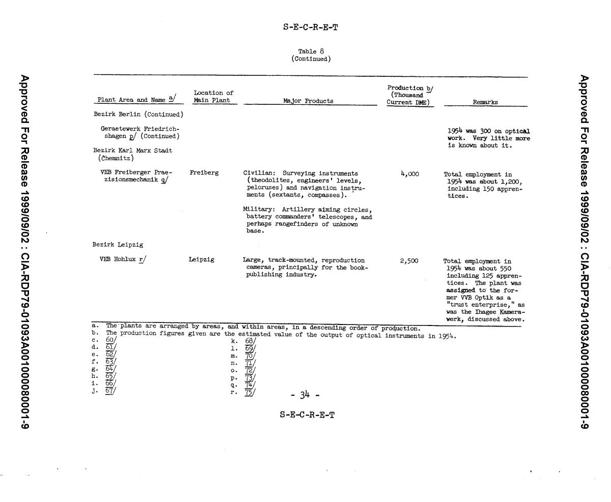

Sometimes Freiberg and Freital have been confused
/UserContent2/2712020_CIA.jpg
http://www.ussrphoto.com/UserContent2/2712020_CIA.jpg
/UserContent2/2712020_CIA2.jpg
http://www.ussrphoto.com/UserContent2/2712020_CIA2.jpg
Replied on: 20200127110238
Thank you Detlev!
Very interesting info! Seems like CIA had no information regarding cameras...
Replied on: 20200127112111

No it's definitely Freiberg. From the same poster "Kot" on VK, it says that this theodolite is a copy of German theodolite Th2a (Max Hilderberandt factory),
and in 1945 in the Freiberg in MaxHildenbrandt factory there is a VTS workshop that started to make this same Th2a with VTS-VS markigns and later under Soivet name of OTS-62 (VTS) after move of the VTS workshop to Baltics.
/UserContent2/2712020_UOCFZsJsUoA.jpg
http://www.ussrphoto.com/UserContent2/2712020_UOCFZsJsUoA.jpg
/UserContent2/2712020_aiwcqFtK79g.jpg
http://www.ussrphoto.com/UserContent2/2712020_aiwcqFtK79g.jpg
/UserContent2/2712020_z850IJUE5UI.jpg
http://www.ussrphoto.com/UserContent2/2712020_z850IJUE5UI.jpg
/UserContent2/2712020_8fwIvhupD4w.jpg
http://www.ussrphoto.com/UserContent2/2712020_8fwIvhupD4w.jpg

Replied on: 20200127113816
You are right, but the document doesn't mention a camera production in Freiberg.
Replied on: 20200127114455
Indeed. I just find the fact that so many cameras are know but NONE have any papers or boxes highly suspicious..
Thank you Detlev, the CIA document is most helpful!

The marking on the theodolite is different than the camera because of the "K". But the serial number uses the same designation "No." as the TSVVS where the earlier theodolites by Hildebrand use the "Nr." designation for the serial number.

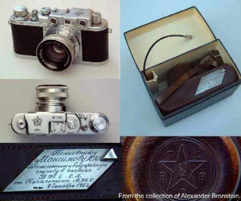

Maybe possible that there were no boxes made for this small edition of military cameras meant for officers of the USSR Topographical Service (or to whom and wherever they were distributed). Boxes are usually for civilian cameras as are manuals. Maybe there was no "passports" needed as they were produced in Germany but meant for Soviet military use.
Here is presented TSVVS with box(but i'm not sure that box is original):
http://yelphimoff.narod.ru/bronshtein/RusCamera.htm
Unfortunatelly, can't find original site of Alexander Bronstein...
http://xalmaz.narod.ru
Replied on: 20200130104917
Thank you xalmaz, I am in contact with him, will ask for more information.

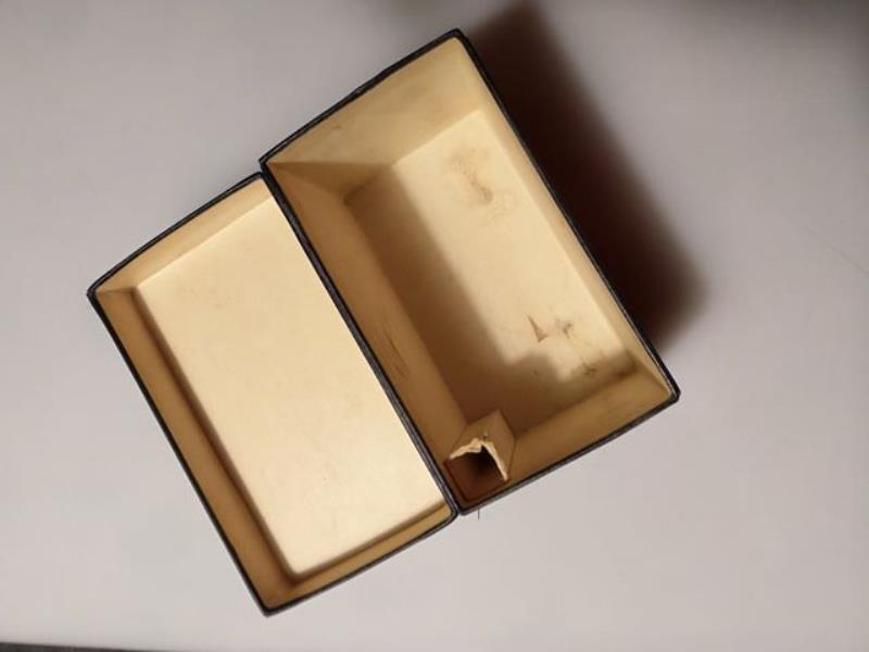

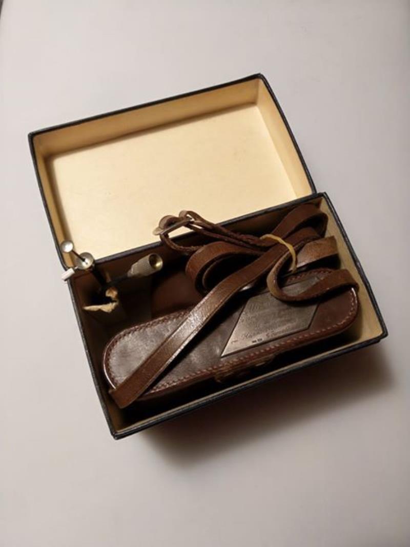

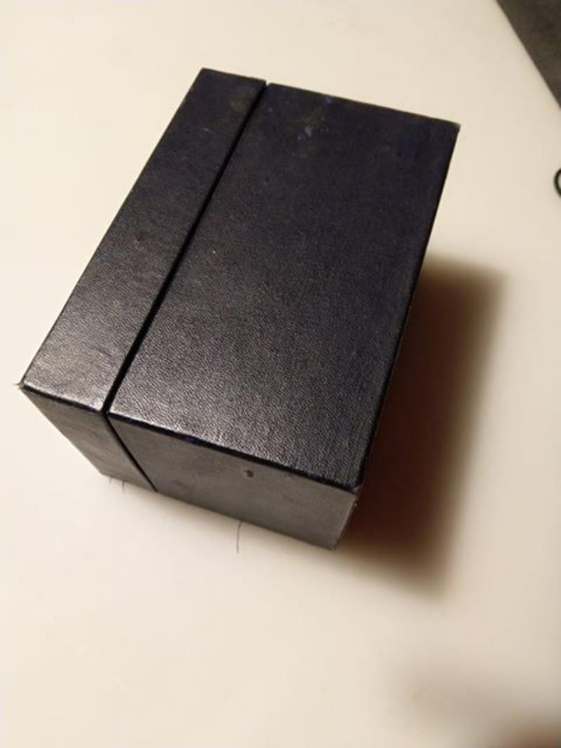

Replied on: 20200130114928
Alexander Bronstein has kindly provided me with more detailed photos of that camera box. It is quite plain...
/UserContent2/3012020_83198860_2543204285923546_5280322640123265024_n.jpg
http://www.ussrphoto.com/UserContent2/3012020_83198860_2543204285923546_5280322640123265024_n.jpg
/UserContent2/3012020_84137376_794603631012123_859831823931277312_n.jpg
http://www.ussrphoto.com/UserContent2/3012020_84137376_794603631012123_859831823931277312_n.jpg
/UserContent2/3012020_84433982_179889856724635_5151127245015744512_n.jpg
http://www.ussrphoto.com/UserContent2/3012020_84433982_179889856724635_5151127245015744512_n.jpg
/UserContent2/3012020_83101564_2567392373495093_4336284705293860864_n.jpg
http://www.ussrphoto.com/UserContent2/3012020_83101564_2567392373495093_4336284705293860864_n.jpg

Replied on: 20200131150027
The plaque is interesting. Can somebody translate what is written? I see 1957 as an anniversary date (?): probably late if it's the case...
The cable release with its special case inside the box is interesting too. A pity we don't know more about it.
Replied on: 20200131150658
Here's a better photo.
It says:
"To Colonel Maximov L.K. for many years of excellence in service in detachment of VTS SA (Military Topography Service of Soviet Army) from head of VTS, December 9 1957".
/UserContent2/3112020_84002721_160790025358946_8312377858118909952_n.jpg
http://www.ussrphoto.com/UserContent2/3112020_84002721_160790025358946_8312377858118909952_n.jpg
Replied on: 20200131152009
Thanks, Vlad.
