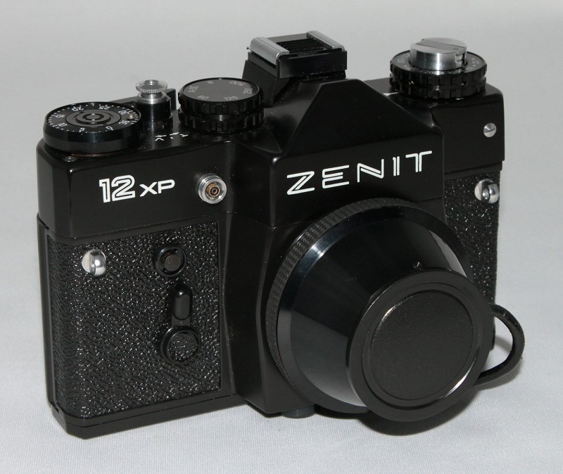

I recently aquired this Zenit-12XP with the bayonet and endoscope modification usually associated with the Zenit-11 in its MT-1 form. Do you think that this is a factory modification or has someone just modified it using MT-1 parts? The camera came as part of a MFN-10 microscope kit.

To me it looks like a mod.... In theory it's easy enough to do. I have an MT-1 and it's a matter of 4 screws to convert it from bayonet mount to m42. If I get time, I will see if I can fit the MT-1 mount to my 12xp, to see if it can be done, providing the screw holes line up it should be simple!!

Just a quick update I checked on the my MT-1 Surprise and 12XP and it is perfectly possible to fit the endoscope attachment and Industar lenses from thr MT-1 to the 12 XP. 2 minutes and a screwdriver will swap the m42 mount for the bayonet and they line up perfectly, so unless someone can find another 12 XP medical cmaera I reckon it's a modifiction from bits and pieces.

Many thanks Richard, you have confirmed what I suspected.

It's also a bit odd that it's the 12XP that was used and not the SD which was domestic model if it was the factory article.. nevertheless an interesting find, still very collectible.
