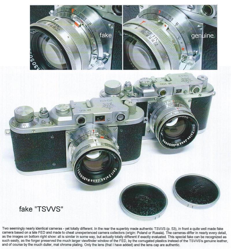

Replied on: 20140818085127
One in ebay right now:
http://www.ebay.com/itm/FED-TSVVS-Russian-Leica-Rangefinder-USSR-Army-Air-Force-COPY-camera-PERFECT-/281415924667?ssPageName=ADME:SS:SS:US:1120
Replied on: 20140818121009
Hi Juhani!
Yes... But the camera is not completely convincing: the viewfinder is a Fed's one and the body and the shutter box are made of alloy, not brass.
But the general quality of all that is amazing...
Replied on: 20140818142323
So it may be non-genuine TSVVS, and possibly staying at a price level which could be affordable [:D]
Reply author: Fred_L
Replied on: 20140818160615
The seller has noticed it is a TSVVS copy... Not an original...
Replied on: 20140818230728
Yes it's just a very good copy. Wrong lens from 1957, Fed viewfinder, gap between mount and top, wrong covering.
Replied on: 20140819005036
<blockquote id="quote"><font size="1" face="MS Trebuchet, Arial, Helvetica" id="quote">quote:<hr height="1" noshade id="quote"><i>Originally posted by Fred_L</i>
<br />The seller has noticed it is a TSVVS copy... Not an original...
Yes and no... The short confusing text can be understood both ways. It says "copy camera" and not "camera copy" or "TSVVS copy" or "replica" which would be best? Any way, I will be watching.
Replied on: 20140819010508
It's sold as a "copy", the seller consulted with me before listing it.
Replied on: 20140819032735
Really, I had not understand at first reading that the camera was declared as a copy.
Probably my English: sellers should beware of old foreign collectors and be more clear!
Anyway, it's a beautiful fake. The lensplate is particularly convincing.
PS: lens of 1937.
Replied on: 20140819085301
I can pass on to seller to adjust description. The lens is Jupiter-8M on it. If my memory serves me right prototype for Jupiter-8 was developed by GOI in 1948 and the later Jupiter-8M modification in 1957. That makes the lens 10 years later than camera.
Replied on: 20140819110723
About the lens, I see a 2/5cm Sonnar, non T and collapsible...
The serial number corresponds to the year 1937.
That time, it's not my English![;)]
Replied on: 20140820072659
Oh! It seems that have switched the lens out on it. I was shown this model with Jupiter 8m before the auction. It's a large collection so they may have found a lens to go with it.
Replied on: 20140820094555
hmm.. so I talked to the seller, it seems that the previous owner of the camera had switched the lens out and not the seller, because before it was tried to be auctioned off as a real TSVVS with Jupiter-8M. Looks like that lot was pulled from the auction because it wasn't a real one. And the collector whose camera the seller is selling must have bought it right after. The guys who are selling it just acquired a whole collection they are liquidating. Here's the previous auction: http://bid.igavelauctions.com/Bidding.taf?_function=detail&Auction_uid1=2967216
Replied on: 20140820203627
At least body cover or tube came from leica the curtain screws are not original and top cover have wider window
a "blended" fake!
Replied on: 20140822094339
This is from the brochure Dr. Milos Mladek had kindly sent me at some point. I hope he doesn't mind me posting it here, but it's very relevant. This seems to be exact same maker of the fake TSVVS:
http://www.ussrphoto.com/resize/resize_image.aspx?ImgWd=800&IptFl=/UserContent/2282014_FakeTSVVS.jpg
http://www.ussrphoto.com/UserContent/2282014_FakeTSVVS.jpg
