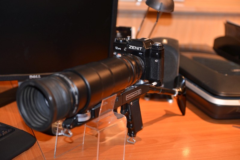

Hi August, I was able to successfully fit the 12XPS body onto a 12S lens and base with no problems and take some pictures. So it's pretty safe to say they're interchangeable.
http://www.ussrphoto.com/UserContent/362013_DSC_3358.JPG

I am happy. So a have no more problems, beginning with a Fotosnaiper FS-12 and a non-conectable Praktica MTL5.. I ordered the Zenit 12XPS-camera already.

the 12XPS body in a 12S set or vice versa can be coupled OK but exposure will be incorrect
But observe that thereare two XPS one with metalic top an another with plastic top. These are completely interchangeable

Here I am again with my little problem.
You are right, the exposure is incorrect with the Zenit 12XPS on my Fotosnaiper F-12.
