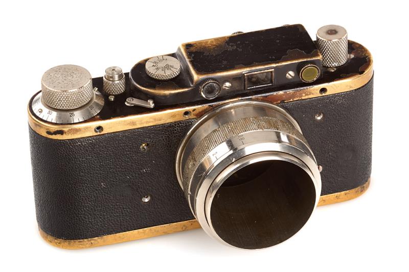

I have just bought this camera.
http://www.ussrphoto.com/resize/resize_image.aspx?ImgWd=800&IptFl=/UserContent/19112014_leica fake 1.jpg
http://www.ussrphoto.com/UserContent/19112014_leica fake 1.jpg
(Leicashop's photo)
Most of the fakes are made from Feds or Zorkis. I am not sure it is the case here...
The screws on the upper plate and on the front of the belt , the metallurgy of the cover, specially about the viewer, the shape and the vertical stripes of the buttons, all is different.
But what if not a Fed? The condition of the chrome means the camera is probably prewar (and that the chrome was not good!). Note that the serial number is at the beginning of the Leica II Couplex series (s/n 71200).
A mix of several parts? But coming from where? A trial? This camera remembers something to me, but what?

Hello Jacques!
It seems to be a japanese prewar câmera.
At same time due the rewind buttom the câmera seems to have a somewhat larger length . Please confirm.
The image finder constructiun apperas to be from the first Leotax Items perhaps.

See this interesting Neuca Prototype
http://collectiblend.com/Cameras/Neubert-Franz/Neuca-Prototype-(black).html

Several things surprise me:
- the rewind button is thick, as on a Leica 1 (A). So, a camera which would have been without rangefinder in a previous life?
- in that case, the cover will be less wide than a Fed's or a Leica 2's (which have narrow rewind buttons). I will check when I have it. And I will take all the measurements.
- the cover itself seems less high than a Fed's.
- the screws on the corners belong to Leica 1 (A) too.
- the 2 upper screws which maintain the shutter box are lower than on Feds or Leicas. So, the shutter box would be different from a Fed's.
Frankly, I had not thought of the Japanese track... I am going to study your link, Luiz. As for the Leicas IIf and IIIf, they are indeed a bit larger, but they have another metallurgy (and the cover is not detachable). The seller thinks it is a FSU production.
And of course, I will open it as soon as I have it, Lenny. Sure, it will answer some questions.
I go on seeking!

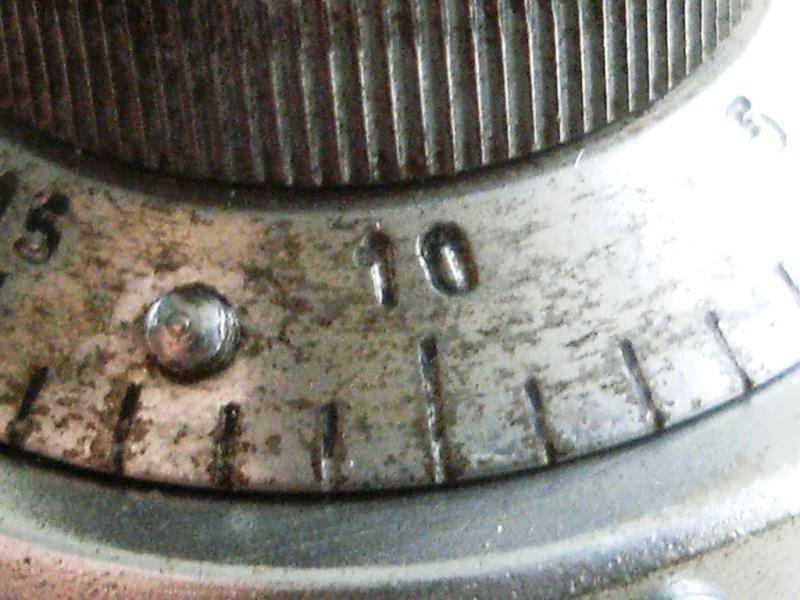

The camera which was desintegrating itself, as you say, could have been a Foca 2 stars. The first series were made in Zamac...
But this one is visibly made of chrome plated brass. Not very good: it remembers me the first trials of chromed Leica II, and the wartime IIIf...
You are right: the engraving on the frame counter and the speed dial are important too. The pins on the frame counter are between 10-15 and 30-35. Like the Fag! It's different on Leica/Zorki and Feds.

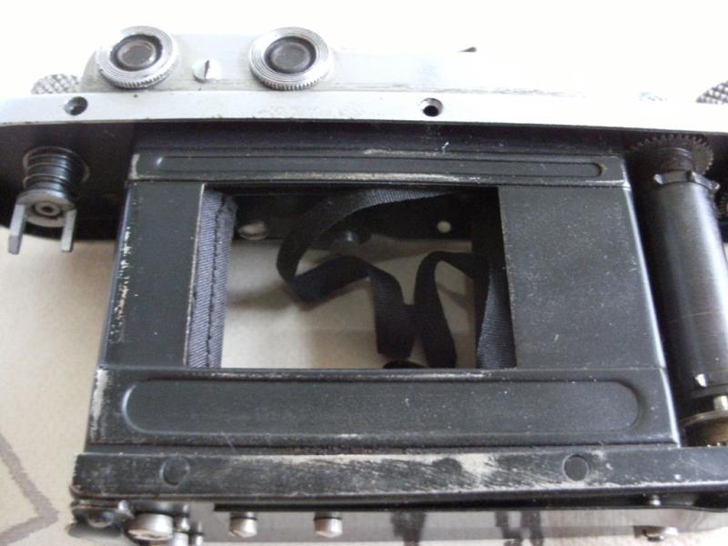

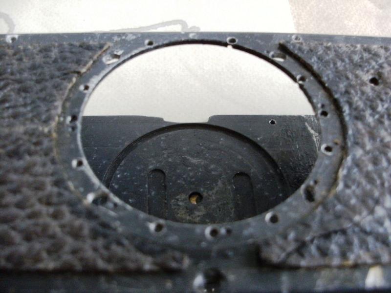

I have just received the camera.
Some words to share my first impressions.
It seems homogeneous: all is well adjusted and would work if the shutters were cleaned.
The chrome looks like the first Leica III(F) one of 1933: bright and somewhat peeling.
No hole to adjust the lens on the back, no hole on the press film inside.
The tip of the rangefinder could be a Fed 1c's with its drop shape.
The lens must be a Fed with the diaphragm at the rear (middle on Elmars) and its number: 15035 (probably 1935).
But there are things which are very strange: the main buttons, the inscriptions on the counter and the speed dial, the rear of the shutter box when the baseplate is removed, the setting of the baseplate and the position of the screws which fasten the shutter box on the front. All that is neither Fed's nor Leica's. And that could hardly have been home made.
Photos as soon as I can!

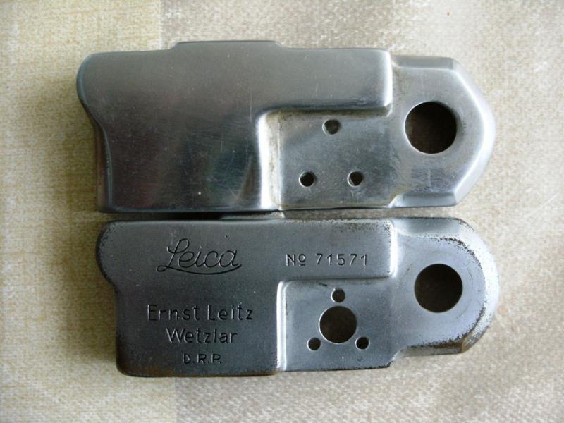

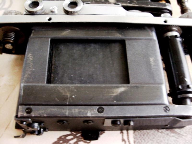

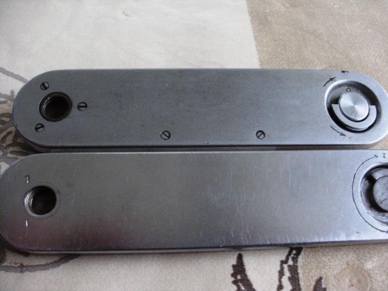

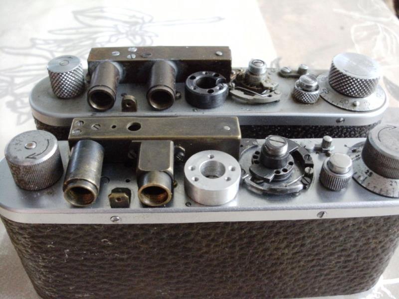

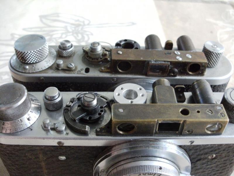

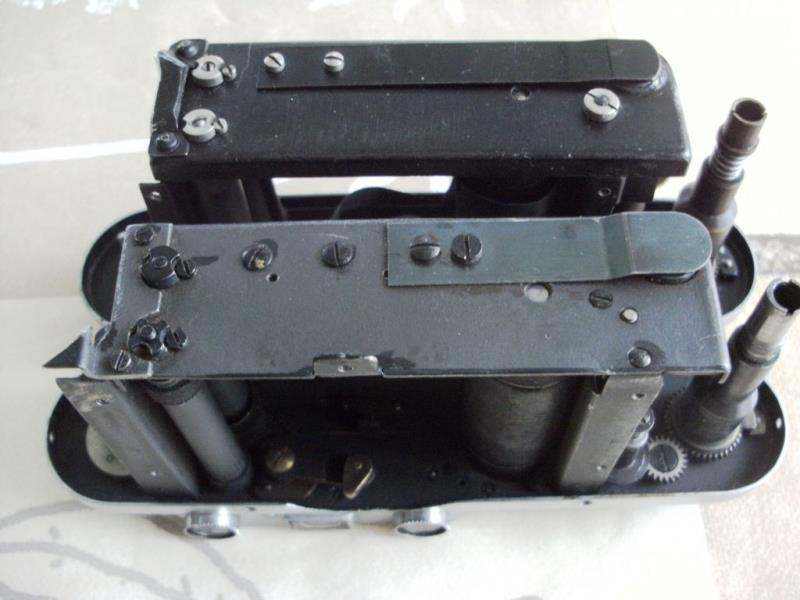

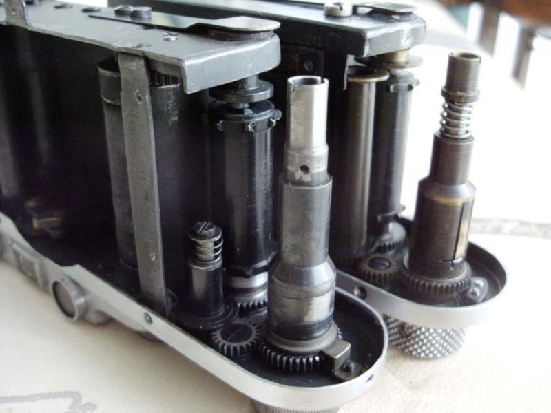

I have now partially dismounted this mysterious camera and a second one (a Fed 1d) to compare.
Of course, the technical solutions are globally the same: they both are Leica II copies. But almost all the internal details are different: position and size of screws, shape of the shutter box, springs and position of the film plate...
Feds are Leica copies; this one is not exactly that. It's a sort of transposition. For example, the release lever doesn't work like on Feds or Leicas.
Photos tomorrow: the battery of my numerics is OK now, but it's night here...

<br /> almost all the internal details are different: position and size of screws, shape of the shutter box, springs and position of the film plate...

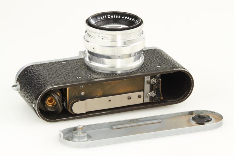

The Pioneer on fotoua.com has a picture without the bottom-plate.
There might not be many other inside pictures of other early Leica copies.
Replied on: 20141125041248
Yes, Juhani. When a lens without body meets a body without lens, it can make a camera... We have the date of the lens, not of the body...
Lenny: I have looked for internal détails on the net. I had seen the Pioneer on Fotoua. But they don't look like.
Replied on: 20141125042541

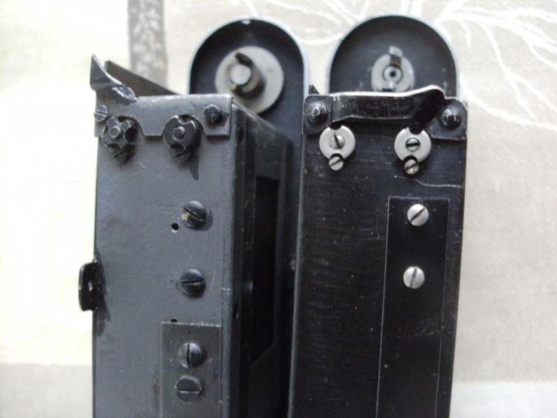

First comparison: the back part of the shutter box.
http://www.ussrphoto.com/resize/resize_image.aspx?ImgWd=800&IptFl=/UserContent/25112014_DSCF1699.JPG
http://www.ussrphoto.com/UserContent/25112014_DSCF1699.JPG
The Leica fake is on the foreground, Fed 1d on the background.
Same general organisation, but all is slightly different: the screws, the release spring...

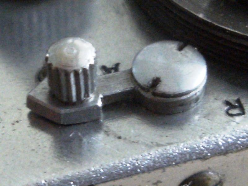

Detail concerning the screws to regulate the shutters and the lock of the baseplate.
Note that the Leica used two slot screws for their shutters until 1931, then 4 slots in 1932 (appearance of the Leica II), then 6 slots (Leica III). Fed kept the 2 slot one, except on the only Fed b (or V) I have seen (4 slots).
The lock of the baseplate is original.
http://www.ussrphoto.com/resize/resize_image.aspx?ImgWd=800&IptFl=/UserContent/25112014_DSCF1701.JPG
http://www.ussrphoto.com/UserContent/25112014_DSCF1701.JPG
Replied on: 20141125044318
The rear part of the shutter box. The Leica fake is the first.
http://www.ussrphoto.com/resize/resize_image.aspx?ImgWd=800&IptFl=/UserContent/25112014_DSCF1704.JPG
http://www.ussrphoto.com/UserContent/25112014_DSCF1704.JPG
http://www.ussrphoto.com/resize/resize_image.aspx?ImgWd=800&IptFl=/UserContent/25112014_DSCF1706.JPG
http://www.ussrphoto.com/UserContent/25112014_DSCF1706.JPG
No "rib" to reinforce the cage on the Leica fake. And screws always different.

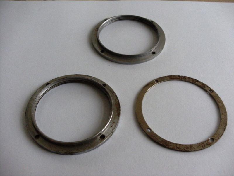

The part of the body which receives the lens, lens plate dismounted.
http://www.ussrphoto.com/resize/resize_image.aspx?ImgWd=800&IptFl=/UserContent/25112014_DSCF1709.JPG
http://www.ussrphoto.com/UserContent/25112014_DSCF1709.JPG
Many holes. Only four are enlarged to receive the corresponding screws.
And the lensplate. On the Leica fake (forehand), the shim is realised with a ring of metal. Strong paper on Feds.

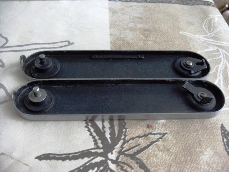

Replied on: 20141125051113
The two baseplates (with z and a on the Leica fake).
http://www.ussrphoto.com/resize/resize_image.aspx?ImgWd=800&IptFl=/UserContent/25112014_DSCF1710.JPG
http://www.ussrphoto.com/UserContent/25112014_DSCF1710.JPG
http://www.ussrphoto.com/resize/resize_image.aspx?ImgWd=800&IptFl=/UserContent/25112014_DSCF1712.JPG
http://www.ussrphoto.com/UserContent/25112014_DSCF1712.JPG
Thank you so much Jacques. I love it. You must be very happy to own this cam. This cam seems to be much more advanced in technic.
I love that there are 2 different locking nuts of tension setting screws, A 2-sided nut is only needed for the closing curtain because it doesn't need much tension. A 4-sided nut is much better for the opening curtain which needs much more tension and so it's better to adjust. But here it's just opposite, the opening curtain has the 2-sided nut only. Seems someone changed it by mistake.

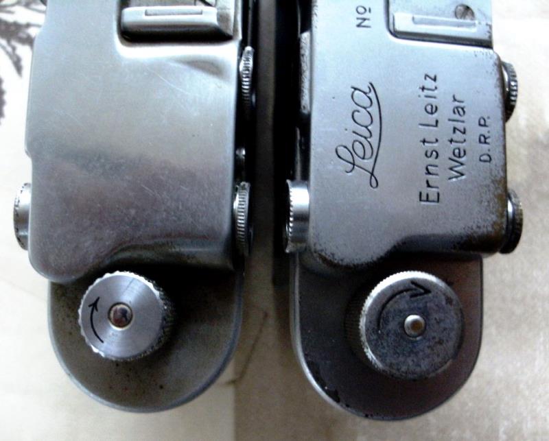

Just a last one about the cover.
Compared to a Fed's, the cover of the fake seems shorter on the right (when looking from the front).
http://www.ussrphoto.com/resize/resize_image.aspx?ImgWd=800&IptFl=/UserContent/25112014_DSCF1707.JPG
http://www.ussrphoto.com/UserContent/25112014_DSCF1707.JPG
The Fed is in fact a "no name", as you can see.
That's all for today. If I can, I will post some other photos of the ciphers and of the inside of the rangefinder.
The adaptation of the lens was certainly home made. But not the mechanism. So, where does it come from?
This metal distance ring seems to be a step back. With the paper shims the mount can be adusted much better and sometimes were used in more layers on one side then the other.

<br />The two baseplates (with z and a on the Leica fake).
Jacques, have both baseplates the same length?
It seems the distance between RF-eye and VF-eye on the backside is shorter.
Jacques, do you mean the M39-mount was added home made?

"a" and "Z" are German: Auf and Zu. So as this is most likely not a fake but a completely odd camera, this may be one clue?
Replied on: 20141125111503
To Lenny:
- the metal ring behind the lensplate is completed by a paper shim (5 on the Fed 1d showed!).
- both baseplates have the same dimensions.
- I think that the lens was home adapted. But the body certainly was made for a M39 lens.
- you are right, there is 1/2mm less between VF/RF on the backside.

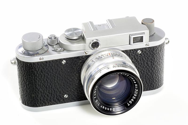

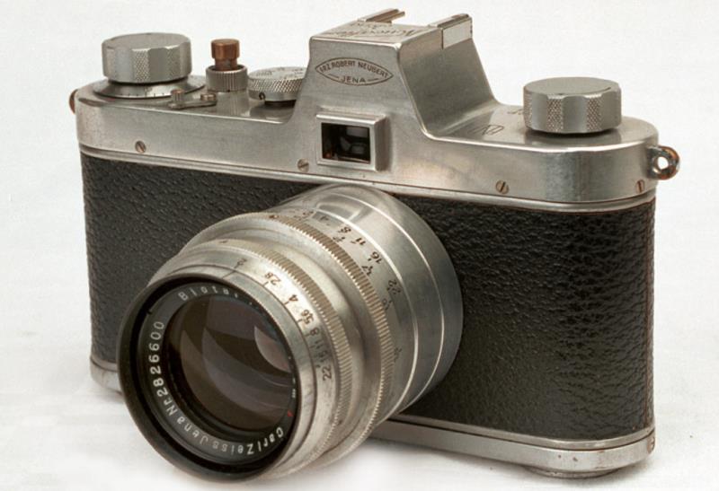

Seems Luiz is right.
This Neuca-Prototype from 1946 seems to be similar. This cam was in the Westlicht auction #23, lot 379, sold for 6800 euro (there are more pictures on leicashop.com).
http://www.ussrphoto.com/resize/resize_image.aspx?ImgWd=800&IptFl=/UserContent/25112014_Neuca_Proto_1946.jpg
http://www.ussrphoto.com/UserContent/25112014_Neuca_Proto_1946.jpg
Then there was another Neuca-Prototype from 1948. This cam was in the Westlicht auction #12, lot 332.
http://www.ussrphoto.com/resize/resize_image.aspx?ImgWd=800&IptFl=/UserContent/25112014_Neuca_Proto_1948.jpg
http://www.ussrphoto.com/UserContent/25112014_Neuca_Proto_1948.jpg
Could be Jacques cam is between both cams pictured above. What a find!!!

Some last photos with cover removed.
http://www.ussrphoto.com/resize/resize_image.aspx?ImgWd=800&IptFl=/UserContent/27112014_DSCF1742.JPG
http://www.ussrphoto.com/UserContent/27112014_DSCF1742.JPG
http://www.ussrphoto.com/resize/resize_image.aspx?ImgWd=800&IptFl=/UserContent/27112014_DSCF1743.JPG
http://www.ussrphoto.com/UserContent/27112014_DSCF1743.JPG
On both photos, the Leica/Neuca is on the foreground.
Always many small differences...
The distance between the finders (3,8cm, axle to axle)is the same. It's just the house of the VF/RF which is a bit less large on the Neuca (4,8cm vs 5,1cm).

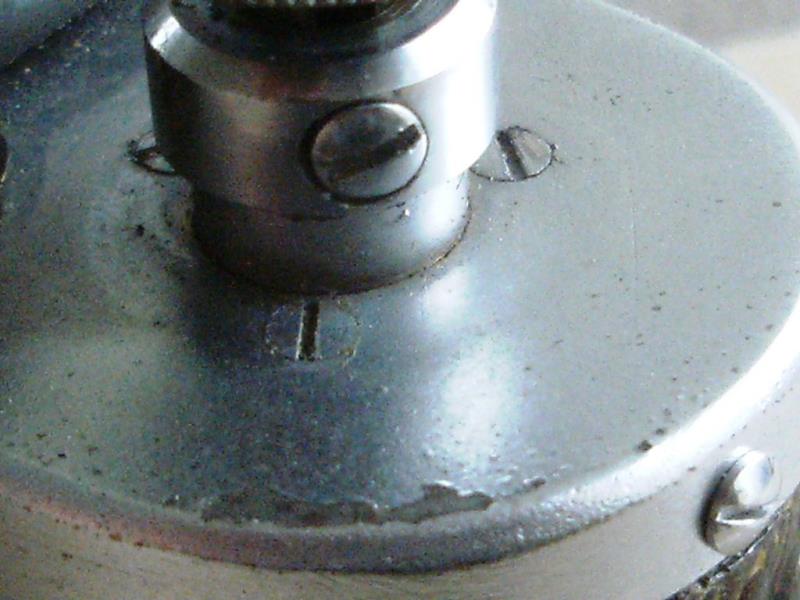

The engraving on the winding button, smaller than Fed's.
Replied on: 20141127092353

The three screws under the rewind button. The summit of the triangle is towards the left (towards the right on the early Feds and Leicas).
Is it 3mm less on the rewind side or did they move the whole top more to the middle to gain more space for the bigger rewind knob?

Sorry, Lenny, I cannot be precise: the two cameras are remounted now.
If you look at the photo I posted at 09:18:04, you see the housing of VF/RF (in brass). The right and (particularly?) left spaces are less important on the Neuca.
Another photo to compare the covers with their different shapes. It's all that which allows to place the button, I think.
http://www.ussrphoto.com/resize/resize_image.aspx?ImgWd=800&IptFl=/UserContent/28112014_DSCF1733.JPG
http://www.ussrphoto.com/UserContent/28112014_DSCF1733.JPG

Did you change the tension setting screws? The 4-sided nut is on the closing curtain which is not necessary because it doesn't need so much tension as the opening curtain. The 4-sided nut would be much better on the opening curtain to adjust it better. I think they were changed by mistake. Too bad there is no inside photo of the Neuca from 1948 for comparisons. Interesting is that the black Neuca from 1946 has two 6-sided nuts like on Leicas and then Neuca went away from that and changed to 2-sided and 4-sided nuts.
Replied on: 20141214090151
To Lenny: I don't want to modify anything on this camera. The curtains are just partially jammed, and it would be easy to restore them. But I prefer to keep it in its actual condition.
To Stephan: good question! The lens flange is standard (28,8/28,9mm by my caliper).

Just a detail more about this camera.
By the position of "D.R.P." (Deutsches Reich Patent) on the cover, the Leica camera which was used as a model was made between 1932 and 1936. After, the "DRP" inscription is in second position, just under "Leica".
That does not really change what we had said. But the camera could have been made before WW2 too.
Reply author: Lenny
Replied on: 20150615094010
I think the change of the D.R.P. position was end of 1935. The real Leica #71571 must be an early Leica-II, not an upgraded one, but in black paint. I think because your Neuca looks different, especially under the base-plate, an early serial number was chosen.
By the way, the Neuca which was just sold at westlich for 6600 euro was also sold there in November 2007, lot 332, for 5520 euro, at least the lens has the same number.
Replied on: 20150615111402
The change of the "DRP" position appeared somewhere in 1935 or 1936. For the moment, I don't have a better estimation. But it is not such important: it was just to enlarge the possible date of making.
And yes, as I have already said, the number is at the beginning of the (D) Couplex series (71200 in february 1932). At that time, all the Leicas were in black, except some special orders.
Having this camera in hands, just a word more. It was strongly used: the peeling of chrome around the speed dial and the two back windows is evident... A prototype which was tested for a possible mass production, perhaps.

There is this black Neuca which might be from 1946
http://www.ussrphoto.com/resize/resize_image.aspx?ImgWd=800&IptFl=/UserContent/1562015_Neuca-Prototype base2.jpg
http://www.ussrphoto.com/UserContent/1562015_Neuca-Prototype base2.jpg
Then there is the Neuca which was just sold at westlich, could be from 1948
http://www.ussrphoto.com/resize/resize_image.aspx?ImgWd=800&IptFl=/UserContent/1562015_Neuca proto westlicht 1506251.jpg
http://www.ussrphoto.com/UserContent/1562015_Neuca proto westlicht 1506251.jpg
They both have six-sided nuts with an additional plate under it and the long shutter-spring. Your Neuca has 2/4-sided nuts without a plate under it and a short spring. I guess your Neuca is a younger evolution. Why start with a shorter spring when Feds had long springs. But still I like your Neuca most, very special.
Replied on: 20150615170815
Luiz,
Do you know what the shutter box of the Neucaflex is made of?
On your site, it seems aluminium or iron, not brass: http://www.novacon.com.br/influest12.htm
On my camera, it is made of iron, contrarily to the Neucas we know.
And the base plate is made of iron too. I had not tried a magnet...
So, this camera could derive from a Neucaflex rather than a Neuca?
Thanks. Jacques.
Replied on: 20150615181743
I actually own this câmera and it is made of aluminium sheets.
I bought it around 1978 with Xenar 2.8 Isogon 40mm and telexenar 180mm and 360mm. na excelente kit!
more interesting I bought a second one identical that I sold soon after I assembled it.
This second câmera was bought by a song in the pouce Market and its prevoius ownwe disasembled completely and put the parts on a bag. Happily there were no parts in abcence. This was twenty years ago.
Regards LP
Replied on: 20150616032122
Thanks, Luiz.
If you own this Neucaflex, could you make some photos of the shutter box to compare with mine? If possible!
I am surprised by this shutter box and the plates made of iron. A bit unusual... Do you know other examples?
Replied on: 20150616202420
Not neucaflex excuses.... but UCAFLEX a slight great mistake!
Replied on: 20150617073004
If your Ucaflex has a shutter box made in aluminium, I suppose that the whole series of Uni/Uca/Neucaflex has the same.
I try a magnet everywhere, now![:)]
And in my LTM "Leica like", this camera is the only one to have the shutter box, the buttons and the two plates in iron. The body is in aluminium and the cover in brass with chrome.
Why? I don't really see an explanation for that.

Replied on: 20150622111446
No idea concerning this shutter box made in iron sheet?
I don't remember having seen a Leica like mechanism made of that material. As for the plates and the buttons made in iron too... But I am far for knowing all of them.
Just a guessing. At first sight, it is probably easier to make the mechanism of a prototype in iron sheet whereas the corresponding production will be made of brass or alloy. So, yes, that would leads towards a prototype.
But does this camera, as it is, lead us towards the Neuca? Probably not: they seem too far. This camera would be rather a sort of "orphan" with, perhaps, as ancestry, the mechanism of the Neucaflex... Unless the Neucaflex is derived from this camera??

Years after, same spring release, same buttons...
Curious!
