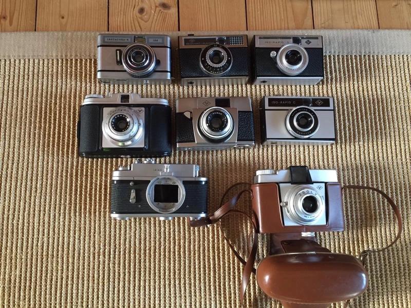

The cameras arrived today. Surprise, it has NO serial number on the back, only the number 1A143 on the front. It looks good but unfortunately it is broken, one shutter strap is between the big gears. So I have to diassemble it and replace the shutter strap.

Lenny, it lies disassembled on the table now. Some guy had disassembled it before and reinstalled some things wrong... The slow speed escapement was installed wrong, some screws are damaged. I hate it when people that don't know what to do try to repair a camera with the wrong tools [:(]
But I think I can reuse the strap, it is not broken and I can reglue it to the big drum, clean all and assemble it in the right way.
And no, I am not an Agfa collector now [:D] If anybody of you wants to have these Agfas let me know, I send them just for the shipping costs. Otherwise I throw them away...
