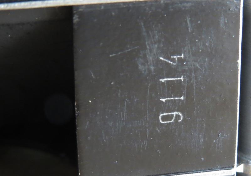

This last version arrived lately. Nickel plated lens n° 16771, and rare (?) internal number of 9114.
/UserContent2/952025_IMG_1897.JPG
http://www.ussrphoto.com/UserContent2/952025_IMG_1897.JPG
/UserContent2/952025_IMG_1896.JPG
http://www.ussrphoto.com/UserContent2/952025_IMG_1896.JPG
Perfectly working, as far as I can see. And it has its two spools. Even the reflex finder is usable. But all that is rather baffling...
A question: do we know the meaning of this internal number?

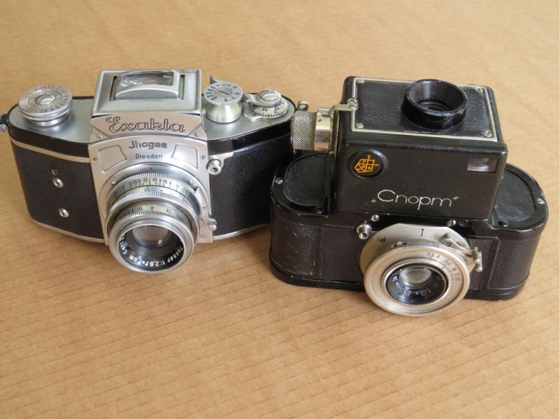

Side by side, "the" two prewar SLR. Not the same philosophy, nor the same filiation...

Replied on: 20250512083118
Yes Juhani, a very interesting and strange beast, as you say.
A pure Eastern conception and design...
I have put the Sport and the Exakta side by side on my shelves. Perhaps they will talk of the German Soviet pact of 1939?
