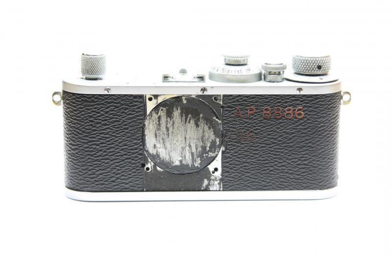

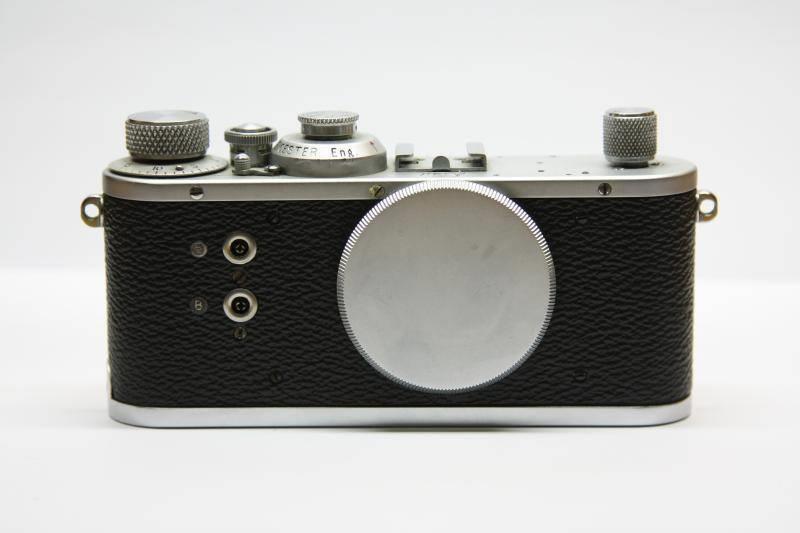

Reid made Leica III and Leica Standard copies, but too late to have been useful during WW2. Just the same for Kardon, on the US side that time. These cameras were really copies, not Leica fakes as those we have here.
Just to complete what Steve said, two photos of my Reid "periscope":
/UserContent2/832019_Reid 2208 1.jpg
http://www.ussrphoto.com/UserContent2/832019_Reid 2208 1.jpg
/UserContent2/832019_Reid 2208 2.jpg
http://www.ussrphoto.com/UserContent2/832019_Reid 2208 2.jpg
And about the Fed 1b cover, I wonder if it's a real one. I have seen too many Leica fakes, with that type of cover, to be persuaded. Note that Leica used that type of round cover only in 1932 for their Leica II. In 1933, the Leica III appeared and used a "cornered" cover for the slow speed mechanism. We find that cornered cover from the Fed 1c-s...

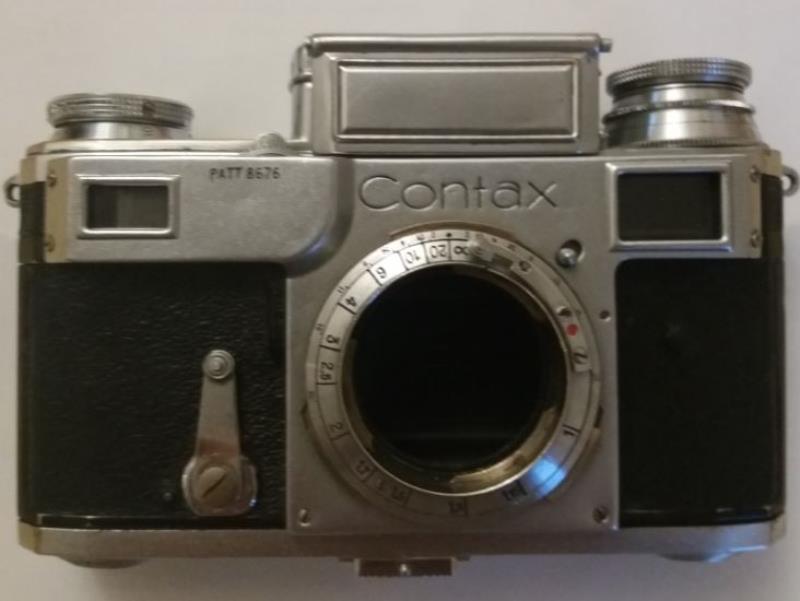

<blockquote id="quote"><font size="1" face="MS Trebuchet, Arial, Helvetica" id="quote">quote:<hr height="1" noshade id="quote"><i>Originally posted by SteveA</i>
<br />During WW2 the British government appealed for people to hand in their Leicas and Contaxes for military use. Best prices would be paid for the cameras, which were urgently needed for reconnaisance work etc. Super Ikontas were also used, I believe some of the D day landing photos were taken with 6x6 Super Ikontas.
Yes, not only Leicas but also Contax II or III (even though on the web you can find mainly Leicas). In fact I do have a Contax III which has been used by the Royal Navy, engraved Patt 8676.
/UserContent2/7102019_ContaxIII.jpeg
http://www.ussrphoto.com/UserContent2/7102019_ContaxIII.jpeg
Bought few years ago on ebay for as little as 40£ (no lens and no case). I'm really torn between the option of selling it (i had a quote of about 240£) or have it fully serviced (quoted 160-220£).
it is a big dilemma [?]
