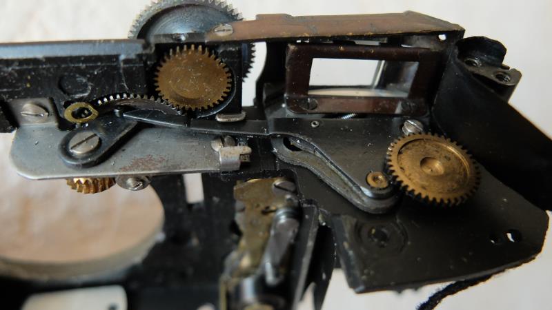

Hello everyone!
I recently became interested in analog photography. After doing quite a bit of research I decided to borrow a '59 Kiev 4A from my father to try out my photography skills. After a short course on the camera's operation I snapped a few pictures from a moderate distance, then close up - at the lens' smallest 0,9m range. Then when I tried to take a picture at range again I noticed that when trying to focus, the image in the small rangefinder rectangle of the viewfinder doesn't seem to be moving. It only only moves very slightly at 0,9m-0,95m focus, then it stops moving. I tried to be as gentle with the camera as possible since it is quite old (and maybe fragile), but it seems something malfunctioned.
My question is is there a way I could fix this myself or do I have to find a repair shop?
If I manage to get it fixed I might share my first ever pictures taken on film here [:D] Any assistance would be greatly appreciated! Thank you!
Reply author: jed
Replied on: 20200707131140
Hello and welcome Chris !
Your camera is a valuable one. The issue with the rangefinder is not a big problem but you'll need to disassemble the camera to clean the parts pictured below. Try to play many times with the focusing mount, maybe it will help. If not, take a (good) screwdriver :)

http://tunnel13.com/blog/1937-zeiss-ikon-contax-ii-cla/ shows how to get the top cover off the Kiev/Contax and to remove the shutter mechanism. It is likely that the long thin finger which meets that lever in Jeds photo is stuck - you may be lucky and be able to get a needle down between the shutter mechanism and gently free it off. If not then you will need to remove the shutter mechanism from the camera. IMPORTANT: wind the shutter self-timer on before removing the mechanism to make sure the shutter mechanism engages properly with it when you put the mechanism back into the body.

Progress report: I managed to get to the rangefinder mechanism thanks to some WD-40. Thank you for the tip! The rangefinder mechanism is now fully functional! But sadly I have encountered another problem - It seems that at some point during the repair I moved the base of the winding knob and when I screw it back on it winds all the way up to "B", and only moves down to 5 when trying to change the timing. I also tried to play around with the timing, now it's all over the place. Now if I want to set the desired timing I have to twist the knob to the timing I need, shoot then wind it again to the same spot. It doesn't stop automatically like it used to.
