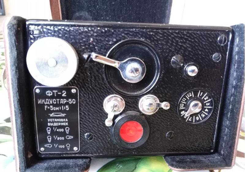

Reply author: perkinsmg
Replied on: 20201231024333
The two levers each have two positions, so that makes four possibilities. Only three appear on the instruction plate. The fourth, with both levers pointing away from each other, is the mystery setting.

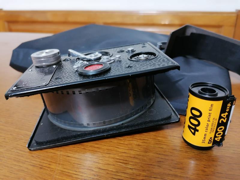

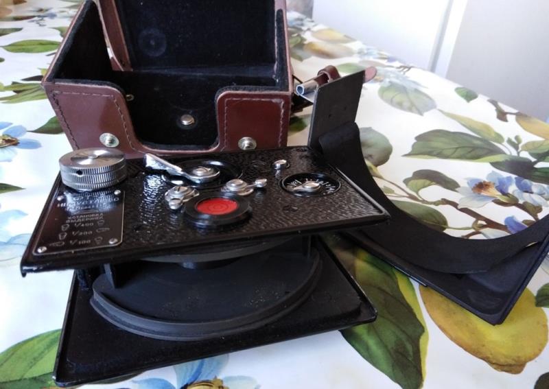

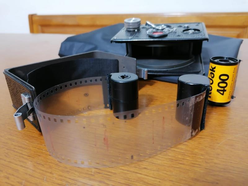

the camera has arrived and it is beautiful.
I loaded the spool and inserted everything without problems.
I turned the knob 3 and a half turns and placed the indicator on frame 1.
I'm ready for the first shot.[:)]
Now ... <font color="red"><i><b>after I take the shot, how far do I have to turn the knob to position the film for the second frame ???</b></i></font id="red">
Many thanks to all !!!
Replied on: 20210203120027
Hi!
Glad you're happy with the camera!
It's three complete revolutions per shot.
If you want to count the frames taken then do three complete revolutions plus enough to take you to the next number - e.g. wind from 1 to 1 to 1 to 2.
Michael.
Reply author: schyter
Replied on: 20210203124457
great information Michael !!! Thanks a lot !![:)]
so if I understood correctly,I have to do three full laps every time I want to advance the frame and the counter will position itself on the correct number.
Replied on: 20210203125021
Yes, three full revolutions of the counter. And advance to the next number if you want (there's nothing automatic about the counter increment. I also don't get frame overlap even if I don't move to the next number).
Replied on: 20210203125427
/UserContent2/322021_ft2.jpg
http://www.ussrphoto.com/UserContent2/322021_ft2.jpg
/UserContent2/322021_ft2-1.jpg
http://www.ussrphoto.com/UserContent2/322021_ft2-1.jpg
/UserContent2/322021_ft2-2.jpg
http://www.ussrphoto.com/UserContent2/322021_ft2-2.jpg
/UserContent2/322021_ft2-3.jpg
http://www.ussrphoto.com/UserContent2/322021_ft2-3.jpg
Replied on: 20210203125930
<blockquote id="quote"><font size="1" face="MS Trebuchet, Arial, Helvetica" id="quote">quote:<hr height="1" noshade id="quote"><i>Originally posted by perkinsmg</i>
<br />Yes, three full revolutions of the counter. And advance to the next number if you want (there's nothing automatic about the counter increment. I also don't get frame overlap even if I don't move to the next number).
perfect !!!

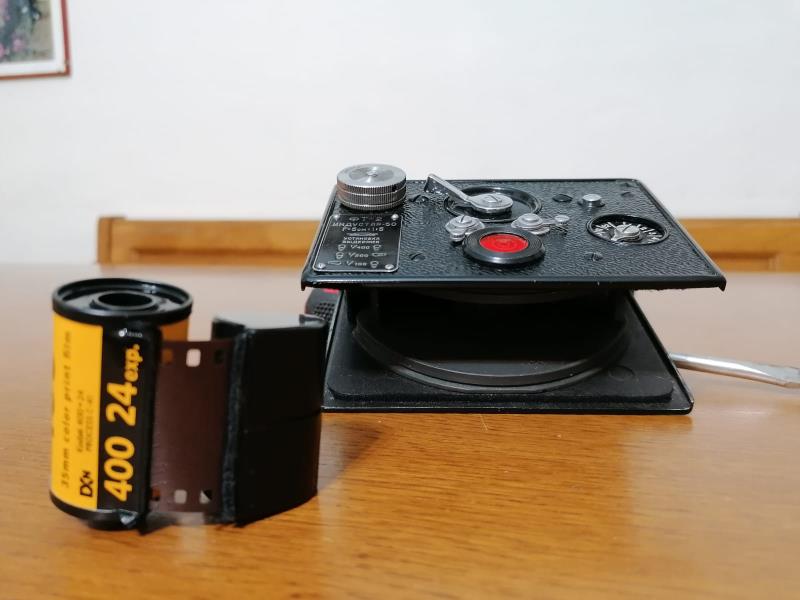

I have attached a piece of old film so as not to waste a shot.
I loaded a 24 exposure film ... will I get 8 frames?
Replied on: 20210203130521
You should do. I think I got 12 from a 36exp. These days I usually load bulk film.
