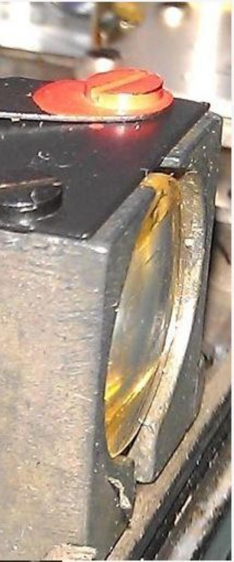

Reply author: Denn_kirov
Replied on: 20240401000653
In theory, it is possible to adjust the front lens of the rangefinder. But you will have to adjust the rangefinder again. In practice, the most difficult thing is to adjust the front lens, because it is glued into a metal frame.

Reply author: henry
Replied on: 20240402083124
Cheers, everyone. The issue was that the whole rangefinder/viewfinder assembly was not sitting straight on the body. The threaded hole for one of the three screws holding it in place was offset, and that pulled the whole assembly out of parallel with the body. I took that screw out and now the ass'y is straight(er).
You can tilt the front viewfinder prism to adjust the field-of-view but that makes it very difficult to get the rangefinder image in line with the dark contrast mark in the prism. You can also remove the back eyepiece with the framelines on it and shave off some material to move it left or right. I did both but the issue turned out to be as described above.
I bought another 5C later that didn't have this issue and that's the one I've been using ever since.
