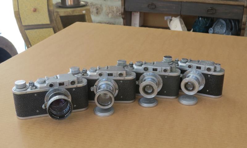

The four cameras in photos:
- an ordinary late 1e (s/n 183231)
- the Fed-Arsenal s/n 00067,
- the Red Flag 200977,
- the 1f "romashka" 210112.
A photo of the family:
/UserContent2/592021_IMG_0402.JPG
http://www.ussrphoto.com/UserContent2/592021_IMG_0402.JPG

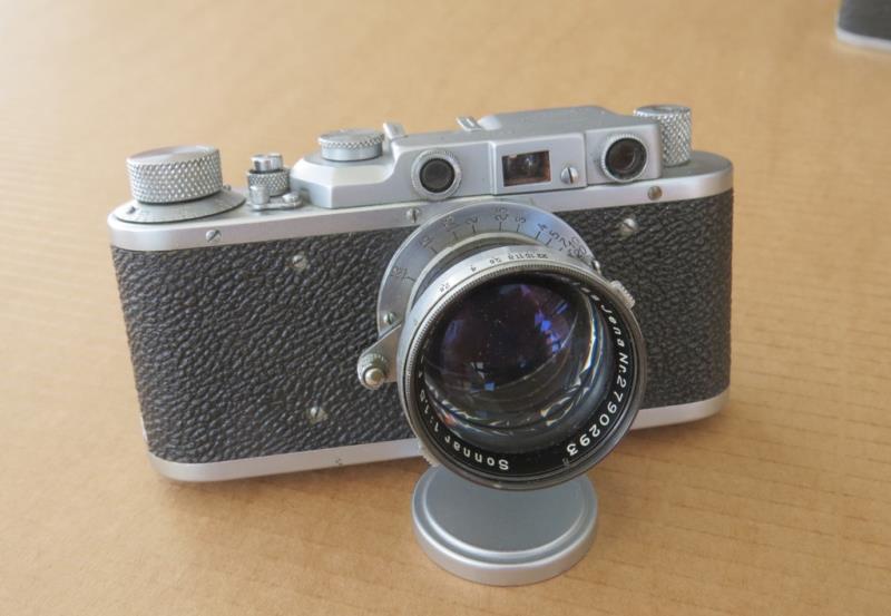

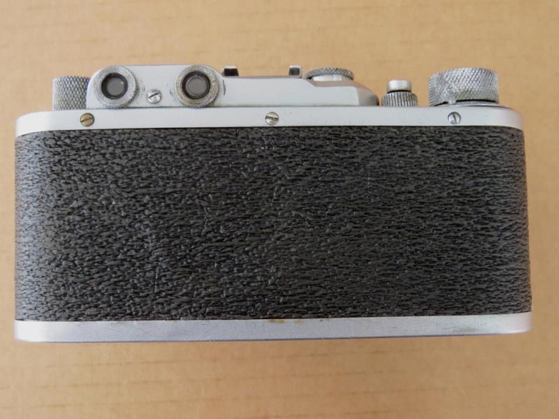

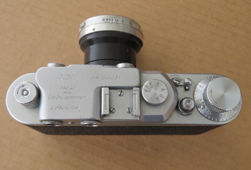

First one, the 1e.
A well known camera, now. As we have already said in other threads, they were still made in Kharkov before the evacuation in september 1941. Here is an ordinary 1e:
/UserContent2/592021_IMG_0405.JPG
http://www.ussrphoto.com/UserContent2/592021_IMG_0405.JPG
/UserContent2/592021_IMG_0406.JPG
http://www.ussrphoto.com/UserContent2/592021_IMG_0406.JPG
Not completely ordinary, in fact : a 1,5/5cm Sonnar was adapted to a Fed mount. In fact, it seems that Fed missed lenses, and it's not the only 1e to have an "exotic" lens.

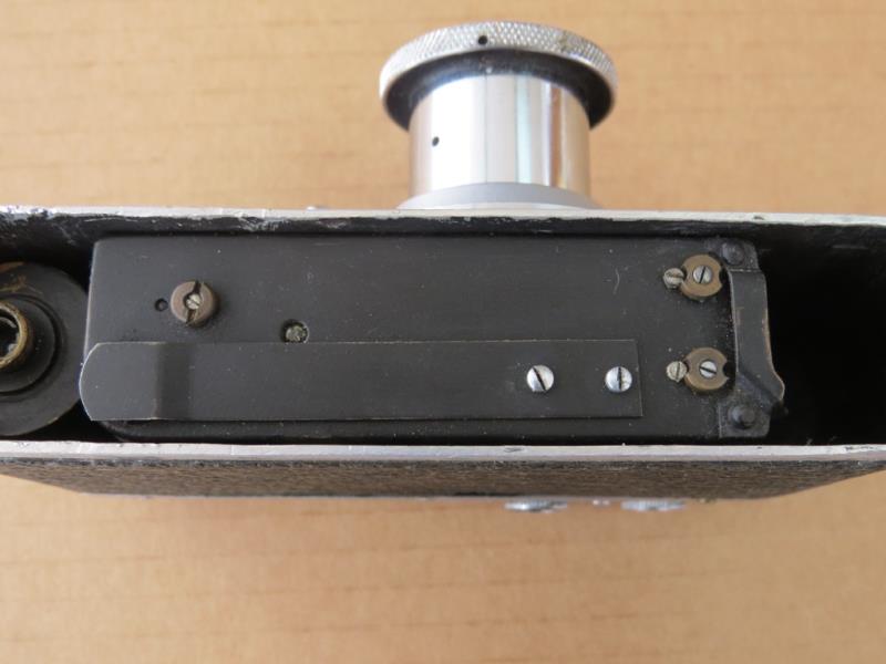

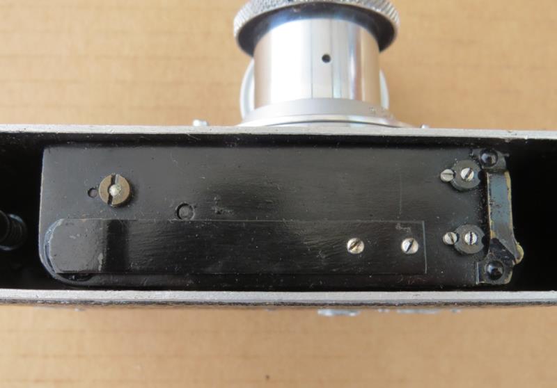

Replied on: 20210905082238
Two photos more:
/UserContent2/592021_IMG_0407.JPG
http://www.ussrphoto.com/UserContent2/592021_IMG_0407.JPG
/UserContent2/592021_IMG_0408.JPG
http://www.ussrphoto.com/UserContent2/592021_IMG_0408.JPG
So, the common vulcanite and an ordinary shutter box (made in steel, so magnetic; and with nickel bolts).

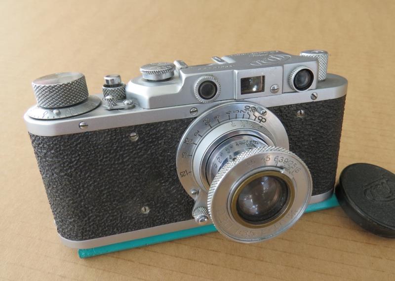

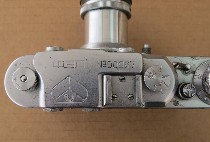

Replied on: 20210905083559

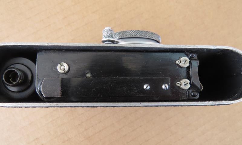

Second camera: the Fed Arsenal s/n 00067. Well known on this forum, as we discussed about it some years ago:
http://ussrphoto.com/Forum/topic.asp?TOPIC_ID=2884&whichpage=1&SearchTerms=fed%2Carsenal
It was made at Arsenal in 1945, just before the factory was in charge of Kievs. 11 known items only, most in bad condition.
/UserContent2/592021_IMG_0417.JPG
http://www.ussrphoto.com/UserContent2/592021_IMG_0417.JPG
/UserContent2/592021_IMG_0418.JPG
http://www.ussrphoto.com/UserContent2/592021_IMG_0418.JPG
Found without lens (I added the 2/50mm Fed which was the best concerning the position). Generally found with an early Industar 22, two with an early Fed "one turn" (for the 1a).
The vulcanite seems exactly the same as the 1e one.

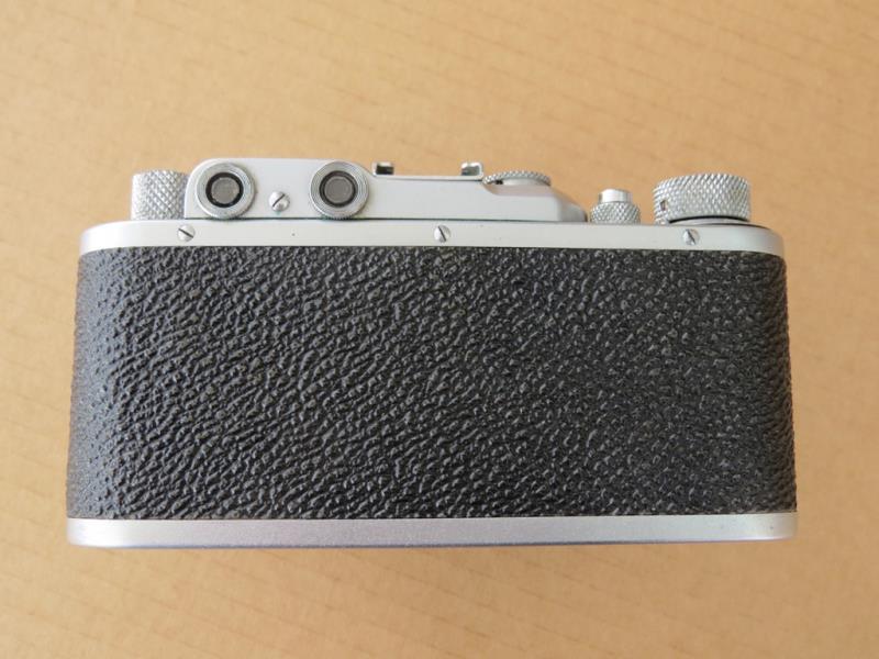

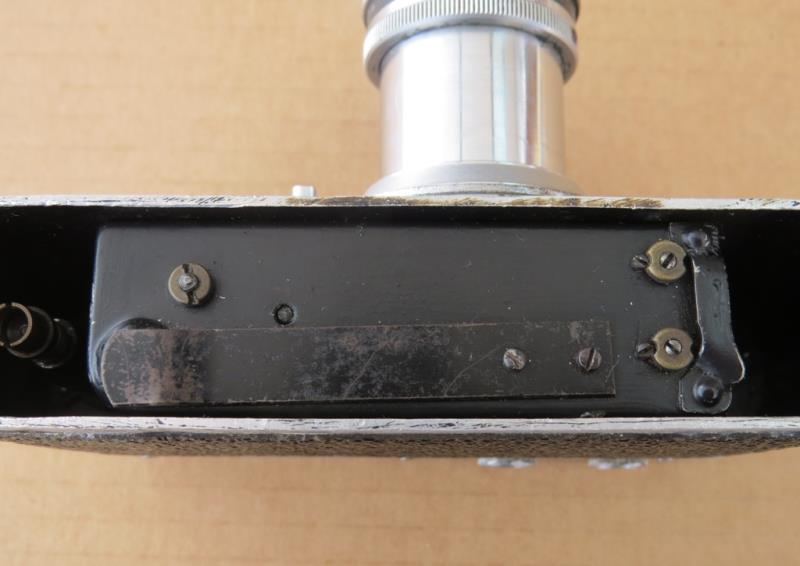

Replied on: 20210905084819
Two more photos:
/UserContent2/592021_IMG_0420.JPG
http://www.ussrphoto.com/UserContent2/592021_IMG_0420.JPG
/UserContent2/592021_IMG_0421.JPG
http://www.ussrphoto.com/UserContent2/592021_IMG_0421.JPG
Bad condition of the chrome. The shutter box is interesting: made of steel (magnetic) and equipped with nuts in brass.

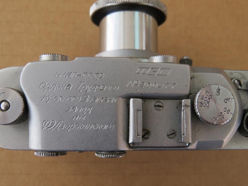

The turn of the Red Flag NKAP now.
Several versions are known: with "stretched" vulcanite, "romashka" one and with ordinary one (1e type), that last one being contested. I don't talk about the fakes (I have several if necessary).
This s/n 200977is a regular NKAP:
/UserContent2/592021_IMG_0410.JPG
http://www.ussrphoto.com/UserContent2/592021_IMG_0410.JPG
/UserContent2/592021_IMG_0411.JPG
http://www.ussrphoto.com/UserContent2/592021_IMG_0411.JPG

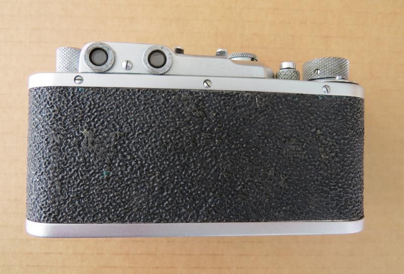

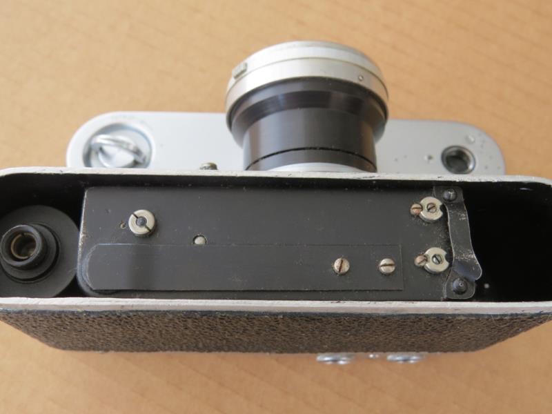

Replied on: 20210905090738
Two photos more:
/UserContent2/592021_IMG_0413.JPG
http://www.ussrphoto.com/UserContent2/592021_IMG_0413.JPG

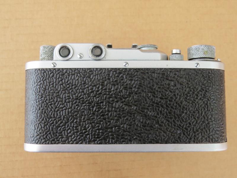

/UserContent2/592021_IMG_0415.JPG
http://www.ussrphoto.com/UserContent2/592021_IMG_0415.JPG
This vulcanite was never seen before. But we will found it again on some first 1f. For the "romashka" vulcanite (also named "flower", please see the 1f below).
Concerning the shutter box, it is made in brass (non magnetic); the nuts are in brass too (like the Fed Arsenal).

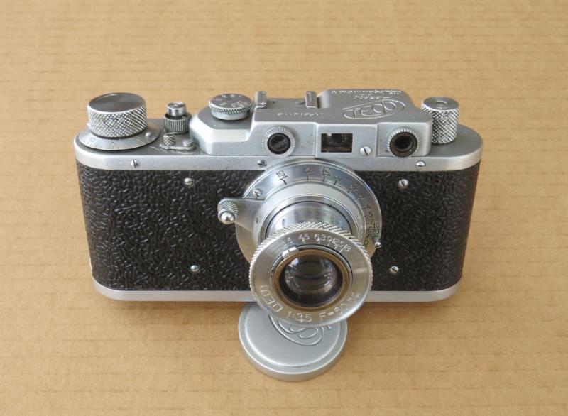

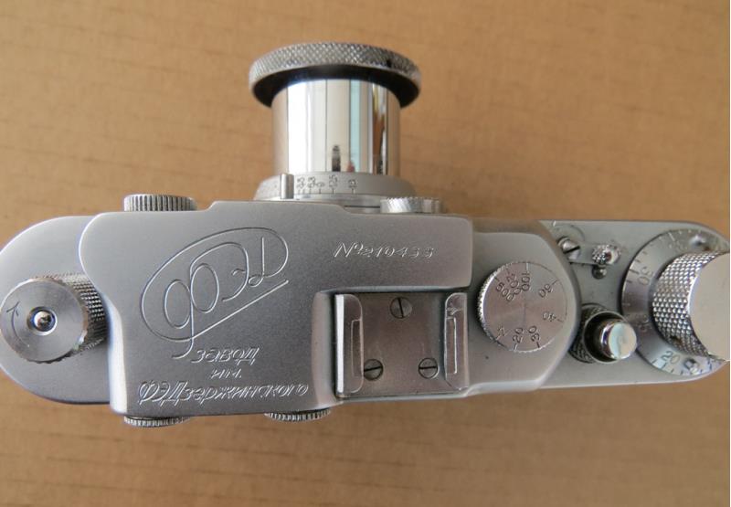

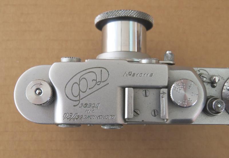

Last item: the early Fed 1f s/n 210112.
/UserContent2/592021_IMG_0424.JPG
http://www.ussrphoto.com/UserContent2/592021_IMG_0424.JPG
/UserContent2/592021_IMG_0425.JPG
http://www.ussrphoto.com/UserContent2/592021_IMG_0425.JPG
Nothing special, except of course the circled release button which reminds the 1c to 1e series. Very fast, the 1f release buttons will be soft on the 1f.

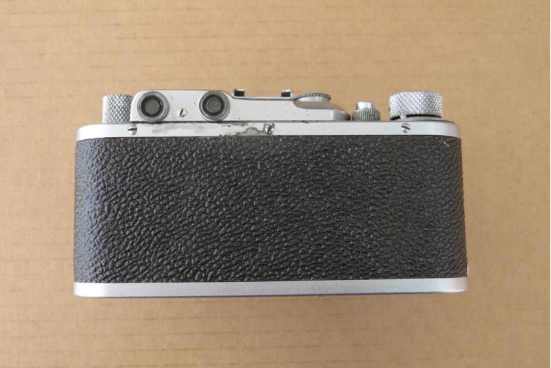

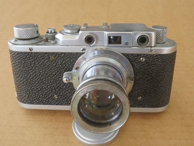

I should have proposed a short comparison with an early, but ordinary Fed 1f too.
Here are some photos of the s/n 210455.
/UserContent2/1192021_IMG_0429.JPG
http://www.ussrphoto.com/UserContent2/1192021_IMG_0429.JPG
/UserContent2/1192021_IMG_0430.JPG
http://www.ussrphoto.com/UserContent2/1192021_IMG_0430.JPG
The visible change is the release button: circled on the others, soft on this one.
