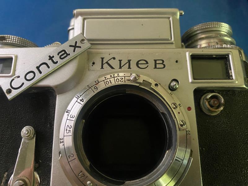

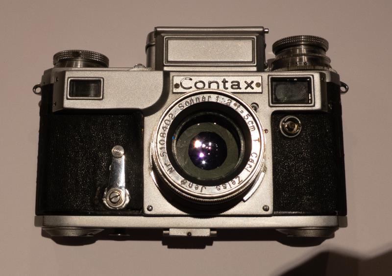

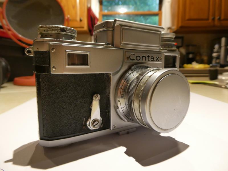

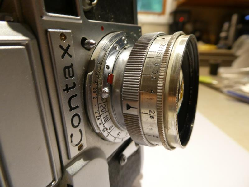

I’m looking for identification on this camera and lens. It is on a Kiev III (see imgur link) with a Contax plate affixed over the Kiev name .
The front barrel of the lens has a Zeiss name “plate” (see imgur link)
I have scoured the internet and have not been able to find any additional information. Is this is a genuine Zeiss lens or
a Jupiter lens with a fake plate around the lens.
The back of the lens has no info on it, but the marks for the f-stop seem to be a bit different than on other lenses, especially the holes on the far ends of the f-stop range. Also, there are clicks when moving the f-stop ring but they don't seem to click on each mark.

Hi, looks like just a regular Jupiter 8M with re-engraved front ring..

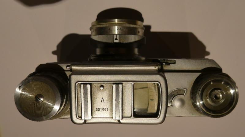

BTW there is a flash contact, any idea who has added it? If back in 50'ies USSR. the camera has been in a professional workshop!

Well regarding the lens.. it is unmistakably a Jupiter 8/8m shaped body that's how I can tell...
The engraving.. well there are two possibilities:
1. someone had a professional repairman change the engraving to Zeiss, it's not that hard, in 1990s there were tons of fake Zeiss and Leica lens that looked a lot more professionally redone that yours.
2. another a less likely but viable scenario is that camera was modified in a KGB workshop that each factory like KMZ and Arsenal had during those years to be disguised as western camera as it was easier to and cheaper to modify these than to buy western counterparts.. I generally don't like to believe that romanticized spy story but there is a chance that is how it happened because these workshops were real and produced plenty of spy gear. I guess we will never know for sure but that gives you several hypothesis to choose from [:)]
It is indeed an interesting story about a Russian soldier and it is also very possible he had stole it from headquarters to make some money on.. very common scenario is USSR as unsupervised government equipment tended to disappear [;)]
in terms of engraving looking professional I tend to disagree, from seeing a lot of fakes this one is absolutely one of the most fake looking [:D]. Someone could easily done that with a steady hand and an engraving machine.

The lens is a Jupiter-8, not 8M, you can tell by the aluminum body, and I bet it does not have stop-clicks.

The J8M started production in 1959, and the aperture scale has click stops and is linear.
This lens is a Jupiter-8. The engraver never bothered to change the serial number, the lens was made in 1951. This lens "very most likely" is made of Zeiss Lens elements, Zeiss fixtures, Zeiss parts and assembled in Russia. I have 1952 J-8's with German lens elements, and later 1952 J-8's with Russian cut-from-Schott glass elements.
