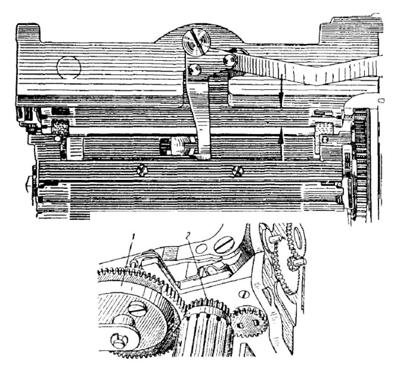

Hi, the shutter tension adjustment should still be the same - the bottom right hand side of the lower drum, the little slotted washer that has to be moved aside then the adjusting screw. If the shutter opens and closes smartly on B then the tension is probably OK. Its possible that someone has had a go at the camera and messed up the timing - the slow speeds escapement may not be disengaging. You can tell this if you get the buzzing sound on speeds faster than 1/50 second.
If you wind and set the shutter on 1/1250 second, there should be about 6 to 7 teeth of the big gear visible before the cutout section of it. More or less than this and the speeds will be adrift. There should be 1.5 to 2 of the strips of the upper blind visible below the top of the shutter crate. If you have a copy of Maizenburgs book its all in there, have attached image for reference
/UserContent2/1882022_kiev.jpg
http://www.ussrphoto.com/UserContent2/1882022_kiev.jpg
