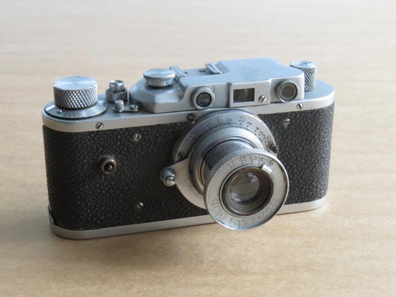

At first sight, nothing interesting with this ugly Fed 1d.
/UserContent2/18112022_IMG_0851.JPG
http://www.ussrphoto.com/UserContent2/18112022_IMG_0851.JPG
/UserContent2/18112022_IMG_0852.JPG
http://www.ussrphoto.com/UserContent2/18112022_IMG_0852.JPG
/UserContent2/18112022_IMG_0853.JPG
http://www.ussrphoto.com/UserContent2/18112022_IMG_0853.JPG
A very common one, with a flash plug.

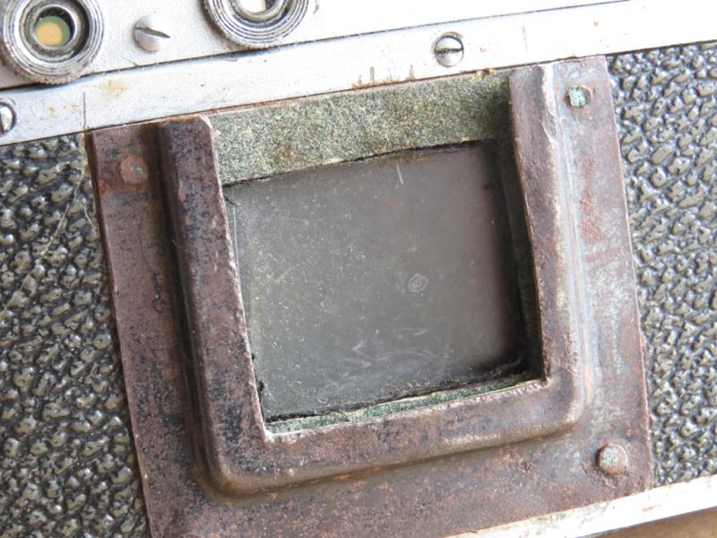

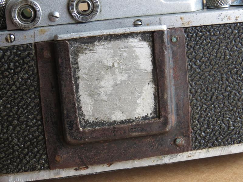

On the back, a plaque of aluminium fixed by rusted iron.
/UserContent2/18112022_IMG_0854.JPG
http://www.ussrphoto.com/UserContent2/18112022_IMG_0854.JPG

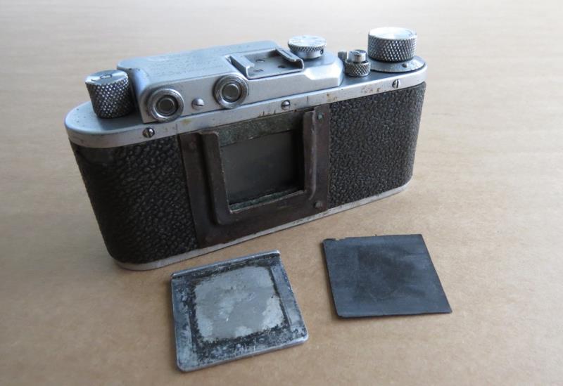

Below, a sheet of glass against the curtains. Of course, the camera cannot take pictures as it is:
/UserContent2/18112022_IMG_0855.JPG
http://www.ussrphoto.com/UserContent2/18112022_IMG_0855.JPG
/UserContent2/18112022_IMG_0856.JPG
http://www.ussrphoto.com/UserContent2/18112022_IMG_0856.JPG

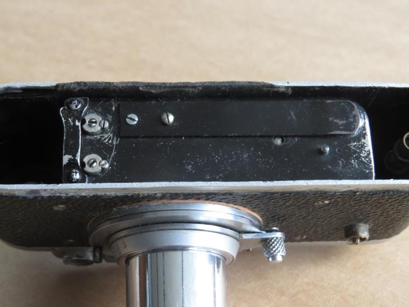

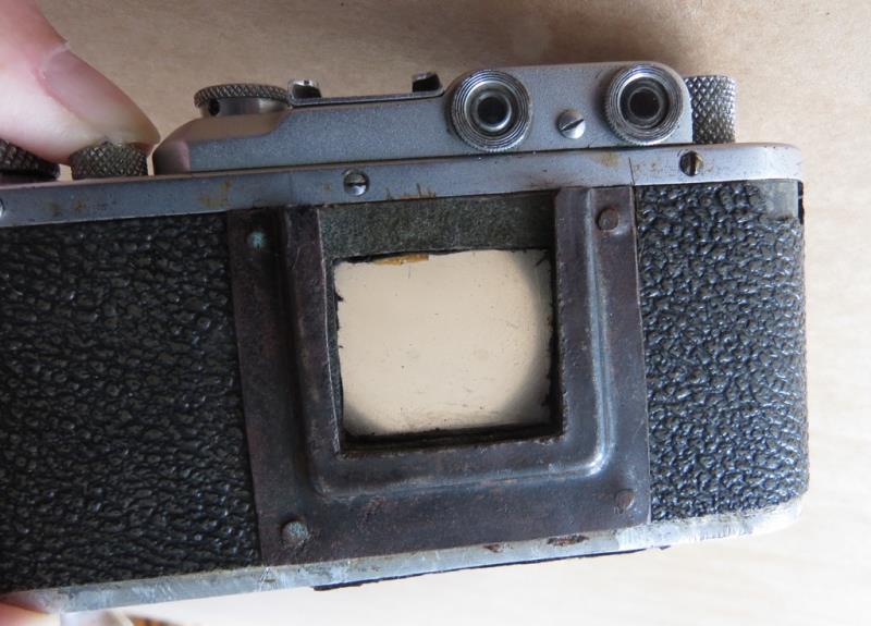

Replied on: 20221118084455
Very probably, that camera was used as a checker for lenses (the register is exactly at 28,8mm on this item. But the montage is not from the factory, of course! It could have been made after ther war, when the lack of standardization for the prewar Feds had become a problerm with the appearance of new lenses...
/UserContent2/18112022_IMG_0858.JPG
http://www.ussrphoto.com/UserContent2/18112022_IMG_0858.JPG

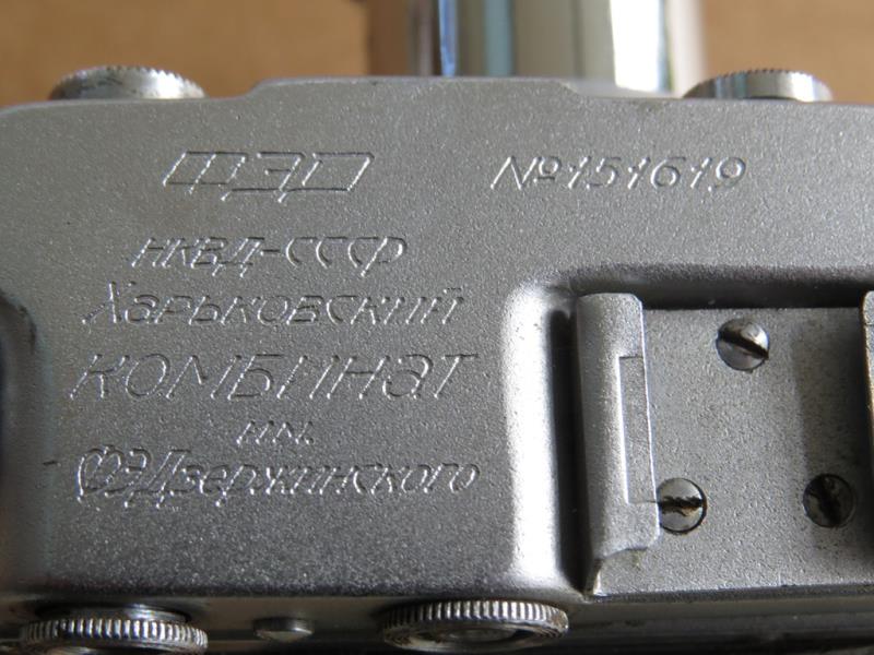

Note that the lens (s/n 153385) should be original.
Replied on: 20221118170150
Jacques, a really weird camera. Congrats to that find. I also don't think that it was factory made, looks like home made.
