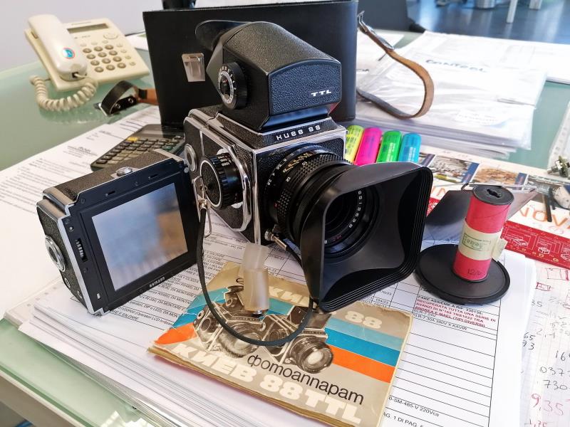

maybe then I was lucky. I got a practically new Kiev 88 (from Serbia 1988 year).
I redid the backtraps and everything works like a charm. Fingers crossed.:)
/UserContent2/582023_88.jpg
