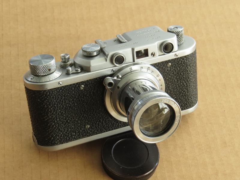

before I mess up this katalog, it was one camera on eBay #280190465127:
http://cgi.ebay.com/ws/eBayISAPI.dll?ViewItem&rd=1&item=280190465127&ssPageName=STRK:MEDW:IT&ih=018
I'm not sure if it should go in it.

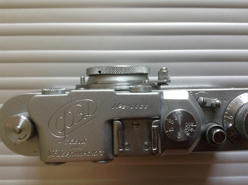

It seems we must be careful with the limits 1d/1e.
I already saw several Fed 1 engraved 1d in the #173600/176000. Princelle points them in his book (he says #174000-178000). Probably some 1d pre engraved covers sent to Berdsk and put together there. They are really scarce, but it would be fine to check before putting on a list.
Replied on: 20080528235005
So I am completely lost people... I got 2 books in front of me - Asquini/Pegorari and Princelle 2nd edition:
I also have this camera #177511
Princelle says that these cameras were produced in Siberia with serials on 1e 173600/174000 - c. 183000 and up. So I would assume Berdsk.
Cladio and Albino says the following about the same range: "Towards the end of 1946 the returned to Kharkov is organized and production slowly resumes. Only in 1947 it will be possible to return to full production" ... errrrrr... so while organizing in Kharkov, Berdsk is meanwhile producing this model? I'm confused.. what is the latest news on that? [:D] So according to Asquini/Pegorari the 1e is not Berdsk at all?!
Thanks!
Replied on: 20080529085559
Not an easy question. But this camera -1e type- is called "Berdsk" because we decided so. We, that is to say probably JLP, but not the factory.
In fact, Berdsk is not written on the covers: there is only "made in the factory of FE Dzerjinski, Kharkov".
We can only suppose that some cameras were put together at Berdsk from spares coming from Kharkov: perhaps these rare Fed 1d engraved CCCP after 173600-174000 (up to c. 176000 for some). The real production will begin again in 1946 with those 1e, maybe at Berdsk first then in Kharkov (from 173600-174000 too).
It would be logical, but nothing is sure!

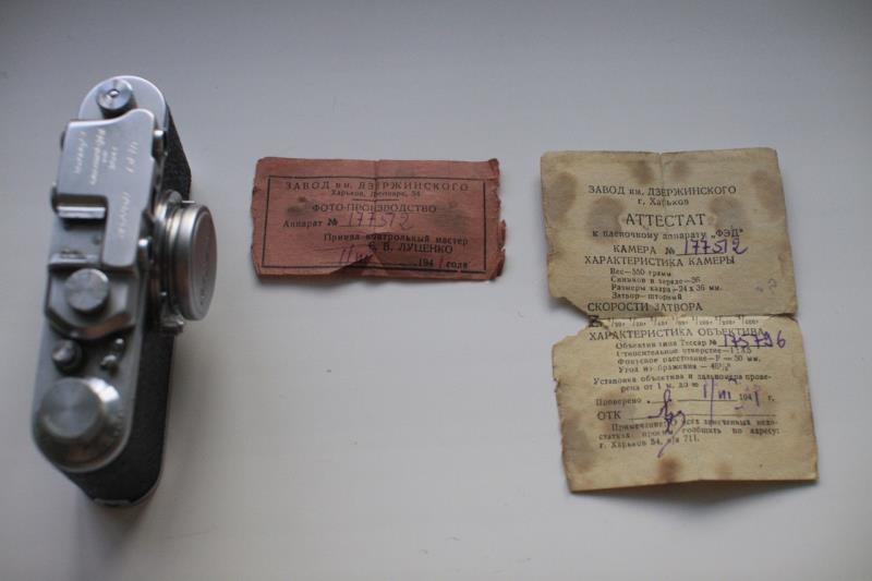

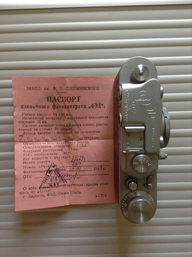

One of the most helpful things in Princelle iare the "Benchmarks" notes he adds. For this case, I have noticed he writes (below the entry for the "RED FLAG - N.K.A.P."):

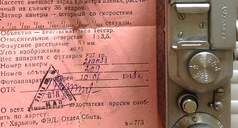

"Benchmarks: The FED "RED FLAG" # 201280 is delivered with a passport printed in Berdsk and countersigned the 19 August 1946."
So, I think if a passport was printed in Berdsk in 1946 then the RED FLAG camera (at least the first 1200) may have been made in Berdsk.
Also, comparing the BERSK cameras with the RED FLAG - KNAP FED you will notice many differences in the parts (the castings look different, for example, of the rangefinder housing) and the finish is also much different. So I suspect that the RED FLAGS were actually made in Berdsk when the old parts from Kharkov ran out and the next FED to come out from Kharkov was probably FED-1f.
The "Berdsk" FEDs were probably assembled in Bersk .... maybe in 1942, and sporadically throughout the war, when they were needed, but by 1945 the parts originally made (and engraved) in Kharkov were running out so a new production line had to be built and the new cameras produced were the "RED FLAG - KNAP".
So I think all FEDs with the Berdsk style engraving, and some with the earlier style engraving were assembled in Berdsk. I also think that it is possible that cameras were assembled in Berdsk, more by hand than assembly line, sporadically throughout the war.
But, all is hypothetical and based on some logic, unless more examples with passports are known (and even then only if the passports tell the place of construction or signing).
Replied on: 20080529104815
Hi Bill,
About passports, DVD show the passport of an S eBerdsk with 31/07/1941 as a date. It would fit your hypothesis. But the date is very next to the evacuation.
It seems the paper was made in Kharkov.

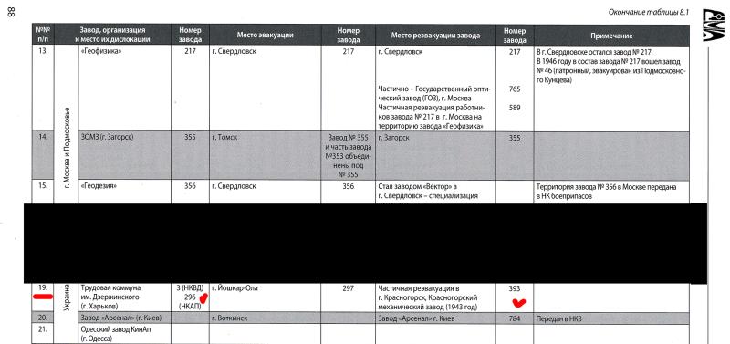

It was one document listed there (page in Russian):
http://www.zenitcamera.com/archive/misc/gko-docs.html#n2445 ...
This is the GKO (The State Committee of Defense) Decision (Order) No.2445 from October, 23rd, 1942. "About allocation of optical-mechanical manufacture from structure of factory number 296 NKAP and its transfer to NKV system".
So, from the October, 1942 according this Order the FED factory (number 296 NKAP) had no opportunities, nor the rights to make a cameras. Up to the ~1946 year, as we know...

So, does it mean that the parts just sat there in Berdsk for 1943-1945 ?
Possibly so. While remains not clear (as there is no text of the order) to whom this optical manufacture (and in what volumes and so on) was transferred... How the optical manufacture was carried out is not clearly too...
P.S. I think, that no return at all existed. Manufacture was restored in Kharkov from scratch.

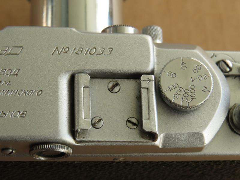

I own what I beleive to be a Berdsk-S, #178482.
This particular camera is one of the oldest pieces in my Russian Camera collection. I bought it in 2000.
Now, what am I to look for? Are we checking for authenticity?
Replied on: 20080529175231
About the passports, if you could have a look at the Berdsk S # 180024 of DVD,
-URL http://www.dvdtechcameras.com/collect/fed/fed.htm
-then click on FED S New,
-then go to the last one (before, there are several very strange S...)
The passport is interesting as it shows this curious date -31 VII 1941. Would anybody be kind enough to translate the interesting parts of it (titles, I guess)? Perhaps it would help us to know the origins and dates of these cameras.
Then I agree with Bill about connections between Fed and Zorki. For example, the Fed-KMZ we know, numerous Fed-Zorki and (as it seems)some early Zorki 1a were equipped with the 1/1000th shutter. These shutters were certainly coming from Fed as KMZ never used them after on their 1 series. And the first Fed-Zorki seem to be twins of the last Fed...
But no certitude, as usual...
Reply author: nightphoto
Replied on: 20080529202217
Hi Steve,
Your camera is in the right serial number range and although the FED-S Berdsk is rare, a number of examples are known and I have not seen fakes of it. So we are not so much talking about authenticity, but more about where these cameras, as well as the cameras that came after them, were made. Where they made in Kharkov or Berdsk, and when? So it is more a matter of history than authenticity.
I can read that the passport for camera (FED "Berdsk") serial number 180024 gives an address of "Kharkov, Lesnopark 54"
and also states "NKVD - CCCP ... Kharkovski Kombinat of F.E. Djerzinski". Also that it is a "FED-S". So probably no doubt this camera was finished before any move to Berdsk. Probably just before the move ... or at least they were still using this type of passport (who knows when they would actually make new passports for the new location?

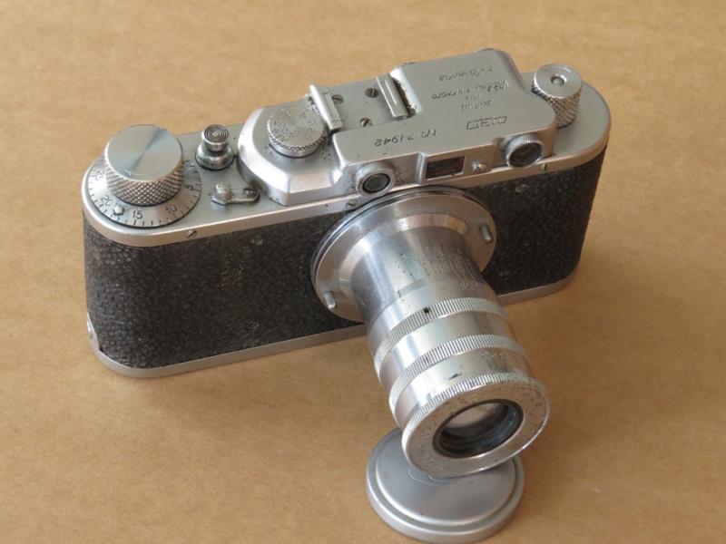

This subject of the so called "Fed Berdsk" (or Fed 1e)is fascinating. Of course this was an extremely turbulent and difficult time in the history of Fed, and perhaps we can never know the real facts.
I have only one Fed 1e "Berdsk" in my collection. If I remember correctly the serial number begins 174XXX, (I will check when I am back in the UK towards the end of June and enter it into the Wiki).
The main point I want to make is that in addition to the unique engraving on the Fed 1e as opposed to all other Fed 1's my particular "Berdsk" has no visible screws in the baseplate. As far as I know this peculiarity applies only to the Fed 1 e. It would be interesting to know how many or what percentage of the "Berdsk's" from our own collections have this physical difference to other types of the Fed 1. Perhaps this information can be of help in pieceing together this mysterious period in the history of Fed.
Cheers, Jim[:)][:)][:)]

Yes, and to re-answer Steve's question I guess, no Steve, this camera was NOT made in Siberia according to Jacques' and Bill's research I guess but is classified as Berdsk [:)]. So it's authentic, it's a Berdsk but not true Berdsk...

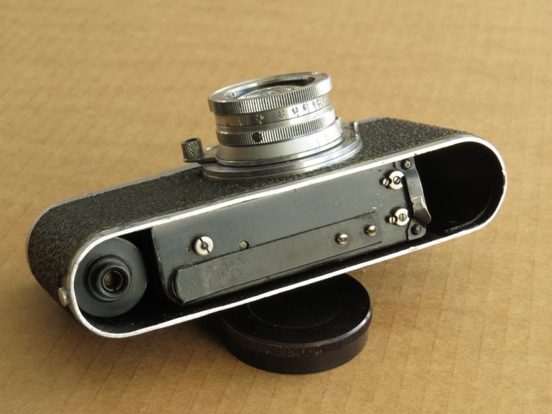

For the uneducated like myself here, what exactly is the baseplate? The bottom plate? and no visible screws you mean no screws? [:)] or sunk screws?

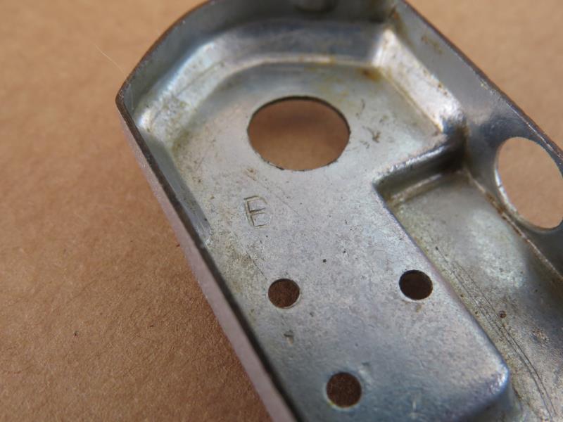

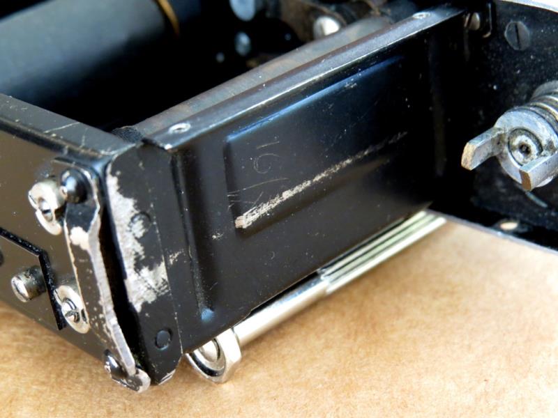

I don't have a Fed 1 to hand at the moment, but as far as I remember there are either two, or three countersunk screws visible on outside of the underside of the baseplate of every type of Fed 1 except for the Fed 1 e.(The baseplate meaning the removable bottom plate of the camera).
On The Fed 1 e that I have these screws are not visible, (The baseplate is "clean" apart from the thumb twist for baseplate removal) As far as I know this physical difference applies only to the fed 1 e "Berdsk". I wish I had the camera with me at the moment so that I could explain more fully, but perhaps Bill, or Jacques can clarify this point better than I am able.
Best regards, Jim[:)][:)][:)]
Reply author: James McGee
Replied on: 20080530025936
Vlad, Hello again. I need to make a correction about what I said earlier regarding the baseplate screws on the Fed 1 as I may have mislead you. I had said that no screws were visible on the baseplate of a Fed 1 e, when in fact there will be three visible screws, (I had fogotten the screwed tripod mount) which is held by three visible screws.
Now that I remember, there are in fact five screws on the baseplate. Three holding the tripod mount, and two other screws about one and a half inches, or 4cm apart in the centre, and towards one edge of the baseplate. On some Fed 1e,"Berdsk" it is these two latter screws that are not visible.
As far as I can say, if you have doubts about about whether your camera is a "Fed 1 e Berdsk" and it doesn't have these two screws as on all your other Fed 1 cameras, then it is definately a "Berdsk". I hope that I have explained myself clearly this time, if not no doubt others can correct me.

From September to December 1941 -- the evacuation to Berdsk.
According the GKO order from 23.10.1942 all plant optical manufactory transferred to NKV.
In 1942 all FED electric drills manufactoring was transferred to Tushino, Moscow.
Labour Red Banner (Flag) order decorating -- 16 September 1945.
From 09.09.1946 -- the re-evacuation to Kharkov.
A recommencement -- up to 1948 year.

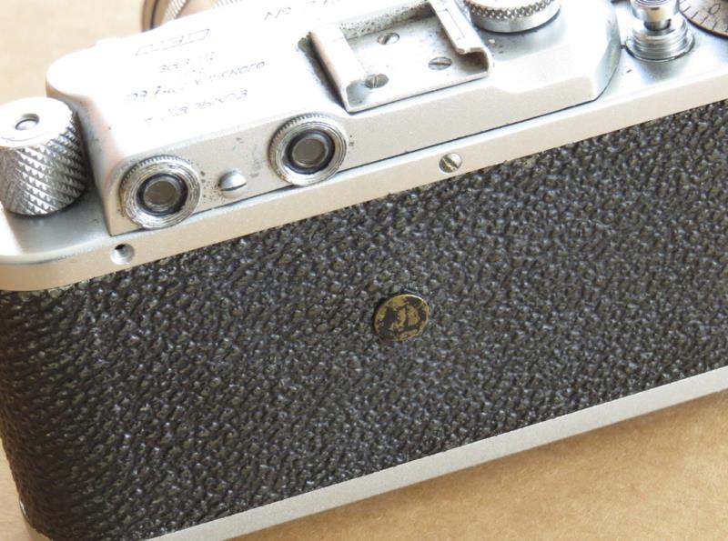

Jim, I still have 5 visible screws on my 1e.. I don't think these screws mean much... they probably went away with them sometime in mid-production of 1e... My serial # is somewhere above in this forum thread.
Replied on: 20080530235757
As far as I know, (and I could be wrong) if a Fed 1 has only three visible screws in the base, then it is definately a Fed 1 e, assuming that other parameters are correct, engraving, etc.
I assume that there are also quite a few of these cameras with five visible screws, so they are also genuine Fed 1 e, providing other criteria matches of course.
I really can't imagine that anybody would try to fake one of these cameras when could just as easily fake a "Red Flag" and ask a much higher price.
My particular Fed 1 e has only three visible screws in the base, and to be perfectly honest I would never have noticed but for reading about this in Princelle and later checking just out of interest and curiosity. JLP himself says that only some Fed 1 e camera baseplates show this difference, but he doesn't say how many.
Cheers,Jim.[:)][:)][:)]

I agree with you about that question of screws, Nathan. It was easy to mix bodies and baseplates at the factory and it is always the case now.
About the period 1941-46, there is another passport, always at DVD's, which is very interesting and puzzling. It is the one of a 1d, signed the 18/06/1941, serial number: 168018 for a "normal" 1d(non S). Previously, we had discussed of a 1eS # 180024, passport signed the 31/07/1941.
The substraction is easy: 12000 passports in 45 days, 270 passports in a day... It seems impossible, but we know absolutely nothing about the local and historical circumstances.
Or one of the passports is a fake, but I don't think so. And the 1S don't have a special range: they were always numbered amongst the regular NKVD.
Personally, I always think that our hypothesis (1e made in Kharkov till # c. 180000) is valid. The factory probably signed in a hurry the passports for all the finished cameras (perhaps even for non finished ones). But where did they go? Certainly, they were not sold. To the Red army, perhaps? To be sure, we should know the precise history of these last days...
Any idea about that period of history?

BTW, In my earlier post regarding the three visible screws as opposed to five in the base plate of some FED Berdsk's perhaps I didn't explain as clearly as I might have.
As far as I can gather some Berdsk's have only three visible screws in the baseplate, and other Fed Berdsk's have five visible screws. The three visible screws applies only to the Fed Berdsk, and no other Fed-1, so if only three screws are visible, and other parameters are correct then I believe that the camera is without doubt a Berdsk.
Of course there are also some Fed Berdsk with five screws in the baseplate just as all other Fed-1's.
And just to confuse matters more, we don't even really know for sure if these cameras were ever assembled at Berdsk.
Will the Fed mystery ever end????
Regards, Jim[:)][:)][:)]

My three FED-1e, two of which are FED-S, all have 5 screws in the baseplate.
There is currently a late FED1-e camera #182948 on ebay which also has 5 screws.
http://www.ebay.at/itm/FED-NKVD-Type-1e-BERDSK-Rare-Russian-35mm-Rangefinder-Camera-182948-/360706589152?pt=US_Vintage_Cameras&hash=item53fbc9c1e0
Another one, #176596 seems to have only 3 screws but it's a little hard to see.
http://www.ebay.at/itm/USSR-Soviet-Collectible-FED-1-Berdsk-35mm-RF-camera-with-FED-3-5-50-lens-EXC-/390554007760?pt=Film_Cameras&hash=item5aeed538d0
I found something else - we have two consecutive FED1-e serials, one of which is a FED-S.:
#174290, sold on eBay
#174291 (1/1000 speed - Fed-1S), sold on eBay
Christian
Replied on: 20130801084815
My 1e-s have five screws too.
So, we are not far from s/n 184000 now. Interesting...
The two consecutive serial numbers are interesting too. So it would be confirmed that the S-s were made in the normal production, "in the middle of" the other cameras. To be sure, we should have the s/n 174289 or 174292!... I personally have two cameras with consecutive numbers, an S and a NKVD c series.
Reply author: ricale
Replied on: 20130801110032
I have 2 Fed 1e, all with 5 screws.

Check the engravings on the baseplate of this FED1e #179708:
http://www.fotoua.com/4colcam.php?seek2=34&seek1=28&usl=&usl1=&rd=4&st=7&collector=1&stat=
Could anyone translate what it says?
I read something about 41-45 which would suggest a post-war date, at least for the engraving.

We know the passport of #180024, dated 31/July/1941, long time after the war started on 22/June/1941. The battle of Kiev was from 23/August/1941 till 26/September/1941. It's amazing that they were still producing cameras at the end of July. To write a passport and sign it just takes a minute. It doesn't make sense to write a passport in advance because once you want to package the camera you need to search for the passport. I think it's safe to assume that #180024 was packaged on 31/July/1941, a Thursday.
It is mentioned that A.Braslavskiy has another passport of #175116 from summer 1941. It would be interesting to know the real date because we could calculate how long it took to produce nearly 5000 cameras, and we could calculate how many days it would take to produce the rest of the known Fed-1e. Is #183892 the highest known serial for a Fed-1e?
After the war the last samples of Fed-1e might be assembled and the Red Flag too. Photohistory.ru mentioned that 1316 cameras were produced in 1948. Since the passport of #201280 is from 19/August/1946, those 1316 cameras can't be all Red Flags. The first Fed-1f might have been produced in 1948.

Replied on: 20160417162404
FED #210033 was made 10 july 1948. Coll. D.Bessonov
Reply author: Lenny
Replied on: 20160417174859
<blockquote id="quote"><font size="1" face="MS Trebuchet, Arial, Helvetica" id="quote">quote:<hr height="1" noshade id="quote"><i>Originally posted by levonsa</i>
<br />FED #210033 was made 10 july 1948. Coll. D.Bessonov
That's interesting.
So Fed produced Fed-Zorkis with 1/1000 speed together with KMZ in Krasnogorsk
and at the same time produced Fed-1f with 1/500 speed in Kharkov.
Replied on: 20160418051700
Thanks, Alexey.[:)]
Could you give too the address of the passport?
I suppose that this very early Fed 1f has a special vulcanite?
Reply author: levonsa
Replied on: 20160420153031
I will ask permission from the owner to publish his picture.
Replied on: 20160422172502
http://www.ussrphoto.com/resize/resize_image.aspx?ImgWd=800&IptFl=/UserContent/2242016_1.jpg
http://www.ussrphoto.com/UserContent/2242016_1.jpg
http://www.ussrphoto.com/resize/resize_image.aspx?ImgWd=800&IptFl=/UserContent/2242016_2.jpg
http://www.ussrphoto.com/UserContent/2242016_2.jpg
http://www.ussrphoto.com/resize/resize_image.aspx?ImgWd=800&IptFl=/UserContent/2242016_3.jpg
http://www.ussrphoto.com/UserContent/2242016_3.jpg
http://www.ussrphoto.com/resize/resize_image.aspx?ImgWd=800&IptFl=/UserContent/2242016_4.jpg
http://www.ussrphoto.com/UserContent/2242016_4.jpg
Reply author: Lenny
Replied on: 20160423005859
Thank you very much Alexey,
FED made some ugly cases at that time.
Very sad that the vulcanite got painted.
I can't read the address, but it seems to be the new location.
Replied on: 20160423034435
Thanks a lot, Alexey!
A beautiful 1f, probably one of the first. I wonder if the official numbers don't begin with 210000, even if we find some 1f between 201800 and 210000, perhaps to fool the Plan!
This one has that ultra rare vulcanite. Some of the others have a Red Flag's one, with stretched stripes... My s/n 210921 is already completely regular.
Could somebody translate the location of the factory, so that we can make comparisons with the pre war ones?
Thanks again. Amitiés. Jacques.
Replied on: 20160423102254
Alexey, very interesting example, thanks for posting! Jacques, the address on this passport on the bottom now is simply - City of Kharkov, FED, Marketing Department.
Replied on: 20160426073812
Thanks, Vlad. So, we don't know more about that question of location.
The passport of this very camera is coherent with the JLP which mentions that "the first 20 new Kharkov Feds were made in june 1948".
But the series begun with the s/n 210000...
Reply author: Alfa2

Which number had the FED plant before the war in Kharkov? Was it plant #296?
Thanks

Reply author: Lenny
Replied on: 20160503120059
Thanks Alexey,
so I guess when Fed was Kommuna under the NKVD it was plant #296.
Did the number change when they came under the NKAP in Febuary 1941?
Did they keep the plant number in Berdsk?
Did they have the same number when they relocated to Kharkov again in 1946?
What are the plants #297 and #393 ?
I just want to comletely understand what Zoom wrote in this thread. Zoom mentioned plant numbers with important decisions.
Thanks

Reply author: Lenny

Replied on: 20160504113209
<br />Huh? Yoshkar-Ola? I thought it was Berdsk??? Alexey??
Astonishing!
Vlad, please, could it be possible to have a traslation of this line "19"?
I see that KMZ is quoted, with the year 1943.
Thanks. Jacques.
Replied on: 20160504114144
Jacques, it says:
Factory and from where relocated: Ukraine, FED Labor Commune (City of Kharkov)
Factory Number (?): 3 (NKVD), 296 (NKAP)
Place of relocation: City of Yoshkar-Ola (huh?)
Final destination after de-evacuation: Partial re-evacuation to Krasnogorsk, KMZ 1943
Destination Factory Number: 393
Replied on: 20160504132358

Replied on: 20160505122230
Alexey, Lenny, I'm still hung up on the Yoshkar-Ola.. Berdsk is 2500km east of that city! I guess it's possible that FED with its equipment didn't fit entirely into Yoshkar-Ola plant and was moved further and camera/optical division ended up in Berdsk.. strange..
Reply author: Lenny

Replied on: 20160505135605
<blockquote id="quote"><font size="1" face="MS Trebuchet, Arial, Helvetica" id="quote">quote:<hr height="1" noshade id="quote"><i>Originally posted by Niko80</i>
<br />
Also I'd like to point out that I am now the owner of the FED"e" #180024 with the corresponding documents. If there is any information I can provide just let me know.
Christian
Hi Christian,
the documents I saw are not a dated passport. What I saw was a small paper dated 31/July/1941, maybe a documentation that the camera was complete and checked. Are there other dated documents?
Thanks

What is the highest serial number for a 1e in your database? If there were so many top plates made unassembled we should have found them already. As I said before, left over parts were transferred to KMZ and they recycled everything.
I ask about the passport of #180024 because someone mentioned it in the wiki. If there is no passport I would like to correct the mistake. I think too that the papers I saw about #180024 look original, I don't doubt them, I used them for my calculation. I only would like to be correct in the wiki.

Regarding vulcanite there are some rules but there are exceptions too. I saw original vulcanite of FED NKVD but not black, the colour was like coffe with milk. We had discussion about it with my colleague - art historian who is really interesred in old FEDs.

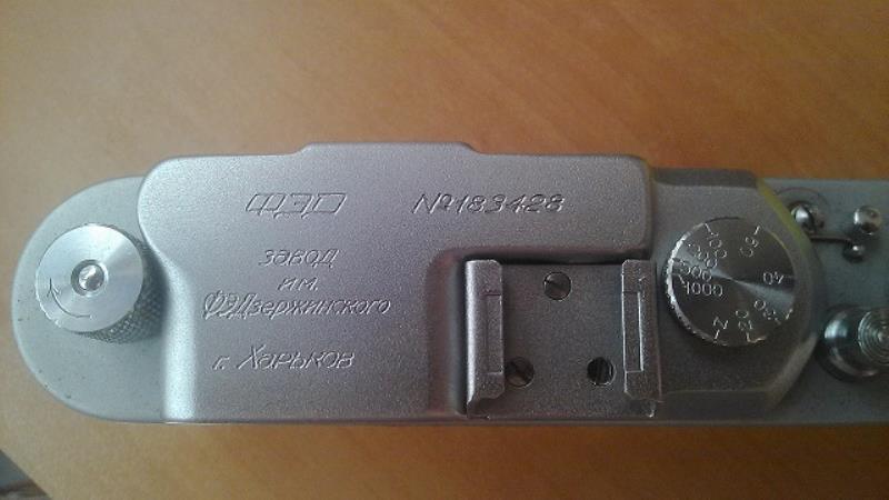

Thanks Jacques,
so you check only the bottom plate of the shutter crate, right.
Strange, so my #182393 could be a fake which I doubt, could be postwar which I doubt too, and my #221333 is also a mystery. Both I got very cheap [:)]
We need more samples for brass and alloy crates in the serial range #170.000 till #250.000 please.

<blockquote id="quote"><font size="1" face="MS Trebuchet, Arial, Helvetica" id="quote">quote:<hr height="1" noshade id="quote"><i>Originally posted by Zoom</i>
<br />It is impossible to consider this delirium:
http://ussrphoto.com/UserContent/352016_IMG_0002.jpg
as a reliable source!
Now I see, it's page 88 from a book.
Which book is it?
The 1200 camera book?
Reply author: Alfa2

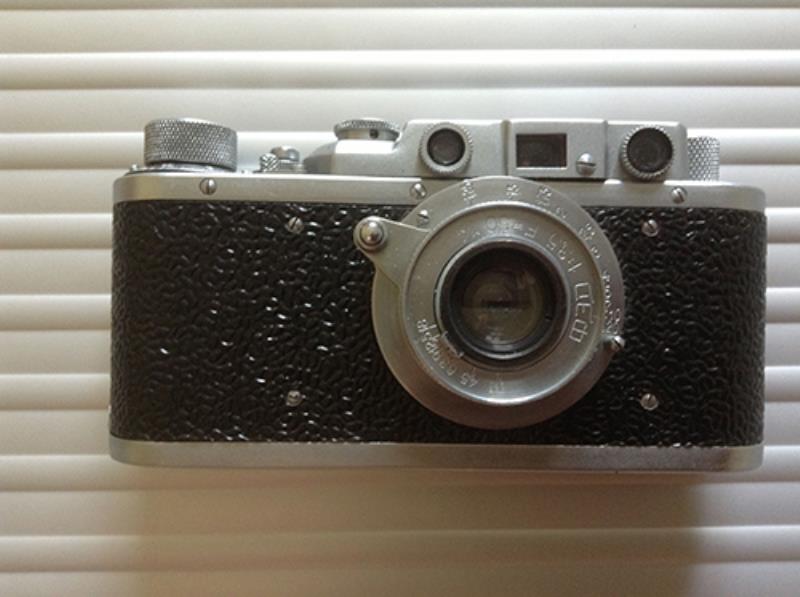

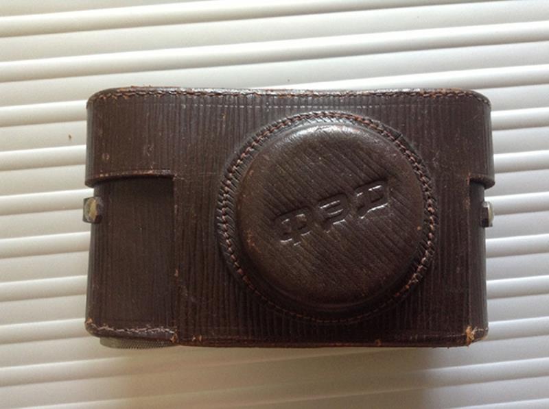

Replied on: 20160508132837
I promised to place photo of my FED. It's number is 210 193. Hmmm, strange camera.
Here they are.
http://i1238.photobucket.com/albums/ff500/Planistigmat/fed21.jpg
http://i1238.photobucket.com/albums/ff500/Planistigmat/fed22.jpg
http://i1238.photobucket.com/albums/ff500/Planistigmat/fed23.jpg
http://i1238.photobucket.com/albums/ff500/Planistigmat/fed24.jpg
http://i1238.photobucket.com/albums/ff500/Planistigmat/fed25.jpg
http://i1238.photobucket.com/albums/ff500/Planistigmat/fed26.jpg
http://i1238.photobucket.com/albums/ff500/Planistigmat/fed27.jpg
http://i1238.photobucket.com/albums/ff500/Planistigmat/fed28.jpg
http://i1238.photobucket.com/albums/ff500/Planistigmat/fed29.jpg
http://i1238.photobucket.com/albums/ff500/Planistigmat/fed30.jpg
Replied on: 20160508143639
Exceptional!
The NKAP vulcanite, and the prewar release button!
One of the very first 1f...
Congrats, Alfa! Jacques.
Reply author: Lenny
Replied on: 20160508161529
Thank you so much Alfa,
what a beauty. How many years do you have it?
Reply author: Lenny
Replied on: 20160508162049
Sad, it's not working, right?
Reply author: Alfa2
Replied on: 20160509014656
Thank you Jacques, thank you Lenny.
I have the FED about 15 years. Unfortunately it is not working now but it was working when I bought it. I think this is only problem with glue which is used for a shutter ribbon to glue it to a roller. Good that the FED is complete and I will fix it during winter when my repairman has less orders than during summer.
Reply author: Lenny
Replied on: 20160509024628
<br />
I had that problem too on a Zorki-C, the glue wasn't strong enough on the drum. But good you have someone to fix it.
Great you have it for so many years, it's kind of a reference to be original. And #210235 has this stretched stripes vulcanite too, so it match with it.
Reply author: Alfa2
Replied on: 20160509040521
And #210235 has this stretched stripes vulcanite too, so it match with it.<hr height="1" noshade id="quote"></font id="quote"></blockquote id="quote"> That's great. I had the same doubts.
What about the lens S/N ? It seems to be OK, FED 210 <b>193</b> and the lens number <b>217</b> - little bit greater.
Seems they started lenses numbering from the beginning with FED 210 000.
What do you think ?

Replied on: 20160509050234
I think too it's a batch number (or a control number) rather a real serial number, by the s/n of lenses I know on other Fed 1f.
Reply author: Lenny
Replied on: 20160509074155
There is also a lens number on the lever but the lens needs to be screwd out off the helicoid to see this number.
It would be really interesting to resolve the secret of Fed lens numbers, but thousands of numbers would be needed.
This could be a challenge for ussrphoto.com with its thousand members.
Reply author: Alfa2
Replied on: 20160509104623
<br />There is also a lens number on the lever but the lens needs to be screwd out off the helicoid to see this number. <hr height="1" noshade id="quote"></font id="quote"></blockquote id="quote">I have checked the number. It is also 217. This confirms somehow it is not serial as you wrote it isn't. So this is lens without S/N.
This could be a challenge for ussrphoto.com with its thousand members. <hr height="1" noshade id="quote"></font id="quote"></blockquote id="quote">Great, we will have subject to talk about for next 10 years. [:)]
Reply author: Lenny
Replied on: 20160509155614
<br />Great, we will have subject to talk about for next 10 years. [:)]
That's for sure ... if you search every weekend in your boxes for some forgotten gems. I wonder about the other cameras you have. Poland is still a good place to get some great cameras.
Replied on: 20160509164823
FED #210033 ____ leans #209
FED #210073 ____ leans #3
FED #210193 ____ leans #211
FED #210266 ____ leans #6

Reply author: Lenny
Replied on: 20160510042725
<br />FED #210033 + lens &#8470;209 - it's attestat! Or a certificate of your too, is of no importance?
Alexey, where is #209 stamped? At the lock or away from the lock?
I think if you have to write a passport, you take the number which you can see. But there might be hundred lenses with #209. Can't be a real serial number.
Replied on: 20160510132331
Strange, but I have always believed that if the passport number of the lens is written such that it lenses all the same room! And not fiction forum participants!
Lenny, you are doing a lot for the order on the site. It's great! But I also like the position of the wise Jacques! You should never jump to conclusions faster, especially when it comes to the Soviet production. We must weigh everything, consult with all together and make a decision!
http://www.ussrphoto.com/resize/resize_image.aspx?ImgWd=800&IptFl=/UserContent/1052016_2.jpg
http://www.ussrphoto.com/UserContent/1052016_2.jpg
Reply author: Lenny
Replied on: 20160510144613
Alexey, thanks for the close up photo of the passport.
But you must admit that the first Industar-10 #209 made from Fed should be from the year 1934, a 1-turn lens. Then at some point in time, when Fed changed the serial system, there should be many other Industar-10 also with #209. Helpful would be a close up photo from the back of the lens with the whole M39 ring shown, and maybe even the number on the lever, but the lens needs to be screwed out off the helicoid. I hope we will know more about this I-10 serial system one day.
Thanks
Reply author: geoffox23
Replied on: 20160510145441
Lenny
You are comparing prewar with postwar numbering.
Postwar, lens numbering restarted and seems to have no logical system to tie to bodies.

No, I'm not comparing them, but there should be only ONE serial for each lens and not hundrets. To me, this is a kind of batch number, especially when it's not stamped at the lock.
For example, how did KMZ arrange the serial numbers. There could be TWO I-22 with the same serial #5211929, but one is with 'mm' from 1952 and the other is with 'cm' from 1955. It's still possible to separate them. There is only ONE serial for each I-22.
These I-22 are postwar too and are interchangeable on all Zorkis and each has it's own serial and isn't tied to any body.
Reply author: Lenny
Replied on: 20160510153602
Maybe a lens serial number wasn't important for Fed at some point. There are even 50/2 lenses without serial number before the war. It seems Fed didn't need the serials and the numbers stamped have a special meaning, for example to help regulation.
Then there is the girl who has to package the cameras and to write the passport and she writes what is given. But it's not a serial number!!!
Replied on: 20160510162756
Of course the serial numbers had a great importance for Fed! Like of any FSU production! If some (rare) lenses don't have numbers, we don't know why.
At this point, I don't understand really what we say, but perhaps it's not important [:)]
I just point that the first Fed lenses were 1 turn ones. They were numbered in very tiny ciphers too, which cannot be confused with postwar ones.
That said, by the passport showed by Alexey, the "209" seems a serial number, or I don't understand what is written before. It's "objective = lens", no? Or can it really be "batch of objectives?" Or anything else? We have to take that in consideration and think of what it will lead to. For me, at least, rather than thinking of who had written that...

Reply author: Zoom
Replied on: 20160512165941
<br />Happy to know that there are documents which prove that there were no Fed made at Berdsk during the war.
This article is not about the production of cameras in Berdsk. But, indeed, the FED production on the plant No.296 NKAP has been discontinued. The plant is fully switched to military production.
<br />My question was in fact more extensive: can we affirm that there were no Fed <b><u>mounted</u></b> during the war, at Berdsk or elsewhere? Are there documents too to prove that?
The FED factory (No.296 NKAP) gave all its optical part according the GKO order No.2445 (23 October 1942).
http://www.zenitcamera.com/archive/misc/gko-2445.html
All optical equipment, materials and so on were taken away. Nevertheless, a certain number of cameras left. According to the factory's history book, the plant began to assemble cameras in 1946, as I remember. But there is no documentary evidence to the cameras assembly before February 1946...

Replied on: 20160513002519
Thanks Zoom.
So, we are always at the same point, more or less. If I try to summarize:
All the Fed 1e could have been completely produced at Kharkov before evacuation. That said, the timing seems unrealistic by the passports we have (I have added dates and numbers found on Alexey's site):
- s/n 164716 : 18/3/41,
- s/n 168018 : 18/6/41,
- s/n 175118 : 21/6/41,
- s/n 175524 : 21/6/41,
- s/n 181100 : 30/7/41,
- s/n 180024 (S):31/7/41.
To produce 12000 cameras in 45 days is impossible. Were some cameras mounted elsewhere? Or are there "big" holes in the numbering, as the JLP suggests?
It is unlikely that cameras were produced at Berdsk's plant during the war. On the other hand, it's not completely impossible that some were only mounted from parts coming from Kharkov, after the evacuation.
All the remaining materials were transferred to Krasnogorsk in 1942. So, KMZ too could have played his part concerning the mounting of Fed 1e after the war. After all, there is no real difference in quality between Fed-Zorkis and Fed 1e.
Berdsk produced the NKAP "Red Flag", probably from already existing spare parts, in 1946.
Arsenal produced the Fed-Arsenal in 1946-47, in very small numbers, from existing and "home" made parts.
Fed-Kharkov resumed the production in june 1948 (the first Fed 1f).
What an entangled story... The main question remains of course the place of production/mounting for the 1e. We only have hypothesis, absolutely no certitude... Certainly, we miss a major fact?
Reply author: Zoom
Replied on: 20160513004738
<br />Link does not work
Corrected, sorry.
Reply author: Zoom
Replied on: 20160513005804
<br />
No. A personnel only. Their number is not known (a list of the names is incomplete). A few dozen people (maximum)...
Reply author: Lenny
Replied on: 20160513054324
<br />the timing seems unrealistic by the passports we have (I have added dates and numbers found on Alexey's site):
Jacques, as I understood it the Fed equipment was transferred to KOMZ in November 1942 and was stored there till it was transferred to Arsenal in Febuary 1945. KMZ might have gotten everything after Arsenal stopped producing as Altix assumed.
Why do you think of 12000 cameras?
Where did you find those 2 passports?
Reply author: Lenny
Replied on: 20160513055654
Jacques, now I understand why 12000. Forget about this passport #168018, it is out off the line of other passports.
It could simply be that they wrote 18 VI 1941 instead of 18 IV 1941 for #168018.
Replied on: 20160513064227
181100 - 168018 # 13000 cameras in 42 days. Of course impossible.
And 7000 cameras in 3 days it's impossible too!
The passport of the S s/n 180024 was established on a Kharkov paper. We don't know for the others.
Of course, the passports can have been filled in a hurry after the parts were made for the corresponding cameras. But it doesn't enlighten the whole question.
We have a real problem of comprehension between number of cameras/passports/location of production concerning these Fed 1e.

Reply author: Zoom
Replied on: 20160513155408
<br />...and they set up a table with information about Joschkar-Ola, which Zoom calls a not reliable sourse and a piece made in delirium.
The Kinap plant from Odessa was transferred to the plant No.297 NKV in Yoshkar-Ola.
Used documents:
GKO Order No.374ss -- August 2, 1941.
GKO Order No.681ss -- September 16, 1941.
Cited also: The Economic Council of the SNK USSR Order No.1880-564s -- December 6, 1940.
Source: Russian State Archive of Socio-Political History (RGASPI), fund (ôîíä): 644, inventory (îïèñü): 2, cases (äåëî): 10 (list 39, par. 16) and 18 (list 84).

Good evening guys! why do you think that this is the date of manufacture? I now intended that this date of packaging. and the production of the marriage took place, in consequence of that, some parties came back to troubleshoot.
Reply author: Lenny
Replied on: 20160514173233
<blockquote id="quote"><font size="1" face="MS Trebuchet, Arial, Helvetica" id="quote">quote:<hr height="1" noshade id="quote"><i>Originally posted by elnur</i>
<br />Good evening guys! why do you think that this is the date of manufacture? I now intended that this date of packaging. and the production of the marriage took place, in consequence of that, some parties came back to troubleshoot.
Hello Elnur,
I don't exactly understand what you want to say,
but congratulations to your FIRST POST.
Replied on: 20160515003209
Welcome Elnur, it's great to have another big FED expert in our midst! What Elnur is trying to say ( I had earlier conversation with him) is that the dates on passports are not the dates of manufacture but the dates of sale. Not all of batches of these cameras would get sold at the same time. These dates on passports are filled in when the cameras are sold, sometimes they would be sold in different sequence and sometimes would sit on shelves of the store for a while so the dates are not actual manufacture dates. Also when cameras are returned to factory for repair because of defects they would get issued new dates on passports.
It's a pleasure and honor to have you here, Elnur! I hope to see more of your participation!
Reply author: Lenny
Replied on: 20160515023820
Thanks Elnur.
This makes sense, that the passports were written when the cameras were packaged for sale.
It doesn't make sense that passport dates were written in advance, because once they needed to package the cameras they would need to search for the passports, when writing a passport just takes 1 minute.
Of course the cameras were not sold consecutive to their serial numbers. Cameras with higher serials could be sold earlier.
Later this might have changed little bit when they only wrote the month and year in the passports.
Replied on: 20160515035442
Thanks, Vlad, and welcome to you, Elnur!
So, passports show the date of sale. That completely changes the point of view, of course! No possibility to calculate a precise production from the serial numbers, for example. And the 1e were very probably made entirely before the evacuation. No more problem, unless perhaps about the last ones. Were they sold too? When? Always before evacuation? Or reserved to the Red Army, as I had guessed somewhere, half by joke?[:)]
No doubt you will help us to put some missing pieces on this entangled puzzle, Elnur. Thanks...
Reply author: elnur
Replied on: 20160516095825
Thank You all for the warm welcome! I am very pleased )
About packing cameras. I'm certainly not a historian, and do not have enough facts to say it all. But a fresh idea will not harm us. I did not mean that the passports were written in advance. But on the contrary that there had been a batch of cameras, which later had to undergo some checking. After the devices are tested, Packed and were issued certificates. And the devices that were problematic were returned for repair. And possibly from the earlier numbers, but with the late date in the certificate. I think that's why there's the confusion.
Replied on: 20160516104915

Reply author: elnur
Replied on: 20160516124012
and one more 177572 from 1st of July 41
http://www.ussrphoto.com/resize/resize_image.aspx?ImgWd=800&IptFl=/UserContent/1652016_pr1Pp27EESg.jpg
http://www.ussrphoto.com/UserContent/1652016_pr1Pp27EESg.jpg
Reply author: Lenny
Replied on: 20160516131035
Thanks Elnur,
on the passport I read #177512. Is the camera #177572 ?
Reply author: elnur
Replied on: 20160516134915
Oh, sorry. You r right Lenny. Made mistake.

Reply author: Aleksandrov66
Replied on: 20160518071824
Good day everyone!
Yesterday i was offered to buy (i didn't) camera n.183428.
I'd like to share a photo (s\n is already in the wiki):
http://www.ussrphoto.com/resize/resize_image.aspx?ImgWd=800&IptFl=/UserContent/1852016_untitled.jpg
http://www.ussrphoto.com/UserContent/1852016_untitled.jpg
Unfortunately, i got only one picture.
Reply author: Lenny
Replied on: 20160518074234
Thanks Aleksandrov,
it's really amazing that so many Fed-1e look so good,
as if they were never used,
as if they were not bought from someone who wants to use it,
as if they were gifts maybe for outstanding military performance.
I put it in the wiki under FED-1e too, to be complete.
Reply author: Alfa2
Replied on: 20160518074348
Why it has 1/1000 ?
Was it FED S ?
Reply author: Lenny
Replied on: 20160518075633
<br />
Why it has 1/1000 ?
Was it FED S ?
#183321 is listed with 1/1000 too, so this makes sense too.
Replied on: 20160518085921
that's a FED-S, I have a 1e FED-S also with 1/1000 but regular 3.5 lens. Will look at serial # later if you guys are interested. it's in 17XXXXX range..

Giving the right url and translation of Zoom page:
<b>http://www.zenitcamera.com/archive/misc/gko-2445.html</b>
Top secret
Ruling
State Defense Committee
Number 2445 cc
Moscow Kremlin
October 23, 1942
On the selection of opto-mechanical production from the plant number 296 Narkomaviaproma and transfer it to the system Narkomvooruzheniya
State Defense Committee decided:
1. Cancel Item 4 Resolution GFCS 2140 pp 1) of 4 August 1942 relating to the transfer of the plant number 296 2) Narkomaviaproma’ in Narkomvooruzheniya’ system.
2. To instruct the Narkomaviaprom - T Shakhurin pass before November 1 of this year on factories Narkomvooruzheniya optical optical-mechanical manufacturing factory number 296 in the formulation.:
a) all work in progress for all opto-mechanical, civil and military instruments, manufactures and previously produced on the factory number 296;
b) all equipment, tools and equipment for the production of optical components and assemblies of optical instruments and 30% of the total number of factory normal cutting and measuring tools for metalworking;
c) reserves all metals, glass and other optical materials available in the plant for production of opto-mechanical devices;
d) metal cutting, optical and other equipment, according to Annex 3);
d) all workers, engineers and technicians working in the optical and assembly plants in the optical manufacturing plant and 20% of workers in the mechanical and instrumental workshops.
3. To instruct the Narkomvooruzheniya - ing. Ustinova translate transmitted, according to paragraph 2 of this resolution, optical-mechanical part of the production plant number 296 on the Siberian group of optical factories Narkomvooruzheniya 4).
4. To instruct the People's Commissariat - ing. Hrulev select cars in the amount and timing of application Narkomvooruzheniya for transportation of equipment, materials and people from the factory 296 Narkomaviaproma (Mountains. Berdsk Novosibirsk Region) optical Narkomvooruzheniya plants.
Chairman of the State Defense Committee
I. Stalin
xxxxxxxxx
Top secret
Comrade I. V. Stalin
Here we present a draft Resolution of the State Defense Committee, "On the selection of opto-mechanical production from the plant number 296 Narkomaviaproma and transfer it to the system Narkomvooruzheniya".
Currently, the plant number 296 manufactured pumps for direct injection aircraft engines, power tools and military optical instruments.
Available in three different factory production complicates the process and does not provide further their normal development.
The draft regulation provides for the allocation of optical-mechanical manufacturing plant number 296 on Narkomvooruzheniya plants and leaving the factory number 296 in Narkomaviaproma system for the production of pumps and power (motors) of direct injection.
L. Beria
D. Ustinov
P. Dementiev
October 22, 1942
Nº LB-2788
Narkomaviaprom - National Comitee of airplane production
Narkomvooruzheniya - National Comitee of weapon (production)

Here another camera to add to the list, &#8470;175553 from a seller on ebay
https://www.ebay.com/itm/FED-BERDSKI-type-1e-Vintage-WWII-1945-Russian-Original-Camera-copy-Leica-II-D/143657847916?hash=item2172accc6c:g:F7IAAOSweFhewZH4
It seems strange inside, looking from the opened bottom... what's your feelings?
Reply author: basic-collector
Replied on: 20200725110208
Two more... n.179919 https://www.ebay.com/itm/RARE-FED-1-E-Zorki-NKVD-sn-179919-1-3-5-F-50M-M-Original-Case-1000pcs-serie/373007503343?hash=item56d8facfef:g:w64AAOSwv-ledOPm
and n.176931
https://www.ebay.com/itm/FED-Type-1e-Berdsk-Rangefinder-Camera-3-5-50-M39-Leica-Mount-USSR/174310750899?hash=item2895bafab3:g:-hAAAOSwYfBe3ojC
The interesting thing is that each seller tells a different story ... :-)
Replied on: 20200726091322
<blockquote id="quote"><font size="1" face="MS Trebuchet, Arial, Helvetica" id="quote">quote:<hr height="1" noshade id="quote"><i>Originally posted by basic-collector</i>
<br />Here another camera to add to the list, &#8470;175553 from a seller on ebay
Yes, I had seen it.
It looks like a spring for cameras with a delaying mechanism. Probably a home made modification...

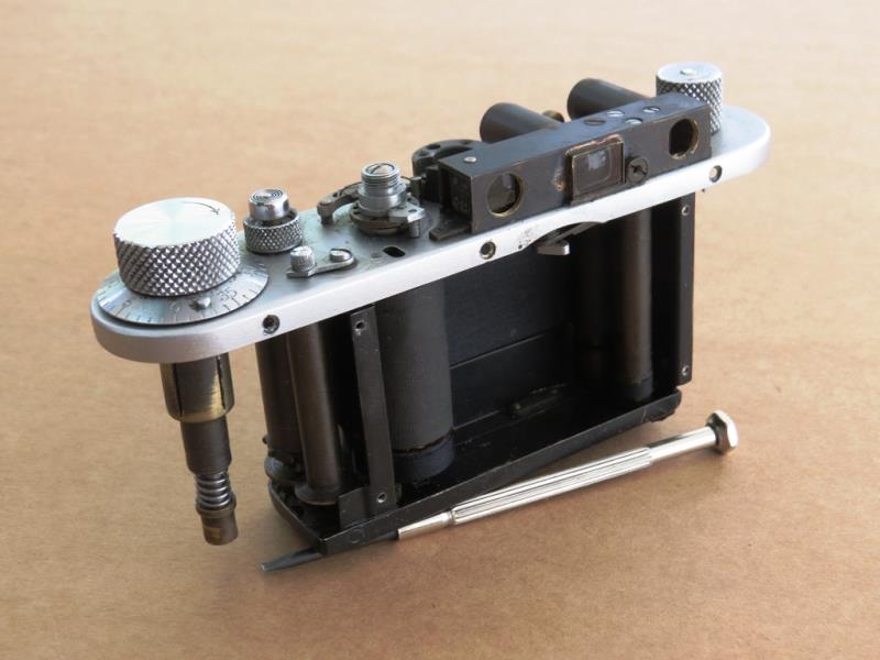

Replied on: 20200811095647
I have just dismounted my 1e s/n 183613 (though very reluctantly) to know more about that camera. Here are some photos:
/UserContent2/1182020_IMG_0152.JPG
http://www.ussrphoto.com/UserContent2/1182020_IMG_0152.JPG
/UserContent2/1182020_IMG_0161.JPG
http://www.ussrphoto.com/UserContent2/1182020_IMG_0161.JPG
/UserContent2/1182020_IMG_0169.JPG
http://www.ussrphoto.com/UserContent2/1182020_IMG_0169.JPG
I have plenty of others, if necessary!
Replied on: 20200811101445
At first sight, all seems correct for a 1e. Except, of course, the date 16/X. If this camera is completely original, that would mean that some very late 1e were mounted after the evacuation, possibly at Berdsk.
Concerning this s/n 183613, the shutters are original, and I found nothing really strange when taking it to pieces, except that the lensplate is not shimmed, and that it seems not perfectly centered on the body. Perhaps difficult conditions of mounting at Berdsk?
The last 1e known is the s/n 183906, by Alexey Nikitin's site. As far as I know, we don't know the internal inscription of date on the very late 1e.

A 1e more here. In fact, an S with a surprise:
/UserContent2/2112023_IMG_0924.JPG
http://www.ussrphoto.com/UserContent2/2112023_IMG_0924.JPG
The "20-1" was engraved for the Fed B: coupling with the slow speed machanism. Rather rare!
All the rest is common, alas. I hoped some traces on the shutter box, but all is regular...
/UserContent2/2112023_IMG_0925.JPG
http://www.ussrphoto.com/UserContent2/2112023_IMG_0925.JPG
/UserContent2/2112023_IMG_0927.JPG
http://www.ussrphoto.com/UserContent2/2112023_IMG_0927.JPG
Replied on: 20230121092101
I had forgotten: 31 VIII (1941) is engraved inside on the shutter box. It's the last day found for these cameras, though the last s/n is 183892 in our wiki, 183906 by Alexei Nikitin's site...
Was this camera delayed for some reason, or the mounting at the factory went on later in september?
