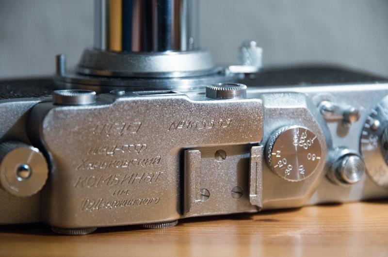

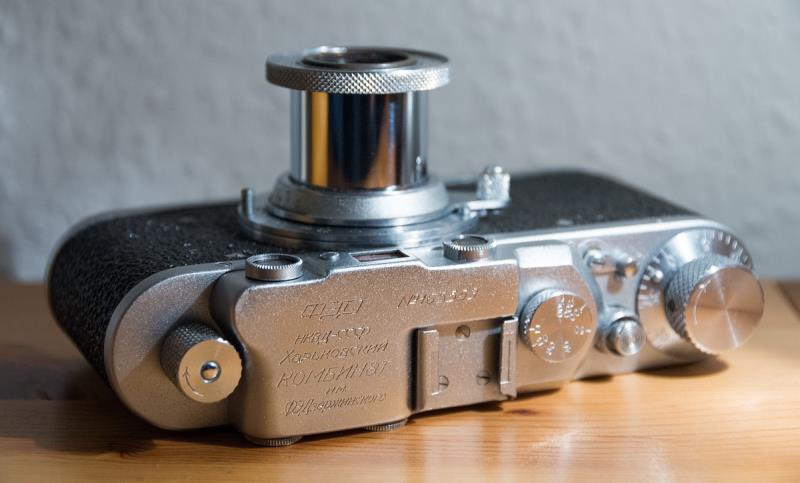

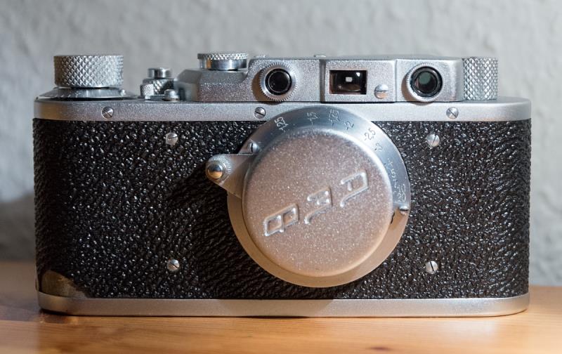

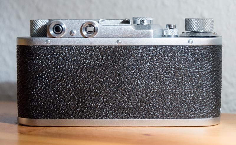

so, now I have also received such a strange FED here. It has the serial number 165553 with a matching lens with the number 164785.
Compared to my 169520 I see absolutely no difference, both cameras look identical. Even the lens cap is the same (large, deeply embossed FED name).
The vulcanite looks the same, the engraving on the cap looks the same. The only difference is that all the body screws have a much flatter head, still slightly curved, but not as much as on the FEDs. The best thing is that all the screws look like new, so it has obviously never been opened. As far as I can see, 20/III or 20/II is engraved on the inside of the case. But I won't be able to see it more precisely until I take it apart.
Replied on: 20241207111142

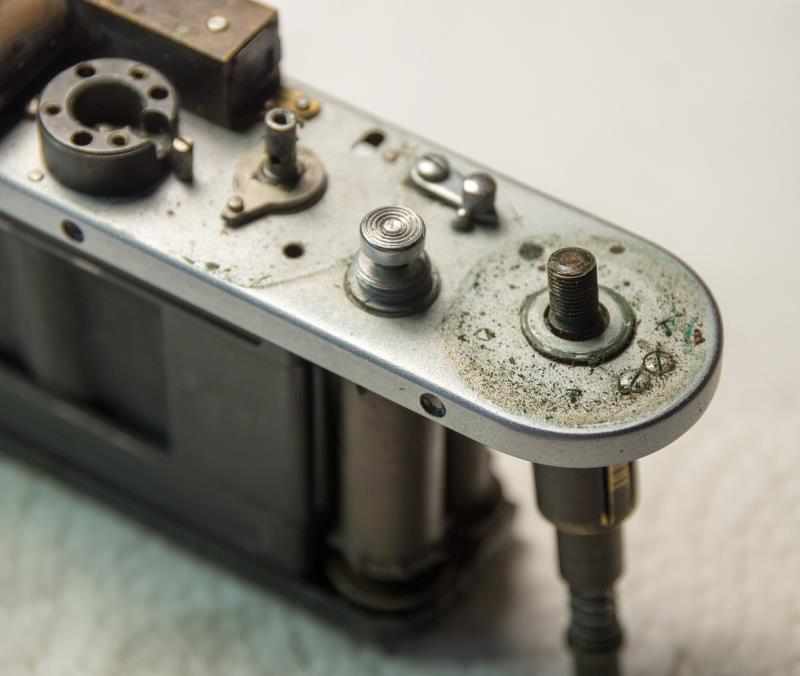

So now I've taken it apart and cleaned it. Of course, the sealing cloths were ruined, as is often the case.
The camera has really never been opened, all the screws on the outside and inside were perfect with no damage from the wrong screwdriver.
Unfortunately a piece of the leather is missing, otherwise it is perfect. And look at the decades of dirt under the cocking knob...
The date scratched on the shutter housing is 20/III

Replied on: 20241208073906
Your remark about the screws is very interesting, Ulrich.
The internal date (20/III) corresponds to 1941, and seems OK for the s/n 165553.
The same for your 169520 with 22/IV inside.
But we have in the wiki the s/n 168018 (inside the 166617-172385 range) with its passport dated the 18/06/41, from Kharkov Lesopark 54... That one should not have been made at Berdsk.
