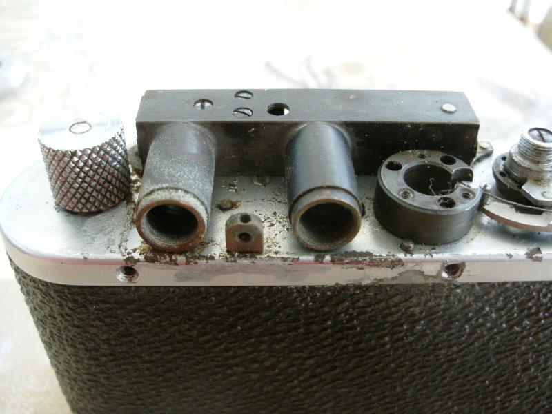

Posted - Jul 04 2015 :  3:52:43 PM  Show Profile  Reply with Quote
I have just received the camera. I can confirm it was originally a 1940/41 Fed:
- there is no hole in the press film (after c. s/n 150000)
- the release button is of the 1d/1e type,
- the two plates are made of iron. It was not the case before the s/n # 150000, it will not be the case for the postwar Fed, including my Red Flag (checked with a magnet).
So, I think this camera could be a genuine Fed-Arsenal, if these cameras ever existed...

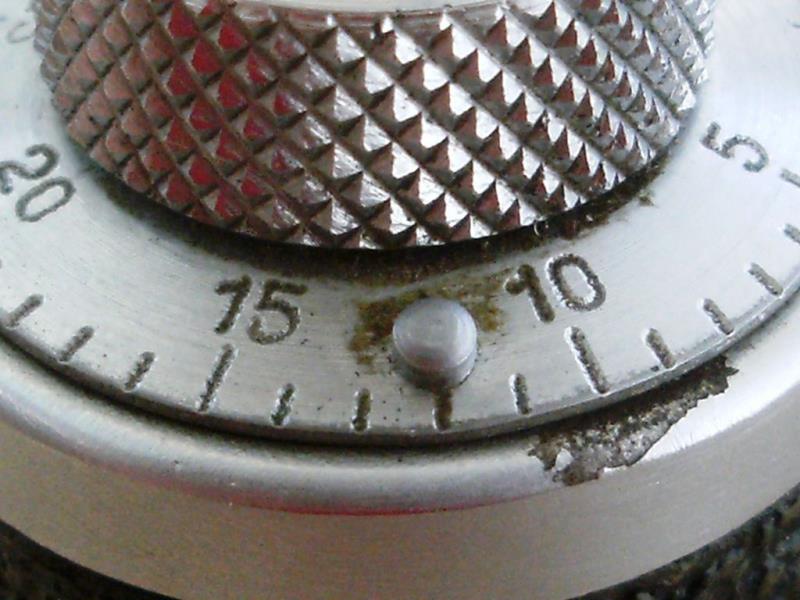

There are some details which are original:
http://www.ussrphoto.com/UserContent/472015_DSCF2165.JPG
The speed dial has engravings never seen on Feds.
2589 Posts
Posted - Jul 04 2015 :  3:56:51 PM  Show Profile  Reply with Quote
The winding button has an unusual arrow and the frame counter has original engravings and a special position of the pins: between 10/15 and 30/35 rather 15/20 and 0/35:
http://www.ussrphoto.com/UserContent/472015_DSCF2168.JPG
http://www.ussrphoto.com/UserContent/472015_DSCF2167.JPG
2589 Posts
Posted - Jul 04 2015 :  4:06:14 PM  Show Profile  Reply with Quote
So, the engravings are much deeper than on ordinary Feds. It is lighteron the cover:
http://www.ussrphoto.com/UserContent/472015_DSCF2163.JPG

2589 Posts
Posted - Jul 05 2015 :  03:23:51 AM  Show Profile  Reply with Quote
Two more photos.
An inscription under the pressure plate:
http://www.ussrphoto.com/UserContent/572015_DSCF2178.JPG
And rust on the upper plate:
http://www.ussrphoto.com/UserContent/572015_DSCF2170.JPG
A former owner tried to hide rust with metallic paint...

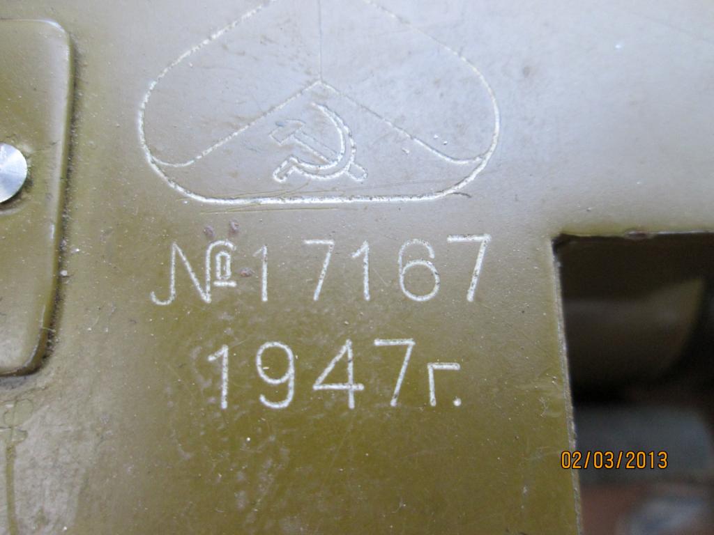

Posted - Jul 13 2015 :  03:17:58 AM  Show Profile  Reply with Quote
Hi everybody.
Arsenal logo existed prior to 1950. You can see it on military optical devices, theodolites from 1947. If you are able to have a look on the Kiev camera instruction manual from 1947-1948 you will find this logo as well.
Concerning the Fed Arsenal camera it is genuine. Two versions are known: early with logo with hammer and sickle and later ones without hammer and sickle on the logo.

152 Posts
Posted - Jul 13 2015 :  3:59:55 PM  Show Profile  Reply with Quote
Dear Bill,
I do not know if some documents were preserved (except probably blueprints or documentation). I never saw any passport for this camera and the possibility that there exists one is zero. As far as i know nor more than 400 pieces were ever made. What I've heard is the recollections of old former workers. I trust them since many things what I've heard from them later was proved by documentations or some artifact finds. It is quite easy to find the documentation of more recent cameras and optics since some designers are still alive and they have their own archive. Of course workers or camera assemblers have no such drawings or documentation and they can only recollect what they saw.
I know that this sounds silly and you may not trust me since I cannot provide any documentation. Remember that Arsenal is strictly secret object even today and its archive is closed for any research. Almost everything that I could find about the early post-war period of Arsenal comes from the Zeiss Jena archives.
I told Jacques about the existence of this camera for a long time ago and I think he still does not believe in its originality despite he managed to buy one.

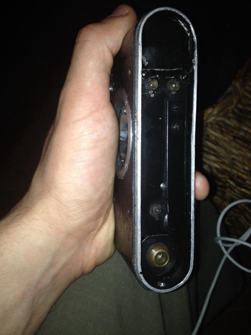

Concerning the second type of the FED Arsenal I put some photos with the agreement of the owner. I know the history of how this particular camera has found the new owner and I have no doubts about its originality (I will not tell you explicitly where this camera were previously but you can easily guess why I am so sure)
http://www.ussrphoto.com/UserContent/1372015_2.jpg
http://www.ussrphoto.com/UserContent/1372015_3.jpg
http://www.ussrphoto.com/UserContent/1372015_5.jpg
http://www.ussrphoto.com/UserContent/1372015_7.jpg
http://www.ussrphoto.com/UserContent/1372015_8.jpg
And concerning the Arsenal logo, here is some proof that it existed say in 1947
http://www.ussrphoto.com/UserContent/1372015_1a.jpg

Posted - Jul 13 2015 :  4:17:00 PM  Show Profile  Reply with Quote
Another little thing. The FED Arsenal was produced in another place as Kiev-Contax cameras. Here is this building
http://www.ussrphoto.com/UserContent/1372015_comparison.jpg
This is an old Arsenal workshop that more or less preserved after the war. So the munition and FED Arsenal was produced there. After the German equipment arrived and was installed in this building:
http://www.ussrphoto.com/UserContent/1372015_Arsenal.jpg
the production of optical devices were moved to the new workshops. Bill, your photo of the Kiev cameras inspection was done in the latter building (second floor). The third and the fourth floors were build in mid fifties.

Dear Alix,
Thank you for the photos of another copy of FED-Arsenal. They are helpful to compare with the other examples known. It is certainly not a question of trusting you, as I have seen your other posts to be informative, knowledgeable, and without bias. So, as you yourself have just said, "Fides sed affirmo - trust but verify". In this case, until some documentation is revealed or discovered, there will remain a question in my mind as to authenticity of FED-Arsenal.
The cameras were supposedly made around 1946 - 1950 and so any person working at Arsenal Zavod at that time was doing so at least 65 years ago. If they can remember how many were made of each of two series, but have no other details that would help to authenticate the memories, then it is not much of a story. So far, I have not heard anything that convinces me that these cameras are real and there are many facts that do not line up with the usual details that show authenticity.As well, I do not rule out that they are authentic and only write about it at all to try come to some reasonable answer.
There are many reasons to fake such a camera, and many reasons to proclaim it authentic, both involving mostly money, but also the pride of discovery and being part of history. I don't know why you say that there is zero possibility of passports existing? All cameras and equipment made for the Soviet military had passports. Indeed the known FED-Arsenals have serial numbers, so of course they had passports.
The TSVVS camera was made in a series of about 1000 and presently there are about 75 examples known and listed in our USSRPhoto.com WIKI. Why, if there were 400 FED-Arsenal cameras made are there only a few to be found. I know only of numbers: 00004 (Yuriy Davidenko) / 00020 (Bill Parkinson) / 00067 (Jacques Morin) / 00070 (mentioned as owned by a third party in Kiev, in correspondence I had with Yuriy Davidenko) / 00216 camera you have just shown / 00222 sold on Ebay by German seller in March 2010. So only six that I have heard about. If there were 400 FED-Arsenal cameras it would seem like more would be known, judging by how many TSVVS have survived out of 1000.
Maybe you can find out more about the story than just some workers remember them. Any details or documentation could be helpful as it does not seem that any of the historian - authors of Russian cameras has heard anything other than that they were made after the war, twice. I thank you and your friend for the images of No. 000216 and I'm sure Jacques may tell us what model FED it is made from.
Why would the one I owned, No.00020 have been made from a Zorki? Any ideas? Also, I have some photos of No. 000222 from Ebay if anyone wants to see them.
Best regards, Bill

Dear friends!
Delighted by this thread!
As Altix says, it's several months we have discussed together about postwar Arsenal productions: these exciting 1945/50 years. And when I saw this camera for sale... But even now I am not completely convinced, like Bill and for the same reason: there is no "material" certitude.
On the other hand, a very small series made from Fed parts is not such a problem. They can have been made unknown from the rest of the factory and be the task of an internal workshop with two or three persons. All the work is to assemble spare parts, to reingrave plates, and to make some spare parts which can be missing. The last task can be the most delicate, it's why I have insisted on it.
As for a possible passport... After all, we found nothing about the TSVVS, Bill... If we had passports or papers about this camera, we would know for sure where the TSVVS were made.
Concerning the low number of these Fed-Arsenal, I found mine only under the specification of "Fed". Nothing else: these cameras are not well known. Another possible explanation about the difference between the number of 400 cameras and those really found : that the covers were engraved, but the very bad condition of parts coming from Berdsk couldn't have allowed to mount the foreseen number. It could explain too why we find a Fed Arsenal cover on a Zorki 1b, later...
But all that are only guessings. Nevertheless, I must say that after Altix's pictures of Arsenal, I imagine a small team working on the mounting of these cameras...
Now, concerning the original Fed series of the 00216, showed by Altix, it's impossible to say without having it in hand. Is there a hole in the press film? If no, it's a post s/n c. 150000. Are the two plates magnetic? If Altix could put these two questions to his friend? But at first look, I would say that this camera was probably made from wartime Fed parts, exactly like mine. But the vulcanite seems different.
Something else: the frame counter is exactly the same too, on the two cameras, with a position of one pin at "12" (and at "32" on the other side, of course), never seen on a Fed. To compare with Bill's Fed-Arsenal, which has a normal Zorki frame with pins at 5/10 and 25/30. These famous missing parts...
It should be interesting to speak of the lens plate too, and of the choice of the lens: a very early "1 turn" on the s/n 00216. But I stop there!

Posted - Jul 15 2015 :  12:23:33 AM  Show Profile  Reply with Quote
Dear Bill,
I don't believe that military Arsenal logo is a certain proof that the cameras that bears it was initially assembled for military. It is a tendency that every military device from late forties- early fifties has military logo but is not true that every civil product from that time should have the logo without hammer and sickle. For me the proof of military camera or military device is the presence of the inventory number. There are a lot of Arsenal civil products from early fifties that bear the military logo. Just one example
http://www.ussrphoto.com/UserContent/1572015_1.jpg
http://www.ussrphoto.com/UserContent/1572015_2.jpg
But of course I cannot exclude that the first batch was produced by request of military.
regards
altix
Edited by - altix on Jul 15 2015 12:50:20 AM

What kind of item is that in the photos? Do you think that one (with hammer and sickle) is for military and the other (without hammer and sickle) is civilian model? On the items I have seen, from all factories, the hammer and sickle always denotes made for the military.
And in any case, unless I find or hear new information, I don't have much more to add about FED-Arsenal. My opinion is, that I am open to authenticity, but I am not convinced at this time from what I have heard and seen. Thanks for the photos and info.
altix
Ukraine
152 Posts
Posted - Jul 15 2015 :  02:26:26 AM  Show Profile  Reply with Quote
I showed the containers for film cassettes that were produced for civil market. The earlier one has logo with hammer and sickle. Just to show that this logotype does not mean that the item was produced for military purposes. I think that time nobody paid much attention which logo to put on the product.

The magnetic parts of the Feds can help to date them. To be as precise as I can:
- the shutter boxes were made in brass up to the s/n c. 12xxxx. So, non magnetic. Magnetic after until the end of the 1e series (c. 184xxxx). Then, NKAPs and the first 1f have shutter boxes made in brass again, before it turns to magnetic metal up to the end of Fed 1.
- the two plates are first made of chrome brass, then of chrome magnetic metal from the s/n c. 15xxxx up to the end of the 1e (184xxx). In fact, during WW2. Certainly Fed had other uses for brass at that time. After, the plates of NKAP, 1f and 1e are always made of non magnetic metal.
But I am not 100% sure of my NKAP, so, if Alexander could check on his camera?
Of course, I don't speak of the cover which is never made of magnetic metal (as far as I know).
Concerning the hole in the press film, it disappears at c. 15xxxx. It allowed to regulate the camera/lens with the corresponding hole in the back of the camera. This hole in the camera had disappeared years before!
That question of magnetic properties was initiated by Niko80 on this site. Of course, there can be exceptions (repairs, remountings, etc).
On the cameras s/n 00067 and 00216,
- there is no hole in the press film,
- the shutter box and the plates are made of magnetic metal.
So, I am sure that they were made between s/n c. 15xxxx and 184xxx, corresponding to the years 1940/41 or 1940/46, depending on where we put the 1e Berdsks: that's another question!
I try to find something about the original parts now: view counter, winding button and speed dial.

Hello everyone,
Concerning FED-Arsenal No. 00020.
It is possible to tell the difference between the rangefinder housing of a Zorki and the rangefinder housing of a FED by looking at photos. Specifically, if you look, from the top, at the shape outline of each, it can be seen that FED rangefinder housings look to have been hand-filed and are less square towards the rear section (where most of the engraving is). They look hand-shaped or hand-finished. The Zorki rangefinder housing, when looked at from the top seems more squared off, possibly more finished by machine than by hand. The Zorki has an almost strict right angle around the accessory shoe, where the FED has a slightly 'wavey' or bent look to the line, somewhat uneven as though hand finished - filed. Probably this is due to a slightly different and more advanced manufacturing process and technique at KMZ or more advanced machinery used at KMZ since they were a more modern plant. I have always noticed this and have used it to determine if cameras that had mismatched parts (rangefinder housing to body).
From looking and comparing photos, it seems that FED-Arsenal No. 00020 has a Zorki rangefinder housing (more squared in the outlines, seen from the top) that matches it's Zorki body. In other words, the camera is totally a Zorki, not a Zorki with an older FED rangefinder housing. If that is the case, then it would mean the camera was a Zorki when engraved with the FED-Arsenal logo and number. I have no doubts that the No. 00020 camera is the same as the other FED-Arsenal cameras as far the engraved logo and number details, in every way. I can not imagine that No. 00020 is a fake of an authentic FED-Arsenal camera as I bought it nine years ago (in October of 2006) when the others had not yet come to light and there was little or no discussion of this camera. If correct, this would point towards at least one FED-Arsenal "first series" being made from a later Zorki, not matching the time line of the FED-Arsenal story and not something a factory would be likely to do
Below are some comparison photos showing the rangefinder housings.

There is another detail which is interesting to consider: the hollow which let the rewind lever move freely, on the cover.
That feature, on my s/n 164433:
http://www.ussrphoto.com/UserContent/1772015_DSCF2215.JPG
On Feds, this hollow is more or less square. And it exists on the prewar and wartime series (1c to 1e) without interruption. We find it again on the first postwar 1f, up to c. s/n 220000, then it disappears (my 1f s/n 232140):
http://www.ussrphoto.com/UserContent/1772015_DSCF2218.JPG
On Zorkis, it is there on the first series. For example, on my Fed-Zorki s/n 03278:
http://www.ussrphoto.com/UserContent/1772015_DSCF2217.JPG
On Zorkis, this hollow exists too on the 1a and a part of the 1b, then it disappears. Note that on Zorkis, it is more rectangular than on Feds.
This hollow is present on the covers of the Fed-Arsenals 00004 and 00067. It is absent on the 00020 and 00216. I don't know for the others. As the engravings have exactly the same characteristics, they were for sure made at the same time, when covers without hollow existed, probably in the very early 1950 years.
So, I share Bill's opinion: certainly these cameras were not made in 1946/47.
Edited by - Jacques M. on Jul 17 2015 04:12:49 AM
alzo
8 Posts
Posted - Jul 17 2015 :  06:19:52 AM  Show Profile  Reply with Quote
Dear all,
I consider your argumentation about the hollow is insufficient for proving that the camera is fake. This hollow was made after the main shape of top plate was stamped. Otherwise you would be unable to take away the stamped detail from the stamping form. The absence of the hollow on the top plate can only tell about the simplification of the manufacturing procedure. It cannot serve as a proof that the top plate was used from the late Zorkis where the manufacture procedure was also simplified. As I see the top plates of FED, FED Arsenal and FED-Zorki have different geometry that says only that the stamping forms in three cases were different.
For final resolution of the puzzle we will need the documents from Arsenal plant or to perform, say, the spectral analysis of alloys that were used in production of top plates for FED Berdsk, FED Arsenal and FED-Zorki. I consider these both verification approaches are much better than any attempts to discuss the camera originality based on recollections of former Arsenal workers or on the shape and geometry of the top plate.
with best regards
2589 Posts
Posted - Jul 17 2015 :  07:26:49 AM  Show Profile  Reply with Quote
Hi Alzo,
If I understand well, you consider that there were some non-stamped covers left, and that these covers could have been used to make some Fed-Arsenals? Why not... That would explain why some cameras have this hollow, while others don't.
I must say too that there were several different "forms" to make the covers, at Fed's, sometimes used at the same time. So, a specific shape is not a proof in itself: it should be crossed with other specifications. Too long and hazardous.
So, yes, a spectral analysis would certainly be interesting...

On thinking of the possibility of a spectrographic analysis, I wonder if it would really give us the solution of the problem, contrarily to what I have said above. Sorry...
I try to explain.
I suppose that the analysis will be made by comparison with another part, which will be the model. For example, the cover of a Fed 1e "Berdsk" and the one of your 00216. It's perfect if the result is positive. But what do we know exactly about this 1e cover? Is it different by its composition from a 1d or a 1f? Or even from an early Zorki's? I fear that we don't really solve the problem: we only change the question.
And even if it is proved that the 00216 cover is absolutely like a Fed Berdsk's (by it composition or whatever else) and that the series of these cameras is coherent, we won't know where, when and by whom this cover was engraved.
Here is the "hollow" on my Fed-Arsenal's cover. As you can see, it's a Fed type one. The camera is coherent and can be made of Fed Berdsk parts only. But that doesn't tell me if there is a series of Fed-Arsenals...
http://www.ussrphoto.com/UserContent/1872015_DSCF2220.JPG
(sorry for the paint -not removed- of a precedent owner!)
Perhaps things would be better on analysing the odd spare parts, specially this very interesting counter frame I had never seen before. But in that case, what will be the model for the comparison?
I fear that you will find much more questions than solutions. To protocol should be hard. But I'm not a scientist!
For me, it would be better to look for original papers of the factory, if it is possible. If not, probably this question will join the non-solved cases...
Bill Parkinson

It was called in Arsenal "Nivelir Gluhoy -NG" ("deaf level"). The first article (July 1945) writes that it is planned to produce "NG" while the second (October 1945) already shows a photo. But I doubt that these levels were assembled in Arsenal in 1945. Actually it is almost one-to-one Carl Zeiss Ni B (1945-1946). There are some cosmetic differences but I believe the optical properties are the same for Arsenal and Zeiss levels (improved 31x zoom ). I believe that Arsenal level was actually produced by Zeiss (at least in 1945-46). In 1946 the equipment was brought from Jena to Kiev and probably Arsenal levels 1947 -1953 (?) one can consider as truly Soviet ones produced on Zeiss equipment.
http://www.ussrphoto.com/UserContent/1492015_type2.jpg
After 1946 Zeiss was unable to produce levels for German market due to regulations of occupation forces. It started with a new model only in early fifties.
The difference in design of Zeiss Ni B from Arsenal one can be explained by the fact that Zeiss labeled levels were produced for export to US, England and France occupation zones. That demanded much higher standards of quality. I think Arsenal level is simplified version of Ni B.
Here is the comparison of Soviet and German packaging:
http://www.ussrphoto.com/UserContent/1492015_type2_1.jpg
Later Arsenal NG levels have plastic parts and were produced probably up to 1957. Some further developments can be traced even in 1962 (NB-3 model).
