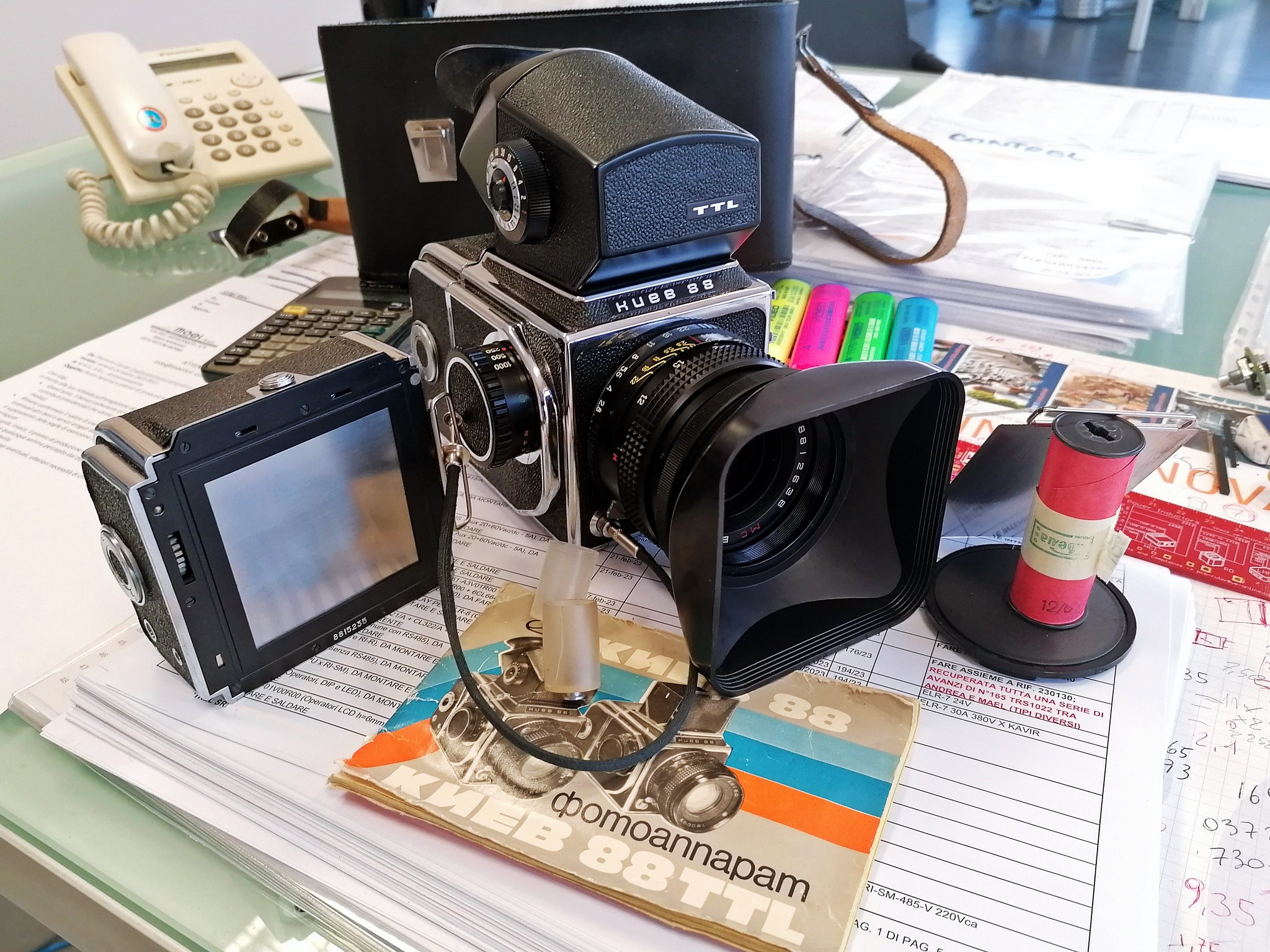

luigi gesi
schyter
Italy
81 Posts
Posted - Aug 05 2023 :  3:55:28 PM  Show Profile  Visit schyter's Homepage  Reply with Quote
""It seems as if the late 88 cameras were better than the older ones""
maybe then I was lucky. I got a practically new Kiev 88 (from Serbia 1988 year).
I redid the backtraps and everything works like a charm. Fingers crossed.:)
http://www.ussrphoto.com/UserContent2/582023_88.jpg
