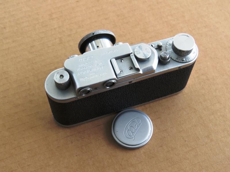

Posted - Jul 11 2018 : 11:24:39 AM Hello,
I have received yesterday a strange Fed S, s/n 25726. Its features are from the NKVD 1d type, but the number comes from the 1b series. It puts once more a question which has not been solved: why these serial numbers? I own several of these strange NKVD-s (I am not alone!) and perhaps we could discuss together about mine and yours...
First some photos of this Fed S s/n 25726: the cover and the front.
 http://www.ussrphoto.com/UserContent/1172018_IMG_0110.JPG
 http://www.ussrphoto.com/UserContent/1172018_IMG_0114.JPG
Nothing extraordinary, except the s/n. The vulcanite is typical of the early 1d-s (I would say up to c.110000).

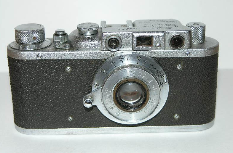

Posted - Nov 25 2023 : 05:37:39 AM A comparison beween the # 66674 (regular 1c) and the # 67588:
 http://www.ussrphoto.com/UserContent2/25112023_IMG_1438.JPG
The # 67588 is above:
 http://www.ussrphoto.com/UserContent2/25112023_IMG_1439.JPG
The 67588 is on the right
 http://www.ussrphoto.com/UserContent2/25112023_IMG_1440.JPG

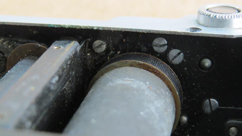

Posted - Nov 12 2018 : 09:14:02 AM I had to dismount my s/n 25726 to see if there is something strange inside. At least, I have just done it. But I could not remove the cover as the VF/RF windows are too tightly screwed. It's certainly a long time since somebody had a look inside...
 http://www.ussrphoto.com/UserContent/12112018_IMG_0671.JPG

Posted - Jul 28 2018 : 11:44:04 AM Here is FED No. 3631 and No. 417
 http://www.ussrphoto.com/UserContent/2872018_FED3631-417.jpg
 http://www.ussrphoto.com/UserContent/2872018_FED3631.jpg
Here is FED No. 3909
 http://www.ussrphoto.com/UserContent/2872018_FED3909.jpg
Here is 4586
 http://www.ussrphoto.com/UserContent/2872018_FED4586.jpg
Here is FED No. 4875
 http://www.ussrphoto.com/UserContent/2872018_FED4875-1.jpg
 http://www.ussrphoto.com/UserContent/2872018_Fed4875-2.jpg

Posted - Jul 28 2018 : 11:38:29 AM The rest of the photos are all I have in my files. Some may be helpful.
Here is FED No. 417 http://www.ussrphoto.com/UserContent/2872018_FED417.jpg
Here is FED No.1653 (4 photos)
 http://www.ussrphoto.com/UserContent/2872018_FED1653-1.jpeg
 http://www.ussrphoto.com/UserContent/2872018_FED1653-2.jpeg
 http://www.ussrphoto.com/UserContent/2872018_FED1653-3.jpeg
 http://www.ussrphoto.com/UserContent/2872018_FED1653-4.jpeg
nightphoto |
Posted - Jul 28 2018 : 11:10:09 AM Actually it is FED 3504.
nightphoto |
Posted - Jul 28 2018 : 11:07:30 AM Hi Jacques, I will post what I have. Here is the most interesting thing.
FED No. 3505 and it's passport from 1936. I can't remember where I got this. I did not own the camera and passport. Maybe this has been seen by members before.
 http://www.ussrphoto.com/UserContent/2872018_passport2.jpg
 http://www.ussrphoto.com/UserContent/2872018_Kharkov3.jpg
 http://www.ussrphoto.com/UserContent/2872018_FED3504-1.jpg
 http://www.ussrphoto.com/UserContent/2872018_FED3504-2.jpg
