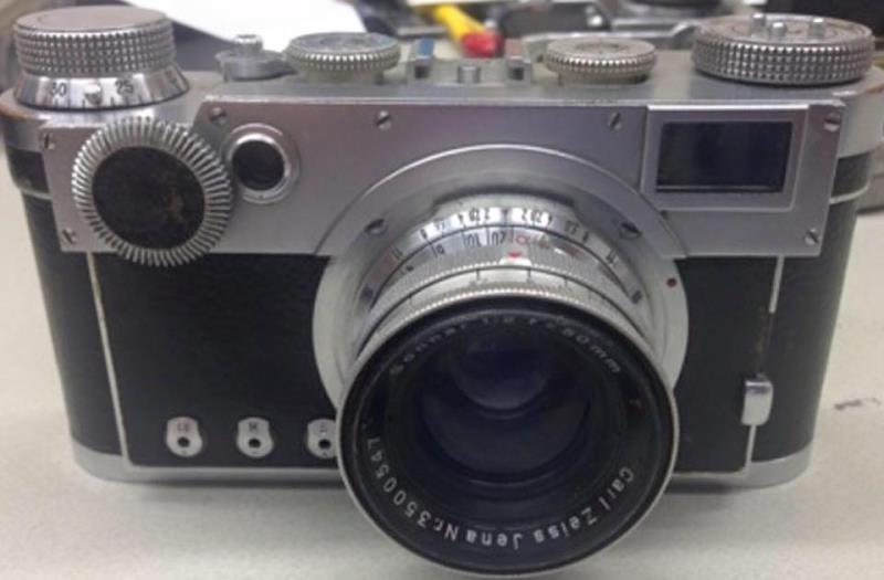

Luiz, does anyone actually have this camera or only pictures remain?
What is second speed like dial for?(whatever located next to the revind button)
Reply author: nightphoto
Replied on: 20071110195428
This camera has nothing at all to do with the TSVVS ! To say that it is a TSVVS-2, or lead anyone to believe that is not accurate and unfortunately could lead collectors and historians of Russian cameras to the wrong conclusion.
The camera pictured in this article is in the collection of Dr. Milos Mladek of Vienna. The photograph of this camera is in Princelle's (2nd edition, page 210). I believe the photograph in the article on this site by Luiz Paracampo was used without permission, and it is a copyrighted photograph.
This camera is thought to be a prototype or development model made by Zavod Arsenal and has nothing to do with the TSVVS (possibly made by the Almaz Zavod)! The article "TSVVS-2 The Challenge" is quite misleading, especially with the creative graphics ... leading to the wrong conclusion that this is a TSVVS-2.
Of course you can find similarities in any Leica or Contax copies, but so what? That does not mean that any theory is true, just because it is said or published on the internet.
This is an interesting camera, an has some importance in Russian camera development history, but a more accurate description of what it may be can be found in the original article about it in Princelle's.

I believe that is not a speed dial, but is the focusing wheel, like on a Contax or Kiev (but moved over closer to the users finger so that the users finger does not block the small rangefinder window, as it can on the Contax or Kiev).
What is your name and a belated welcome to the forum from me!
Best regards, Bill

Or if you mean the second dial on the top of the camera, it is described as a slow speed dial in Princelle's.
Reply author: okynek
Replied on: 20071111190427
Bill, are you talking about black dial on the front of the camera or about dial on the top of the camera,(located next to the rewind handle)? Because this, second dial, I did not find on any other Soviet camera and I wonder what it for? Also I was thinking that big dial on the front is slow speeds. Are you thinking it only to focus lens?
Replied on: 20071111192610
So this big black handle on the front is for focusing and second speed dial on the top is for slow speeds. Make sense now. Appreciate you help Bill!!![:)]

Yes Okynek,
Sorry to be unclear. Black dial on the front for focusing,second dial on the top for slow speeds. I have never seen the camera in person, but this is what I think.

The more I look at this piece, the lines, the design, the overall look and feel of it, the more I keep thinking this is some kind of KMZ experimentation... the closest camera I can think of is Rodina... Almost seems like a variation on a theme of Rodina.. The advance dial reminds me of a Leningrad camera design too much... the slow shutter dial is definitely something new, maybe a modified mechanism from Zorki 3?? Maybe a failed over the top complicated first attempt at creating what in the end became Rodina? Maybe another prototype by I.M. Marensov?
Replied on: 20080426153106
I'm sorry I didn't finish my thought there and posted prematurely, I was saying that the advance dial reminds me of Leningrad dial so that may put a hole in my theory about KMZ since it will now point to GOMZ... but I still feel some kind of relationship of this camera to Rodina... [:)]
Replied on: 20080428134152
Looking to this camera one will see a clear derivation of the FED 2.
The same way as TSVVS comes from FED 1, this new model has a Kiev bayonet mount mounted in a new FED body (derivative). You can even see the large Range/view finder of the Fed 2.
Now take a look to the knobs positioning and distance between them. You will see the same lay-out of FED 2. Different knobs, a mask in the entire front for the focusing wheel and a vertical sliding frame for the 85 and 135mm lenses ...reminiscent form the black Contax I. The slow speed mechanism uses the hollow part of the top of FED 2 and is a reminiscent of the British Agiflex. You must cock separately the slow speeds once the camera main shutter is set in "B". For sure this is not a daughter from KMZ once all parts are not used in any KMZ camera. Really, the machining is more close to the original TSVVS than any other camera, probably, strongly reinforcing the theory of being built at the same factory,

Well according to Boris at Photo-arsenal, this is a GOI Leningrad prototype
http://cgi.ebay.com/GOI-Leningrad-prototype-camera-with-contax-mount_W0QQitemZ370063366756QQihZ024QQcategoryZ15234QQssPageNameZWDVWQQrdZ1QQcmdZViewItem
One thing I'm confused about though, it does not seem to have the spring drive and the thick spool?
Replied on: 20080624234334
Yes, it does not look like Leningrad at all. It look to me great influence from Arsenal

Carefully looking this camera we can see:
1) The rewind button has a film reminder system that is similar to GOMZ Leningrad spring driven cameras, which were also employed in Smena 5,6,7 and 8 cameras.
2) The numbers are in DIN scale not GOST nor H&D This means a transition between the two systems
3) Carefully looking the speed dial you find the "Z" alsoussed in old FEDs
4) Carefully looking the Bayonet you will see that it is not compatible with Zeiss accessory lenses because the helicoid evolves in a different pintch - the meter angles are not placed in equal grades-
5) large base view finder with frame cover at Contax I style
6) The camera is Synchonized.
7) Internal construction reminds (at some extent) the Contax Speigel.
8) Similar layout of FED 2.
Now let us compare with the KMZ Rodina .
1R) the helicoid evolution is the same as Contax and Kiev.
2R) large base viewfinder with diopter adjustment
3R) similar synchro pin type.
Kiev 3 had first series of exposure meters grades in DIN SCALE.
Facts:
Kiev 3 with Din scale 1950-1952
Rodina prototype 1952
Gomz Leningrad Prototype 1954
GOI camera and GOI Leningrad 1947-1949
TSVVS 1949 1950
Standartization of PC synchro in Russian cameras 1955
Date of first GOST film sandartization 1953
These facts induces the production date of this "TSVVS2?" camera around 1950-1953
More. All cameras with Jena lenses have its numbers begining with 35XXXX.....See manufaturing date.
More to come...........
Replied on: 20080630124612
Note: Acording to information From the Lens Collector's Vade Mecum: this lens is transitional from 1952 1953 production . According information of Dan Fromm / photo.net forum.
This reinforces production date post original TSVVS (1949-1950)

Hi Luiz,
I know you will not like my answer, but like you, I am not shy to share my strong opinion. I think that right now there is no good information about where this prototype was made and as well, it is not even known where the TSVVS was made ... but, I can see very little relationship to the TSVVS cameras and until there is some better proof of where the camera was made, it is wrong to call it "TSVVS-2"!
So... Thanks for the diagrams (and for using my photos ;-))! Looks good! But:
1. I would say that the dial engravings are not exactly matching. The "0"s are rounder on the prototype than on TSVVS. The "B"s have a slightly different shape. and the rest of the numbers are similar but would take a closer photo to compare them.
2. Although the prototype camera and TSVVS accessory shoes may both be machined, it does not mean anything since they are totally different in shape and many cameras with small production (such as TSVVS) and many prototypes from different factories have machined parts, including accessory shoe!
3. The arrow engravings that look like this can be seen on many cameras, even including VOOMP, Zorki-1, FED-1, Kiev IIIa, etc. This means nothing.
4. The ocular ring is different between the two, with the prototype ocular ring having, on the inner part, a cone-shape with black-painted concentric rings. TSVVS does not have this.
5. I agree that the leather quality and type looks the same or very similar, but this would be something produced outside of the factory and ordered, so a number of companies may have bought this covering. This is the case with some prototypes that were produced by GOMZ and KMZ but have the same (or very similar) high quality covering.
6. The engraved numbers on the focusing mounts are similar, but so are both similar to the Kievs from this time. And, if you look closely you will see that the prototype camera has a lens locking button and the whole mechanism more similar, or the same as a Kiev than to TSVVS. Please compare it to the 1949 Kiev II on my site.
7. The overall finishings are very nice on both cameras, just as they are on many handmade, hand-engineered prototypes or small edition cameras where molding and mass production techniques are not used. The photos you show here just show that the prototype has a very similar back and interior to the Kiev II. Closer to a Kiev than to TSVVS!

Very good arguments you posted but :
1) I want to show -certainly this is not a camera from Leningrad.
2) My experience convinced myself that this camera has the same or near the same origin of TSVVS.
3) Kiev cameras are far from this model under question
4) the engravings of the cameras you named are close but nor so close as the model under question
5) Finally I said that all that was exposed is my own supposition, but a strong suspicion based under various clear technical proofs. Only that; and the lens serial number indicates the near-by manufacturing date .
It is important to remember that when the camera was manufactured, no one would intend to make any details equals to A or B but follow their own resourses, the available tools.

Hi Luiz,
1. Only Boris has said this camera is from Leningrad. I don't think anyone else thinks it is from Leningrad. Boris is not an expert on these cameras.
2. I know you are experienced, but many of us here on the forum are also very experienced in the details of the manufacturing of these cameras. You may have convinced yourself, in spite of many details that do not point to the conclusion that this unknown prototype is related to TSVVS in any way, however the details that you state do not convince me at all. I have two TSVVS cameras (1949 and 1950) and I am very familiar with the details of them since I have largely taken them apart and examined them closely, under magnification. I am also very familiar with the details of many early Kiev cameras from this era and have also disassembled them. Although I don't own one of the two or three known examples of this camera, I do have some very fine photos of it from one of the owners, and have made many comparisons with the details between the prototype and both Kiev II and TSVVS, so my own opinion is based on good knowledge and observation. I know of no one else that believes that this unknown prototype is related to TSVVS in any way except for you. Even the person who I know that owns one of these unknown prototypes has expressed to me that they were surprised to see it featured under the title "TSVVS-2"!
3. Although you are correct that Kiev cameras are far from this unknown prototype, they are closer in more ways than the TSVVS which is very far from close to this model under question.
4. The engravings of these different cameras can not be compared successfully with the detail shown n these photos. A detailed study of the engravings of the focusing mount and other areas of engraving might be very helpful in finding the true origin of this camera, or at least some of it's parts, but, the photos would have to be closely taken (hopefully with a good macro lens) and compared using large size files to make any meaningful comparisons, hypothesis, or to reach solid conclusions. The photos (both mine of TSVVS and of the unknown prototype) are not good enough quality to reach any definite comparisons or theories.
5. I appreciate your suppositions and I respect very much your knowledge and opinions. However, I don't believe it is responsible to publish an article entitled "TSVVS-2 The Challenge" which can lead someone to believe that this camera has been proved to be related to the TSVVS. In fact, it has not been proved that and perhaps a better title for your articles on this camera would be something to the effect of " A Theory Regarding the Origin of an Unknown Prototype". This would make it clear to interested parties that the article is only your researched opinion rather than a fact. So, although it does not matter to me personally what your opinion or theory regarding the origin of the camera is, and I actually find your article and observations interesting, I find it necessary to write on this subject just so that it is clear to any interested parties that your theory is not an accepted theory, but just your own personal idea.
My own opinion is that the camera may have something to do with Arsenal, and that it is probably correct that it was put in Jean Loupe's book in that chapter. Having said that, I would also have to say that in my mind, it is also possible that TSVVS has something to do with Arsenal, in some way, even though there is a theory that it has something to do with FED or with a factory named Almaz (Yuriy Davidenko's idea). I also think that the camera we are discussing, which I can only call an unknown prototype, is probably a prototype. And, my best guess, so far would be from Arsenal ... and having little or nothing to do with TSVVS besides having a similar body covering and Contax style lens mount.

Boris Jamchtchik just posted this camera in my Vintage Camera Collectors facebook group:
http://www.ussrphoto.com/resize/resize_image.aspx?ImgWd=800&IptFl=/UserContent/172015_tsvvs2.jpg
http://www.ussrphoto.com/UserContent/172015_tsvvs2.jpg
Replied on: 20150701111519
Thanks, Vlad! A mythic camera!
I don't know if it is possible, but could you ask Boris Jamchtchik other photos, more detailed, especially from the mechanism?
Replied on: 20150701115351
Hi Jacques, I asked, we'll see if he will oblige, if he does I'll repost it here.
