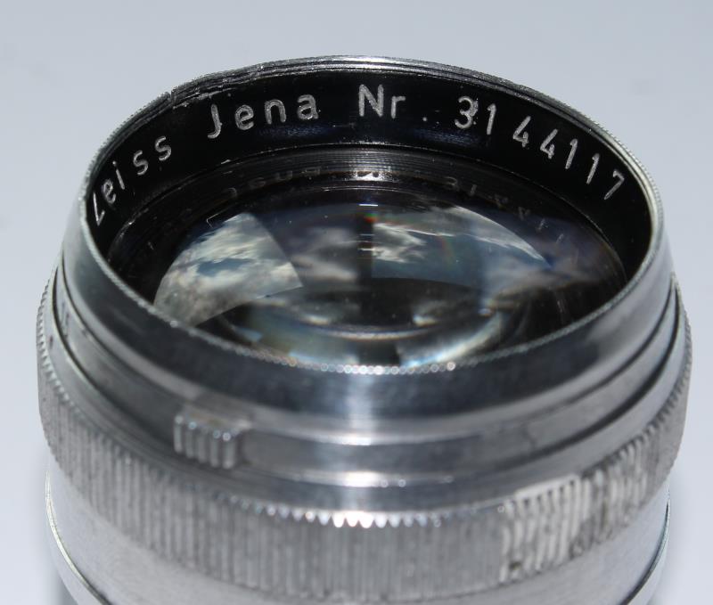

I have just bought one of these lenses (by auction) and something seems interesting. The rear cam has a screw, like on S.H.'s Sonnar, but unlike the other Sonnars seen till now.
http://www.ussrphoto.com/UserContent/1832013_Sonnar 1,5-5,8cm.jpg

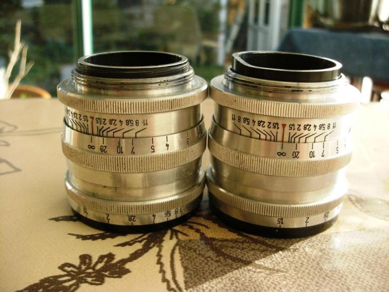

This is my 1,5/5,8cm Sonnar.
http://www.ussrphoto.com/UserContent/1832013_832013_DSC_4149_post.jpg

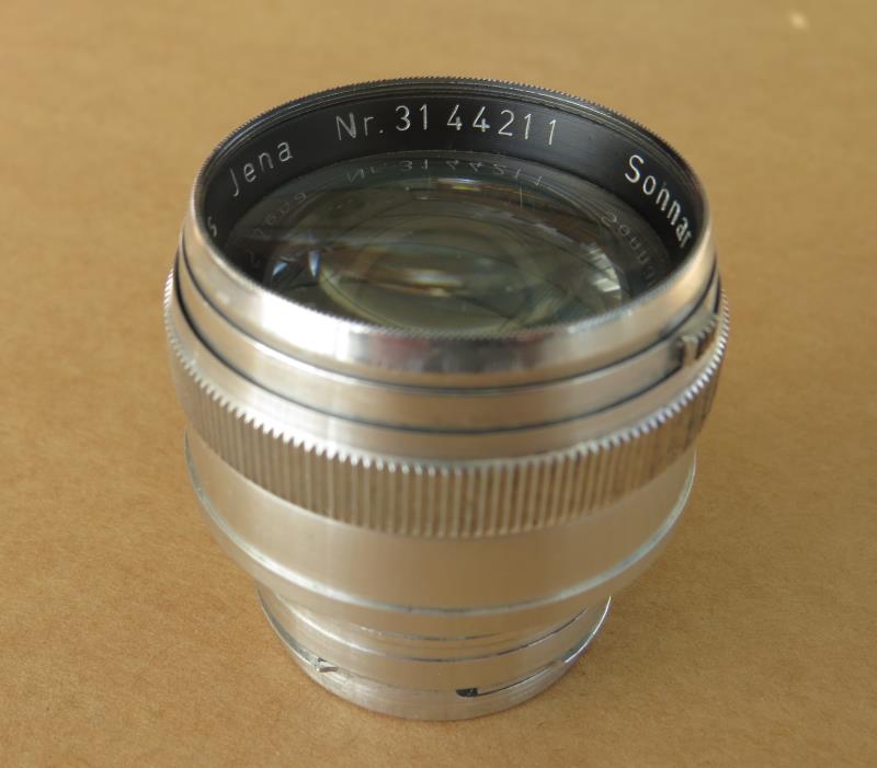

And this is S.H.'s Jena Sonnar.
I will tell you more after receiving the lens. I hope there is not too much fungus...

Well, I saw that too. But the rest of the barrel engravings look russian.
Did not bid on this one because of the fungus.
If you want some more close-up shots of my sonnar, just ask.

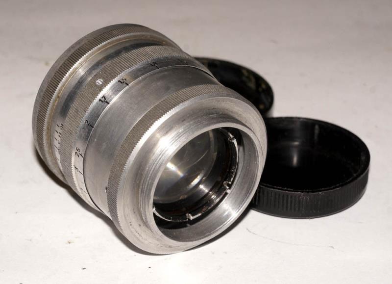

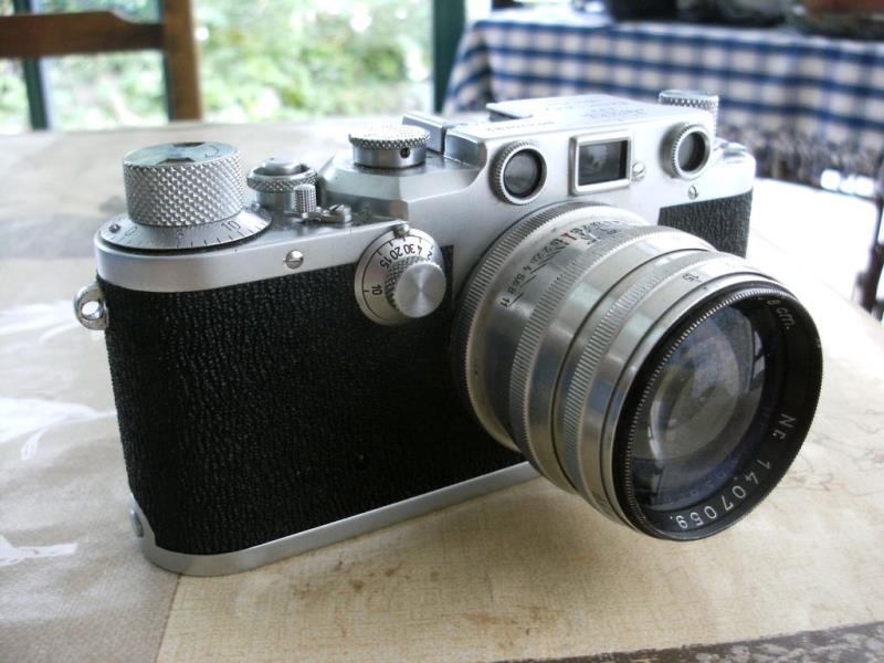

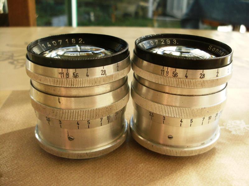

Well, the sonnar is here.
Really in good condition: no fungus or haze, just a very small mark on the front lens. One of the best puchase I ever made...
http://www.ussrphoto.com/UserContent/2232013_Sonnar 1.5-5.8 002.jpg
http://www.ussrphoto.com/UserContent/2232013_Sonnar 1.5-5.8 001.jpg

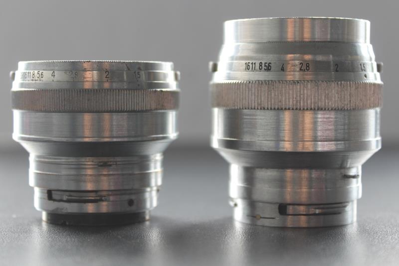

Sonnar 1,5/5,8cm and 1948 1,5/5cm ZK side by side: of course, the Sonnar is longer, but both have exactly the same maxi diameter: 48mm.

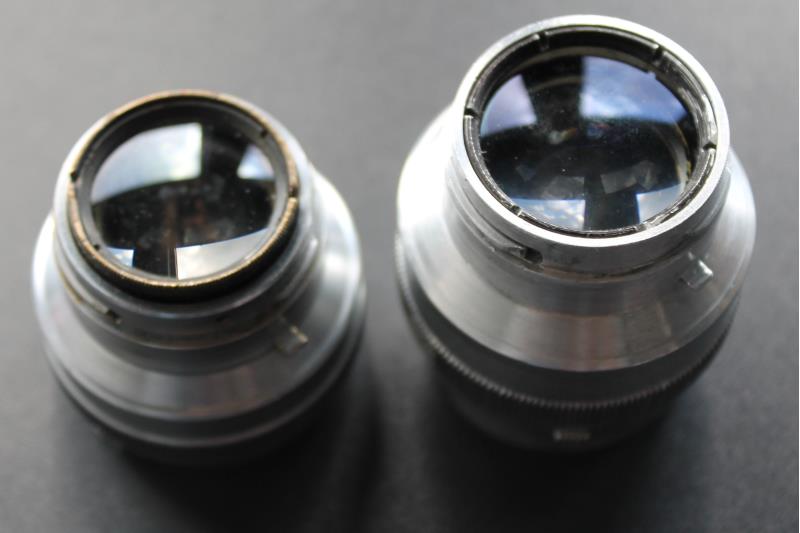

Replied on: 20130322090024

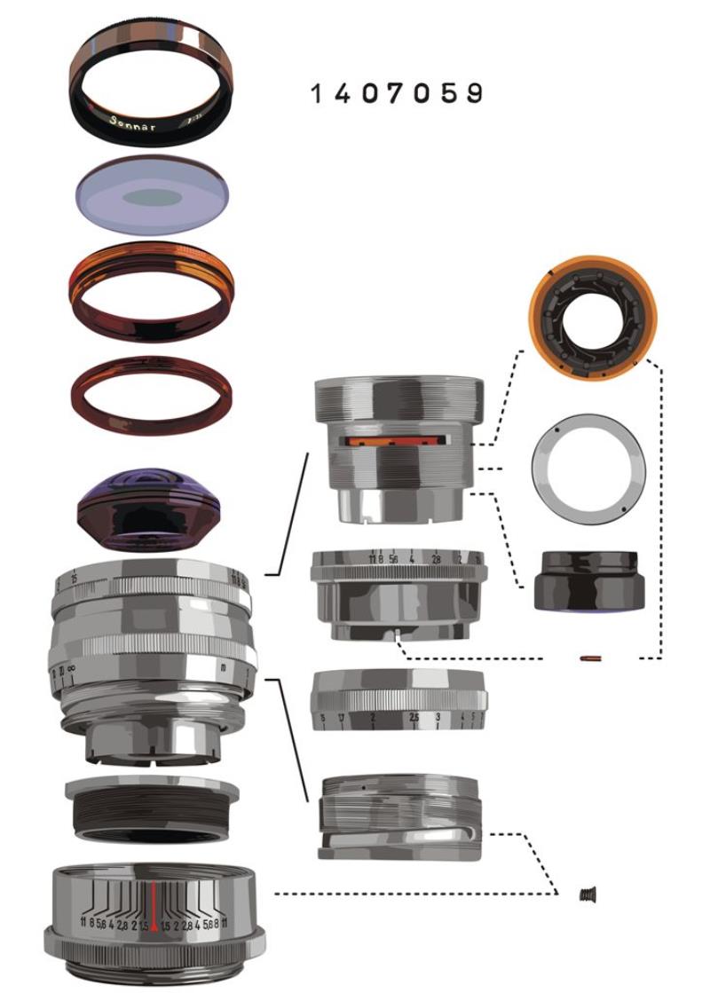

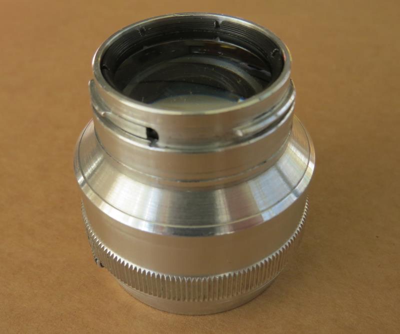

Lens module dismounted:
http://www.ussrphoto.com/UserContent/2232013_Sonnar 1.5-5.8 004.jpg
The back part largely differs from CZJ Sonnar/ZK's ones with that 6 slot nut to maintain the rear element.
Just the same for the front lens which can be directly dismounted on unscrewing the beauty ring:
http://www.ussrphoto.com/UserContent/2232013_Sonnar 1.5-5.8 003.jpg
Much more easy to clean a lens!

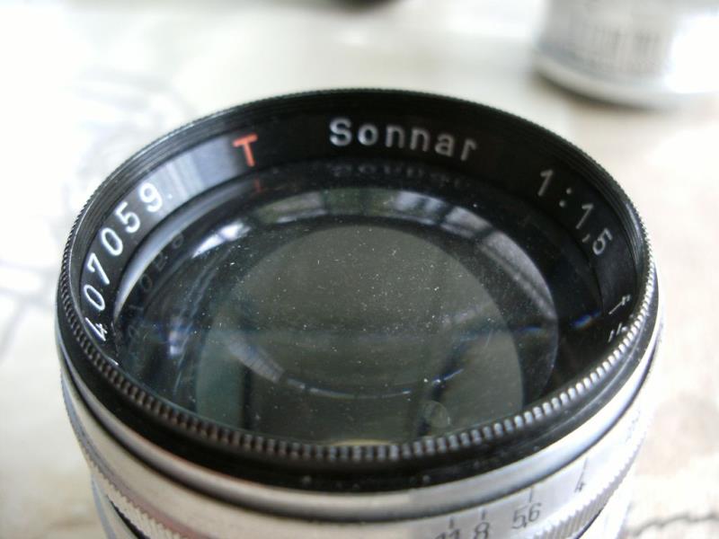

Replied on: 20130322091002
Two last pictures about odd details:
There are two complete diaphragm scales, at the opposite...
These scales stop at f11, like on early 1,5/5cm CZJ Sonnars.
http://www.ussrphoto.com/UserContent/2232013_Sonnar 1.5-5.8 005.jpg
And the distance scale covers 3/4 of turn, unlike the CZJ Sonnars and ZK (half turn). Except one of my Sonnars: 3/4 too!
Here, "m" for meter on the scale ("M" on ZK and Jup)
http://www.ussrphoto.com/UserContent/2232013_Sonnar 1.5-5.8 006.jpg
Don't hesitate to put questions if necessary...

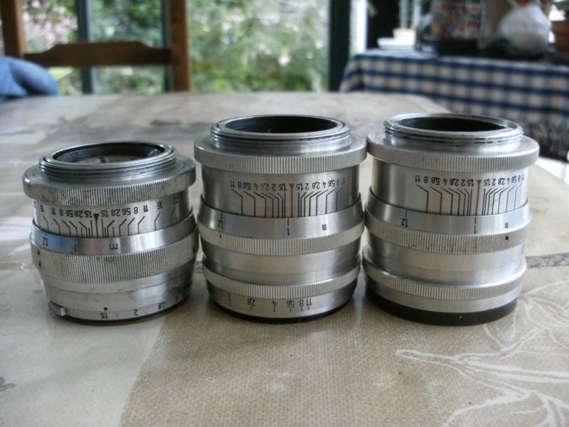

Two more Sonnars here, always LTM.
First, A 1,5/5cm which seems a cousin of my 1,5/5,8cm. Same 6 slot nut on the rear and an aluminium mount. But this one is coated and it is bigger than the 5,8cm (!).
A picture:
http://www.ussrphoto.com/UserContent/1652013_Sonnars 1,5-5cm and 1,5-50mm 001.jpg
The second one is more mysterious. It could be a genuine Carl Zeiss Sonnar, but it has a LTM mount, a strange crossed pattern on two bags and it is heavier than any of the Sonnars I have here (224g). Perhaps a poswar one? A picture again:
http://www.ussrphoto.com/UserContent/1652013_Sonnars 1,5-5cm and 1,5-50mm 002.jpg
Now, a third picture. They are both 1,5/50mm lenses, so I am perplex when I see them side by side...
http://www.ussrphoto.com/UserContent/1652013_Sonnars 1,5-5cm and 1,5-50mm 003.jpg
If you have ideas...

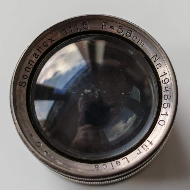

one more Sonnar 14XXXXX in Leica M9!

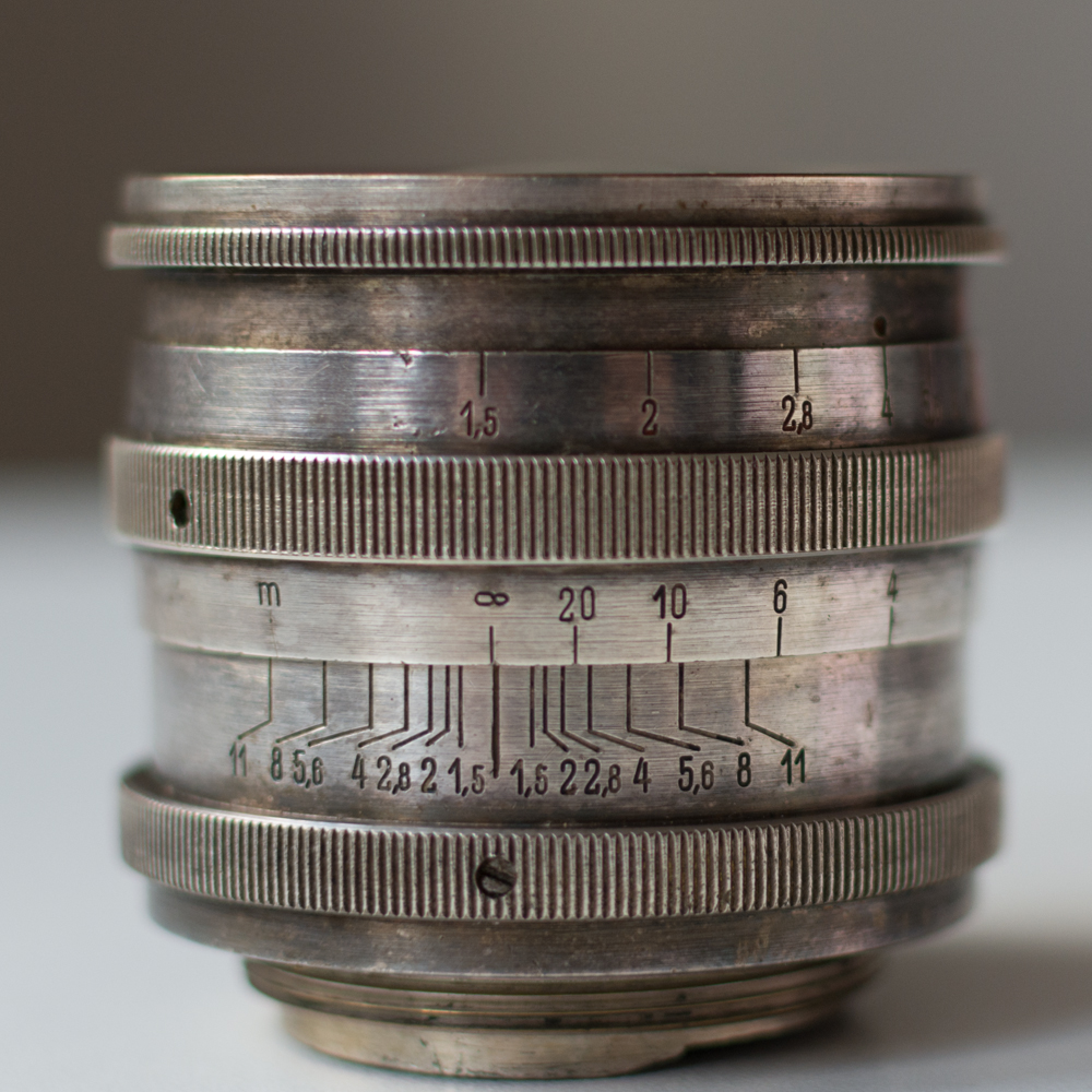

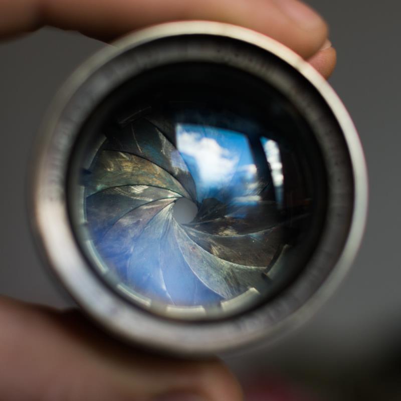

Replied on: 20130904100815

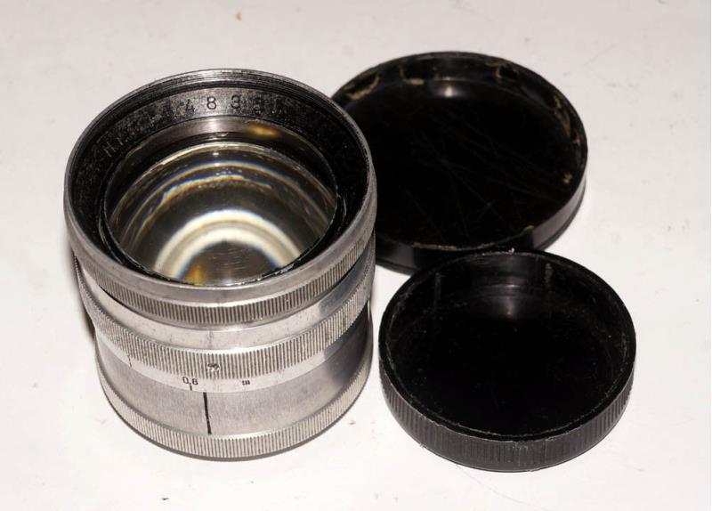

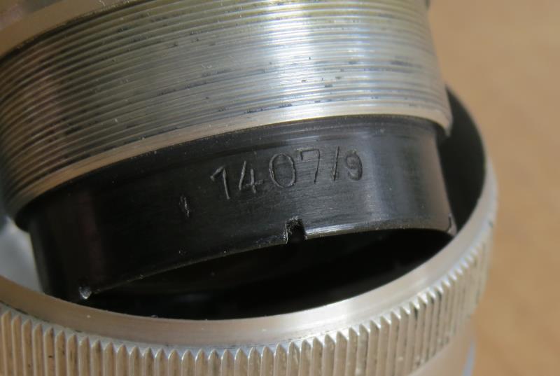

I posted this on the rangefinderforum, but I think some of the collectors here could be interested also. It is an interesting story about east German black market lenses. Please forgive me if you already have read this elsewhere.
I recently bought a strange light alloy uncoated Sonnar 1.5 5cm in Contax mount. This lens is from a German collector who, in the 1970s, checked the focal length because it was bigger than a normal Sonnar. It was found it is close to 60mm, even if it is marked as a 5cm lens. It has also six spanner slots in the rear. It really looks like the 5.8cm ltm lenses...
Here are some pictures of it, compared to a wartime German Sonnar.
http://www.ussrphoto.com/UserContent/492013_sonnar_60_barrel_lo.jpg
http://www.ussrphoto.com/UserContent/492013_sonnar60_mount.jpg
http://www.ussrphoto.com/UserContent/492013_sonnar60_number.jpg
A close up shot of the aperture mechanism:
http://www.ussrphoto.com/UserContent/492013_sonnar60_internal.jpg
I asked the seller about this lens, he replied :
<blockquote id="quote"><font size="1" face="MS Trebuchet, Arial, Helvetica" id="quote">quote:<hr height="1" noshade id="quote"> In 1954-55 I bought a Kiev-camera and this lens in a then still private shop for photo-articles in Halle Saale (East-Germany) Kiev-cameras were then assembled illegally by employees of Zeiss-Jena in the Saalfeld-facctory from left-over parts from the years 1947-48 and sold on the black market or to some private shops with Sonnars 2,0 of original production smuggled out. The 1,5 lens I additional bought then was made of left-over wartimes-production of Sonnar 6cm lens blocks, made for bomb-sights originally, f-stops mechanics and blades added later. Black market only, too. It was a quite big, illegal "enterprise", later with real good mechanical parts and engraving, some with coated front lenses. Ended in the mid-fifties with many prison-sentences. <hr height="1" noshade id="quote"></font id="quote"></blockquote id="quote">
The 5.8cm ltm sonnar lenses probably come from this black market operation too. Not really a "fake" product, because produced by Zeiss employees with Zeiss parts, but rather a black market / illegal product.
Tomorrow I will show it to an experienced repairman : I'd like to use this lens but as it is, it does not really work. With a focal length close to 60mm, the helical pitch in the Contax mount or in my adapters is wrong.

Replied on: 20130904123700
Well, I can already tell you that on my M8 + Contax =&gt; Leica adapter, it does not focus right under 6 or 8 meters. Infinity at f8 is usable.
The markings look right to me and the s/n could be from around 1949/50. Plausible.
If your 1.5 / 5cm is bigger compared to a regular lens, this is probably another one.

Replied on: 20140111084107
I am always with the exotic Sonnars... Glass probably made prewar by Zeiss, mounted postwar by whom?
Here, side by side, my former one (the one which I used to make the photos) and the new one. Exactly the same, except for the rangefinder ring: slopy on the new one.
http://www.ussrphoto.com/resize/resize_image.aspx?ImgWd=800&IptFl=/UserContent/1112014_DSCF1597.JPG
http://www.ussrphoto.com/UserContent/1112014_DSCF1597.JPG
http://www.ussrphoto.com/resize/resize_image.aspx?ImgWd=800&IptFl=/UserContent/1112014_DSCF1598.JPG
http://www.ussrphoto.com/UserContent/1112014_DSCF1598.JPG

Reply author: bezdan
Replied on: 20140214120519
Dear Jacques ;)
thank you very much for your kind welcome :). I ll try to post it again. Yes it is LTM, its sn is: 1948510 ;) and it has very fine gravure.
I am having some problems with jpeg upload.
I ll try again
Best regards
Reply author: Guido
Replied on: 20140214125920
Hello
@Jacques M.: You can look at the pictures by modifying the file names manualy. For example:
http://www.ussrphoto.com/UserContent/1422014_FB_Sonanrex_%20(1%20of%2013).jpg
should work when copyed to the address line of your browser (exchange all spaces with "%20").
@bezdan: It's a good idea to not use spaces in the file names when uploading.
Replied on: 20140214143359
Thanks, Guido [:)]. But I fear I am quite stupid concerning all that...
bezdan: sure of the number? 194xxxx and not 149xxxx? The only other s/n number concerning this ultra rare lens is 1498512.
Thanks. Amitiés. Jacques.
Replied on: 20140214150613
So, my number is wrong: 1948512 and not 1498512.
Thanks.
Somebody of the Zeiss Society...
Replied on: 20140214151005
Hope it works now
http://www.ussrphoto.com/resize/resize_image.aspx?ImgWd=800&IptFl=/UserContent/1422014_Sonnarex.jpg
http://www.ussrphoto.com/UserContent/1422014_Sonnarex.jpg
http://www.ussrphoto.com/resize/resize_image.aspx?ImgWd=800&IptFl=/UserContent/1422014_4.jpg
http://www.ussrphoto.com/UserContent/1422014_4.jpg
Replied on: 20140214152808
Absolutely beautiful!
And "für Leica": the first time I see that...
What means - 0 - on the beauty ring??
What is the weight of your lens? Mine are 187g (sloped rangefinder) and 183g (screw one). It can be important to know what the inside is made of...

Replied on: 20160830080634
Another exotic 1,5/5,8cm Sonnar here:
http://www.ussrphoto.com/resize/resize_image.aspx?ImgWd=800&IptFl=/UserContent/3082016_DSCF2527.JPG
http://www.ussrphoto.com/UserContent/3082016_DSCF2527.JPG
It was found on a 1949 Leiva IIIc "sharkskin". The seller could not tell me when the lens was put on the body.
This lens is coated (like the s/n 1407293). But it has a red "T" mark on the beauty ring. And the same 40,5mm screw mount for filters as the Zeiss original 1,5/5cm Sonnar...
Replied on: 20160830081756
http://www.ussrphoto.com/resize/resize_image.aspx?ImgWd=800&IptFl=/UserContent/3082016_DSCF2530.JPG
http://www.ussrphoto.com/UserContent/3082016_DSCF2530.JPG
Sorry for the dust...
The three Sonnnars, side by side:
http://www.ussrphoto.com/resize/resize_image.aspx?ImgWd=800&IptFl=/UserContent/3082016_DSCF2529.JPG
http://www.ussrphoto.com/UserContent/3082016_DSCF2529.JPG
From left to right: the original 1,5/5cm 2811301 and the "exotic" 1407059 and 1407293.
Note that this "new" 1407059 has too the six slot screw at the back.
If you have questions... I become a specialist about these non Zeiss Sonnars!

Back to this topic always about the 1,5/5,8cm Sonnar s/n 1407059.
Altix dismounted it and made the scheme of the lens:
http://www.ussrphoto.com/resize/resize_image.aspx?ImgWd=800&IptFl=/UserContent/1222017_Sonnar1407059.jpg
http://www.ussrphoto.com/UserContent/1222017_Sonnar1407059.jpg
The different parts of the lens are mounted from the front towards the rear. Seeing the complexity (and the number of these lenses: certainly around 500), probably the work was made by Zeiss workers who had "found" spare parts...
Thanks, Altix.

Replied on: 20170916061147
Another fake Carl Zeiss Jena Sonnar in Contax mount. It came with the additional detachable ring.
http://www.ussrphoto.com/resize/resize_image.aspx?ImgWd=800&IptFl=/UserContent/1692017_2.JPG
http://www.ussrphoto.com/UserContent/1692017_2.JPG
http://www.ussrphoto.com/resize/resize_image.aspx?ImgWd=800&IptFl=/UserContent/1692017_3.JPG
http://www.ussrphoto.com/UserContent/1692017_3.JPG
http://www.ussrphoto.com/resize/resize_image.aspx?ImgWd=800&IptFl=/UserContent/1692017_4.JPG
http://www.ussrphoto.com/UserContent/1692017_4.JPG
Replied on: 20170916104856
Thanks, Altix. So, another exotic Sonnar, in Contax mount, that time... The detachable ring is rare and interesting too... What was it for, exactly? And what does the beauty ring read?
Reply author: altix
Replied on: 20170918075928
Dear Jacques, the beauty ring mimics the standard one. It is written there "Sonnar 1:1,5 f=5cm Carl Zeiss Jena Nr . 3144117". The use of 3 in the beginning of the serial was probably dictated by imitation reasons. Of course the focal length is not 5 but rather 6 cm.
The filter ring does not fits for 40.5 mm screw-in filters or sun shades. Probably the additional ring served as some kind of adapter for 40mm slip-on filters. By the way, such filters and caps are more typical for post war West Germany (BW, Lifa, Schneider). Can it be the indication that the faked Sonnars were produced in West Germany?
One more observation - this Sonnar is perfectly adjusted for use with Contax camera. I am not sure if this is true for Leica 58 f1.5 Sonnars.
altix

Another exotic Sonnar here, written Sonnar 1,5 5cm Nr. 1548365 on the beauty ring. This beauty ring was later painted in black. It has the same body as the s/n 1211770. LTM 39mm, but no coupling system: certainly, it was mounted from spare parts.
http://www.ussrphoto.com/resize/resize_image.aspx?ImgWd=800&IptFl=/UserContent/26112017_Sonnar 1548365 1.jpg
http://www.ussrphoto.com/UserContent/26112017_Sonnar 1548365 1.jpg
(photo of the seller).

Another exotic Sonnar here, written 1,5/5cm and in Contax mount:
/UserContent2/332021_IMG_0357.JPG
http://www.ussrphoto.com/UserContent2/332021_IMG_0357.JPG
/UserContent2/332021_IMG_0358.JPG
http://www.ussrphoto.com/UserContent2/332021_IMG_0358.JPG
Replied on: 20210303095919
In fact, I don't see any difference compared to those of D.H. or Altix, earlier in that thread.
I have just unscrewed the mount and found 1407/9 engraved on the barrel.
/UserContent2/332021_IMG_0349.JPG
http://www.ussrphoto.com/UserContent2/332021_IMG_0349.JPG
My # 1211770 has too 1407/ engraved on the barrel, but it has an LTM mout.
Certainly both belong to the batch of 1,5/6cm prototypes quoted by Thiele in his "Versuche Zeiss Ikon". Probably other lenses shown here too...
