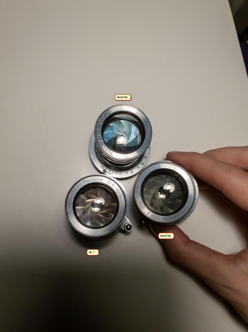

Replied on: 20200309072023

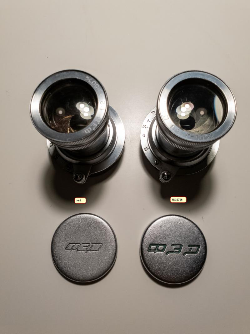

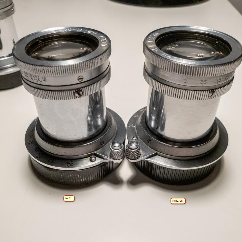

Huge thanks Niko80 for reviving this thread.
I have added a my pair of FED 2/50 lens and my FED 1d camera (Lens #32726 and FED-S #172936) to related wikipages one week ago, so they are probably included in graphs and should fit perfectly in the line.
The shutterbox of my FED has "21/V" scratched on the side, that probably means it passed quality control on May 21 1941 according to this page

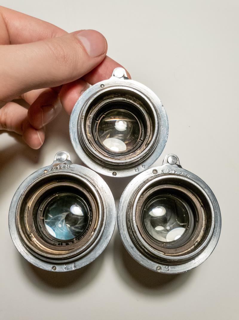

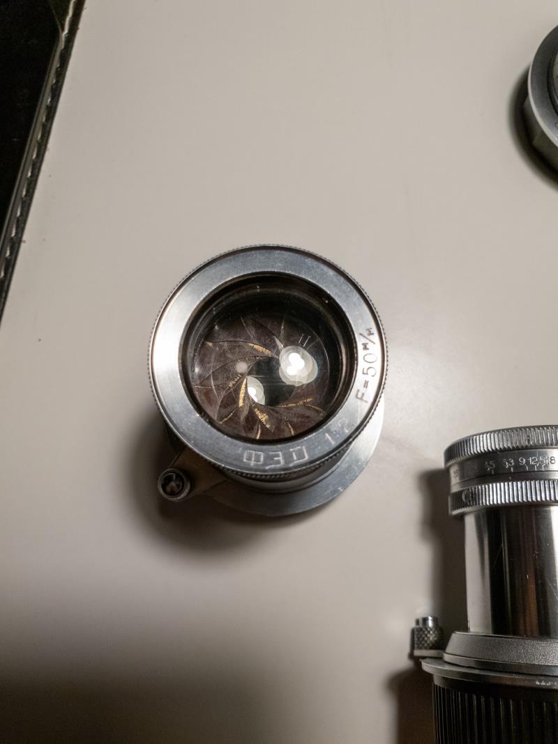

I have recieved the FED-S lens without s/n, it looks like some early lens with brown aperture blades. It has coupling number though.
/UserContent2/14112020_20201114_185716.jpg
http://www.ussrphoto.com/UserContent2/14112020_20201114_185716.jpg
/UserContent2/14112020_20201114_190059.jpg
http://www.ussrphoto.com/UserContent2/14112020_20201114_190059.jpg
Here is some pictures for comparison with two other lenses, &#8470;24129 with blue blades and one of the very late &#8470;32726 from may 1941.
/UserContent2/14112020_20201114_185536.jpg
http://www.ussrphoto.com/UserContent2/14112020_20201114_185536.jpg
/UserContent2/14112020_20201114_185931.jpg
http://www.ussrphoto.com/UserContent2/14112020_20201114_185931.jpg
/UserContent2/14112020_20201114_185446.jpg
http://www.ussrphoto.com/UserContent2/14112020_20201114_185446.jpg
What I noticed is different apart of aperture blades color is knurling on infinity fixator and different font used to mark f-number.
Caps are also different.

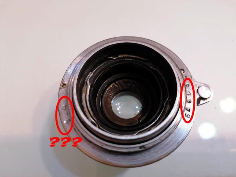

Replied on: 20220131195346
I only have a Fed 50mm f 2.0 lens serial # 29515 and directly across from the serial number is a two digit # either 98 or 96
