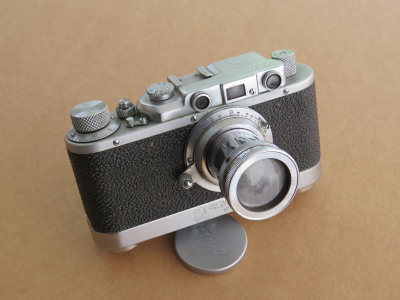

Replied on: 20200420092826

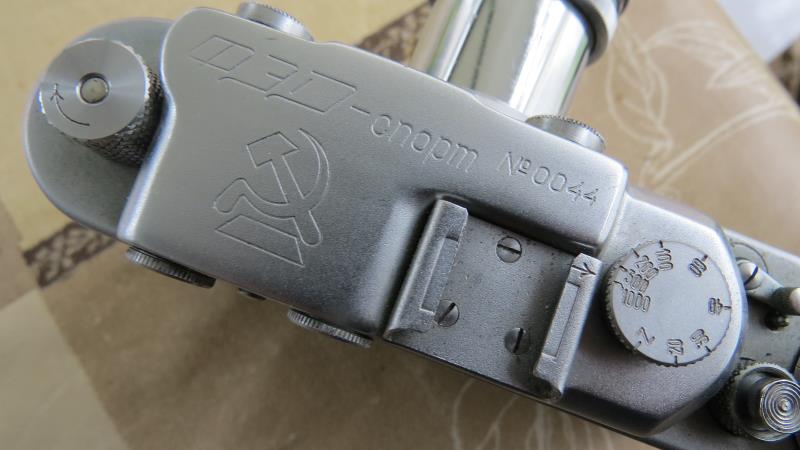

I have just seen that article, on Novacon site:
http://www.novacon.com.br/odditycameras/fedsport.htm
I understand now why the question is (perhaps?) not completely closed. We know that the period 1945/52 was specially "imaginative" for KMZ, so, why not a Fed Sport in 1945/46, just before the Fed KMZ?
Until now, I had always thought that this camera was "home made". But the mechanism of the rapid winder cannot have been manufactured on the corner of a table. There are several types of "rapid winders" for Leicas, but as far as I know, they don't look like the Fed's one. So, could it be originally made by KMZ?
Some photos of my s/n 0044, to compare with Novacon's ones:
/UserContent2/2042020_IMG_0073.JPG
http://www.ussrphoto.com/UserContent2/2042020_IMG_0073.JPG
/UserContent2/2042020_IMG_0078.JPG
http://www.ussrphoto.com/UserContent2/2042020_IMG_0078.JPG

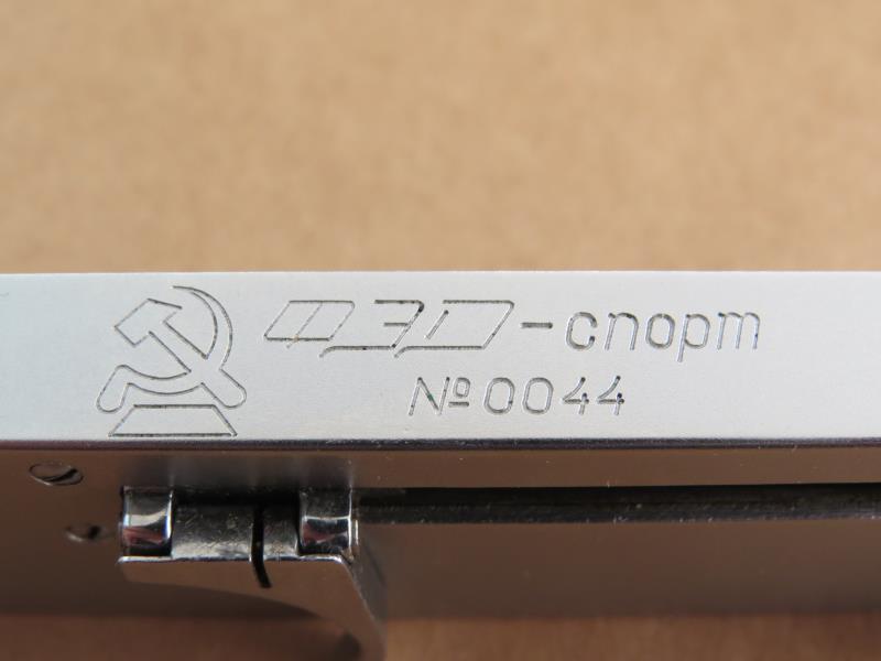

Replied on: 20200420093215
The two engravings, on the cover and on the rapid winder:
/UserContent2/2042020_IMG_3807.JPG
http://www.ussrphoto.com/UserContent2/2042020_IMG_3807.JPG
/UserContent2/2042020_IMG_0084.JPG
http://www.ussrphoto.com/UserContent2/2042020_IMG_0084.JPG

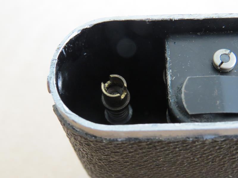

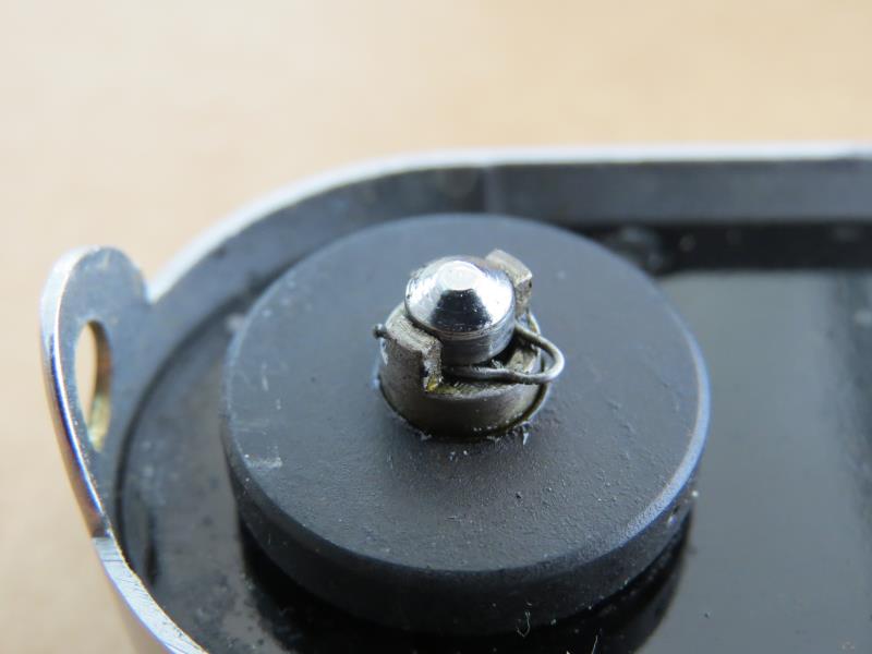

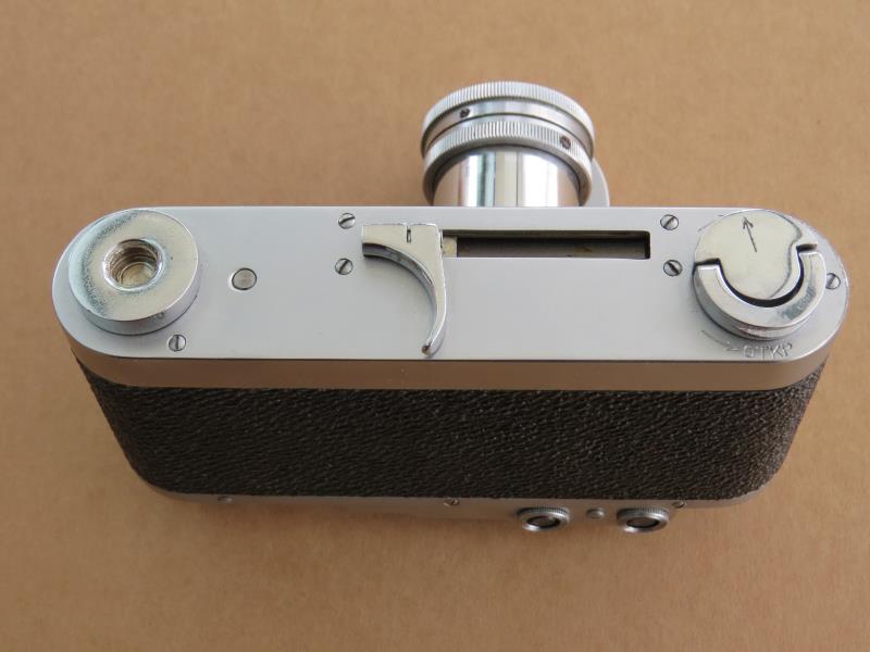

Replied on: 20200420094815
And the system of coupling:
/UserContent2/2042020_IMG_0081.JPG
http://www.ussrphoto.com/UserContent2/2042020_IMG_0081.JPG
/UserContent2/2042020_IMG_0082.JPG
http://www.ussrphoto.com/UserContent2/2042020_IMG_0082.JPG
Note that the axle for the spool seems an original Fed one. The slot was just enlarged to fit the winder. And it works correctly, at least without film!...
It's possible that a very small batch was delivered after WW2 (with a single "0" as prefix for the s/n). But considering my own camera (with a double "0"), it seems really too new...
Any information about Igor Bajanov?
Luiz, could you help? Please!
Reply author: Niko80
Replied on: 20200421164836
Well, I'd say there is something between "homemade" and "genuine factory made".
Look at the FED "Stemar", extremely well made, at least aesthetically, but still clearly a fake. Surely there were people capable of manufacturing something like that in the late 20th century.
I am certainly no expert on that topic but personally I do not like the engravings of the FED Sport at all. It just doesn't feel right for the 40s / early 50s, not to speak of that huge hammer and sickle. In my opinion this looks way more like something out of the 70s - 90s. Especially the font of "sport". All in all the logo, letters and numbers do not fit together well. It's not a pleasant layout. At least it would not have been considered such around 1945.
Furthermore at least in the pictures the corners of the top plate look like it has been ground down to remove the original engraving. And the base plate looks a bit too crude for a factory job as well. But I am sure you can tell much better with the actual camera in hand.
Reply author: Guido
Replied on: 20200421182650
Bonjour Jacques and hello everybody else
I would say I was an expert for FED-Zorki fakes years ago but the FED-Sport is not a fake but a modification.
There are so much things that don't fit with this camera. First they are made from FED-S but there are also models with only 1/500. Maybe fakes of the modifications? Why not ... a seller on eBay ask 3500 Euro for a FED-Sport copy. Fully unrealistic ...
Some points that speaks for a modification:
- the logo is much too big
- the tomb is too large
- there is no star over the logo (like on the FS-2 for example)
- all KMZ products until 1949 had a year with the logo
- early KMZ products before 1948 had only a "N" for s/n, later "N°"
- KMZ used to use five digit s/n before 1954 for some series (Zorki-3)
- the Leicavit copies are made very well but I've seen many workshops with outstanding potential (see the Zorki-75 or so)
- see the last picture from Jacques: it's a very bad modification, hand made for sure, a sign that at this point the one who build the camera has lost the interest of his work, because the parts should be fully black
After all it's a modification made in the 80th or even the 90th. As far as I know there is no earlier mention in the litarure I know, even not in THE Princelle ... So the 90th are very possible.
I'm sure KMZ has nothing to do with that cameras and also FED is not really involved beside the cameras are made by them.
I would be interested in other opinions about this.

Guido, I agree but I wonder what is your definition of fake and modification?
I think we can safely say that the sport is a modified FED1/S but doesn't that make the model "FED sport" a fake then? As you said most likely neither KMZ nor FED made this camera but someone in the 80s or 90s.
In my opinion adding the baseplate with the rewind functionality is a modification but relabeling the camera as "FED sport" with the KMZ logo, hammer and sickle makes it a fake.
It would be interesting if the rapid wind mechanism really works with film or if it's something like the "FED Stemar" that looks like the leica counterpart but isn't fully functional. Given the sometimes crude look I'd guess it was really made to work but still I am sure this was done for the collectors market and not for actual photography. Why go through the trouble to modify a bunch of relatively rare 50 year old and hopelessly outdated cameras (and ruin their original engraving) when you could easily have much better functionality with a cheap modern one? Makes no sense unless you want to create a collectors item.

Replied on: 20200422081220
Always on Novacon, some other photos of the 024 and 025 Fed Sport coming from the Minsk Museum:
http://www.novacon.com.br/odditycameras/minskfoto4.htm
At first sight, it seems that the coupling mechanism is the same as mine. The engraving on the baseplate is a bit different in size, for "Fed-Sport".

Replied on: 20200424122340
It's a fake.
<blockquote id="quote"><font size="1" face="MS Trebuchet, Arial, Helvetica" id="quote">quote:<hr height="1" noshade id="quote"><i>Originally posted by Guido</i>
<br />
I'm sure KMZ has nothing to do with that cameras...
I agree with you.
