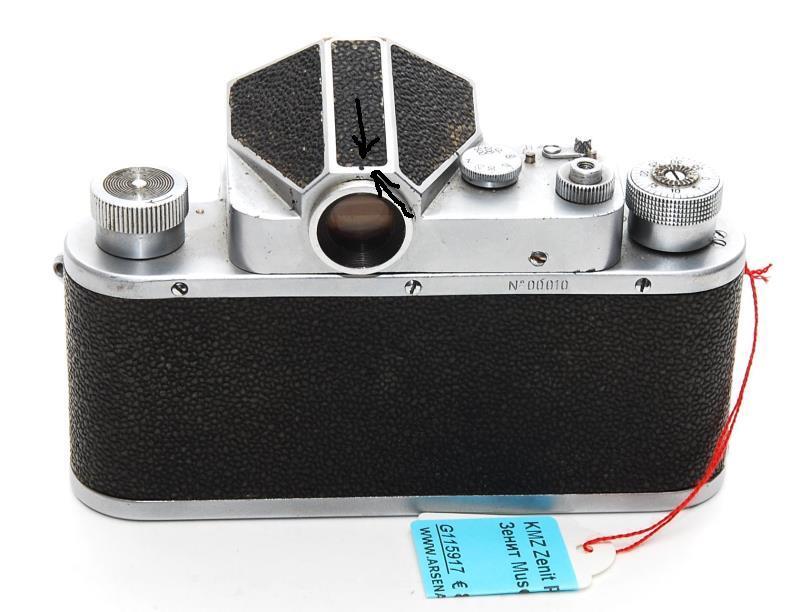

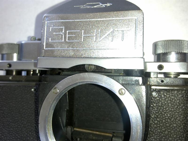

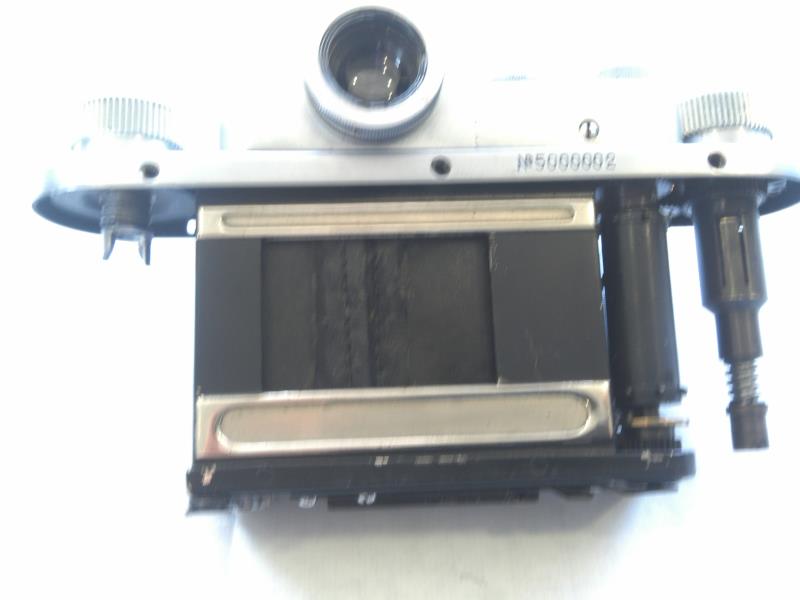

Hello everyone,
To keep the long story short - I've been corresponding with the owner of this camera (a member on this site - although inactive) for quite a while, having long discussions about this camera.
I have an opinion and the owner has an opinion, but I want to hear your expert opinions about this camera first before I present arguments from both sides, what do you think? Anything will be appreciated! Thanks!

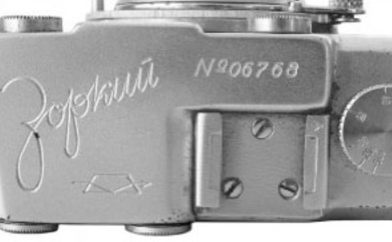

See this Picture from Dennis MO (the maker of a reflex and a rangefinder câmera in the French site Collection d'appareils photographiques de Silvain Halgand.
http://www.ussrphoto.com/resize/resize_image.aspx?ImgWd=800&IptFl=/UserContent/2102014_Dennis MO.png
http://www.ussrphoto.com/UserContent/2102014_Dennis MO.png
This câmera is from 1954 and has the front leather on prism. The lens is right, from the same era.
The shown Zenit is from 1950 and the lens is from 1955 which is slightly diferent from the Dennis picture. This sample has diopter correction at ocular and a strange arrow engraved on prism and no front leather. The square logo denotes experimental series.
At that era the production was low and several modification orders were accepted mainly for high grade officials.
I am curious in know your theories.

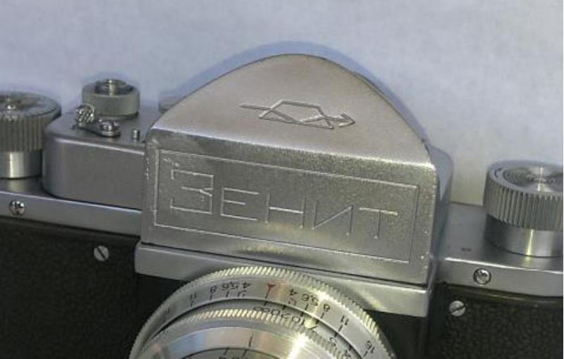

http://www.ussrphoto.com/resize/resize_image.aspx?ImgWd=800&IptFl=/UserContent/2102014_i7M8GZGLW.jpg
http://www.ussrphoto.com/UserContent/2102014_i7M8GZGLW.jpg
This camera is from J.L. Princelle, (stole it from Aidas's site, sorry Aidas [:)]) and it's #000003 from 1950. Notice the serial #s on both camera how they're presented, this mysterious one I've posted above is allegedly from the same year. Also I've never seen a rounded pentaprism like that this early, earliest example I know is from 1952... two years later.

But The owner brings up similarities with Zenit-L (c.1952) and tends to think that this camera was used as jumping point for Zenit-L with details such a KMZ logo engraved into pentaprism, the same bottom screws position and the same font on serial #.
http://www.ussrphoto.com/resize/resize_image.aspx?ImgWd=800&IptFl=/UserContent/2102014_Zenit-L.JPG
http://www.ussrphoto.com/UserContent/2102014_Zenit-L.JPG
(From Zenitcamera.com)

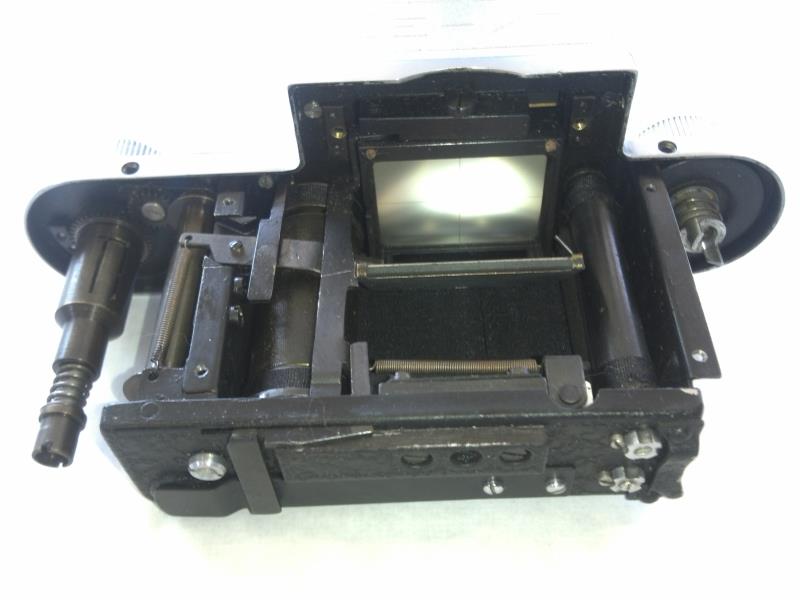

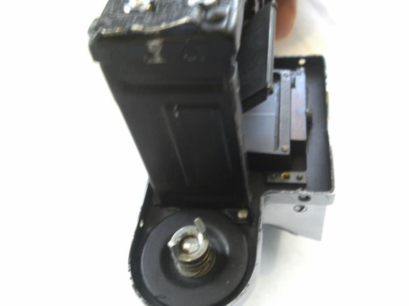

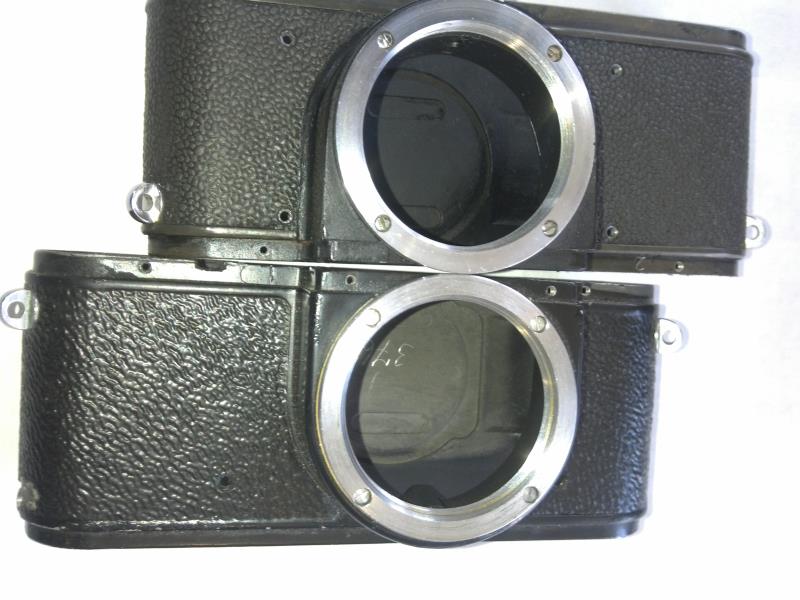

From owner:
Bottom of Zenit-L
http://www.ussrphoto.com/resize/resize_image.aspx?ImgWd=800&IptFl=/UserContent/2102014_zenitbottom.jpg
http://www.ussrphoto.com/UserContent/2102014_zenitbottom.jpg
http://www.ussrphoto.com/resize/resize_image.aspx?ImgWd=800&IptFl=/UserContent/2102014_00002.jpg
http://www.ussrphoto.com/UserContent/2102014_00002.jpg
http://www.ussrphoto.com/resize/resize_image.aspx?ImgWd=800&IptFl=/UserContent/2102014_IMG04.jpg
http://www.ussrphoto.com/UserContent/2102014_IMG04.jpg
I am skeptical to say the least about the authenticity but some of these are good points that he brings up. Luiz, 5000002 would mean the second Zenit ever made... From everywhere I look I see KMZ experimenting with this kind of bodies in 1952 the earliest... the timeline here confuses me maybe if Zoom sees this thread he can chime in... where are all our Zenit experts? [:)]
I'll translate the last two summary letters from the owner from Russian and post them here as well..

OK everything clear but what about the diopter adjustment?
and the little arrow at the left of the prism?

Sorry for rough translation (combination of Google and my editing, but I'm also posting a Russian text next to it for members that can read it):
<font size="3">If you look at the photo of the front of the camera - you can see that angles at the sides of the inscription "Zenit" have more acute form than mass-produced copies and in some places visible dents in chrome. This technology is similar of manufacturing of prototypes. Another significant difference from all known Zenit-1's is that it does not bend like regular chrome edging on one side of the shaft
I think this proves that in any case the camera not made from any other model. That is done so originally.
I think the year of my camera is pointing at the beginning of the project - pre-production sample. And it may have been made in the duration of one and a half years, changed details, make changes, etc, this the serial # from 1950.
In the final revision, that is, in the production version is likely to have been made by technlogists.
removed diopter corrector, made &#8203;&#8203;a dent with black leatherette on the front with the logo, as equipment has already been used on the prototype, put in an old speed dial in (manufactured in large quantities on the Zorkis) That in the final version of the product was reduced in cost mass produced.
I think my camera logically completes the entire line of ZENIT cameras prototypes . I do not think this is normal, when, after prototypes with angular pentaprism housings suddenly appeared a series like mine with a rounded form.
My camera is a link between all cameras lines of Zenit -1 ".

another letter from owner of the camera translated here:
<blockquote id="quote"><font size="1" face="MS Trebuchet, Arial, Helvetica" id="quote">quote:<hr height="1" noshade id="quote"><font size="3">
Lens, of course, is not a original, 1955 year. But the years of production of the camera, I would say that the camera production in 1950 -1952. (I think then there were the first production samples) I think that the frame logo ZENIT first appeared on my camera, if that is deemed a pre-production sample.
   Most likely the camera was designed for the running of manufacturing techniques and visualization of its assembled.
   Also, if you look closely, you can see how some of the technical solutions transferred from my camera to the camera ZENIT L /
1 On these cameras are identical figures font numbers.
2 Factory logo on both cameras placed on chrome.
3 There is a common item on the bottom cover both cameras: if you look at photos of Zenith L-bottom view you can see the two screws. (photo attached). My camera has exactly the same screws which attach a bar (maybe for better fixation of the film.), Which can be seen on the photo number 04.
4 In both bodies there is a corrector diopter. (On Zenith L is less technological, probably because pentaprism was not enough room.)

Luiz I think the arrow was drawn by the owner with a pencil to demonstrate a point in his letter regarding the angles...
Replied on: 20141002195041

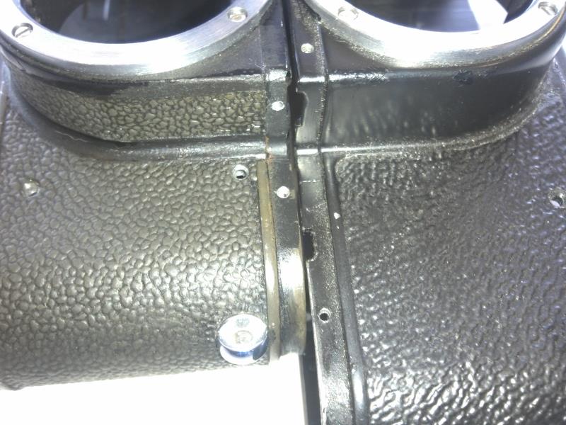

observe another thing:
the shown câmera allegedly stated as 1950 has a molded body of different construction of angled prism counterparts (see the trim around the body leather)and belong to the experimental series as stated on Zenit page
Replied on: 20141002195308
the arrow seems to be engraved on metal
let's know correctly
Replied on: 20141002195356
Luiz are you talking about the molding lines between the camera leather and the chrome parts? That this prototype has it like later versions and the sharp angled pentaprism prototypes do not?
Replied on: 20141002195659
exactly!
Replied on: 20141002201237
here the picture
http://www.ussrphoto.com/resize/resize_image.aspx?ImgWd=800&IptFl=/UserContent/2102014_zenit variations.png
http://www.ussrphoto.com/UserContent/2102014_zenit variations.png

I asked the owner of the camera about the arrow via email, will let you know. Also I asked if he could participate in here directly. We'll see if he can.
Replied on: 20141002211831
I've been also communicating with Bill Parkinson regarding this camera, here's what he had to say:
<blockquote id="quote"><font size="1" face="MS Trebuchet, Arial, Helvetica" id="quote">quote:<hr height="1" noshade id="quote"><font size="3">There is something that makes me think it has a possibility of being a prototype. That is the way the top plate looks to have been cut. What I mean is: If you look at the photo from the back, showing the serial number, you will see that there is a line where the top plate was cut, just to the right of the prism housing. Then it was put together, probably before the chrome plating was done. Tell me if you understand what I am referring to.
  I have seen this joining before on prototypes by KMZ. For example if you look closely at the photos of the Zorki-35m )that I once owned)on the wiki, you can see faint marks on the top plate on both sides of the accessory shoe (not sure if photos show two marks, but there was a cut mark on both sides of the shoe). So, I know that the way KMZ made some prototypes was to join parts from existing cameras. In your Zenit case, maybe the prism housing was joined to some other top plate from another camera.
  So those are some initial thoughts, but of course others could do it too, so I have not examined and thought about the other points in the thread yet.
</font id="size3"><hr height="1" noshade id="quote"></font id="quote"></blockquote id="quote">
Reply author: AlexanderK
Replied on: 20141003032107
Hello guys,
very interesting example. What strucked me immediately, that the camera has three screws on the chrome strip at the rear top. So, it is the body of early Zorki.
The prism on the top? Hm..., it could be really some try to prototype the first Zenit, but it could be also some work of our "fantasy designers" from the former Soviet Union. OK, it is only my speculations, but I would be very happy, if you find any arguments for the prototype.
Replied on: 20141003045345
I am far from knowing well Zenits, and I am delighted by this thread!
Just two remarks:
- the molded parts indicate a "late" Zorki, in fact later than 1950 (made in 1951/53, after the JLP). These molded parts come with the two screws in the back, the rigidity allowing to spare a screw. Before, the Zorki 1a, 1b and of course all the Fed 1 had 3 screws on the back.
- This square logo is reputed to belong to the preserie production batch. Hence (I suppose![:)]) the serial number with a year prefix. It seems that prototypes have serial numbers beginning with 000... at KMZ's. The square logo of the Zenit 1 prototype (with a cover angled, not rounded) is slightly different if I refer to the JLP.
Of course, the lens is not original.
All that makes me think of a camera made of parts of different years: do they work perfectly together?

Dear friends
When I saw the pictures first I was very skeptic but step by step I found details of the known prototypes 00001 and 00003:
- 3 screws on the back
- 2 screws in both sides of the chrom parts of the mirror housing
Very interesting also the modifications of the bottom with the center tripod mount witch not found there way in the production - too expensiv I think.
On the other side prism housing is some sort of home made, not so well done like on the other accepted prototypes.
The next step would be try to find differences between this probable prototype and early Zenit in the mechanic parts, will say inside the camera.

Replied on: 20141003074507
Thanks, Guido, for the article!
I was referring to the JLP who says about this "square logo-round top" (K1010)that it is a preserie with some hundreds of cameras only.
For the moment, it seeems to me that this camera is composed of:
- the base plate of a Fed Zorki or Zoki 1a (1948/50),
- the belt of a Zorki 1c (the moulding)(from 1951),
- the upper plate of a Fed Zorki to Zorki 1b (3 screws). For the front part, upper plate of a Zenit prototype (without screw),
- the rounded prism housing of a K1010 (preserie or beginning of production). Though this housing seems lower on this camera than on K1010s after photos ??
- buttons of K1010 too or after.
Difficult to think of a prototype made in 1950. Logically, it would be a camera assembled a bit later, for example to study the impact of a piece or another.
But these pieces (which seem from different dates) could too have been on tests at KMZ's as soon as 1950.
So....

To the facts of what you see:
--- the base plate of a Fed Zorki or Zoki 1a (1948/50)
Because of the two screws on the back part of the base plate? Well, nothing to say against, all early Zorki's used to have them for (for me) unknown reason. But take a look at this picture:
Two locks - never seen on any Zenit, Zorki or FED - and a tripod mount in the center (found first in the 60th on Zenit? I didn't found the first one, but the Zenit E hadn't it for example).
--- the belt of a Zorki 1c (the moulding)(from 1951)
Like the first type of Zenit 1 (K1010, K1020 ...) had them from 1952 on.
--- the upper plate of a Fed Zorki to Zorki 1b (3 screws)
I think you meen the screws on the back? Like the 00001 and 00003 (K1000) prototypes do have (I've seen pictures).
--- For the front part, upper plate of a Zenit prototype (without screw)
Right, and two screws on the left and the right side, like the 00001 and 00003 (K1000) prototypes too. BTW two of this screws walked to the front in the production models.
--- the rounded prism housing of a K1010 (preserie or beginning of production)
With some differences, wider belts. Same hight as I can see.
--- buttons of K1010 too or after
Buttons like K1005 too ...
I would give this prototype the Princelle code "K1007"! ;-)
Well, one point of skepticism will stay: The year 1950 according the serial number. If this camera is "the missing link" between the prototypes (K1000, K1005) and the production models (K1010, K1020), then the development of the first Zenit has begun in 1949, better in 1948, because such a development usually takes years. In the same time the Zorki 2 prototype (later build as Zorki 3) was designd, the Zorki 1 line development was ongoing. But okay, it could be possible.
Other opinions are wellcome!

Not a problem Guido, I have also noticed the side screws on the pentaprism housing as well as absence of front screws above the lens, that is why I thought this camera needed further discussion here rather than me just dismissing it as a fake.
Does it look like to anyone from the close up of the front of the pentaprism housing that the surface has been milled down to get rid of the indentation for the leather patch seen on production models?
Replied on: 20141003102739
Hello!
About your question, Vlad, all is probably too shining on this camera, by the photos! But it is certainly not a clue of anything: the owner can have it completely cleaned.
@ Guido: You are right to compare too the different details with other Zenits. I have not done it as the Zorkis are earlier (and I know them far better!). It would be interesting too to have a look at the mechanism. The 4 nut bolts, for example, don't belong to the early Zorki 1b. And the general appearance of the mechanism (bolts, paint, rivets, spring) exactly look like my Zorki 1b's s/n 32870, but not my early 1c's s/n 136850. I don't talk of the additional equipment special to Zenits.
About the two main buttons, they are both lined with stripes, not with points like on the K1005 (cf zenitcameras for better photos).
Perfectly OK to name K1007 this camera. I write that immediately on my JLP![8D]

Hello everyone! This is my father's camera so I'll be speaking on his behalf. Concerning the arrow on the picture. It is drawn to show the difference of the length of the edge of pentaprism. Here it is 7mm, while on Zenit S it's 11 mm.
All other defects -- a spot on the front groove on the rear panel next to the viewfinder is factory made. The duct cover is made of several parts.
I am afraid I am not able to answer all the questions, but don't hesitate to ask for clarification or more information about the camera. If you want us to take any other measurements, just ask.

Under the baseplate (second series of photos by Vlad), you can see from left to right:
- The lock which secures the baseplate: as on 1a, 1b. It changes with the 1c (changing of metallurgy) and becomes a part of the shutter box.
- The two bolts to regulate the shutters. Four nuts on these bolts. Fed-Zorkis, 1a and very early 1b have two nuts only. My s/n 32870 has already four.
- The spring connected to the release button. With a bend upwards, like Fed-Zorkis, 1a, 1b... after, the spring becomes flat, then it has the shape of a gull wing.
- The paint: crisp on this Zenit. Like on late Fed-Zorkis then all the other Zorkis. Bright paint before.
So, the mechanism makes me think of a 1950 Zorki's, modified for Zenit. But it would be necessary now to make the same comparison with different Zenits.

I think you focus too much on the Zorki family. The idea of modifying a Zorki and build a mirror and a pentaprism housing on it to make a SLR was of course at the beginning of the design process of this camera. But I'm not so shure that all the details used in the prototypes are taken directly from the actual Zorki production.
For the comparisation I upload a picture of two open Zorki (K1010 from 1952 and K1020 from 1953):
http://www.ussrphoto.com/resize/resize_image.aspx?ImgWd=800&IptFl=/UserContent/3102014_Boden_K1010-K1020.jpg
http://www.ussrphoto.com/UserContent/3102014_Boden_K1010-K1020.jpg
Maybe one screw is missing in the K1020? Now you can compar with the camera in question and I think you will see not much differences.

Of course, Guido, I focus too much on the Zorki side: I don't know the Zenit one, but by books or the net!
By your photos, there was no real evolution on the Zenit side between this "K1007" and your K1010 and K1020. Except for the lock of the baseplate: yours are later and are similar to Zorki 1c's ones. Just the same for the spring which is not bent upright on your photos. So, I think that this camera is earlier.
A point more for a prototype.

Let me share results of my theoretical investigations of this matter.
There is an article called “Our objectives 1950” (Russian “Íàøè çàäà÷è” 1950) at this web-site www.zenitcamera.com/archive/zenit-1/index.html
It’s written there that new samples of Zorki – 3 and Smena were designed over the past year (it’s assumed that Smena is Zenit)
The very name Zenit is mentioned in 1949 (the references are at the web-site ). Taking into account the strict labor policies, when you could be imprisoned for running late at your working place, and the commitments were to be kept, then, it’s likely that the top panel of my camera was made and the date of my beginning of the production was affixed for to have something to present to the factory management. Then surveying work, prototypes, testing of construction and design were started.
If we assume that my camera is a pre-production sample, then it was in produce until the run of a test batch.
Therefore, since according to the technology the upper panel is made after the shutter, then it is likely to have many features in common with shutters of the prototypes, and the camera body itself with the first production samples, that is, more technological option is selected.
So I think if the camera is made of different parts later then that's fine. The camera was not in use and works perfectly.
Now about the duct cover. It was identified as round, I think, due to the fact that at this time Kontaks was in a process of developing in the GDR (I might be mistaken, I am an amateur) and Kontaks has chopped corners of the duct cover and in order to avoid accusation in plagiarism they have made another duct.
But here is a more practical thing. If we assume that my camera is fake, let’s then try figure out from what kind of camera’s cape the cape on my camera is made.
I don’t thing that it was created manually for a fake sample.
In order to do so I pointed to its measurements on the picture. Let’s compare them with the measurements on Guido’s cameras.
1. The height of the front panel with the inscription Zenith is 21mm.
2. The height of beveled front panel with the factory logo is 16.5 mm.
3. The width of the front chrome edging in front and above of the factory logo - 4mm".

Something curious about the speed scale.
This one has the new one (B, 1/25th..., 1/500th)which appeared on the 1952 "square logo" K1010 for the first time.
The first series of prototypes K1000 had the former one (Z, 1/20th...). For the second series (K1005), I am unable to see on the JLP and on Sovietcams.
So, this camera was certainly not entirely made in 1950. Unless perhaps if the K 1005 can be the missing link about that scale.
A point less for the prototype?
No comparison that time with the Zorkis [;)] The new scale will arrive in 1954 for them!

Here by the way the picture of the 00010 sold on eBay in 2008 from Boris for 10000 US$ (or Euros? I don't remember):
http://www.ussrphoto.com/resize/resize_image.aspx?ImgWd=800&IptFl=/UserContent/4102014_00010_1.jpg
http://www.ussrphoto.com/UserContent/4102014_00010_1.jpg
http://www.ussrphoto.com/resize/resize_image.aspx?ImgWd=800&IptFl=/UserContent/4102014_00010_2.jpg
http://www.ussrphoto.com/UserContent/4102014_00010_2.jpg
http://www.ussrphoto.com/resize/resize_image.aspx?ImgWd=800&IptFl=/UserContent/4102014_00010_3.jpg
http://www.ussrphoto.com/UserContent/4102014_00010_3.jpg

Well, the difference of over 100g in the weight is very much, much more than I was thinking. 20% ...
The bottom plate of my early Zenit 1 is 47g but I'm not so shure that would be very relevant.
Your measurements are a great idea too. Here the results of mine:
1. exactly the same, 21mm
2. hmm ... 21mm on mine!
3. 3.3mm, but the edge is much rounder, so not really to compair
I don't know why this big difference at point 2. Could you maybe find an other Zenit-1 or Zenit-C and compair both pentaprism housings side by side? You know that I noted earlier that I seen some possible differences in shape of this parts.
Thank you for sharing the results of your research. I can't say too much on this. But I'm on this even I don't have followed all the links in detail.
The timeline you established looks fine to me and there are no big differences to mine.
The idea about a problem about plagiarism with the GDR company Pentacon with the Contax D models I like very much if I think at all the 100% copies of Contax II and III made by Kiev and many other copies made in the USSR, all the early FED and Zorki were copies of the Leica II Modell D by the way.
At the moment I tend to say the chance your camera is a real prototype is not so bad. As I said before now someone should open the camera and compair it with an early Zenit-1. I don't know nothing about inspecting cameras "inside", so don't count on me in this.
But I wish you good luck that some experts will find out the truth!

Guido: thanks for the photo of the s/n 10. Now, things are more clear. The visible mechanism on this K 1005 is exactly the same as the so called K 1007. A Zorki 1b's. But as the 1b has the former speed scale, I wonder if the speed mechanism has 6 (B to 1/500th) or 8 (Z to 1/500th) slots.

This #5000002 should be behind PM3010 and PM3015 (sovietcams.com) in the timeline. I'm not sure if this #5000002 is original, there are just a lot of strange parts.
In the later production the diameter of the lower part of the timewheel changed. First this diameter was smaller, later it was bigger, same as this #5000002 with a bigger diameter. But the position of the numbers on top of the timewheel is special on this #5000002. In the production the gap between 250 and 500 is smaller and the gap between 100 and 250 is wider. Here on the #5000002 the gaps are the same but 500 has a dash to a different location on the wheel.
As already mentioned, the shutter is in style of a Zorki-1b while the vucanite-housing is in style of a Zorki-1c. This difference doesn't make much sense because there was no mix of both parts in the Zorki-1 production even when both 1b and 1c were produced at the same time for some month. Why mix both parts when they were available at the same time.
A comparison with PM3010 and PM3015 could be interesting because they should be earlier prototypes, both with the vulcanite-housing in style of a Zorki-1c but not the round reflex top. But who knows if these 2 are original because PM3020 (#00010) has already the counter on top of the wind-knob but still the vulcanite-kousing in style of a Zorki-1b.

Interesting to know would be the length on top of the reflex-top between the edge at the frontside over the KMZ-logo and the edge at the backside over the viewfinder.
It is very easy to demount the vulcanite-housing. It does not need to be taken away completely, it would be enough to just move it down 1cm. Interesting would be if there are screw-holes in this housing on the frontside above the lens-mount. If there are screw-holes it would seem that this housing belongs to a later production series. This would be interesting for PM3010 and PM3015 either.

You have understand, I just try to find details which wouldn't "stick". The number of slots in the speed mechanism compared to what is on the dial, for example. And if the first Zenits are undoubtedly from Zorki origins, the derivation can be less evident after. It can even be reversed: the new speeds appeared on Zenits first!
I agree with you: the details which are not on the line can be explained one by one. For example, by the important interval which is possible between conception (prototype side) and application (production side). All the question is to know if we don't go too far in that way. What is the limit?
Finally, what is a prototype? The trial of (a) new solution(s)? Probably. So, what is new in this camera, compared with the "official" prototypes? The dioptric correction? The new moulded body? Something else? If we can answer a question of this type, I feel we will have made a large step towards the prototype. But are these questions valid?
As I have already said, my knowledge is limited to rangefinders. Thanks to that thread, I know better the Zenits. All my ackowledgments!
@Lenny:your question about the trace of screws under the vulcanite is very interesting. I am surprised too by these 1b/1c mixed parts.

The difference in weight around 100 g is alright. My camera has got an additional detail --- dioptric corrector (or “an adjuster”). It is complicated and made of brass, so it can take the weight difference.
Thanks to Guido for sending his measurements. The last measurement, the smallest one, is important for me.
Many think that the prism pit is taken from the first serial sample i.e. they deleted vulcanite with factory logo, polished the chrome edge to smooth at place where vulcanite was, and again put chrome and the factory logo on the chrome.
Measurements provided by you show that it is not possible.
1. The size is totally different in measurement 2 which is the height of the bevel.
2. In order to do that the width of the edge (measurement 3) on the third serial camera should be around 5mm ( 4 mm of my camera then + 1 mm for cleaning of a top layer and leveling the surface for chrome)
3. The prism pit of my camera does not fit to the size of Zenit S which is 1-18,5mm. 2-18 mm.3-2mm .
It follows then that the prism pit is a different instance, a third one.
I was confused myself when I saw heads of shutter speed, so I’ve done some investigation. What came to my mind first is that the head was taken from the old camera but the old shutter speed dial was left. If the change of head happens then scale on the head does not match to the scale on the body as distance between holes on different disks (dials) is different.

As already mentioned the lens is a later version and does not match if #5000002 is a prototype.
The diopter-viewfinder shows heavy wear and does not match #5000002 with less wear.
The bottom-plate shows also more wear and does not seem to match #5000002. Besides that this bottom-plate with the additional 2 screws in this style was used for a Zorki-1b and does not match the vulcanite-housing in style of a Zorki-1c.
The lock in this bottom-plate is also a newer version same as also used in Zorki-C/2/2C and does not match a bottom-plate with the additional 2 screws used for a Zorki-1b.
All in all too many parts which do not match and with different wear. The refex-top and the time-wheel look special, other parts seem to be from later production series. I would not regard this #5000002 as a prototype. Too many other facts which are doubtful that KMZ had used them AT THAT TIME because they do not make sense and that is recognizable.

There was no reason to fake cameras at that time. For example the 1959 Zorki-2C with a remarked top-plate of a Zorki-C. Nobody wanted this trash at that time, they were used as giveaways for the political party if you believe this story mentioned here on this site. Now a remarked Zorki-2C has a much higher value. The intention to fake cameras at that time can hardly be believed.

It was said that this person who was responsible that this #5000002 was made was not a member of the design department. It was said that it was unoffically made. Also this 7-digit serial-number is not the type which KMZ used at that time, it is NOT an official serial-number.
The joint on the refex-top is poorly made because there is a gap to the plate below. I am sure KMZ could have made this joint in much better quality at that time.
The bottom-plate is the older version with the additional two screws, while #00010 has the newer bottom-plate without those two screws.
It would not surprise me if the vulcanite-housing has screw-holes on the frontside above the lens-mount which would mean it is a newer production-part and then everything would make sense.

Reply author: Nordmannen
Replied on: 20141010121434
Hello! Sorry for the delay.
"With the prototype 00010, as we agreed, the similarity is how the shutter is made in this camera and my camera. I will try to show that diopter adjustment is alike to the prototype 00010 as well.
If you take a look at Guido’s picture (the perspective from behind, showed by arrow) we can notice a dot on the housing- it seems like there was supposed to be diopter adjustment on this camera as well, but it wasn’t done probably because of the absence of available space. Therefore, the project has been realized on my camera, prism was reduced in size and the pit was done differently. I think there is prism form a prototype 00010 on Ê1020 and Ê1010 that’s why the pits are big. We could compare their pits with the pit of 00010.
The dot pointed at the picture doesn’t look like a factory defect or damage.
Besides this, my camera has (possibly on the prism) a thin black line throughout the frame in the form of +. I recently understood its function.
When the camera focusing on the object, firstly you need to get a sharp image of this line (corrected for vision) with the diopter adjuster and then focus the lens zoom. It seems to me that this procedure proves the relevance of the diopter adjuster.
After that, when the producers removed the adjuster in serial samples, I do not exclude that some of the cameras were produced with such a line as they needed to readjust the equipment before making new samples. Wear and tear of the adjuster I explain by the fact that it extends out of the camera body to 6mm - fragile item".

My father has some knowledge of mechanics, so he probably can do a simple disassembly of the camera.
He asked to explain what you want to see, how to get to it, and what’s the sense in seeing this or that part.
Another thins we are cautious about is that the camera had never been disassembled. Since the camera is to be for sale we are wondering if disassembly would affect the price.

First take away the bottom-plate and the lens.
The serial-number is placed on a rim. Also on this rim are 7 screws around the camera. Screw all those 7 screws out but remember which screw belongs to which hole, especially the one under the wind-knob. Those screws may be different in length.
Then you only need to take away the 4 screws on the vulcanite on the frontside.
Now the vulcanite-housing can be easily moved down. It is only needed to move it down for 1cm.
Newer productional-cameras have 2 screws ON THE FRONTSIDE on the rim above the lens-mount. But the prototype-cameras like the #00010 and the #5000002 have those 2 screws ON THE SIDE on the rim, left and right.
When moving down the vulcanite-housing for 1cm it must be recognizable if the vulcanite-housing has also screw-holes ON THE FRONTSIDE above the lens-mount. This would indicate that the vulcanite-housing could be a newer productional-part and not a part made for a prototype. Because the prototypes do not have screws ON THE FRONTSIDE on the rim.
After moving the vulcanite-housing down for only 1cm to check the housing move it up again and put all screws into the same holes again. Everything must work fine again after it.
It would be good to take a look on a newer productional camera to know the exact location of those 2 screws ON THE FRONTSIDE.
Reply author: nightphoto
Replied on: 20141012123730
Lurii,
Lenny's instructions sound good. I would add: (1) You don't want to make any marks on the screw heads. So, you must use the correct size screwdriver. Not too small, but one that fits perfectly. Also you can use a bit of tissue or thin cloth to put on the screwdriver so as not scratch the screws. (2) Make sure to photograph everything from all angles and as close as possible once you have the pieces apart.
Also, do not jump to conclusions. If this is a prototype or pre-series that is close to the production cameras, it may be possible that the screws have been moved to the front already. That is why photos will be very important. Try to get close-up photos showing the exact location of these screws, for comparison, as Lenny has said. Also, take photos of everything on all sides of the camera. Good luck, and if you are careful and slow it won't hurt the value of the camera to do this.
Replied on: 20141014124015
Here are some pictures.
http://www.ussrphoto.com/resize/resize_image.aspx?ImgWd=800&IptFl=/UserContent/14102014_IMG480.jpg
http://www.ussrphoto.com/UserContent/14102014_IMG480.jpg
http://www.ussrphoto.com/resize/resize_image.aspx?ImgWd=800&IptFl=/UserContent/14102014_IMG478.jpg
http://www.ussrphoto.com/UserContent/14102014_IMG478.jpg
http://www.ussrphoto.com/resize/resize_image.aspx?ImgWd=800&IptFl=/UserContent/14102014_IMG479.jpg
http://www.ussrphoto.com/UserContent/14102014_IMG479.jpg
Replied on: 20141014124231
And some more
http://www.ussrphoto.com/resize/resize_image.aspx?ImgWd=800&IptFl=/UserContent/14102014_IMG475.jpg
http://www.ussrphoto.com/UserContent/14102014_IMG475.jpg
http://www.ussrphoto.com/resize/resize_image.aspx?ImgWd=800&IptFl=/UserContent/14102014_IMG474.jpg
http://www.ussrphoto.com/UserContent/14102014_IMG474.jpg
http://www.ussrphoto.com/resize/resize_image.aspx?ImgWd=800&IptFl=/UserContent/14102014_IMG472.jpg
http://www.ussrphoto.com/UserContent/14102014_IMG472.jpg
Reply author: Guido
Replied on: 20141014131357
Hello Iurii
Thank you for the new pictures. Very interesting pictures and the missing drill holes are for me an important evidence that's not a simple fake! I hope some experts will see other details because I don't understand absolutly nothing of the "things in the inside".

Dear members
I'm very surprised that no one but Lenny said anything about the pictures posted by Iurii. Really no opinion about this pictures? No more comments? Sorry, I'm wondering about ... Do you really have no opinion or there are other reasons to not talking about?
Okay, I have also some problems with the questions of Iurii because of his intentions to sell the camera and make as much money as possible. But this is only one aspect of this case, the other is the historical one. And maybe also the necessity to accept that other prototypes are existing and the history of the development of the Zenit 1 series must be changed. Maybe we should call this camera a "experimental" one, but for me it's not a big difference.
Please let me know your opinions, please share your opinions! And as an additional question, why you don't said anything about all this in the last time? Is there any reason not to talk about this camera? Sorry if I'm in trouble with this, but I don't understand.
Replied on: 20141015203225
I carefully examined the pictures, but I am not an expert on camera repair so I can't back any of my statements up by experience here.. sorry... I think one of few people here who actually has extensive repair experience here is Luiz.. I'm very curious on what he has to say. And thank you Iurii for posting the pictures, I am sure there will be people reading here that have qualifications to make conclusions.
Replied on: 20141015230003
Dear Guido and All,
I have not said anything because I have been looking at the photos over and over. To me, everything looks okay for authenticity of a prototype (or more probably, an early pre-series because of the style of serial number, which includes a year). But, I am no expert on identifying all of the parts on the interior.
If all of the parts on the interior are either unique (hand made) or from cameras of 1950 or earlier, then that would point towards authenticity. To me, the way the prism housing and top plate are fabricated look authentic in technique as a KMZ workshop piece. I think that the diopter feature would be very hard to fake and also very hard to put into production on a large scale, so that looks like an authentic prototype feature as well. The engravings look to be authentic and it is more possible to get a close look at them in the new photos. I find that Iurii has been forthright and open and has responded to requests for information and photos without problem. As well, it would appear that Zoom thinks the camera is authentic in some regard (at least not a recent fake) and I value his opinions very highly.
If someone has a problem with the history of Zenit development and where this camera fits or doesn't fit, then I they would have to tell how the present line-up of known prototypes have been dated and why it would not be correct for this camera to fit in, either by dating or by the design of it. Since the other known prototypes have squared off prism housings and the production cameras have rounded housings, I'm not sure how anyone would expect that there would not be a prototype of the rounded housing design. To me it is a big change between a squared housing and a rounded housing and would have to be shown in person to the directors before proceeding with a rounded production model.
So, those are my thoughts as of now. But I am not an expert. Probably if I was still collecting I would want this camera. But what is the price? Thanks for the new photos Iurii.
Replied on: 20141017105414
Lenny,
Can you say what you think the differences between these logos are? First is this camera we are talking about. Second is a 1949 Zorki.
http://www.ussrphoto.com/resize/resize_image.aspx?ImgWd=800&IptFl=/UserContent/17102014_zenit 5000002.jpg
http://www.ussrphoto.com/UserContent/17102014_zenit 5000002.jpg
http://www.ussrphoto.com/resize/resize_image.aspx?ImgWd=800&IptFl=/UserContent/17102014_zorki.jpg
http://www.ussrphoto.com/UserContent/17102014_zorki.jpg
Reply author: Lenny
Replied on: 20141019061641
<blockquote id="quote"><font size="1" face="MS Trebuchet, Arial, Helvetica" id="quote">quote:<hr height="1" noshade id="quote"><i>Originally posted by nightphoto</i>
<br />Can you say what you think the differences between these logos are? First is this camera we are talking about. Second is a 1949 Zorki.
Thank you very much Bill,
so I checked many Zorki-1 logos of the non-export version, because there is enough room for the logo and I found many different ones.
- trapezoids with short base but high with steep sides
- trapezoids with long base not so high and not so steep sides
- trapezoids where each side has a different angle
- much later stamped trapezoids with a very short top
KMZ was not capable to produce the same logo in the same period of time. I think impossible for a Leica. Maybe KMZ did this all to please us collectors. I will keep an eye on the trapezoids.
