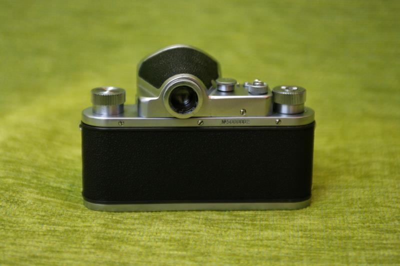

Hello everyone,
To keep the long story short - I've been corresponding with the owner of this camera (a member on this site - although inactive) for quite a while, having long discussions about this camera.
I have an opinion and the owner has an opinion, but I want to hear your expert opinions about this camera first before I present arguments from both sides, what do you think? Anything will be appreciated! Thanks!

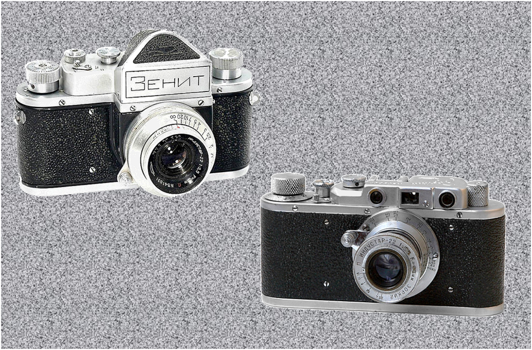

See this Picture from Dennis MO (the maker of a reflex and a rangefinder câmera in the French site Collection d'appareils photographiques de Silvain Halgand.
This câmera is from 1954 and has the front leather on prism. The lens is right, from the same era.
The shown Zenit is from 1950 and the lens is from 1955 which is slightly diferent from the Dennis picture. This sample has diopter correction at ocular and a strange arrow engraved on prism and no front leather. The square logo denotes experimental series.

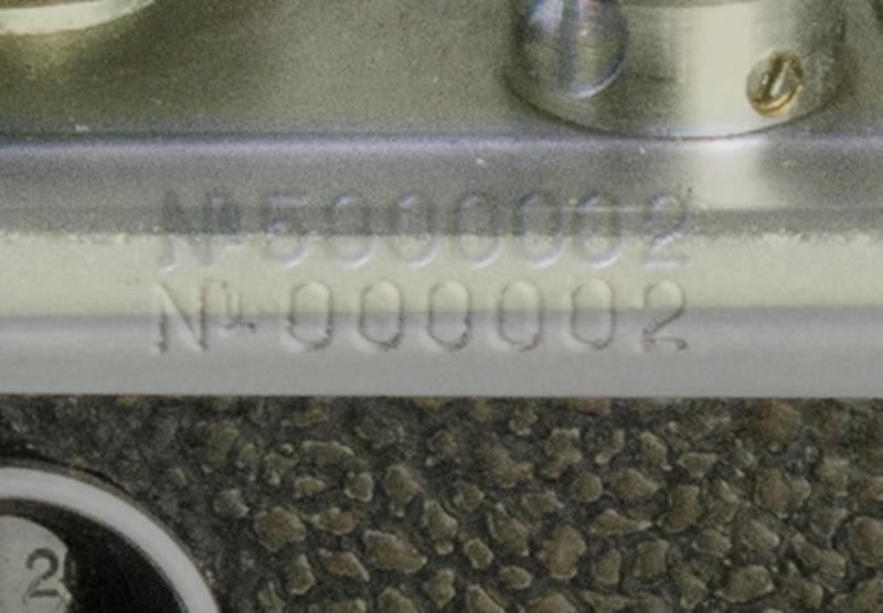

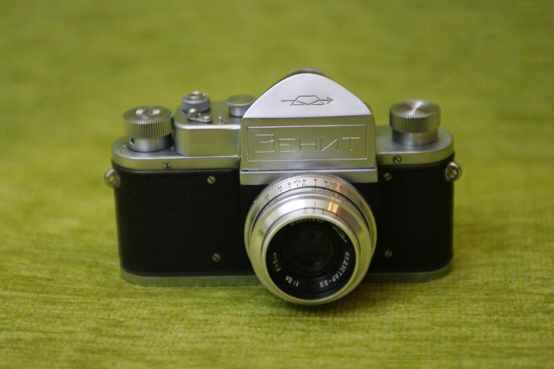

Discard the lens, we both believe it's not original to the camera.. I am puzzled by this though:

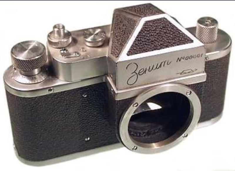

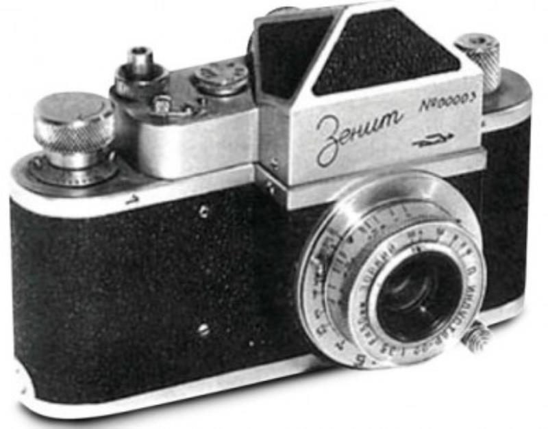

This camera is from J.L. Princelle, (stole it from Aidas's site, sorry Aidas Smile) and it's #000003 from 1950. Notice the serial #s on both camera how they're presented, this mysterious one I've posted above is allegedly from the same year. Also I've never seen a rounded pentaprism like that this early, earliest example I know is from 1952... two years later.
And this is Zenit #0001 from 1950 as well: (from Zenitcamera.com)
But The owner brings up similarities with Zenit-L (c.1952) and tends to think that this camera was used as jumping point for Zenit-L with details such a KMZ logo engraved into pentaprism, the same bottom screws position and the same font on serial #.
(From Zenitcamera.com)

I am skeptical to say the least about the authenticity but some of these are good points that he brings up. Luiz, 5000002 would mean the second Zenit ever made... From everywhere I look I see KMZ experimenting with this kind of bodies in 1952 the earliest... the timeline here confuses me maybe if Zoom sees this thread he can chime in... where are all our Zenit experts? Smile
I'll translate the last two summary letters from the owner from Russian and post them here as well..
Sorry for rough translation (combination of Google and my editing, but I'm also posting a Russian text next to it for members that can read it):
If you look at the photo of the front of the camera - you can see that angles at the sides of the inscription "Zenit" have more acute form than mass-produced copies and in some places visible dents in chrome. This technology is similar of manufacturing of prototypes. Another significant difference from all known Zenit-1's is that it does not bend like regular chrome edging on one side of the shaft
I think this proves that in any case the camera not made from any other model. That is done so originally.
I think the year of my camera is pointing at the beginning of the project - pre-production sample. And it may have been made in the duration of one and a half years, changed details, make changes, etc, this the serial # from 1950.
In the final revision, that is, in the production version is likely to have been made by technlogists.
removed diopter corrector, made ​​a dent with black leatherette on the front with the logo, as equipment has already been used on the prototype, put in an old speed dial in (manufactured in large quantities on the Zorkis) That in the final version of the product was reduced in cost mass produced.
I think my camera logically completes the entire line of ZENIT cameras prototypes . I do not think this is normal, when, after prototypes with angular pentaprism housings suddenly appeared a series like mine with a rounded form.
My camera is a link between all cameras lines of Zenit -1 ".

another letter from owner of the camera translated here:
Lens, of course, is not a original, 1955 year. But the years of production of the camera, I would say that the camera production in 1950 -1952. (I think then there were the first production samples) I think that the frame logo ZENIT first appeared on my camera, if that is deemed a pre-production sample.
   Most likely the camera was designed for the running of manufacturing techniques and visualization of its assembled.
   Also, if you look closely, you can see how some of the technical solutions transferred from my camera to the camera ZENIT L /
1 On these cameras are identical figures font numbers.
2 Factory logo on both cameras placed on chrome.

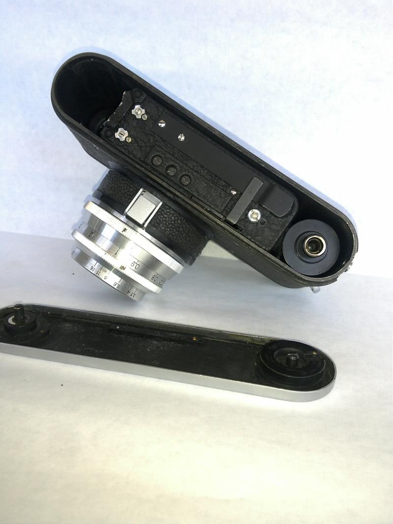

3 There is a common item on the bottom cover both cameras: if you look at photos of Zenith L-bottom view you can see the two screws. (photo attached). My camera has exactly the same screws which attach a bar (maybe for better fixation of the film.), Which can be seen on the photo number 04.
4 In both bodies there is a corrector diopter. (On Zenith L is less technological, probably because pentaprism was not enough room.)

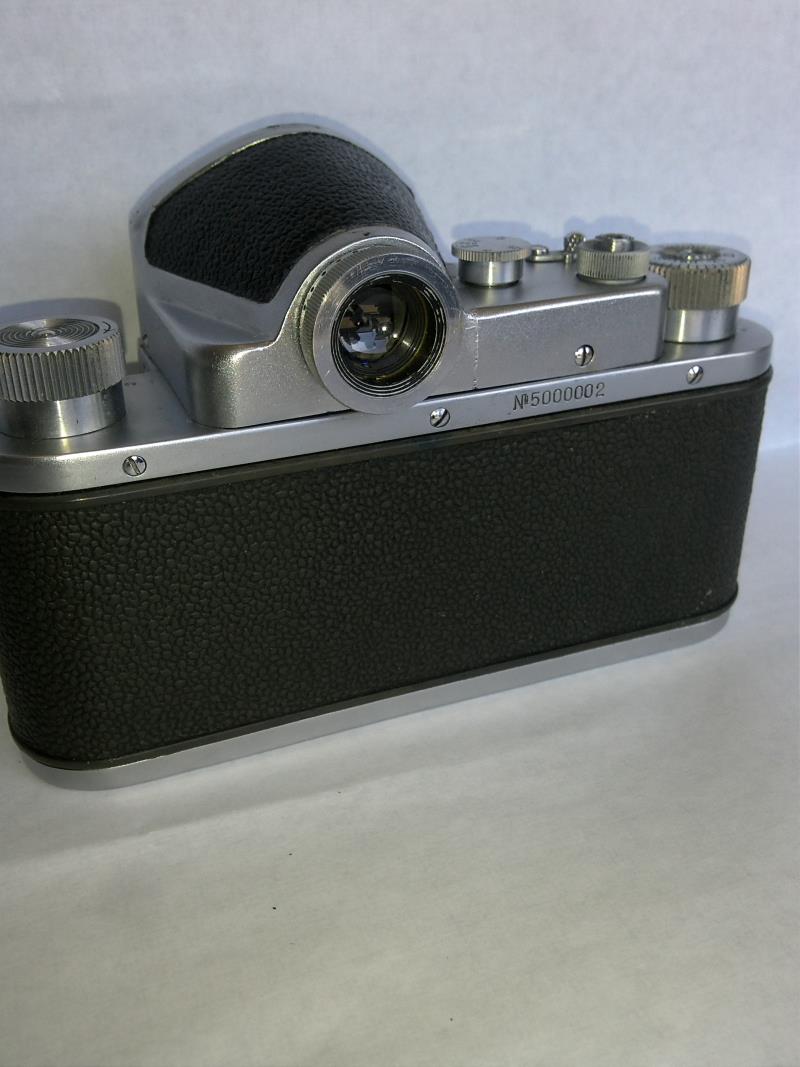

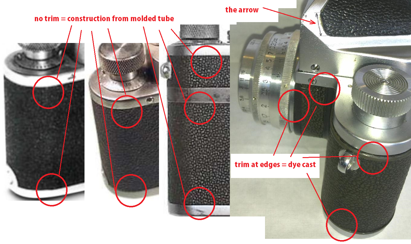

Luiz I think the arrow was drawn by the owner with a pencil to demonstrate a point in his letter regarding the angles...

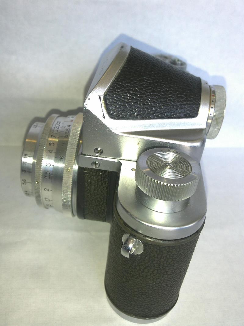

observe another thing:
the shown câmera allegedly stated as 1950 has a molded body of different construction of angled prism counterparts (see the trim around the body leather)and belong to the experimental series as stated on Zenit page
the arrow seems to be engraved on metal
let's know correctly
Luiz are you talking about the molding lines between the camera leather and the chrome parts? That this prototype has it like later versions and the sharp angled pentaprism prototypes do not?
exactly!
here the picture
Good point! That also helps determine the age of the camera...
I asked the owner of the camera about the arrow via email, will let you know. Also I asked if he could participate in here directly. We'll see if he can.

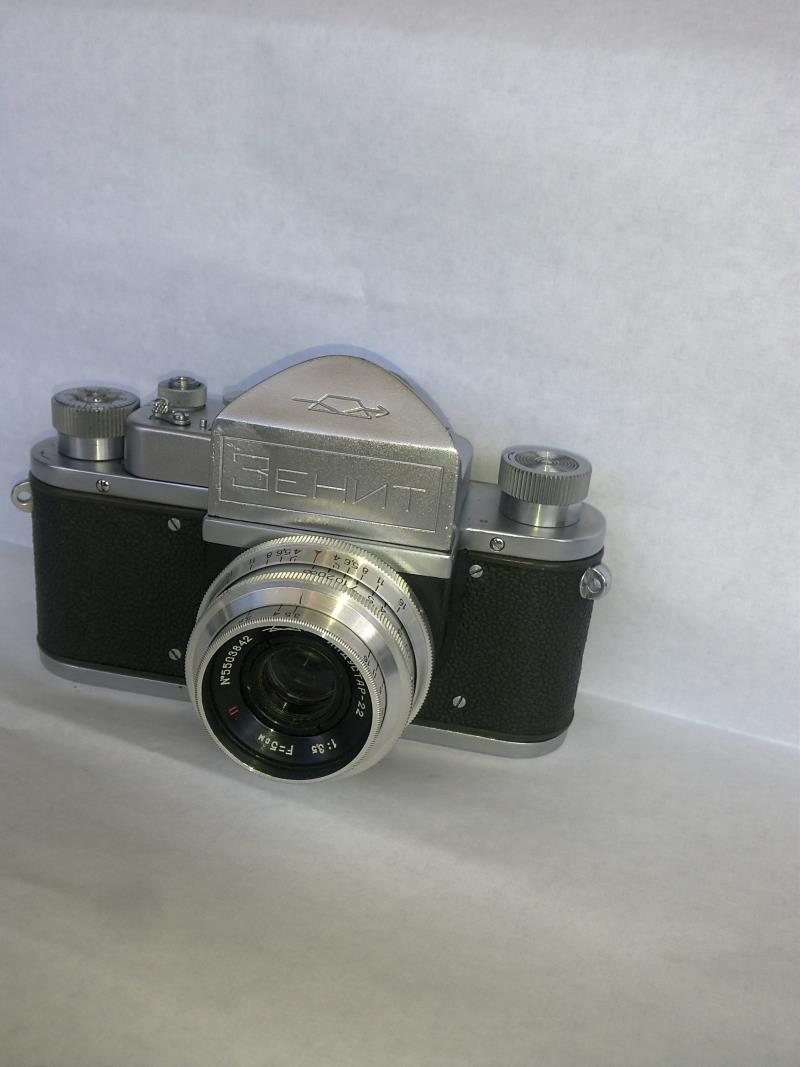

I've been also communicating with Bill Parkinson regarding this camera, here's what he had to say:
There is something that makes me think it has a possibility of being a prototype. That is the way the top plate looks to have been cut. What I mean is: If you look at the photo from the back, showing the serial number, you will see that there is a line where the top plate was cut, just to the right of the prism housing. Then it was put together, probably before the chrome plating was done. Tell me if you understand what I am referring to.
  I have seen this joining before on prototypes by KMZ. For example if you look closely at the photos of the Zorki-35m )that I once owned)on the wiki, you can see faint marks on the top plate on both sides of the accessory shoe (not sure if photos show two marks, but there was a cut mark on both sides of the shoe). So, I know that the way KMZ made some prototypes was to join parts from existing cameras. In your Zenit case, maybe the prism housing was joined to some other top plate from another camera.
  So those are some initial thoughts, but of course others could do it too, so I have not examined and thought about the other points in the thread yet.

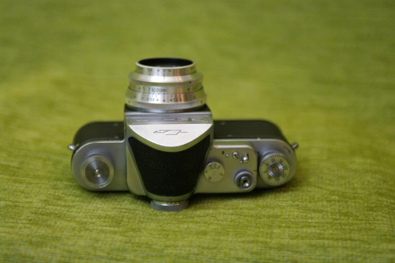

very interesting example. What strucked me immediately, that the camera has three screws on the chrome strip at the rear top. So, it is the body of early Zorki.
The prism on the top? Hm..., it could be really some try to prototype the first Zenit, but it could be also some work of our "fantasy designers" from the former Soviet Union. OK, it is only my speculations, but I would be very happy, if you find any arguments for the prototype.

When I saw the pictures first I was very skeptic but step by step I found details of the known prototypes 00001 and 00003:

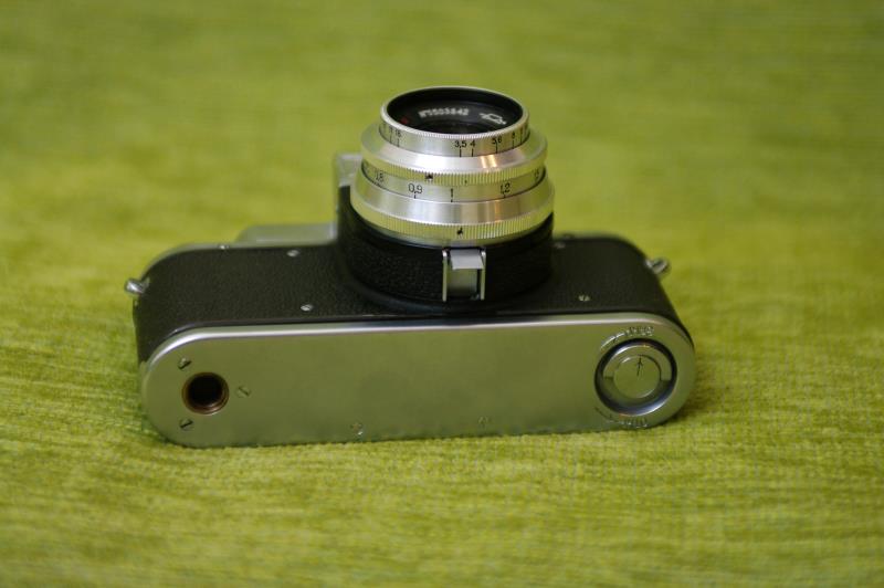

- 3 screws on the back
- 2 screws in both sides of the chrom parts of the mirror housing
Very interesting also the modifications of the bottom with the center tripod mount witch not found there way in the production - too expensiv I think.
On the other side prism housing is some sort of home made, not so well done like on the other accepted prototypes.
The next step would be try to find differences between this probable prototype and early Zenit in the mechanic parts, will say inside the camera.

Thank you everyone for your very constructive opinions thus far, here is my top concern about this camera and why I'm still skeptical about it: Molded die cast bodies only appear in 1951, yet this model seems to be using one and has a serial # of 1950. Luiz had an excellent point right away there. Being a prototype I can see it use at least Zorki-1a or Zorki-1b body for that, it's too early for Zorki-1c which what it seems to use.
I've had further conversations with Bill Parkinson about it and he also agrees with me now in regards to discrepancy of the timeline, Aidas (who had examined it carefully himself separately before and the overlapping serial# picture is his) and Alexey Nikitin also keep an nagative opinion regarding the authenticity.
There's a lot of stuff that is "off" on this camera in my opinion.. but then again, too many abormalities raise eyebrows as Guido pointed out the middle tripod socket..

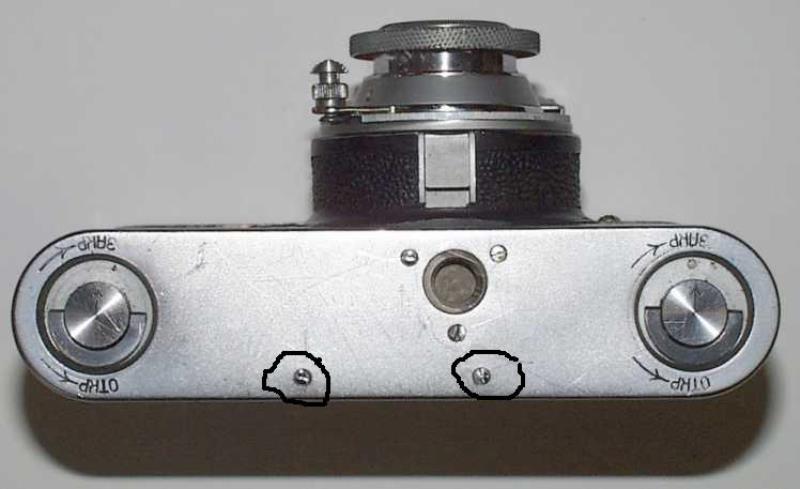

To the facts of what you see:
--- the base plate of a Fed Zorki or Zoki 1a (1948/50)
Because of the two screws on the back part of the base plate? Well, nothing to say against, all early Zorki's used to have them for (for me) unknown reason. But take a look at this picture:
http://www.ussrphoto.com/UserContent/2102014_zenitbottom.jpg
Two locks - never seen on any Zenit, Zorki or FED - and a tripod mount in the center (found first in the 60th on Zenit? I didn't found the first one, but the Zenit E hadn't it for example).

I think you meen the screws on the back? Like the 00001 and 00003 (K1000) prototypes do have (I've seen pictures).
--- For the front part, upper plate of a Zenit prototype (without screw)
Right, and two screws on the left and the right side, like the 00001 and 00003 (K1000) prototypes too. BTW two of this screws walked to the front in the production models.

Guido, actually the middle tripod socket picture is not from this camera, I believe it's from the Zenit-L for comparison (provided by owner). The bottom of this camera is one of the first pictures
