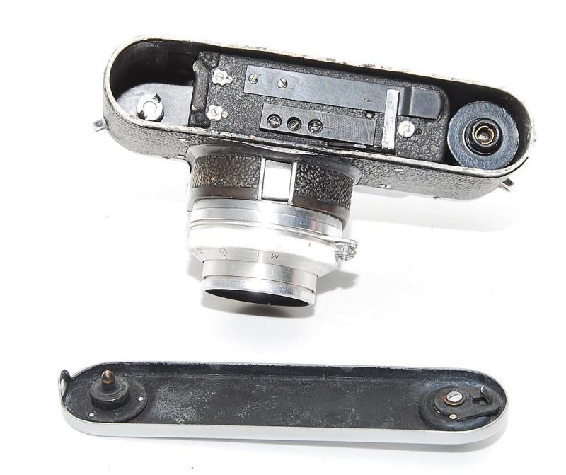

I'm not very shure from witch nut bolts you're talking, sorry. Do you meen the parts under the bottom plate? I can only say that there are little differences between the one of the camera in question and a very early K1010. An other form of screw and a spring (?) with a little other shape.
The thing with the buttons on the K1005 is interesting. The picture on zenitcamera.com shows what you will say, but I have here a picture of then K1005 with s/n 00010 (sold on eBay some years ago) with one button with stripes and one with points ... ;->
Hi Guido,
I try to be better in my explanations...Tongue
Under the baseplate (second series of photos by Vlad), you can see from left to right:
- The lock which secures the baseplate: as on 1a, 1b. It changes with the 1c (changing of metallurgy) and becomes a part of the shutter box.
- The two bolts to regulate the shutters. Four nuts on these bolts. Fed-Zorkis, 1a and very early 1b have two nuts only. My s/n 32870 has already four.
- The spring connected to the release button. With a bend upwards, like Fed-Zorkis, 1a, 1b... after, the spring becomes flat, then it has the shape of a gull wing.
- The paint: crisp on this Zenit. Like on late Fed-Zorkis then all the other Zorkis. Bright paint before.
So, the mechanism makes me think of a 1950 Zorki's, modified for Zenit. But it would be necessary now to make the same comparison with different Zenits.

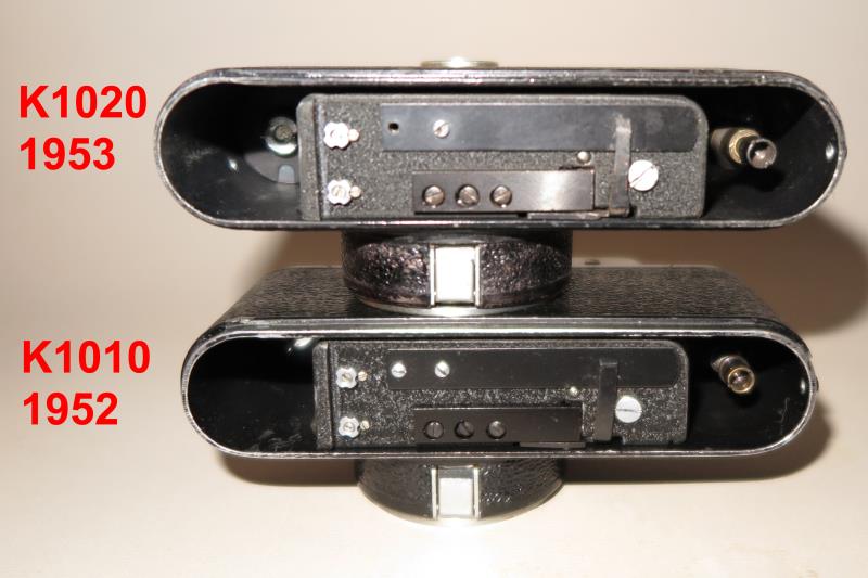

I think you focus too much on the Zorki family. The idea of modifying a Zorki and build a mirror and a pentaprism housing on it to make a SLR was of course at the beginning of the design process of this camera. But I'm not so shure that all the details used in the prototypes are taken directly from the actual Zorki production.
For the comparisation I upload a picture of two open Zorki (K1010 from 1952 and K1020 from 1953):
Maybe one screw is missing in the K1020? Now you can compar with the camera in question and I think you will see not much differences.

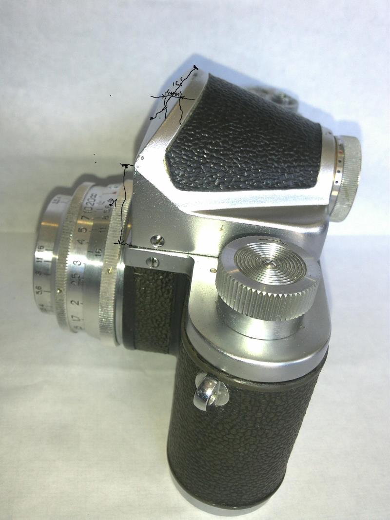

Now about the duct cover. It was identified as round, I think, due to the fact that at this time Kontaks was in a process of developing in the GDR (I might be mistaken, I am an amateur) and Kontaks has chopped corners of the duct cover and in order to avoid accusation in plagiarism they have made another duct.
But here is a more practical thing. If we assume that my camera is fake, let’s then try figure out from what kind of camera’s cape the cape on my camera is made.
I don’t thing that it was created manually for a fake sample.
In order to do so I pointed to its measurements on the picture. Let’s compare them with the measurements on Guido’s cameras.
1. The height of the front panel with the inscription Zenith is 21mm.
2. The height of beveled front panel with the factory logo is 16.5 mm.
3. The width of the front chrome edging in front and above of the factory logo - 4mm".

Your measurements are a great idea too. Here the results of mine:
1. exactly the same, 21mm
2. hmm ... 21mm on mine!
3. 3.3mm, but the edge is much rounder, so not really to compair
I don't know why this big difference at point 2. Could you maybe find an other Zenit-1 or Zenit-C and compair both pentaprism housings side by side? You know that I noted earlier that I seen some possible differences in shape of this parts.

Guido: thanks for the photo of the s/n 10. Now, things are more clear. The visible mechanism on this K 1005 is exactly the same as the so called K 1007. A Zorki 1b's. But as the 1b has the former speed scale, I wonder if the speed mechanism has 6 (B to 1/500th) or 8 (Z to 1/500th) slots.
