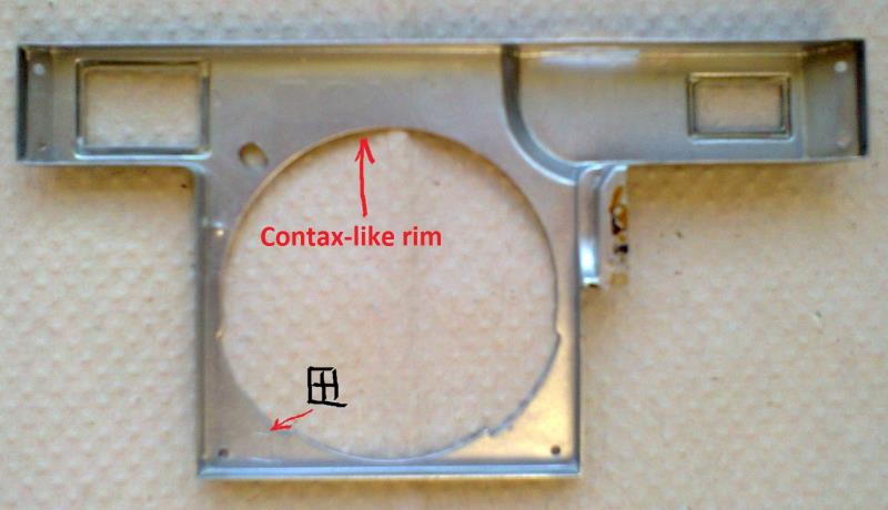

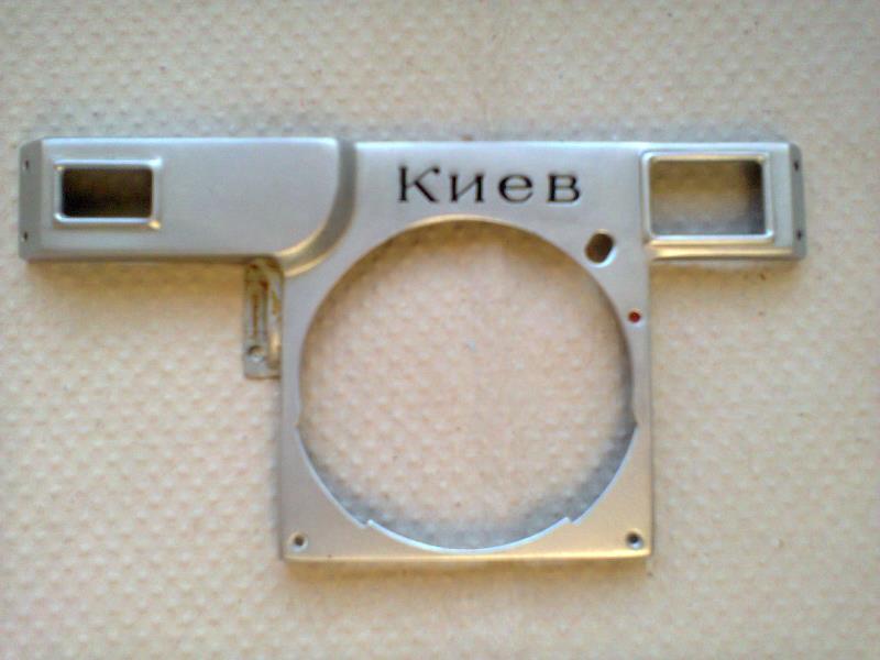

Here is a front plate. Note the Contax-like rim:
http://www.ussrphoto.com/resize/resize_image.aspx?ImgWd=800&IptFl=/UserContent/2422015_5.jpg
http://www.ussrphoto.com/UserContent/2422015_5.jpg
It is badly seen but there is a 'window' engraving. It was engraved before the plating process. Note also the absence of black threads around the rangefinder windows that are common for early Arsenal Kievs.

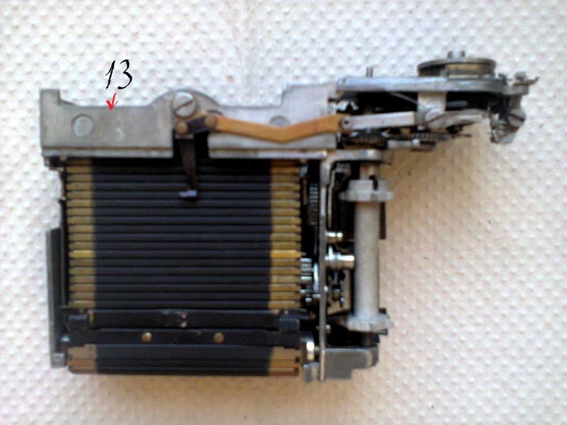

The shutter is badly seen. There is scratched number "13"
http://www.ussrphoto.com/resize/resize_image.aspx?ImgWd=800&IptFl=/UserContent/2422015_2.jpg
http://www.ussrphoto.com/UserContent/2422015_2.jpg

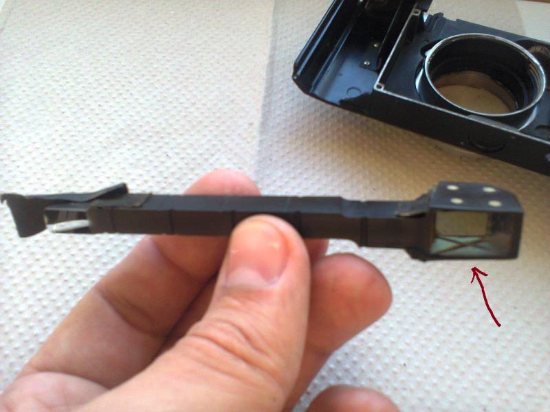

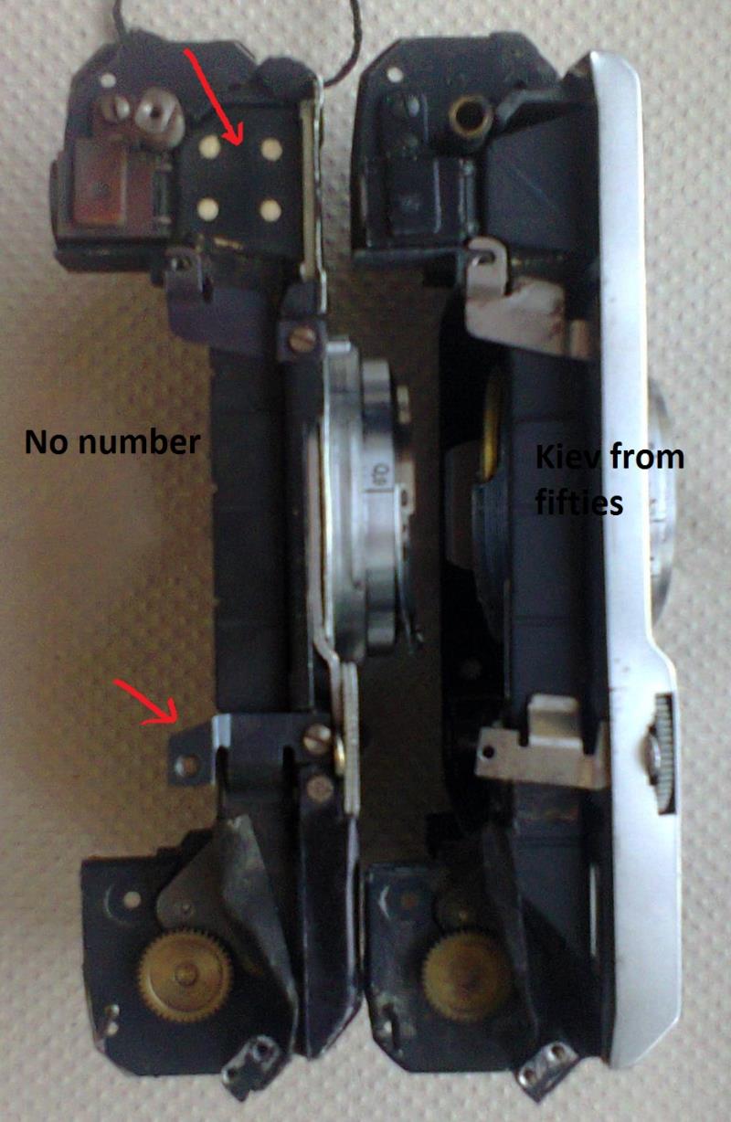

Top view on the rangefinder system. I placed also the piece of Kiev from fifties.
http://www.ussrphoto.com/resize/resize_image.aspx?ImgWd=800&IptFl=/UserContent/2422015_1.jpg
http://www.ussrphoto.com/UserContent/2422015_1.jpg
Rangefinder is of Contax type with the additional splitting of the beam-splitter.

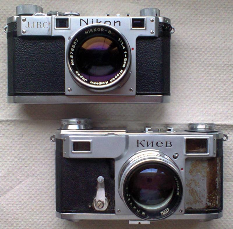

http://www.ussrphoto.com/resize/resize_image.aspx?ImgWd=800&IptFl=/UserContent/2422015_3.jpg
http://www.ussrphoto.com/UserContent/2422015_3.jpg
Two beauties[:)]
