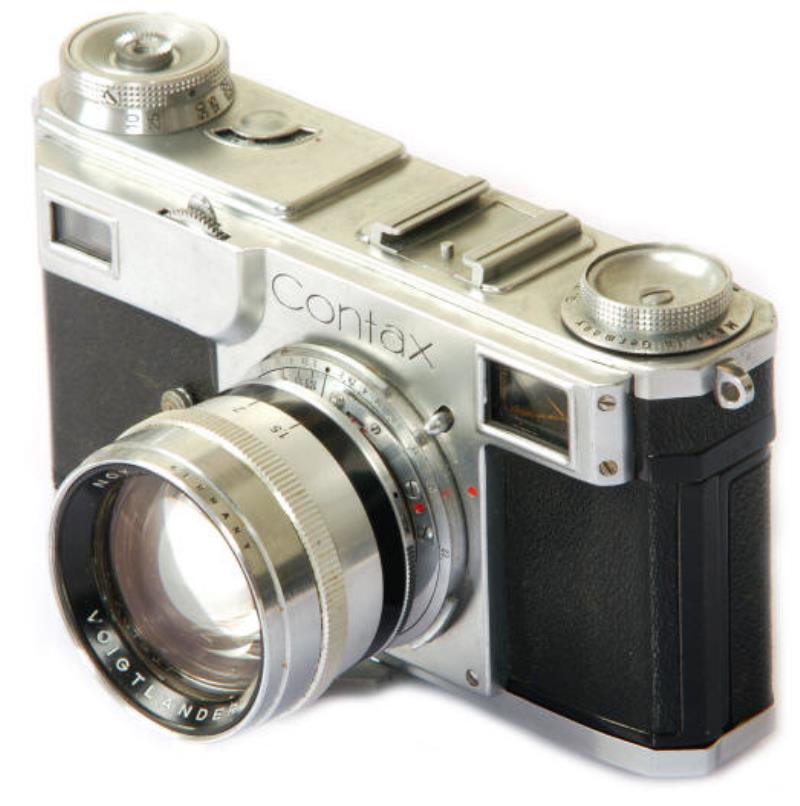

A very interesting camera. The distance ring and the rewind button have Zeiss origins. The back part too, even if it has no Zeiss logo.
It would be interesting to dismount the front plate. Perhaps there is a Zeiss engraving at the reverse, like on the early 1947/48 Kievs with Zeiss Dresden parts?
Perhaps a pre production camera. Or a camera made with spare parts.
Just a word more. Most of the prewar Contaxes didn't have the s/n in the accessory shoe, like the Kievs. Their s/n was on the base of the shutter box and on the inside of the removable back part.
I hardly resisted the temptation but I ended thinking that camera is a private remade from spare parts. Both Kiev and Contax parts. Top plate leatherette does not match with back door ; front plate 6 screws look like new... A sticker "made in Russia"....

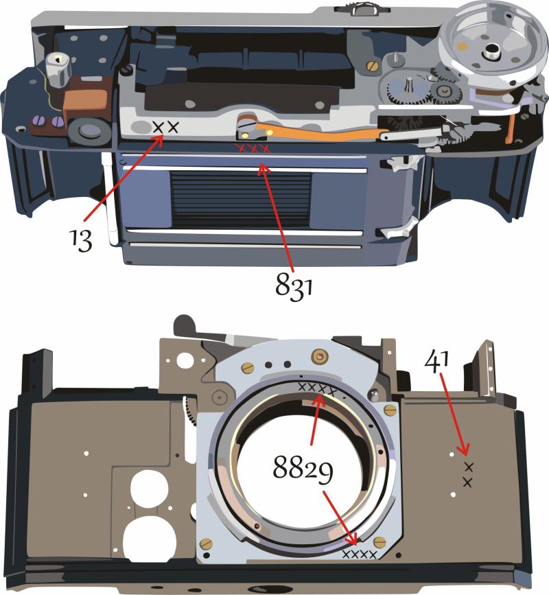

I dismanteled the Kiev and here are my observations.
The camera was kept a long time in moist conditions. The lens is completely ruined by fungus. The bolts that hold the winding knob are not covered with chrome and were rusty.
There are some other details that says that this Kiev was assembled from the unfinished spare parts of Contax. These are: bolts that hold the winding knob, bolts that hold the tripod socket (not painted with black), two bolts on the bottom of the housing that hold the shutter and the self-timer housing (not painted with black), the bolt that holds the self-timer arm (differs from the standard one and is not covered with shiny chrome). There are some other small defects that indicate that the camera was assembled from the rejected spare parts.
The camera was never repaired or opened. At least I did not find the indications of that. The front plate with Kiev name was
removed by somebody and one glass from the smaller rangefinder window is missing. I think that the reason of plate removal was exactly removal of this glass. Probably it was cracked or somebody needed a thin glass. Anyway, the front plate is original or at least is the same as the front plate of Kievs from 1947 to 1949 (the rim around the bayonet typical to Contaxes and not of Kiev-like from fifties). The front plate does not contain any signs of Contax engraving on the inner side (as I expected). There is a small engraving of rectangular window (or of the cross inside the square) on the inner side. This was engraved before the plate has been plated.
The chrome is different in every part of the camera. The front plate is satin and not so mat as on Kiev from 1952 or later. The top plate is shiny with a fine grain chrome plating (like from Contax of M series) . The bottom plate is shiny with grainy chrome (like from Contax of J series). By the way the back door does not perfectly fit the body but it does not affect the camera functionality. This fact also shows that the camera is assembled from spare parts of different Contax series with no high standards of Zeiss Ikon strict control.
Almost all camera parts are from Dresden Contax line except the leather on the back door and on the camera front. This leather is alike on the structure to the leather used on Contax Jena. The leather of Ukrainian Kievs of 40-es and early 50-es is less grainy and differs by the structure of inner surface. The chellac that glues the "Jena" leather is dark and it seems that there was a shortage of it since the leather is glued on metal by small separated islands of chellac. This was a reason that one piece of leatherette is missing.
The rangefinder is of Contax type with a gold plating of the splitting-image surface of the prism. The construction of it is typical to Contax rangefinders of Dresden epoch.
The shutter is from Zeiss Ikon Contax. Ribbons are of white color and the leather on the lifting heel (the lower shutter drum) is from brown leather and not from red or white suede as on Kievs. The shutter housing has "H" marking on the front face and there is a scratched number "13" on the place where Kiev's shutters have their engraved numbers. Since the numbers on the shutter of Kievs'47 coincide with the last digits in the camera serial numbers one can speculate that Kiev under inspection is 13th Kiev ever made. Definitely this number is the only marking that was done by assembling the camera. But I would say that this is a 13th Kiev in the batch of 'unnumbered' Kievs prepared as a bribery for Soviet occupation authorities.
This Kiev has another numbers: "41" on the camera body, "8829" on the bayonet (engraved on the right lower side as on ZI Contaxes), "831" on the plate that covers the shutter and guides the film transport.
This Kiev does not have a strong smell of decayed lubricant as old Kievs have.
I will show some pictures later since I need to transfer them on my laptop.

I prepared a scheme of places where one can find numbers on Kiev without the number.
http://www.ussrphoto.com/UserContent/2222015_b1.jpg

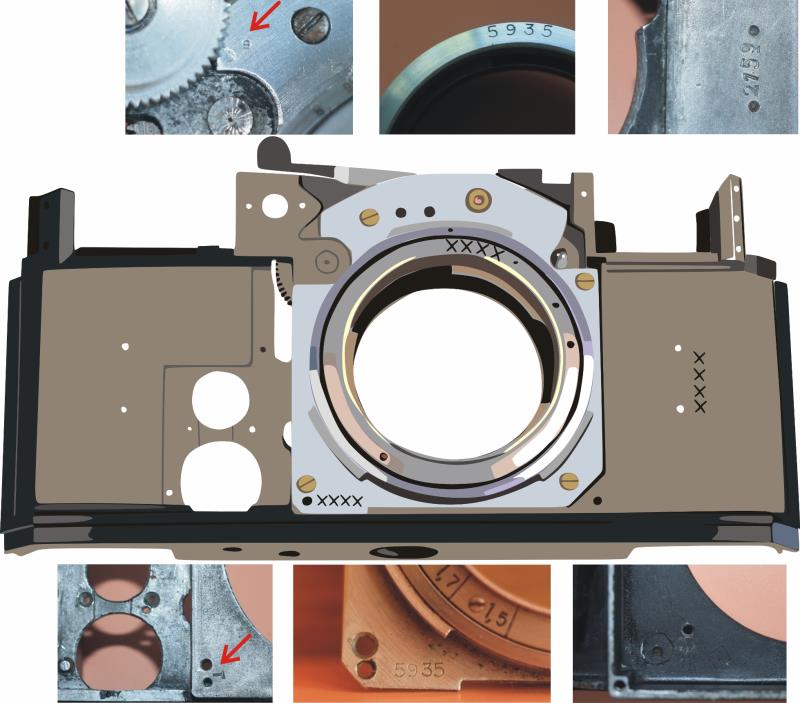

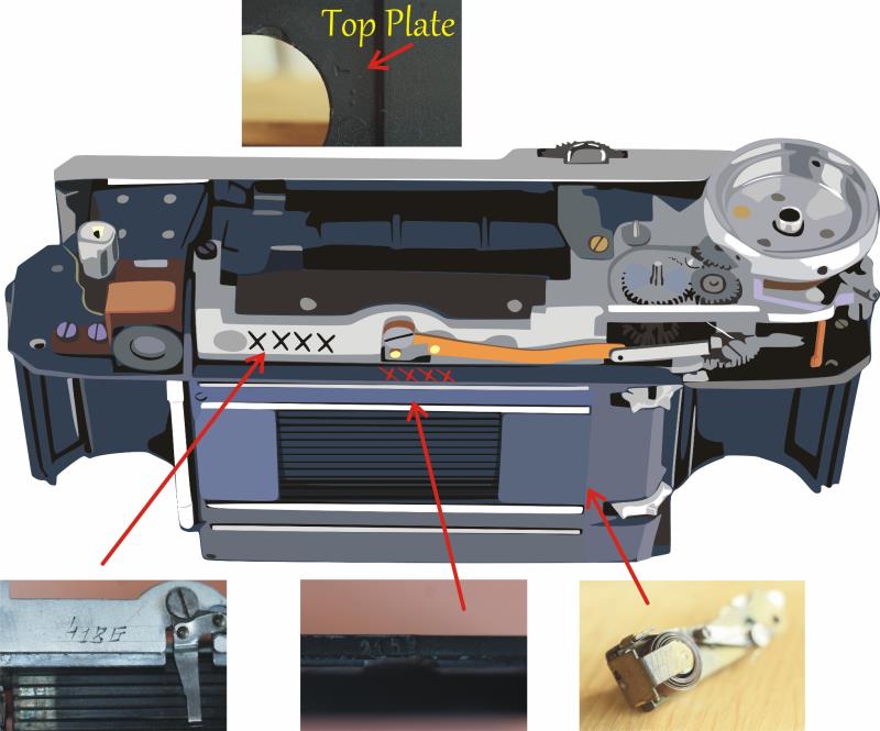

Here are some markings on Kiev from 1950:
http://www.ussrphoto.com/UserContent/2222015_b2.jpg
http://www.ussrphoto.com/UserContent/2222015_b3.jpg
All these markings are aids for the correct assembly. So one should not pay much attention to them. But I find them funny.

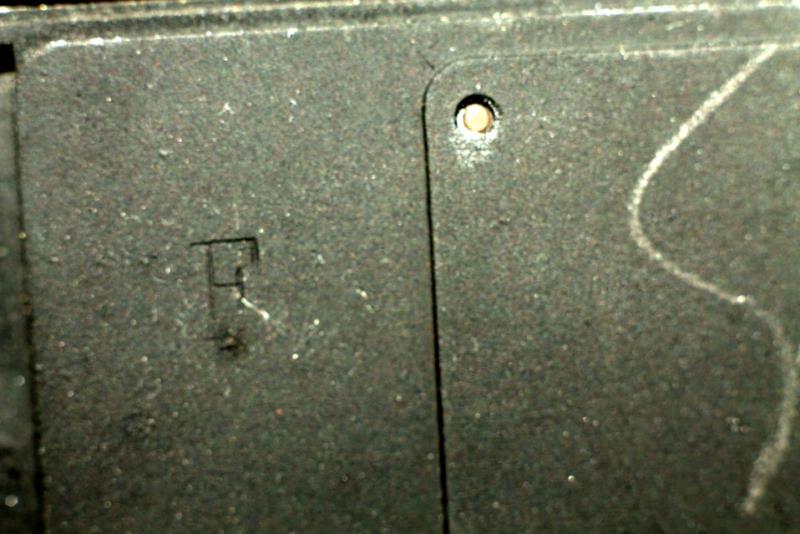

Here is a letter "F" on the top plate of Kiev II from 1951.
http://www.ussrphoto.com/UserContent/2222015_b4.jpg
After 1952 Latin letters were replaced with the numbers.

If I dared... Do you have explanations about the meaning of the numbers? Do you want us to have a look at our Kievs and collect these numbers?
Dear Jacques,
I don't think that all these markings are interesting to investigate. They are all random and were used as an aid during the assembly of the camera. I am just curious if Contax Jena has similar letters on the inner side of the top plate from aluminium alloy. I think this marking tradition of the top plate started in the early days of Kiev production.
I also noticed that early Arsenal Kievs have hand written markings done with a pencil. These are Latin letters and they appear almost on every principal blocks of Kiev mechanisms. I think these markings were made by the quality inspector. My Kiev III from 52 has letter "R" on such blocks. So most probably a German specialist checked the quality of the camera.
